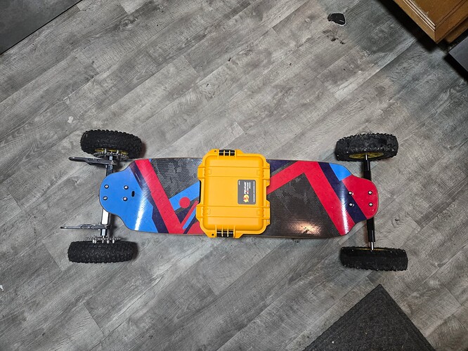

Monday February 3rd was the day the Gravel Flux came back in effect.
I didn’t have far to go in the process…
The yellow box was fastened on, so next up was poking new holes on the deck for the cables
Some drilling and dremeling later we have usable, ugly holes…
So the aluminum plate holds the box to the deck.
Tiny screws hold the unity to the aluminum plate so it’s not ever moving.

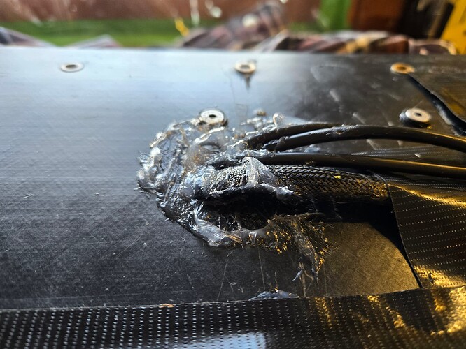

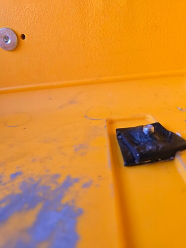

And Butyl tape is the real MVP!!! it’s everywhere! it’s under the box to hold it in place, it’s being used for gasketing, that stuff is awesome
The charge port got soldered on including a fuse… And caked with super glue. So it’s not moving, and protected.
Then Butyl starts it’s job on the bottom holding down the phase wires.
My new thing with this build is that I am slathering silicone paste everywhere, all over the place,I’m not sure if it’s really a good idea but hopefully it doesn’t mess stuff up.
Finally we get gorilla tape covering everything…
Gorilla tape andsilicone paste do not go super well together, so that already started being dumb

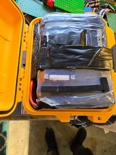

First up I built a little cage with Legos around the unity.
Next time for what ever reasons that could possibly really dumb I slathered silicone paste all over the unity. it’s like a Diddy party…
Then an ABS sheet covers the cage and the unity and the battery sits on top of it.
It’s a pretty tight squeeze in there and I have to push the lid down a little bit,but it fits

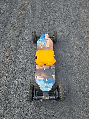

Once I closed the lid I was ready to go ride!!!
I really happy with the look with the yellow box. I really enjoy the pumps of color

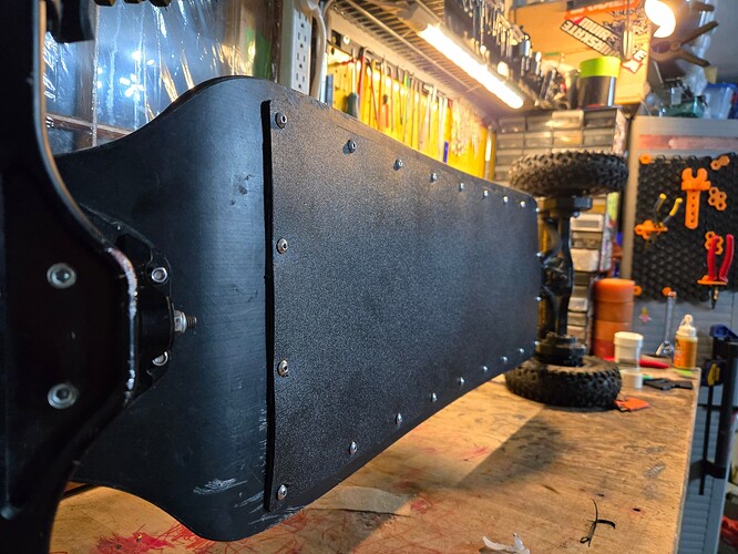

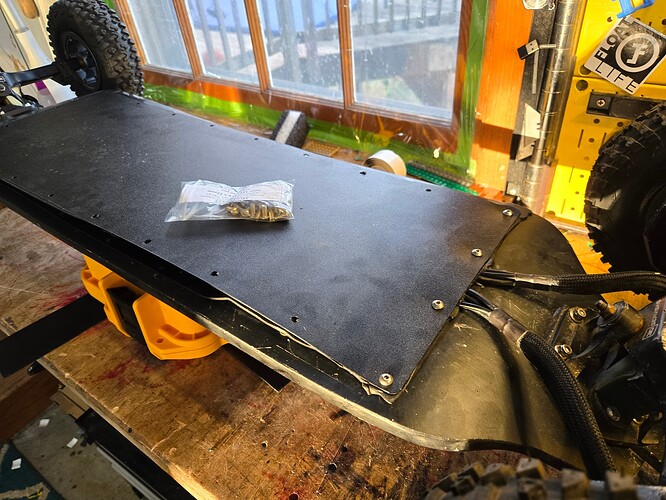

I did have to go back and finish putting the ABS plate on the bottom to protect the cables.
The last whatever setups I did like this I only did ABS on half of the deck which is hard to keep water out of, and It looked kind of crappy.
This time I decided to do the whole bottom and use all of the enclosure holes which is really kind of an obvious thing to do I’m not sure I didn’t do it before but here we are.
First off is the real MVP once again the butyl that I used to make a perimeter around.
Then I just went up and down with the bolts
I think this turned out like really sweet.

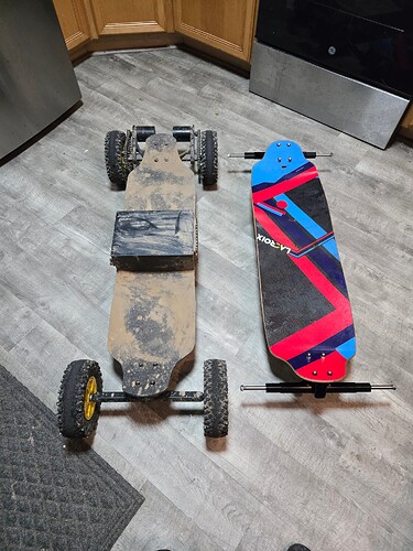

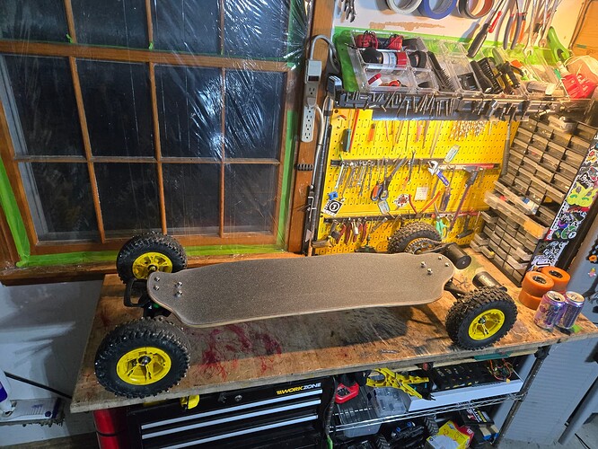

The Dualitys are here for the Almost a Flux.
I am basic, and just got the MTB 300s like I have on the Flux.
I got into figuring out the hardware for the trucks.
Sometimes I don’t have all the right bolts…
This time I did!!!

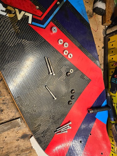

The next move was filing down Josh’s shinny nuts. @monsterbuilder .
With this flat edge I can use them with the Dualitys.
Here we have another stare down between the LaCroix and the Tomiboi.

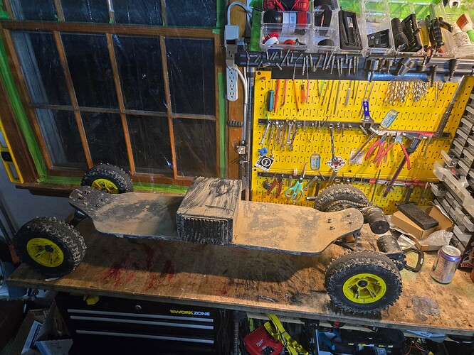

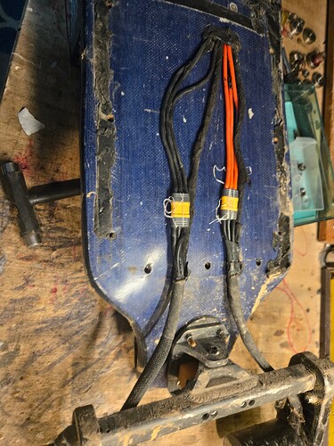

Next up the Gravel Boi goes on the bench to get dismantled.
I swear 30% of my DIY life if peeling off Gorilla tape…
Disassembly went on without any major issues.

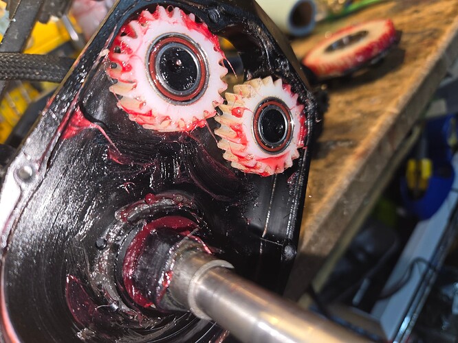

Unlike the gravel flux this enclosure box was completely dry inside, but if we recall I had killed a Unity on this very board I think last winter with water ingress.

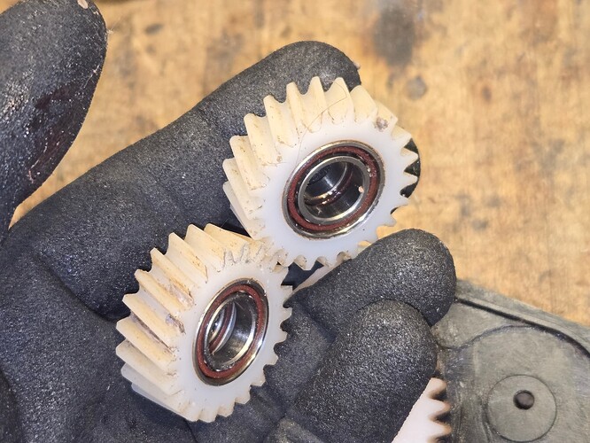

Once on the gorilla tape and butyl tape was off it was fairly easy to remove the motors because of the Radium mounts are so awesome to work with.
Next up I did the tires I had to move tires around to put a couple new mud pluggers on here.
These trampa Phatladz hubs start clicking a while back, but then I learned that if I put RednTacky in the bearing seat they stop clicking!!! so I do that now and it’s fine.
And then I got to slap the tires on there and just plop the box on top so I could get my first preview.

On Friday I had to Drive to the skate shop to get some grip tape. I had ordered some Jessup Roam, but it never arrived so I went to get something locally which they don’t have anything as course as the Roam,but at least it had wide enough crypt tapes I didn’t have to get two sheets and have a line.
However many years it’s been since I first put grip tape on a skateboard man I still love it.
So finally what the grip tape on there I plop the box on top just to get yet another nice preview.
I’m really stoked on the way this thing looks,it’s really sweet to me.

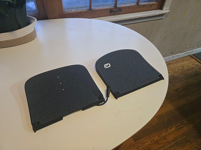

Luca’s first dedicated onewheel accessories showed up.
I got him the flared foot pads the soft version.
I’ve had the Halo foot pads on here which are the biggest foot pads you can get and have a ton of real estate but they’re also heavy and brittle.
So I am losing quite a bit of real estate but they should be a better fit for Luca anyway.
They look really nice on the board, these are parts that Future Motion got right actually.

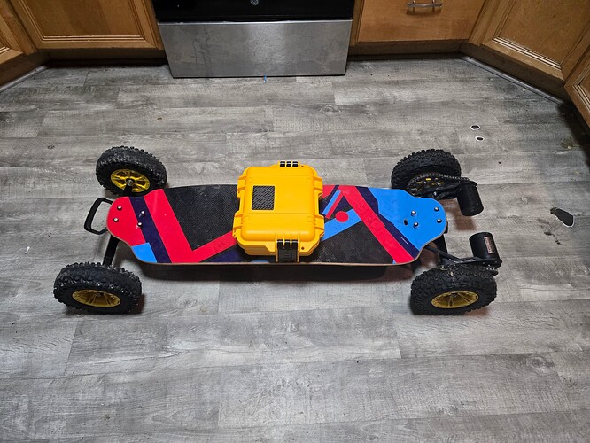

The goal last night was to get the cabling resolved.
The first step was to get the box really set on there and I used a ton of butyl tape on the bottom of the box to get it to sit.
Drilling through the box and the deck for the cable holes is another task that makes me really nervous but I got it done and it’s not perfect and I did it somewhere different than the Gravel Flux which turned out to be less than ideal but we’re making it all work
So I got to the point where I was able to hook everything up and run motor detection to see if everything still worked which is yet another one of those moments that can be nerve-racking.
Fortunately the Vesc Gods were on my side and everything is coming up censored.
Up until this point I had not put the charge port in the box yet, That’s less than ideal… Ishould have done it way earlier when it was loose but I drilled the hole and soldered the wires on. so moving on!!!
Next up is just all the taping on the bottom.
I decided to leave these XT60s here on the bottom because I didn’t want to do direct soldering, or move the XT60s
I just didn’t want to mess with it now I’m going to have to deal with it when I try to do the ABS plate.
We got the bottom all taped up with a massive amounts of gorilla tape.
I’m just using butyl tape to try to seal all of the holes into the enclosure.
And just like I did with the Gravel Flux I’m using Legos around the unity for support to put the battery on top.
It was just happenstance that the Z-mote I have for this board happens to be yellow and obviously I could not be more thrilled.
I really enjoy the pops of color
It’s lives.

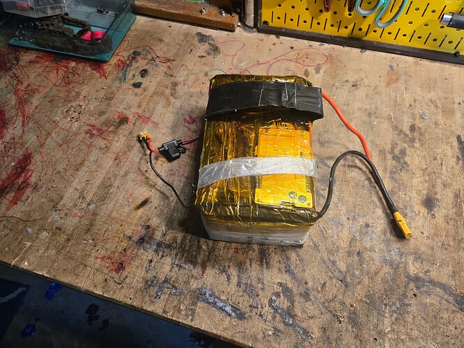

And I have to do a little bit of cleanup with the battery and shrink wrap and put some foam in there but for the most part I’m all set.

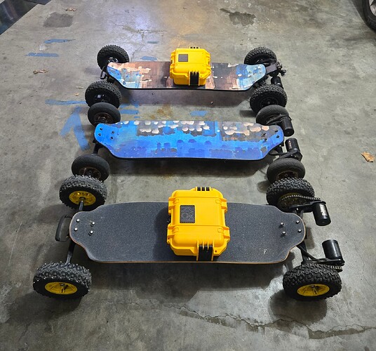

This lining up the boards for a picture maybe the most I do today.
