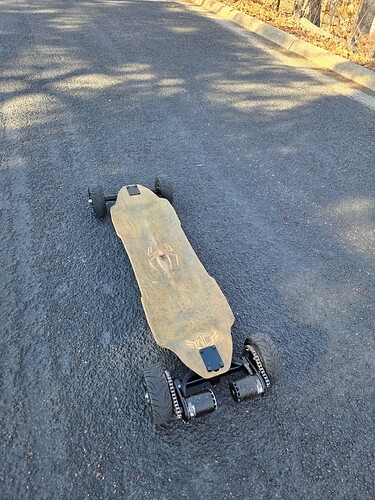

I finally got to take the Almost a Flux out in the woods, with the Singularitys!!!
It was amazing.
These trucks are really cool with these bushings and I could get around super well on this giant behemoth of a Deck.
So I love the deck.
I love the trucks.
I am really loving the tires!!!
Yey.
But the board is fucked up…

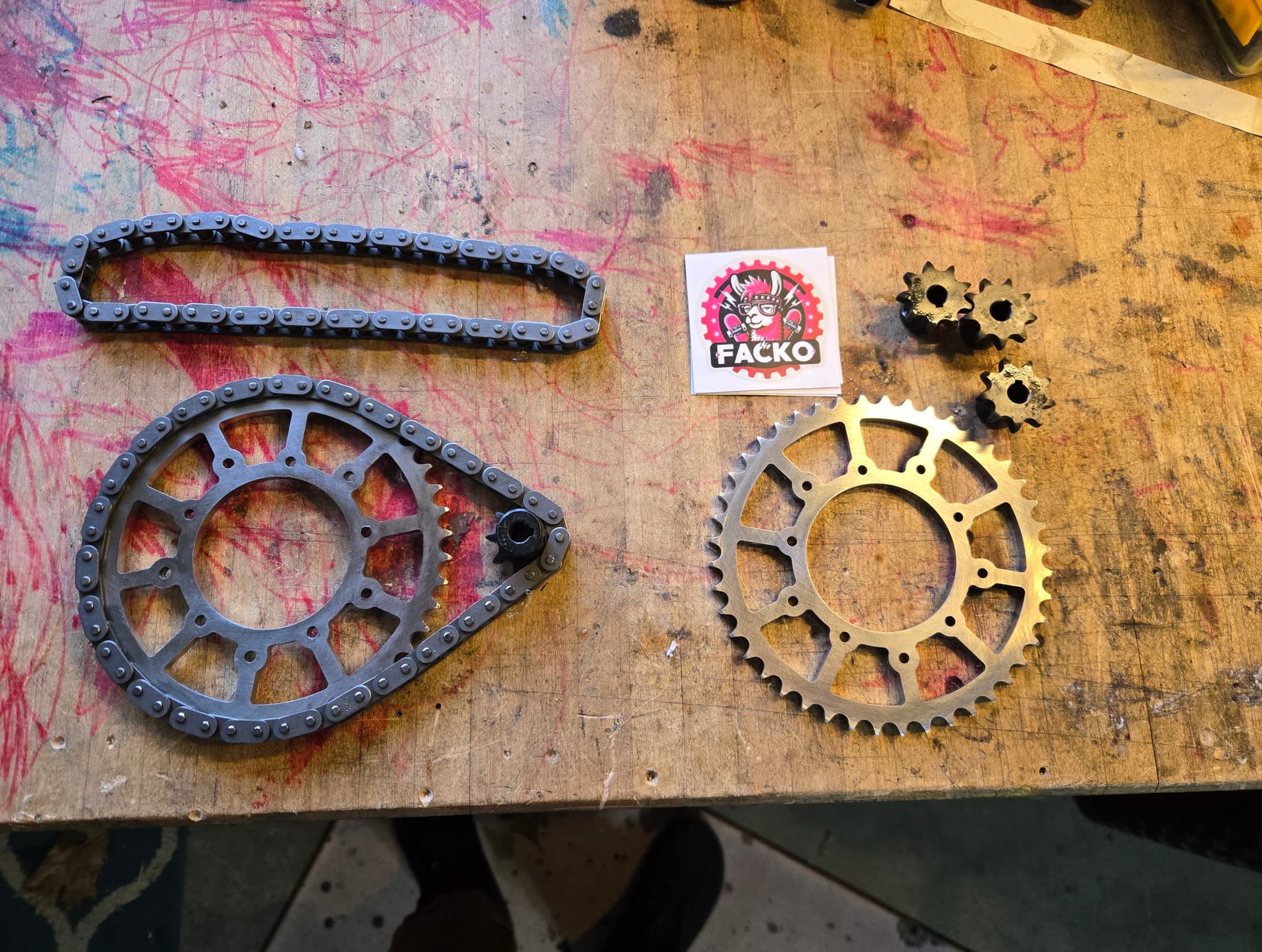

The 41/9 gearing on 190kv is not ok.
And a heavy guy such as myself should not try to be cool and rub a board without a heat sink…
The way I crammed the Unity under the battery in the Yellow box was cute and all.
But it was a little furnace in there.
So I had to open up the board.
I had ordered a new set of chain sprockets from Facko to jump up a tiny bit to 44/9
But what really needed to happen was moving the Unity up to the top and adding the heat sink…
And that’s what we got into today.

After that I moved on to putting on the larger sprockets which just required removing the rear wheels and taking off five little nuts to remove the sprocket.
I had a real scary moment because the chains I have are not long enough for me to put on with the adjustment that I have with the motor mount.
I figured out that I could remove the sprocket then get the chain on there and then insert the wheel into the sprocket and have just the right spacing.
It all worked out. I have one more P group in the battery here.
I have slightly taller gearing.

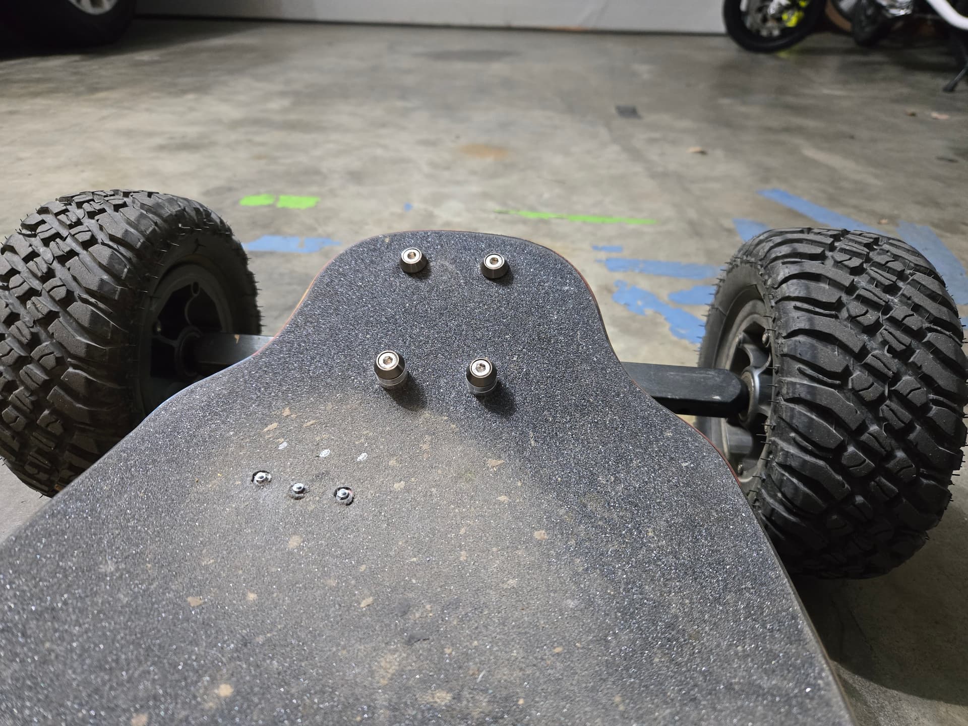

I also decided to go ahead and send it, and add a few studs to the deck.
I just did three in the front and three in the back.
This board does pretty well going up and down curbs.
Could not be doing this shit with Dualitys on here…
Those tires are so wild
