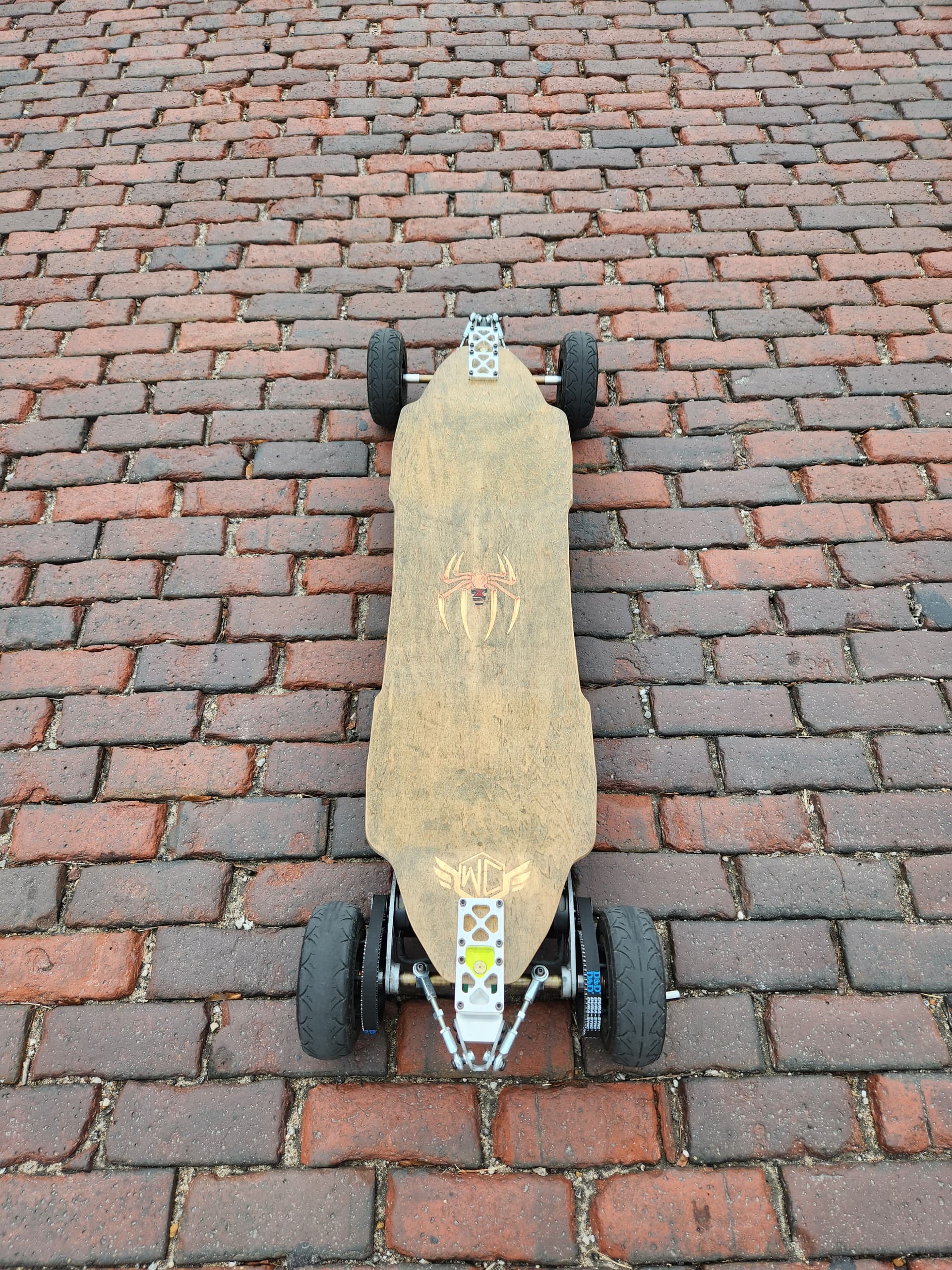

Here I was standing over the board finally getting the chance to try 3 Link Trucks.
And I have to say my initial reaction is that they were weird.
The very first cruise around was interesting.
The trucks turn.
The trucks were loose.
I didn’t have great turning radius, but carving felt pretty good.
But weird nonetheless.
But here is the thing though.
There is so much going on with these trucks.
Like a lot…
So where did I even start off with them.
I did lower the height of the Heim right off and had Maybe 12mm of thread sticking out from the baseplate.
On the front I started off with the most angle. While still having the bracket facing down. So arms below the axle, and on the top hole.
The rear I think I started with the flattest I could.
With the bracket down.
Arms above axle, and on the lowest hole.
I think after just a few minutes of riding I put the rear on the middle hole and left it there.

These trucks are great for the esk8 afficionado that can’t leave shit alone.
Up on the bench they went.
Dallas @dskate was the biggest cheerleader for these.
He apparently loves them.
And is willing to answer the million questions I had.
It’s still wrong that he sold his Flux…
So here I am lowering it.
I have the enclosure clearance.
There is no reason not to make the trucks as low as they can go right…
Besides taking the trucks apart, I did have to drill through the deck.
And I am such a savage and an asshole, that I don’t think it’s possible I could have done a worst job on drilling these holes.
Remind me to fill the extra holes with epoxy one of these days.
Fucking savage.
So I have lowered the ride height 12mm, and I have flipped the front bracket, so I am working on new angles.
Front arm is under the axle, and one hole up. Just above the bracket.
The rear arm is above the axle, the clamp is also flipped up. And had it on the hole even with the baseplate.

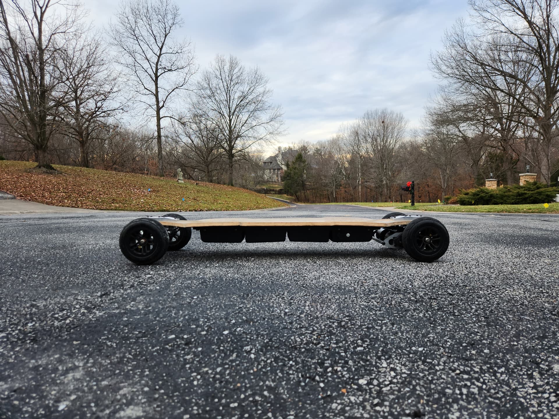

We had some nice days at the beginning of the year, which was sweet, because I could take the new darling out.
All kinds of clearance.
Almost feels wrong.

So the way I have the front on the 3 Links is the most angle I could get.
I had lowered the heim all the way.
Flipped the bracket, and had the arm below the axle, and on the top hole.
@fujio001 pointed out it may be sketchy to have the arm extended that far, and he was onto something, because I did not have a lot of thread engagement going on there.
This really added to the fear of these things falling apart mid ride…
So I ordered some longer middle pieces.
These would be too short for the bottom hole.
They can reach the middle hole, and have good thread engagement for the top hole.
I also loosed the bushings all the way to try to get to a new starting point with these trucks, and that allowed me to make u turns on my street. So there you go @Ash
