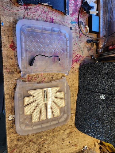

So I am going:
Lil Foccer 3.1 with Power Button.
Zesc - buck converter
To run the Avaspark LIght module with the stock lights.
Avaspark mounting plate.
Avaspark footpad connector.
Avaspark battery break out board to go with
Fungineers BMS.
And I will probably undo the GT motor connector, since I can’t buy an adapter … And don’t want to harvest from the stock controller.

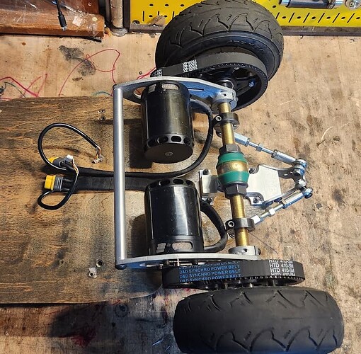

There was a lot of excitement just to try and mock up the deck, truck, and wheels, since I really didn’t know if it would all go together.
but right off the bat, I knew I needed an extension in the front, and I had already gotten one of the Mboards one from @AlexB
getting to this point here, was nerve wrecking, and exciting.
I am a pretty basic dude, and normally like for things to be simple and straight forward, and these trucks are not that.
There is a lot, I mean a lot, going on with these trucks.
One thing I decided to do right away as to try to lower the height of the Heim.
So I started drilling the deck.
measuring is hard, so I drilled the wrong spot in the back…
I also tried to mount the trucks on the back backwards…
So that was funny.
yep. this here.
backwards,
I had to take out the Circlip on the SKP/Reacher Motors to get them to work with these mounts.
I took off the wire braid I had on the motor cables, and put on Tesa tape to flatten out the cable, and provide more protection, in case the motor cans got close.
This is the indestructible Tesa, not the fuzzy Tesa.

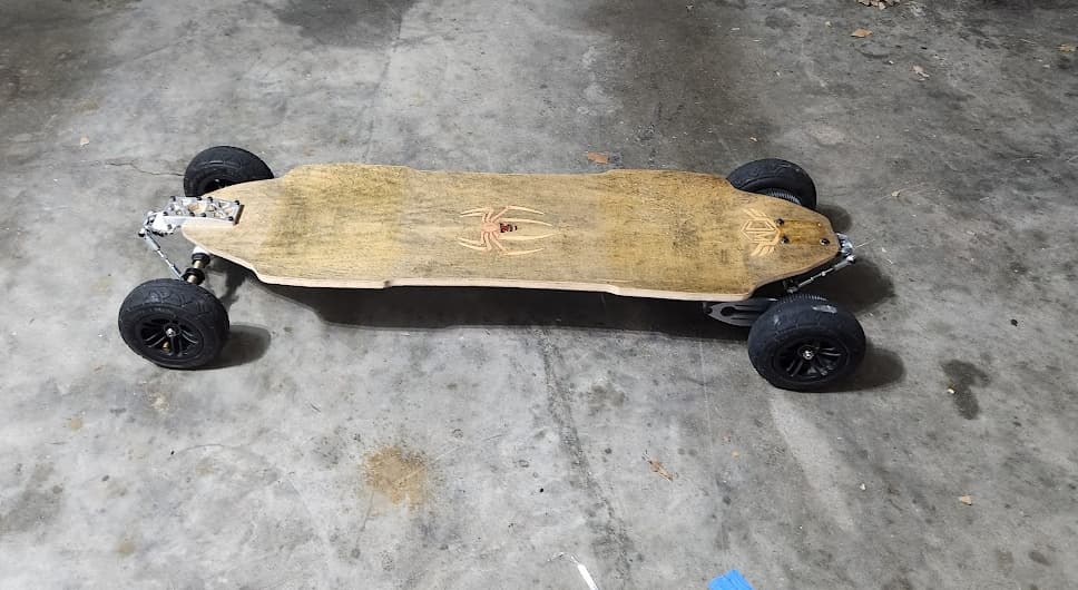

Remember how I had mentioned all I needed for the Llama Link was trucks…
Oh the lies we tell ourselves.
Somehow in the frenzy of the excitement of planning the build I thought, it may take me forever to build this battery(I have all the parts here)
And then @AlexB freaking basically offers to give me this 12S8P SKP pack. (it was such a good deal, I would have been irresponsible to say no)
Off course, that beautiful giant pack would not fit in the Old Flux enclosure I had, or the Khymera enclosure I had originally planned to use.
But it did fit the @tomiboi enclosure it was made for beautifully, which got made and shipped out to me just in time to make this a Christmas Miracle.
bigger is better right
So it is Sunday, December 24th, and I had all the parts I needed.
No bolts for me…
this relic made it on to the bench.
because I decided I needed an extension bracket in the back as well.
Many sets of inserts on this deck…
This was a lovely fit, so stocked when stuff is meat to work together.
The board was not quite together for this shot.
I actually got back to tinkering on Christmas day.
and just slathered Kapton everywhere.
needed a hand to connect the motor cables
And there it was.
