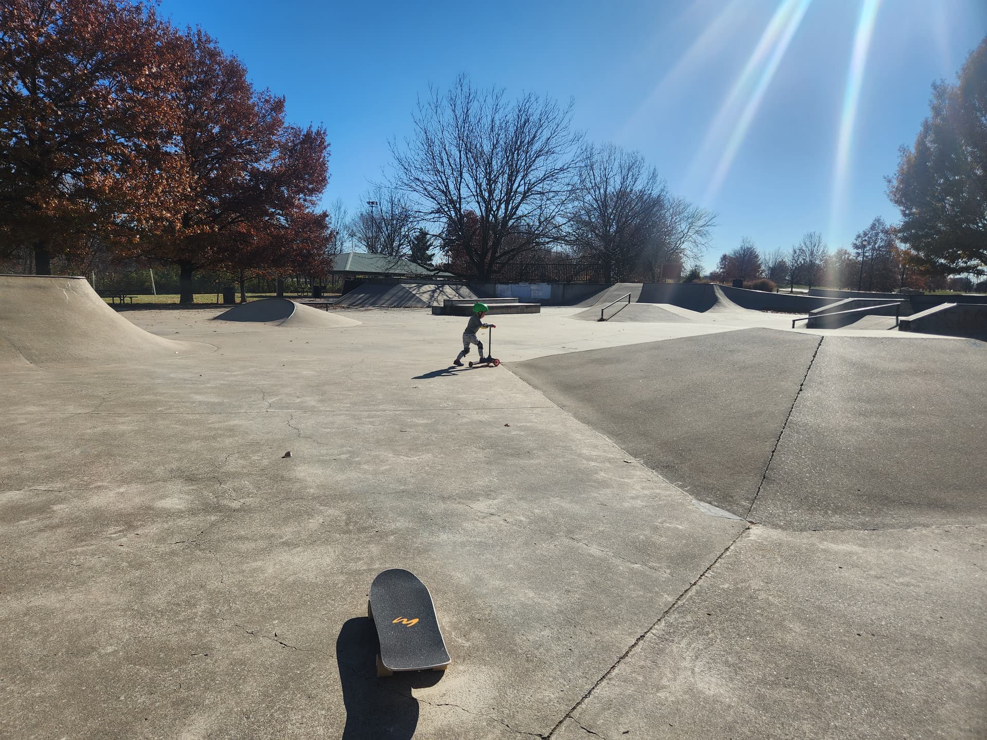

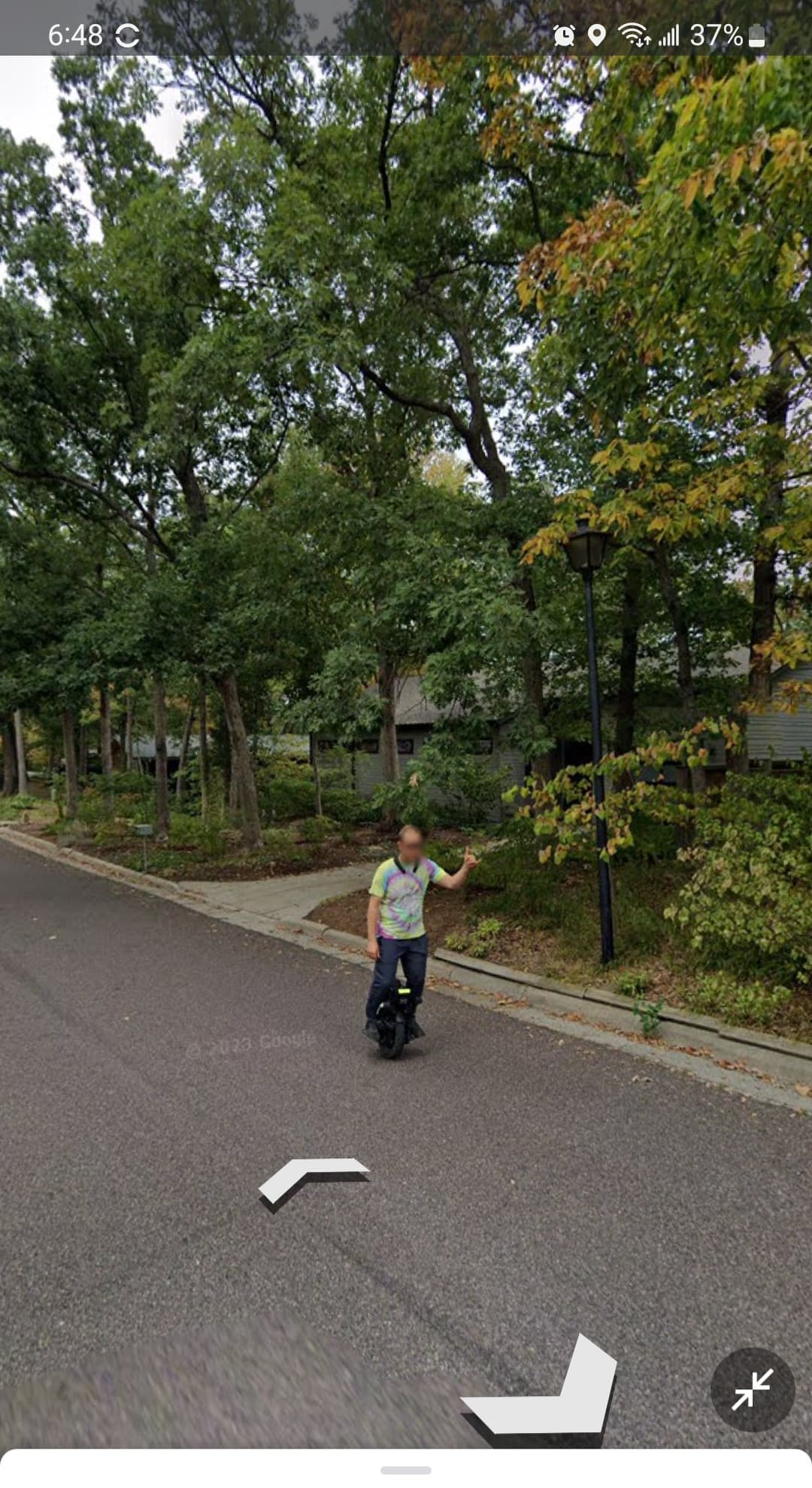

I made my street view!!!
We took the kids for a hike at the park where the skatepark is, and I walked by the there and got inspired to go skate it.
We went back home, and I loaded the van and snuck back out.
I started off on the ATV Ditch Life. To warm up.

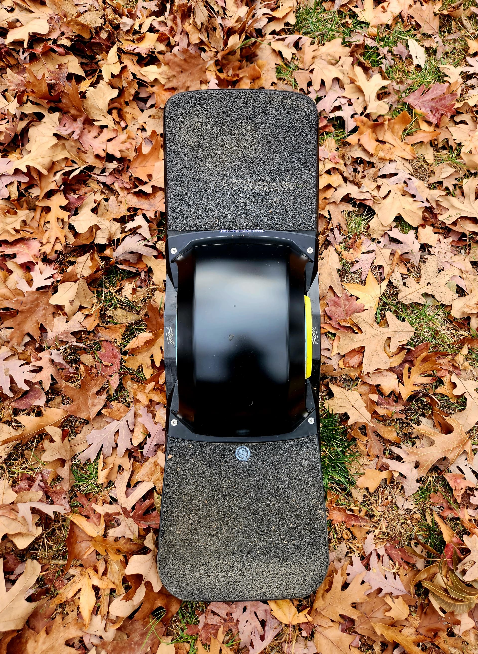

I rolled around on the Onewheel a little bit.
That was ok… I did not try a whole bunch.

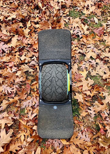

Finally I got the Dinghy out.
That was aslo short lived because it was extra scary on transition.

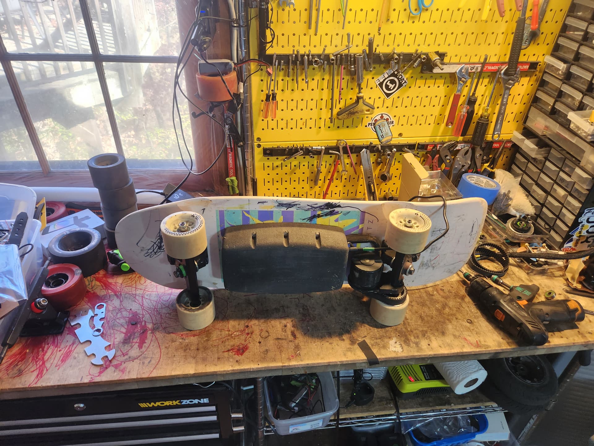

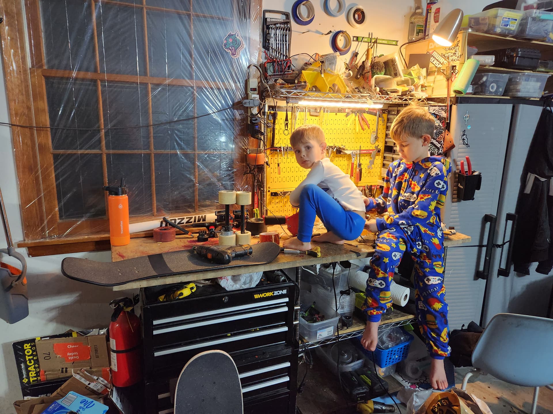

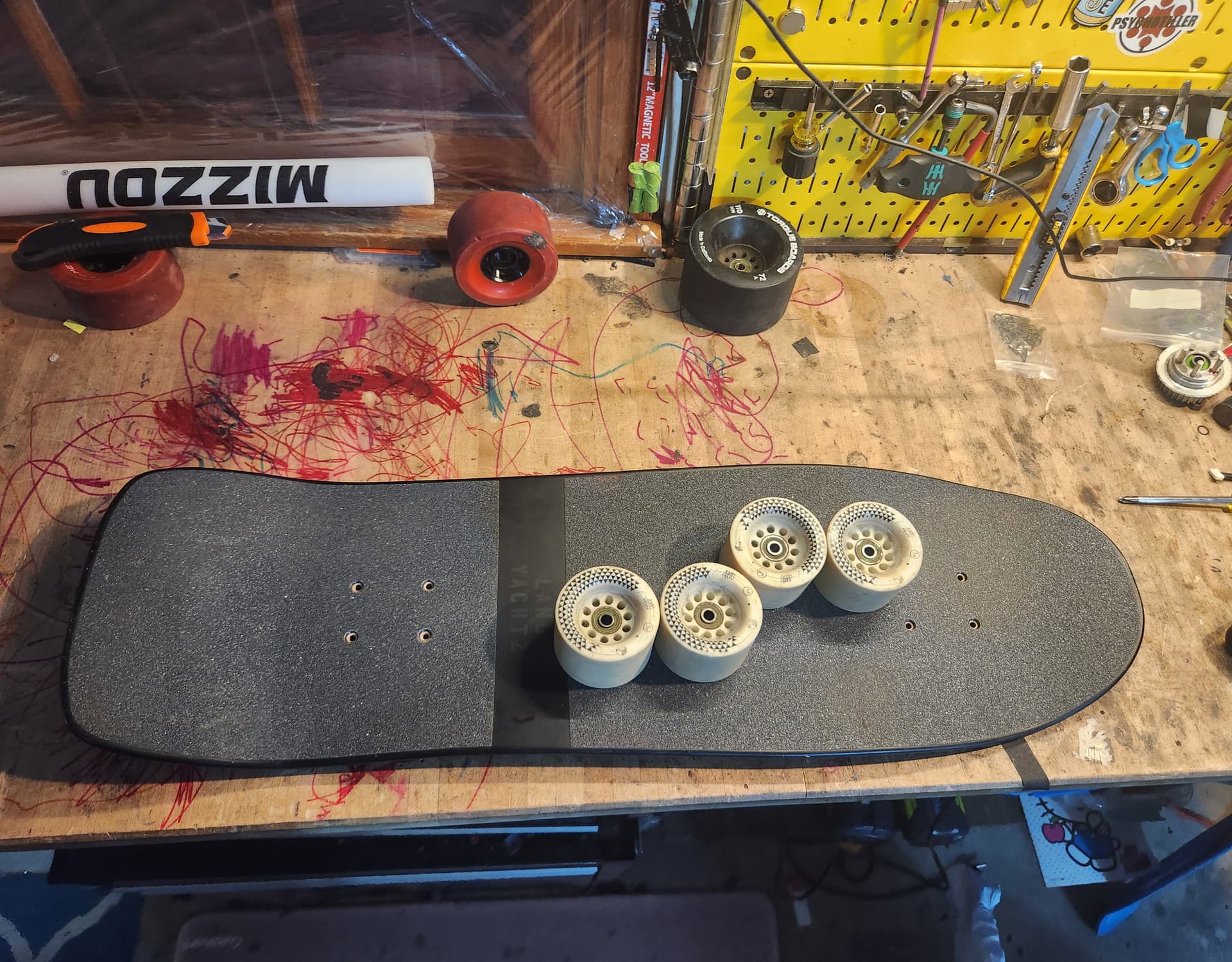

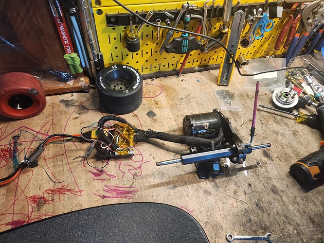

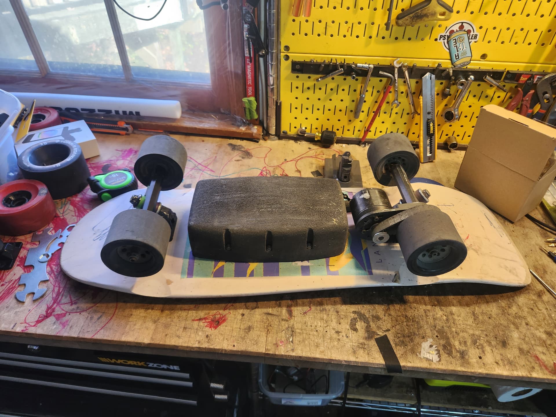

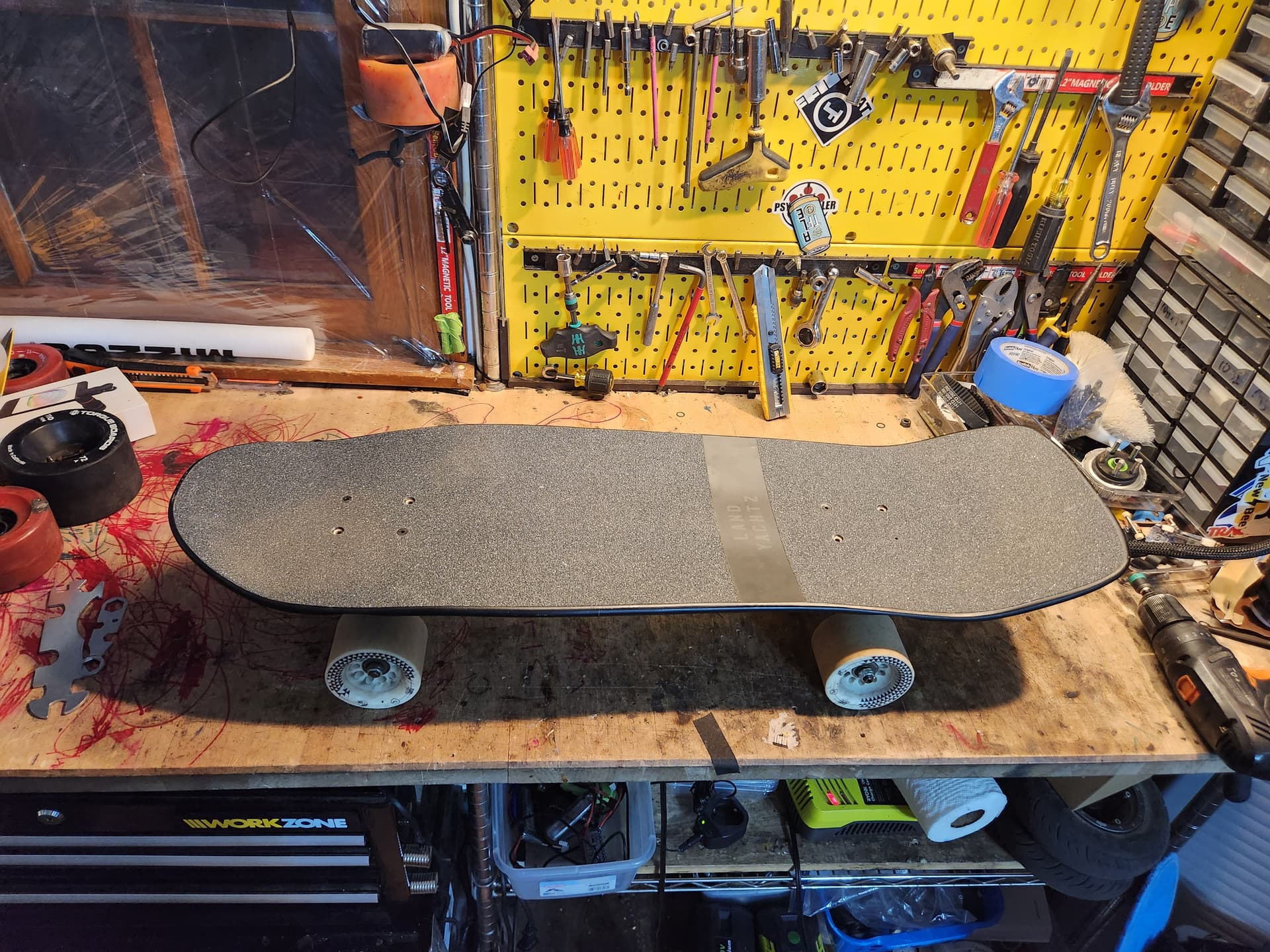

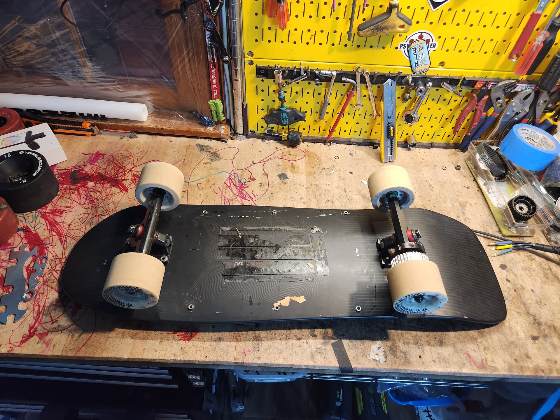

So much so, that I decided to make a skatepark specific build, mostly with parts I have around.
I took the DH Akashas off the Rally Cat
And broke my other ATV Ditch Life deck out of the basement.
Back truck is a BN 145 I had on the Black ATV last.
But I’ll use different motor and ESC.
This is such a good idea both boys decided to help me!!!
Up front it’s Caliber II 150S I think.
I am shaving some weight off by using a 12S1P P45B, instead of the 10S2P 40T.
So 8 cells less.
I’m going to use a Focbox, and I am getting a new Flipsky 6354 190kv motor. And the Z-mote from the Rally Cat.

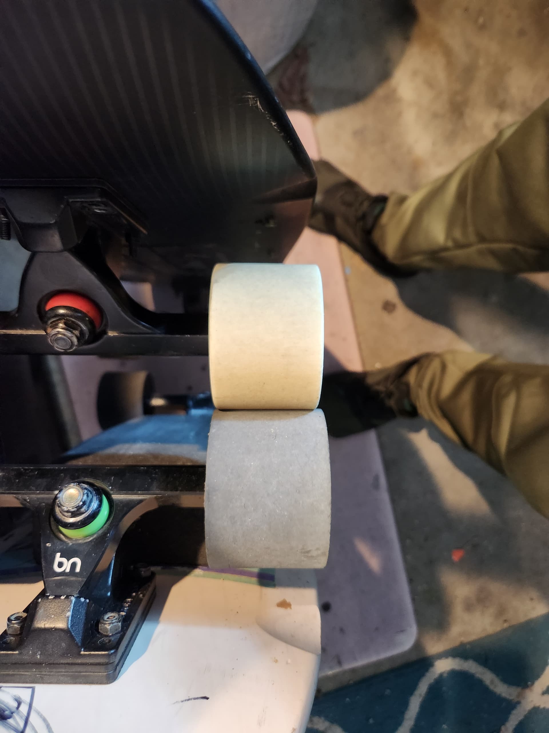

The DH Akashas are a good bit smaller than the Kegels. Forever grateful @Razillian
Which also lets me take risers off.
So, excited.
Batteries are ordered.
I wonder how long before it actually comes to life.

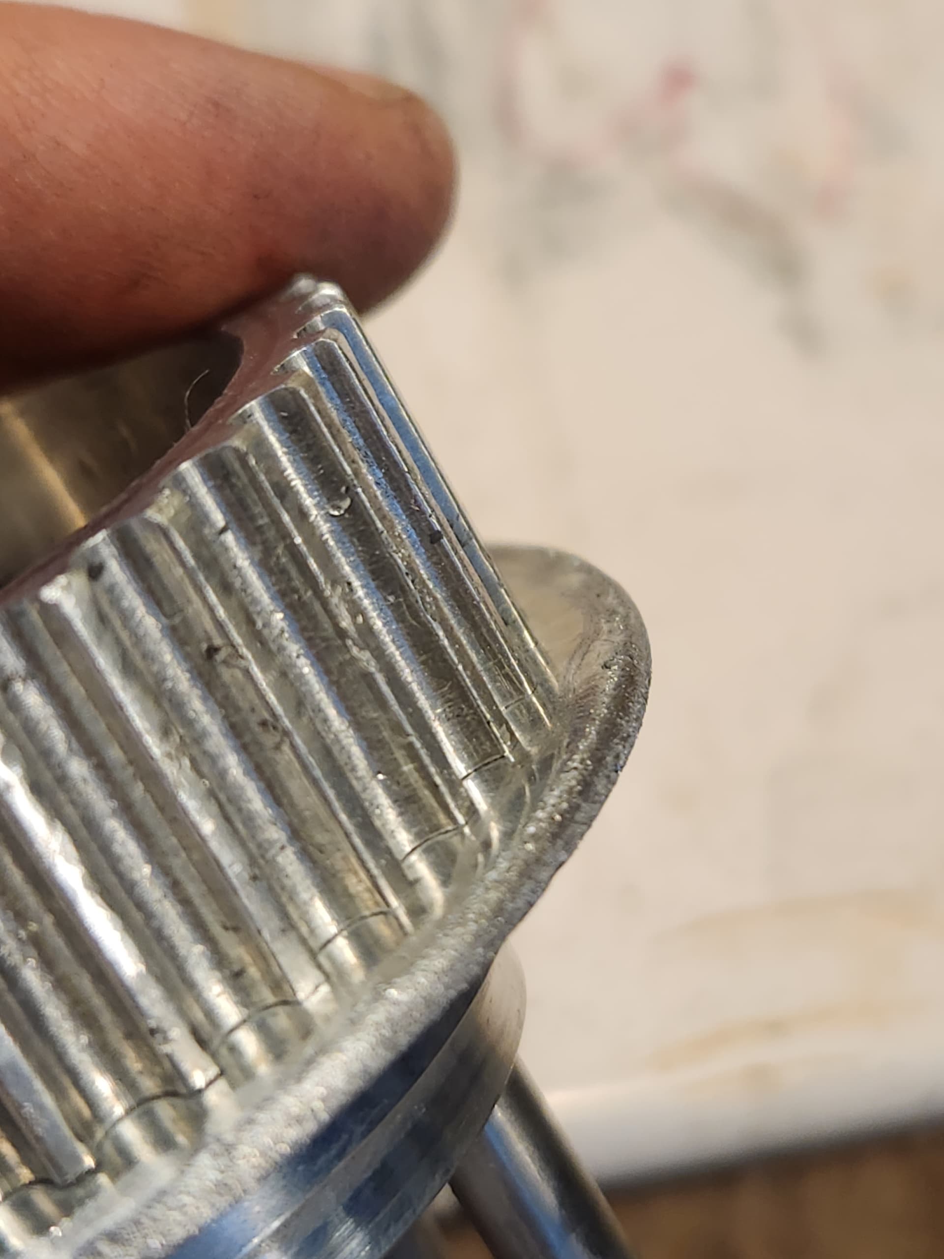

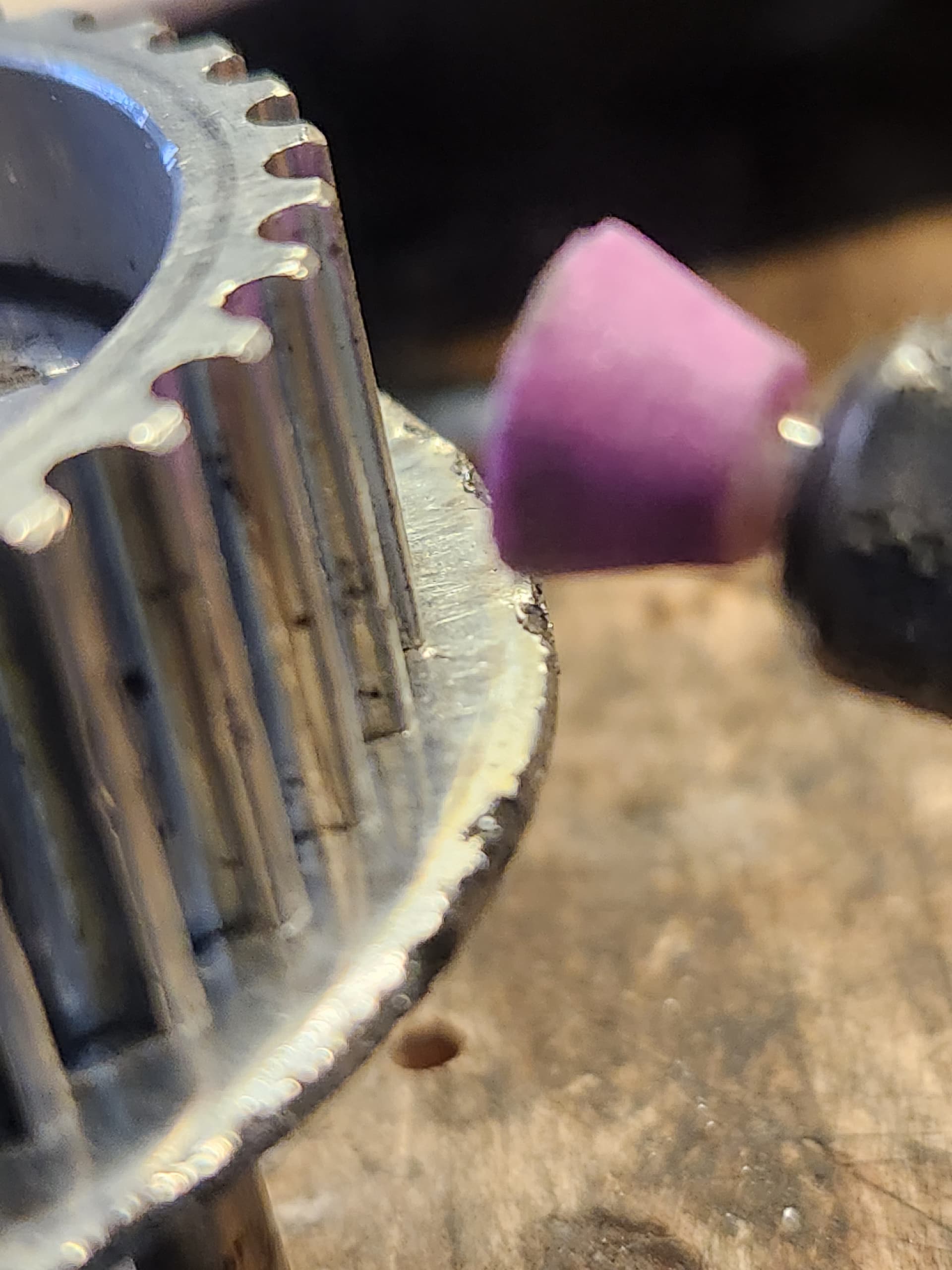

Today I decided to slap the Akashas on the current ATV.

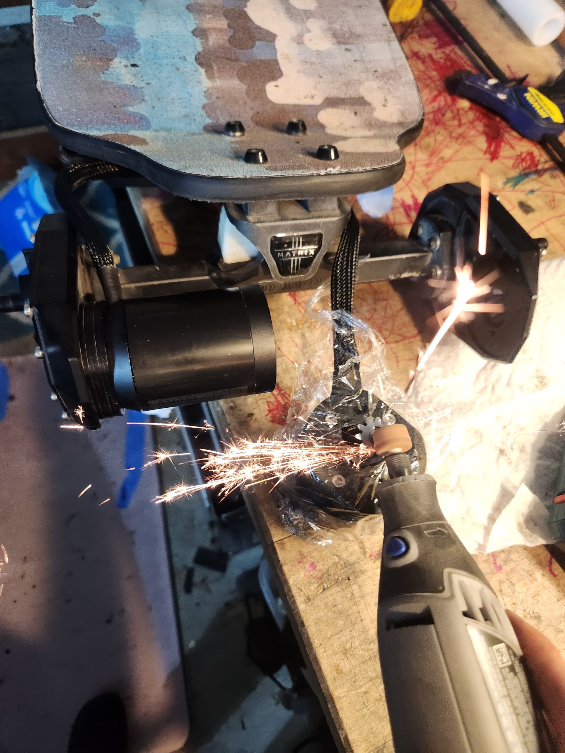

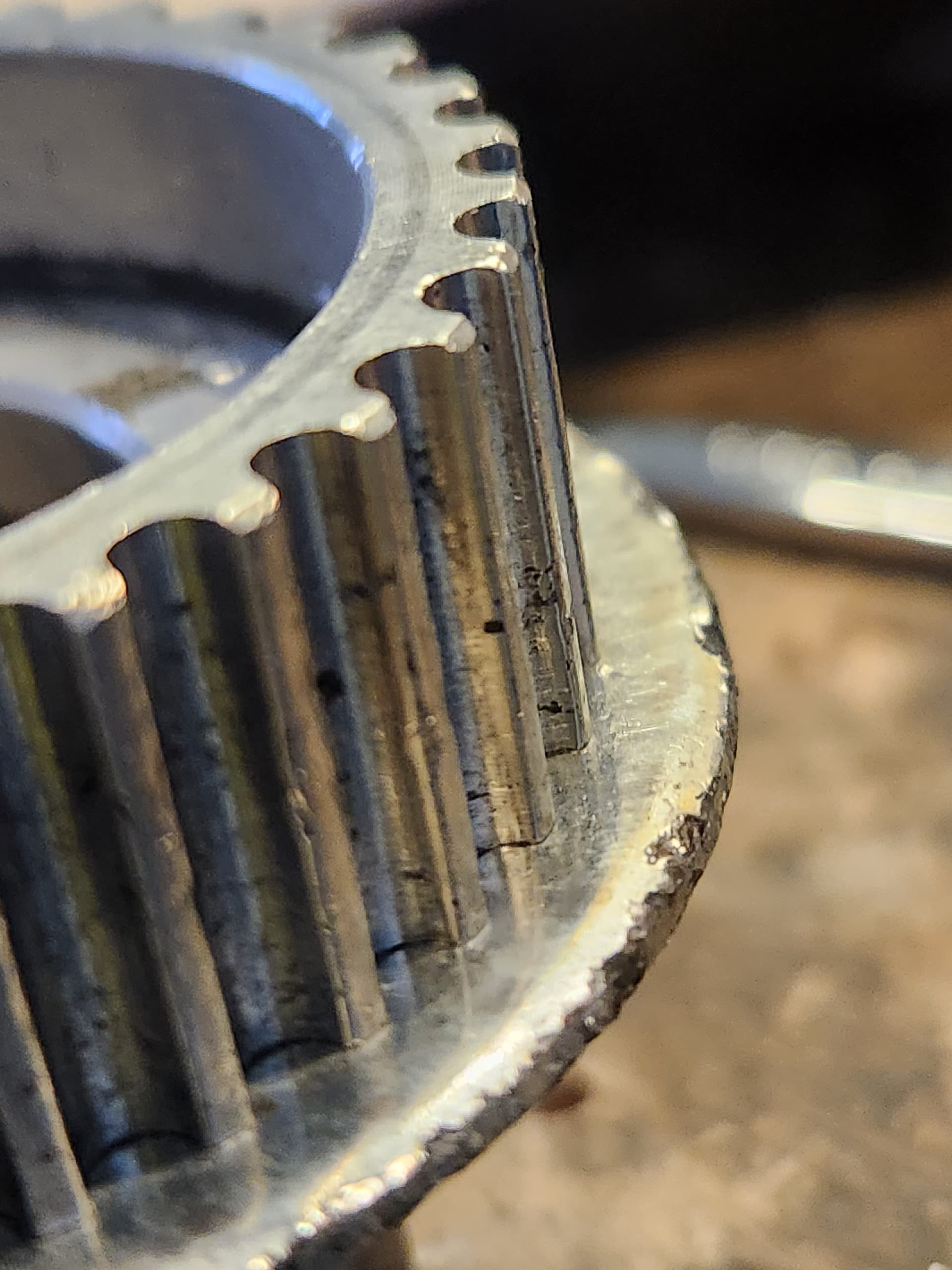

Took a few extra minutes to grind down the rough edges of the pulleys…
And I also knocked the 1/4 inch risers out.

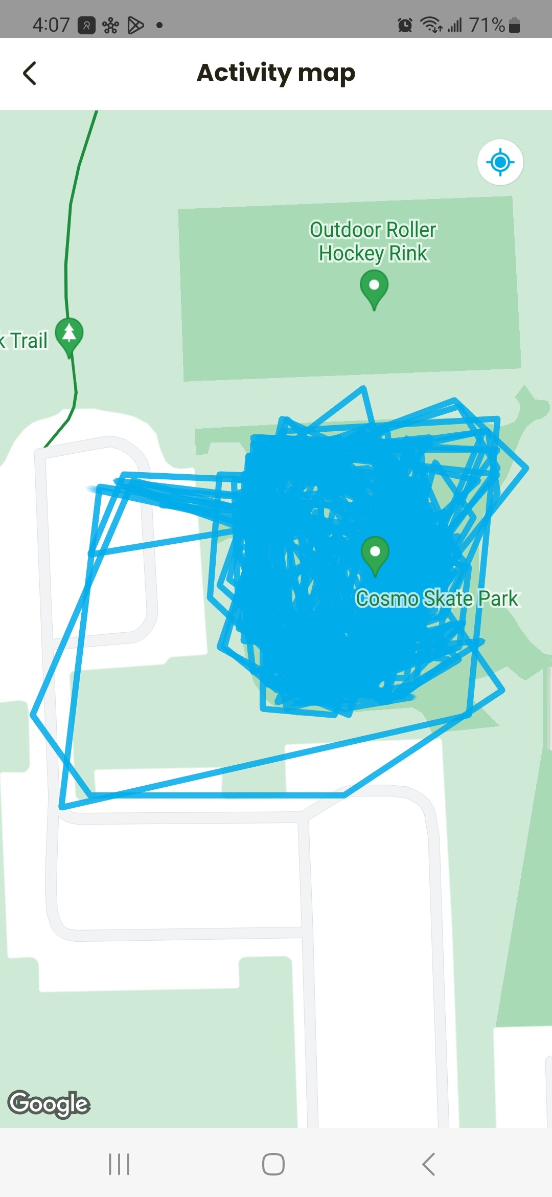

I skated for about 1:15 and Relive tracked 7 miles.

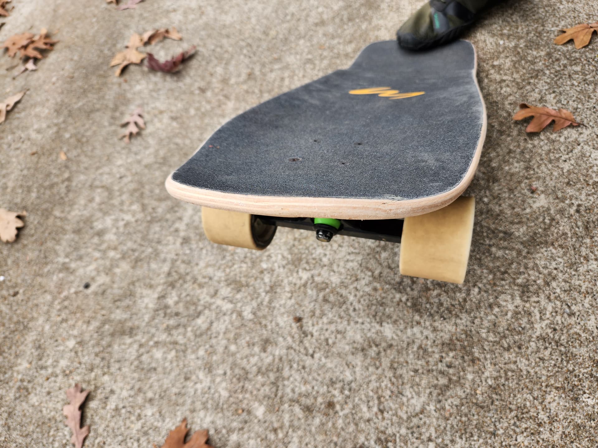

Riding it after the Riptides on the Gravel Boi made me want to make the front looser. So I think I am going to try the White bushings in the center position instead of orange.

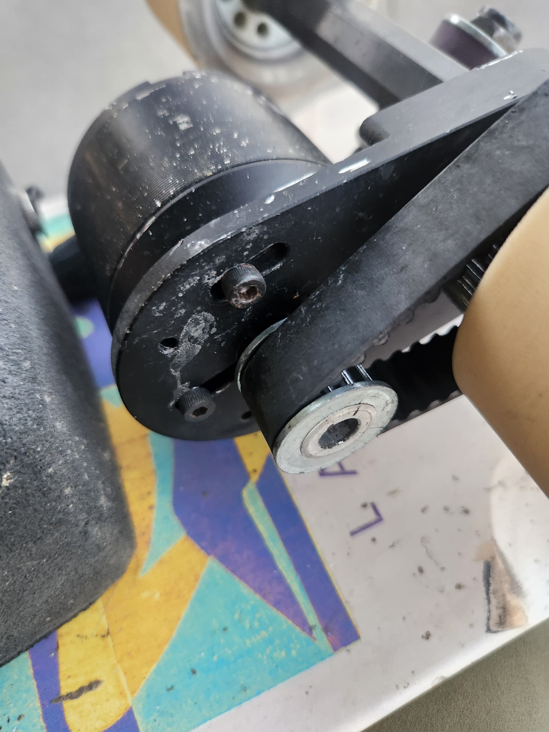

I only got one lap around on the ATV, and the motor pulley came loose…

So later that evening I fixed it with a shinny new steel pulley with a key…
Oh.

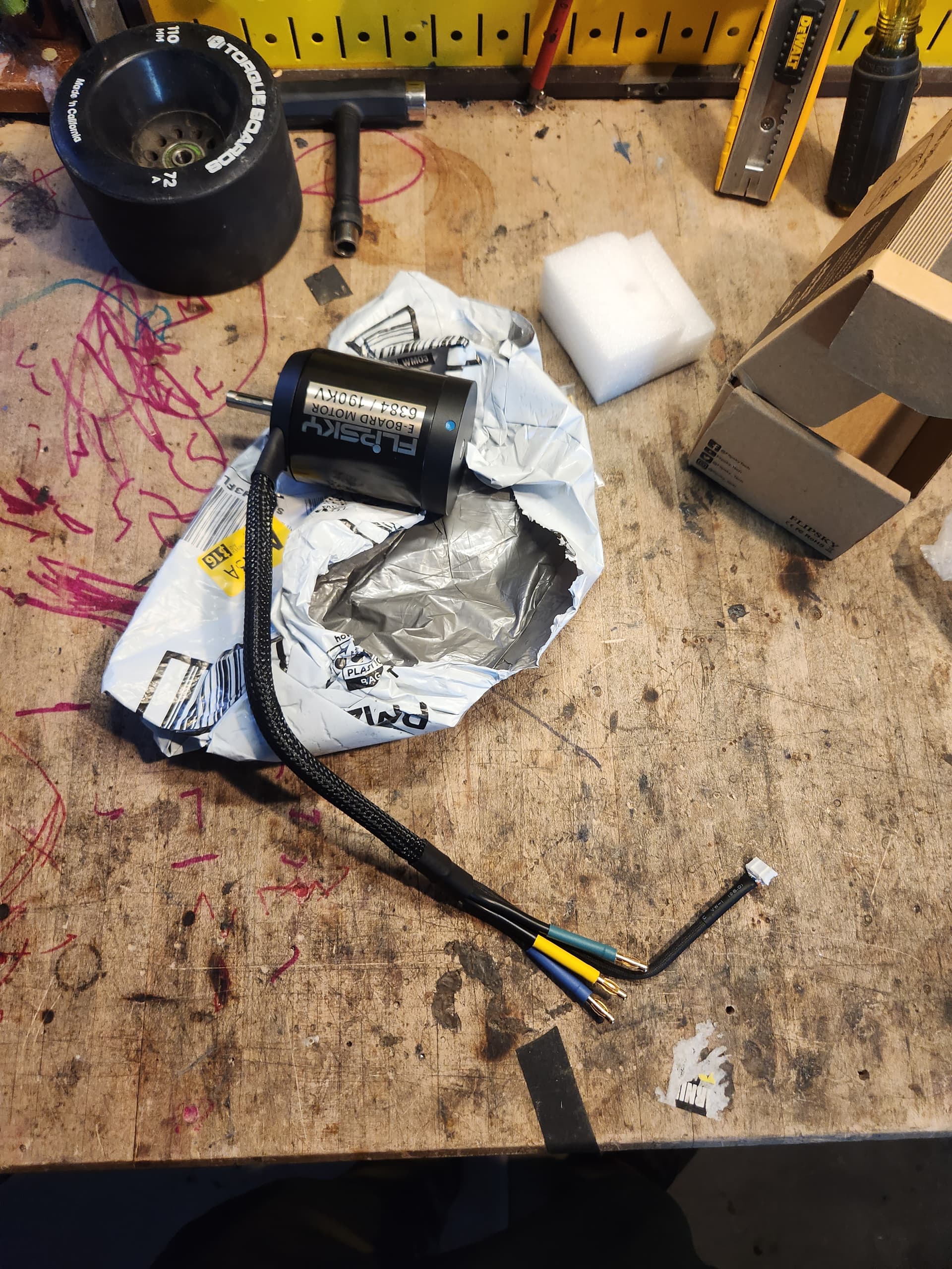

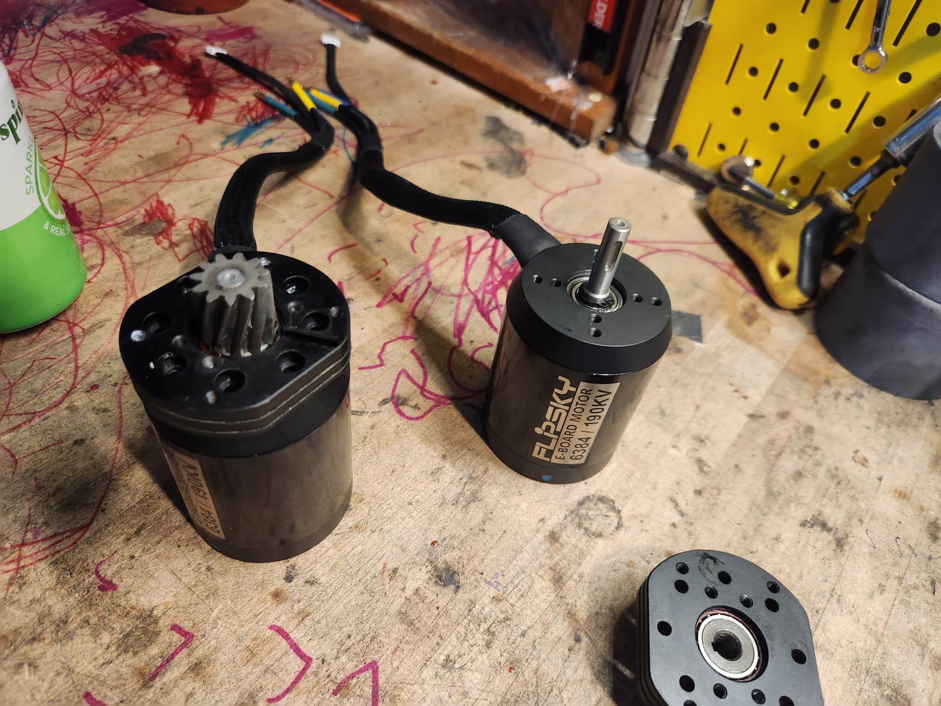

Also the replacement Flipsky Motor showed up.
And the last bit I did for the night was putting the motor plates/pinions on.
I didn’t want to get into soldering last night…
So we are gonna call that a pretty active day.

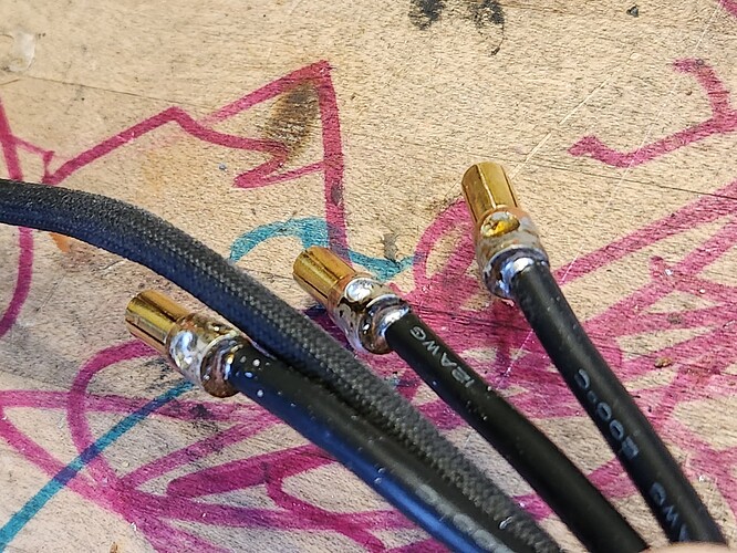

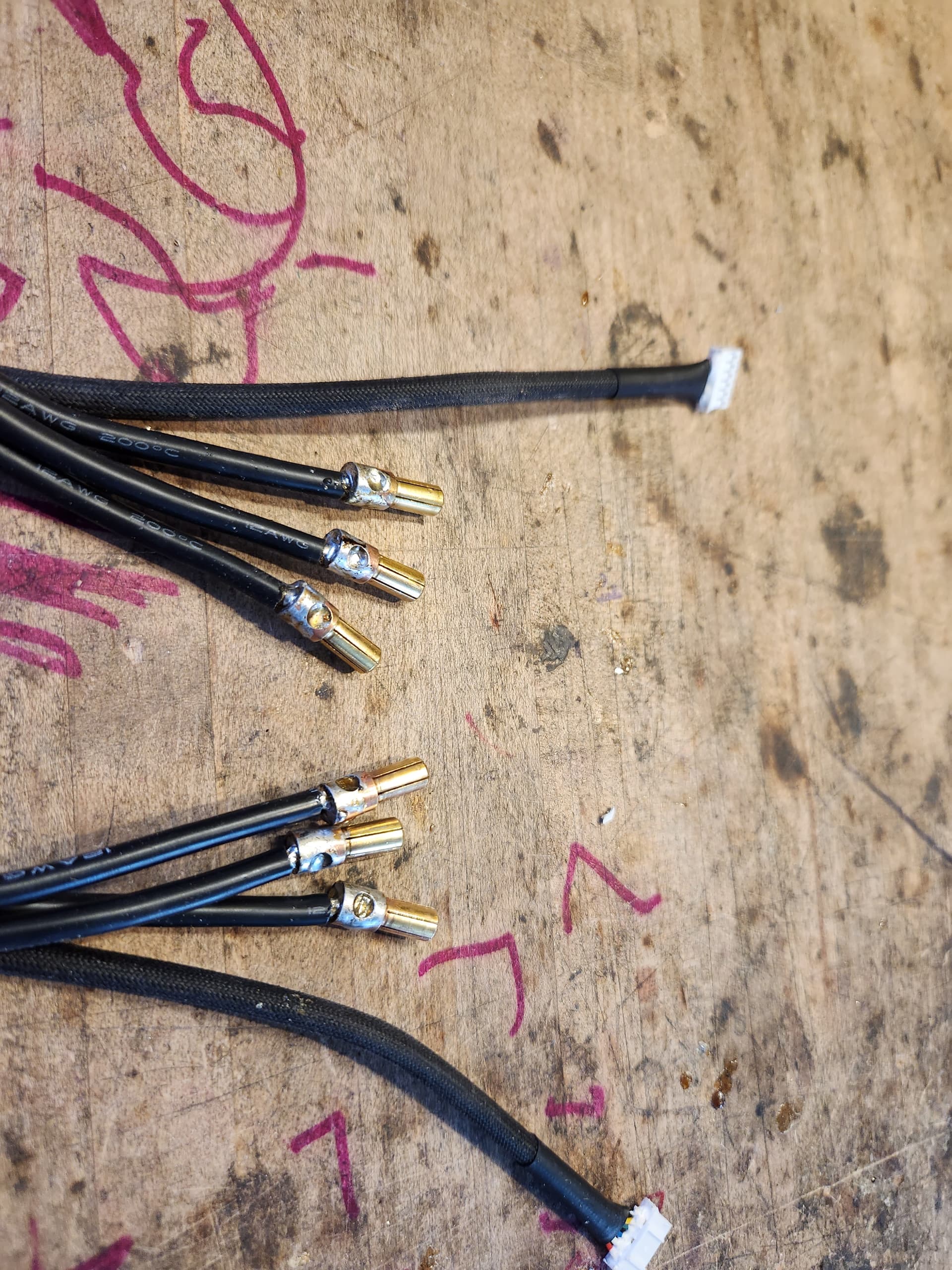

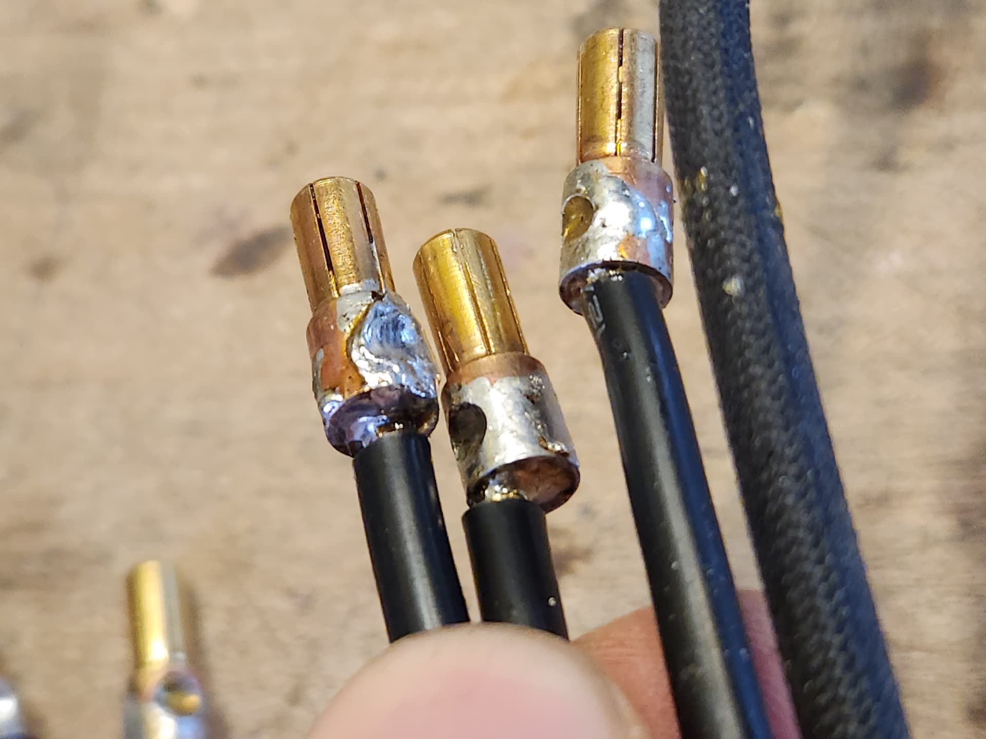

This morning I had some lead fumes for breakfast.
The Flipsky Motors got 5mm bullets, which are a legacy from when the Flux had TB 6380 motors.

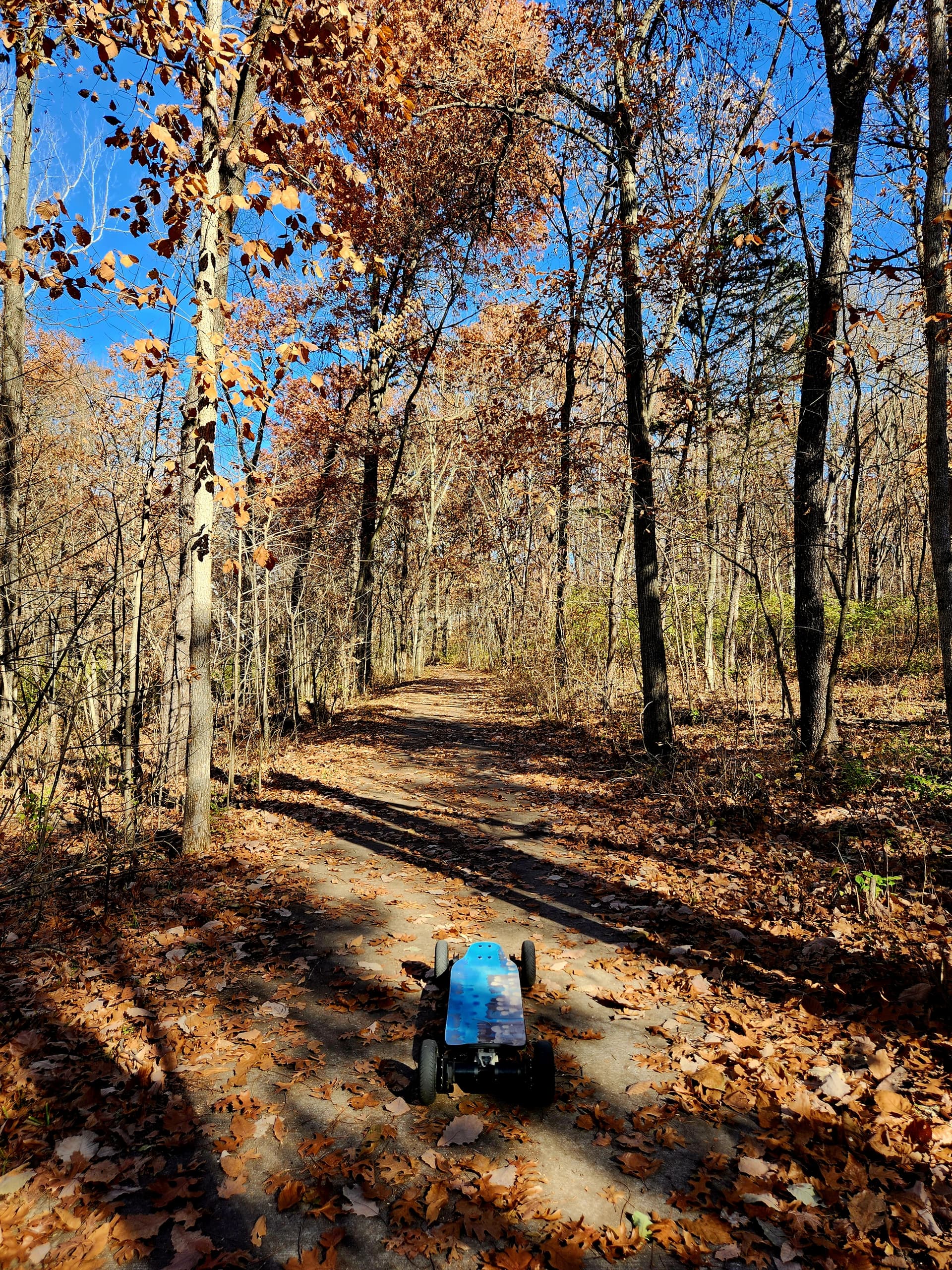

I was not entirely sure what I wanted to go ride at lunch time.
But one of the EUC kids hit me up, and we went riding on the trails…
Which is cool, because it’s super pretty out there.

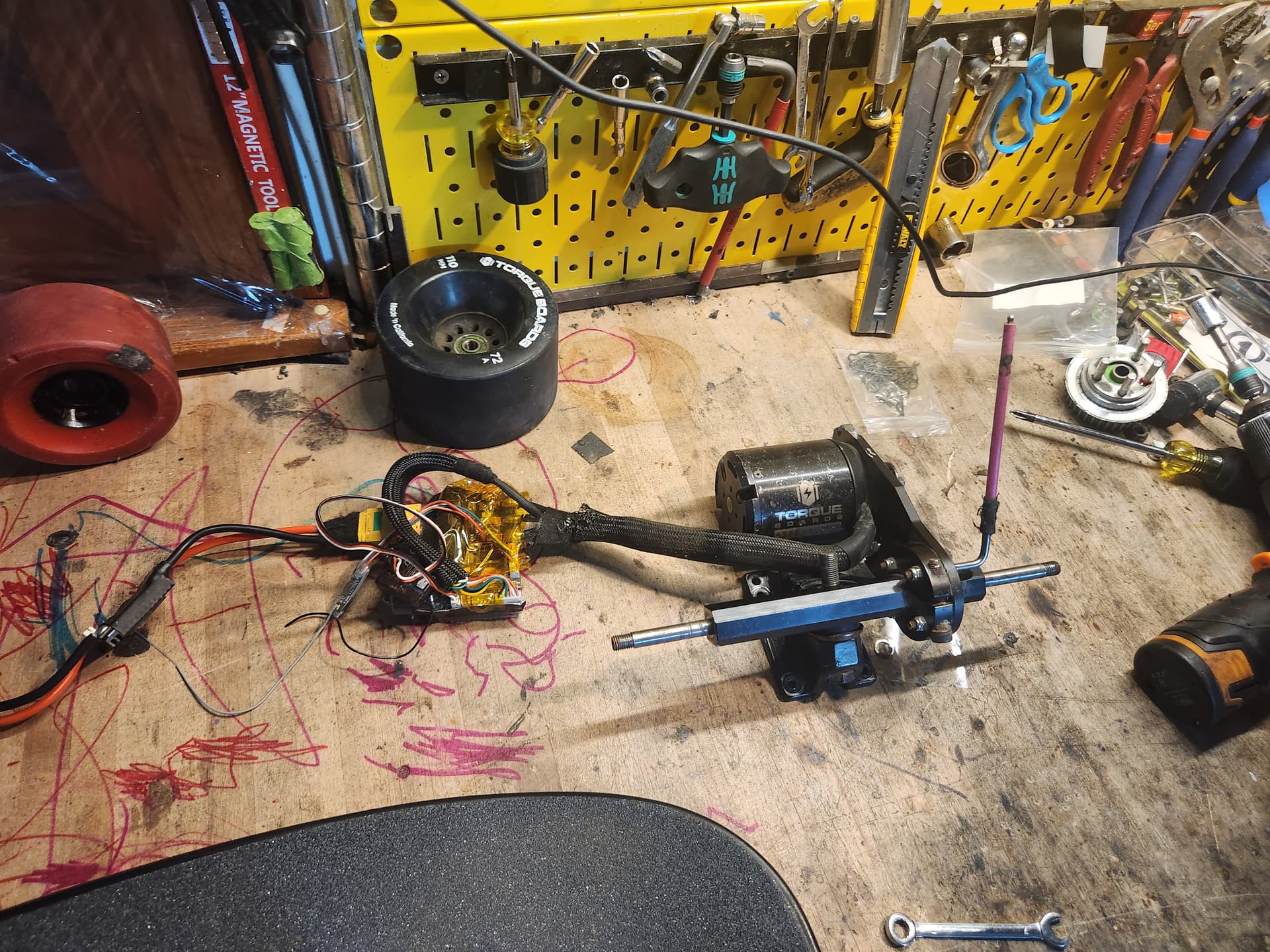

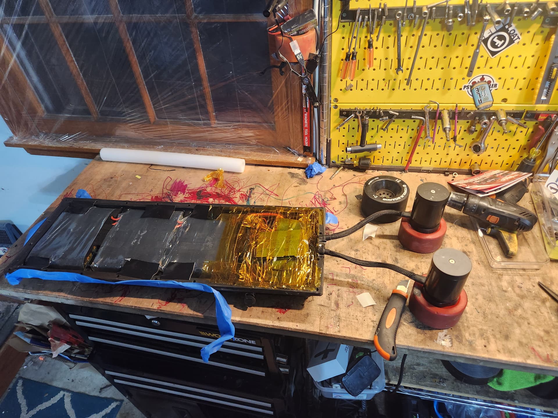

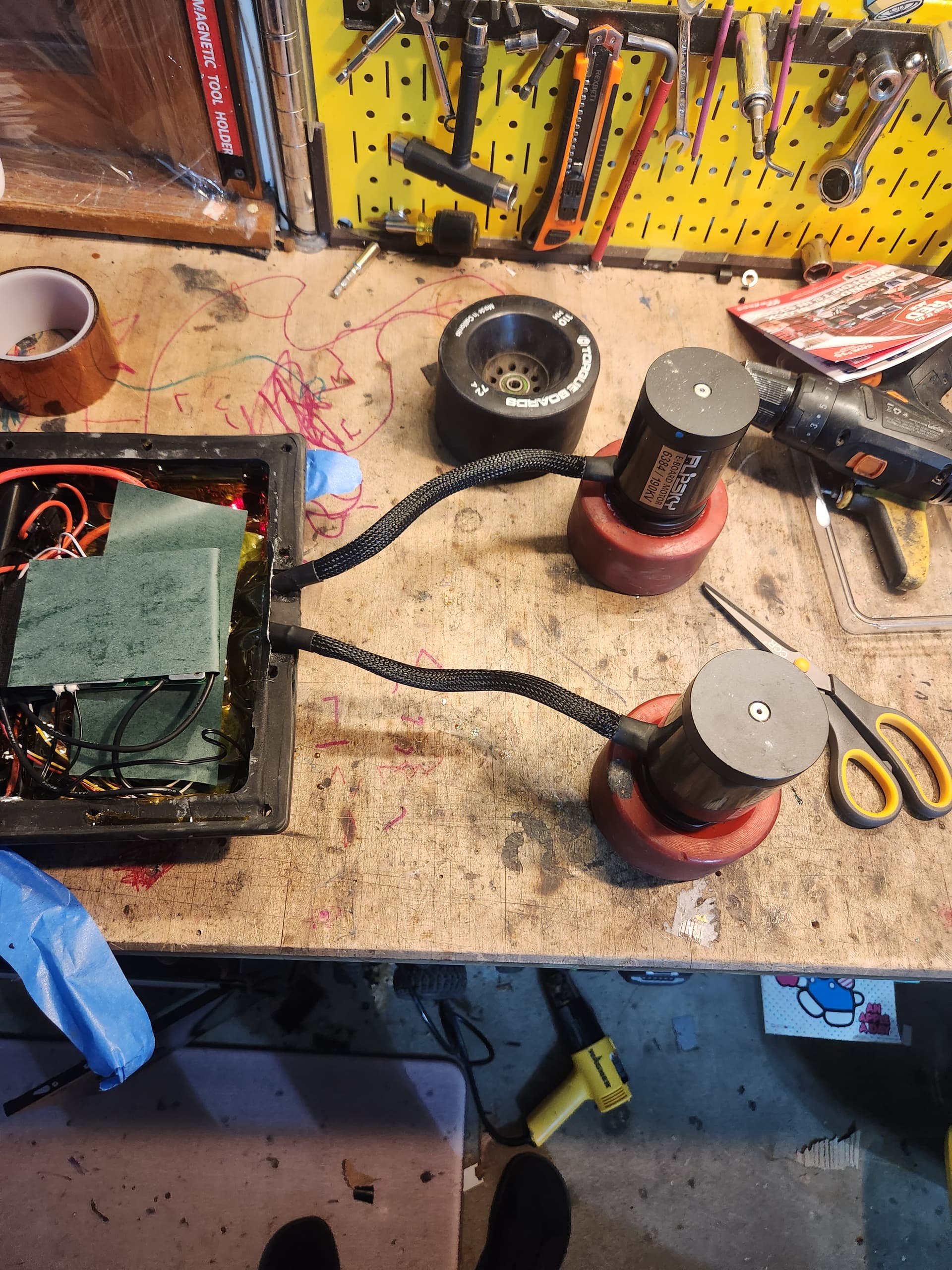

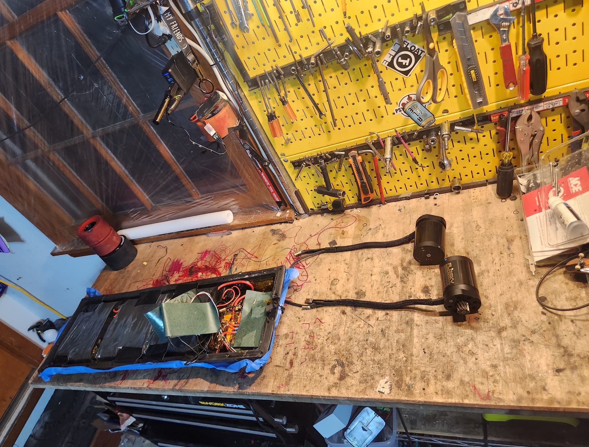

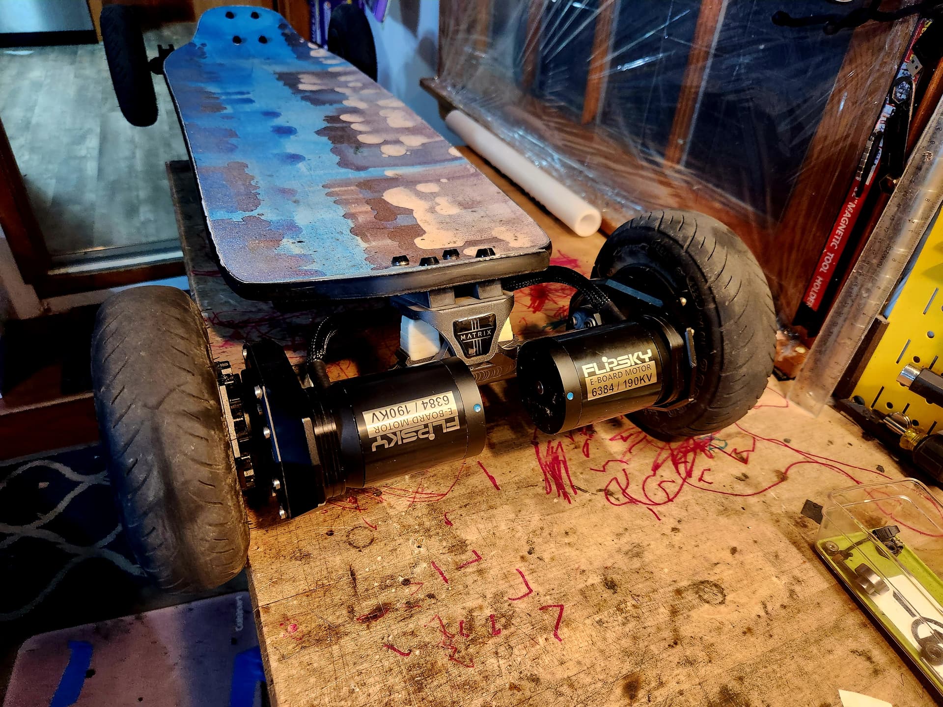

Later in the evening I got back to the Flux.
I have been in this box so many times, I get weird dejavu working in there…
I fired it up, and it came up sensored!!! Hooray.
Then 3ft of Kapton later…

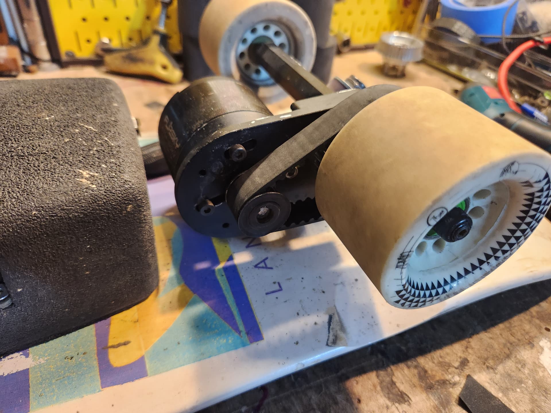

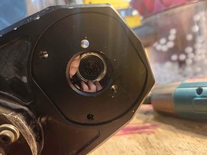

I was so close to home. Just bolt the motors to the drives and the enclosure to the deck and I was gonna go for a ride!!!

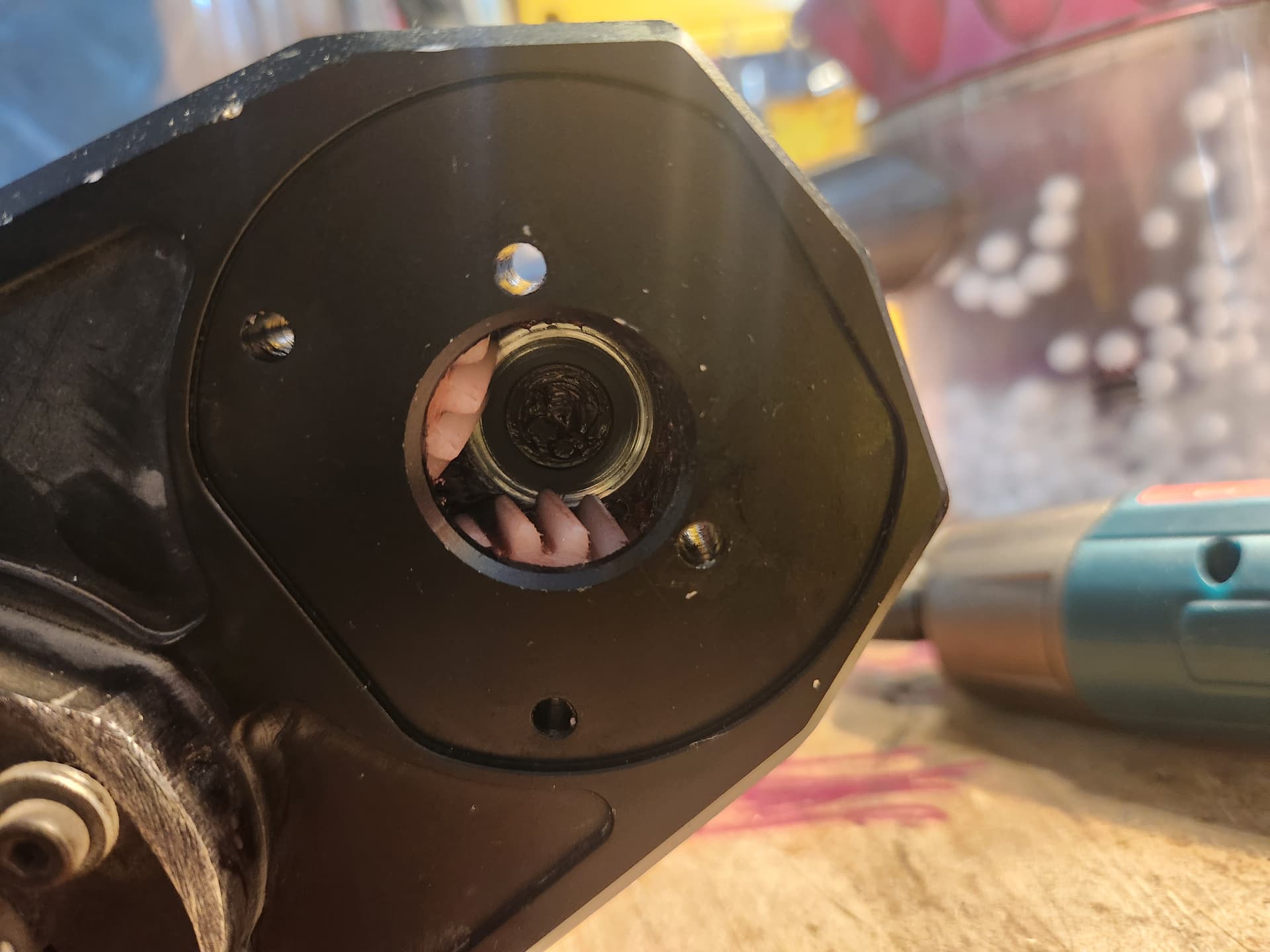

But… One of the drives had heavy resistance when I tightened the 4 bolts that hold the motor plate.
One side was fine…
One side had me stumped.
But seems the pinion was rubbing on the housing.
This was one of those DYI is a disease moments…
So bummed.
Anyhow, after that it was Dremel o’clock.
And that seemed to do the trick to eliminate the resistance.
I really hope these drives run beautifully tomorrow.
But part of me is already thinking I might need to get another set of Radium motor mounts!!!

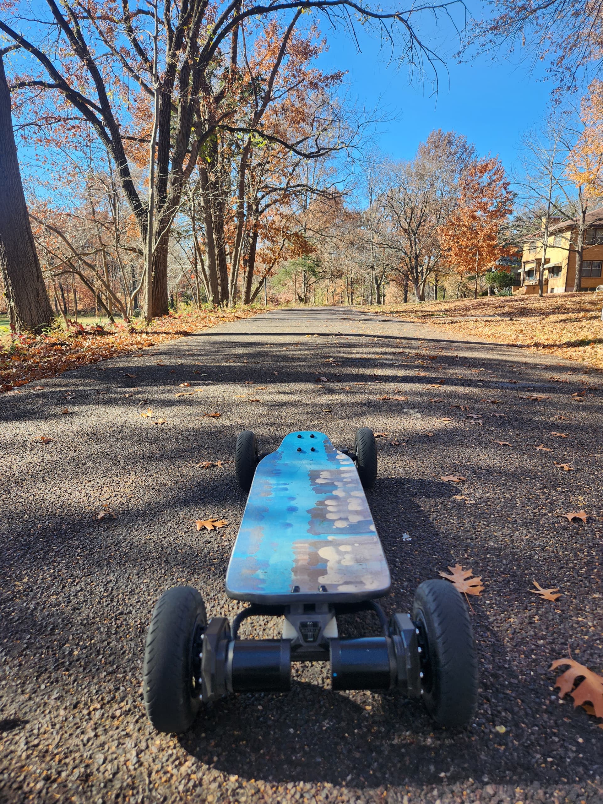

I did a morning warm up run on the GT.
Which is a great way to catch some sunshine.
Then at lunch break I went on the Mayden Voyage of the latest iteration of the Flux with the new Flipsky Motors.
And it’s nice to have a quiet set up again.
The old motors were annoying me so freaking much.
But this ride was glorious and just pure enjoyment.
So much so, that I rode 21.4 miles, which I believe is the longest single ride since I had my neck problems in the spring.
I love this set up!!!

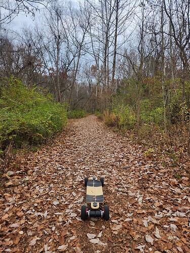

Thursday for lunch break I took the Demonseed to my new favorite trails.
It’s a super fun board for me to ride in this type of setting.
And I continue to be pleased with how well it gets around.

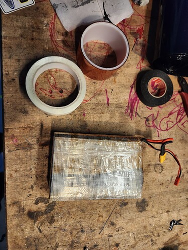

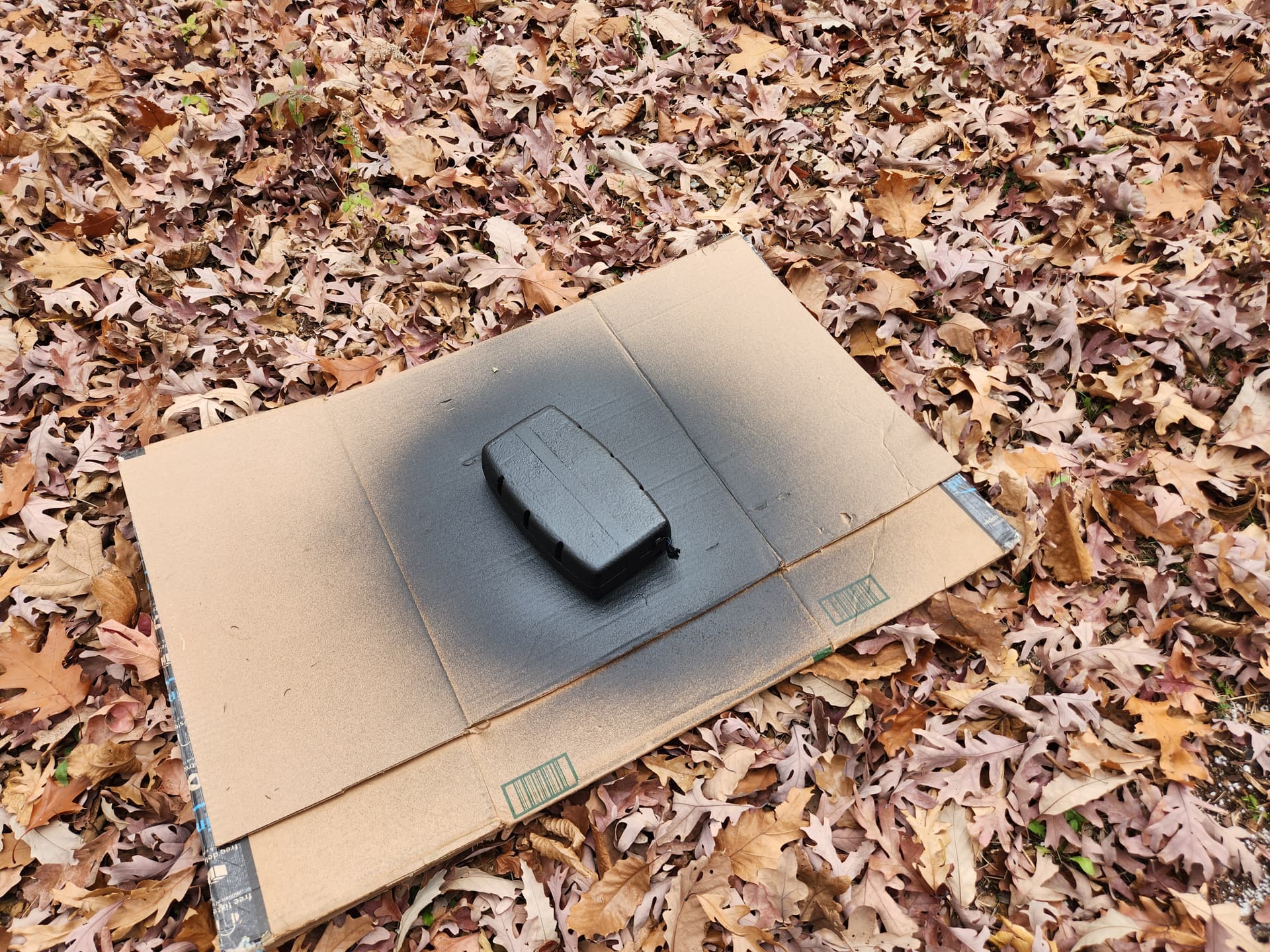

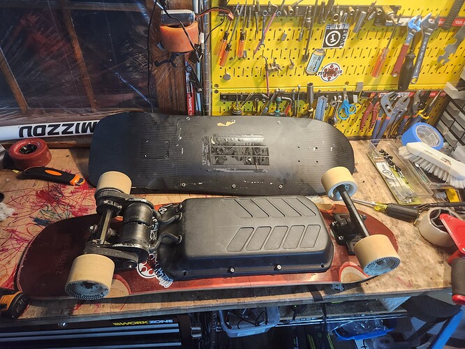

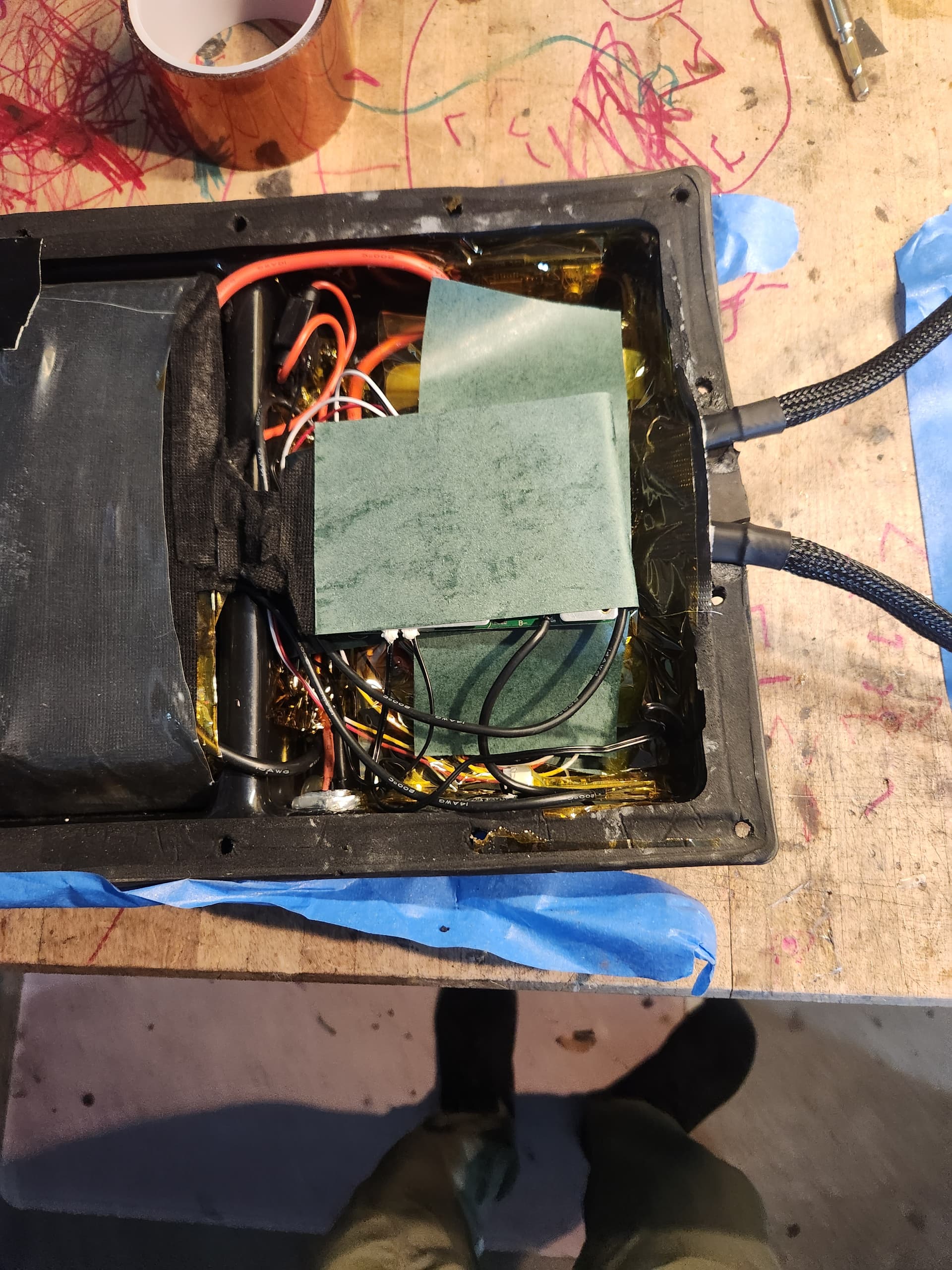

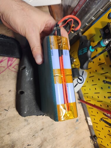

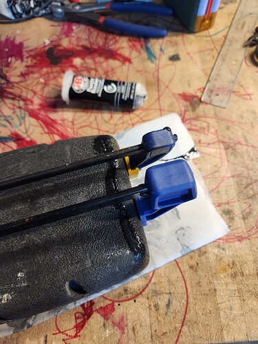

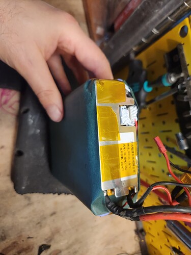

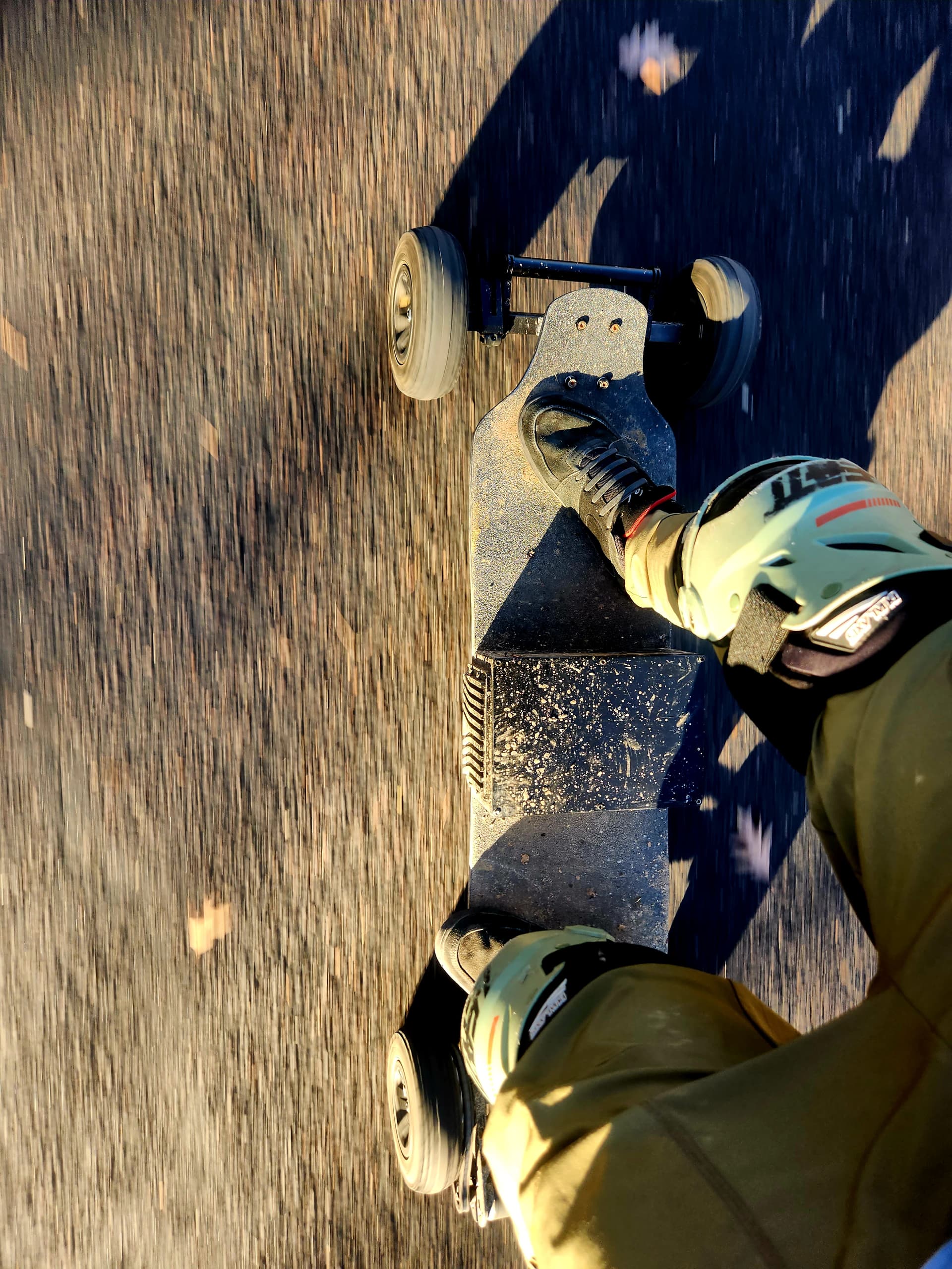

I glanced at it, and saw something slightly off, and realized the enclosure had blown out…
Apparently I didn’t use quite enough gorilla tape on this one…
So then mandatory tinkering had to take place.
I knew I could get this little guy running again fast.
Plastic binder and Tesa tape were the bandaids of choice.

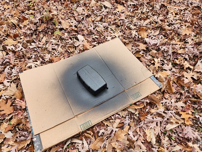

This little printed box has been great.
I hit it with some truck bed liner.
I love that stuff. But sometimes I screw it up. And and this was one of those times…
Oh well, it can’t possibly be very long before I break this board again…
I taped the battery down to the deck a whole lot…
And used Butyl Tape as a gasket/cement for the enclosure.
I didn’t take the battery apart. But it looks good.
Still charges to 41.7.
So I just taped it up.
Taped it down.
Back in action in record time.

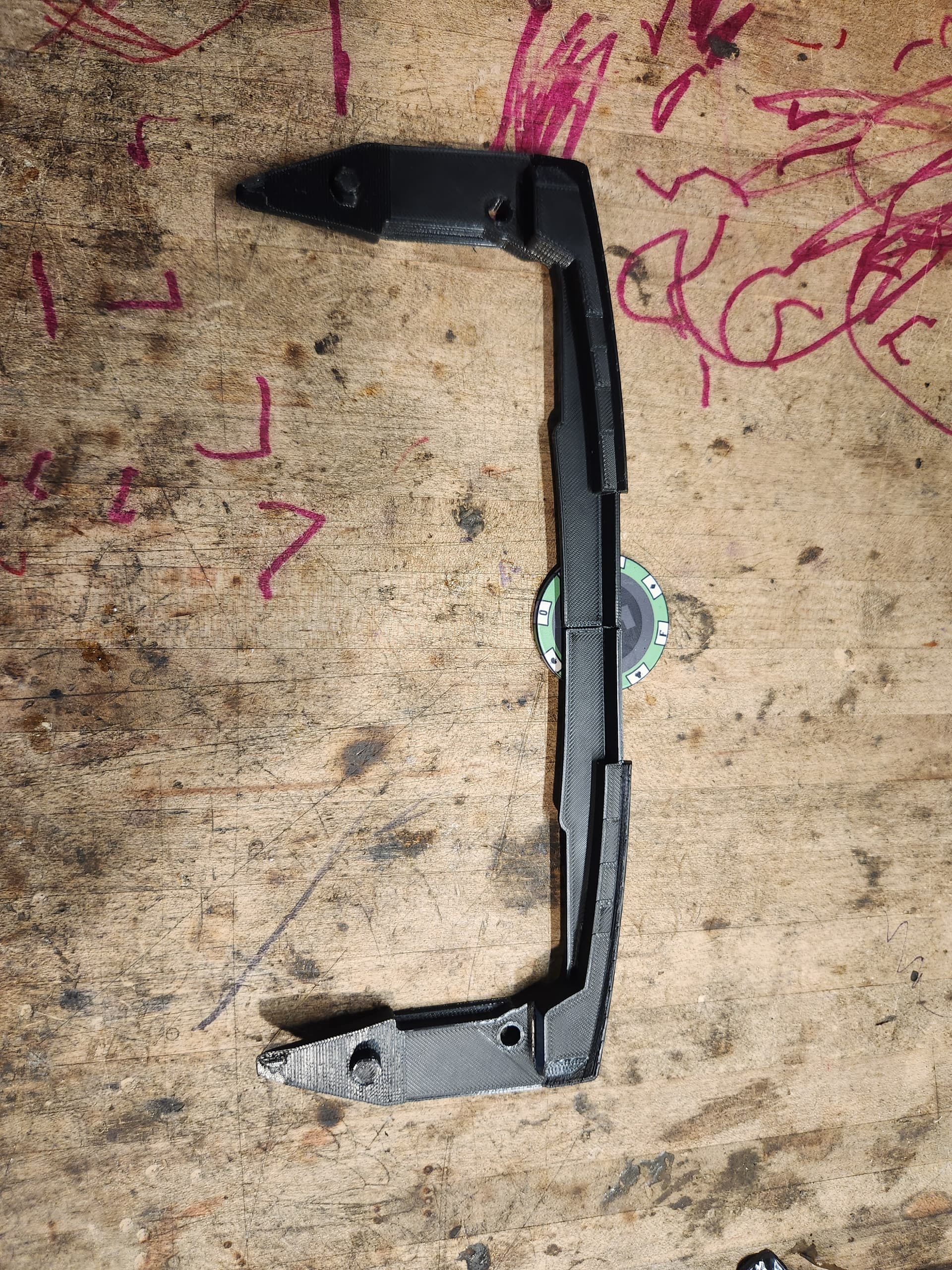

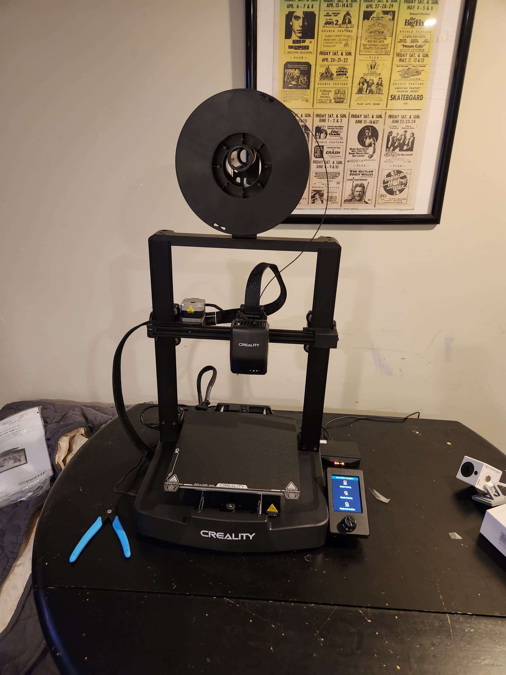

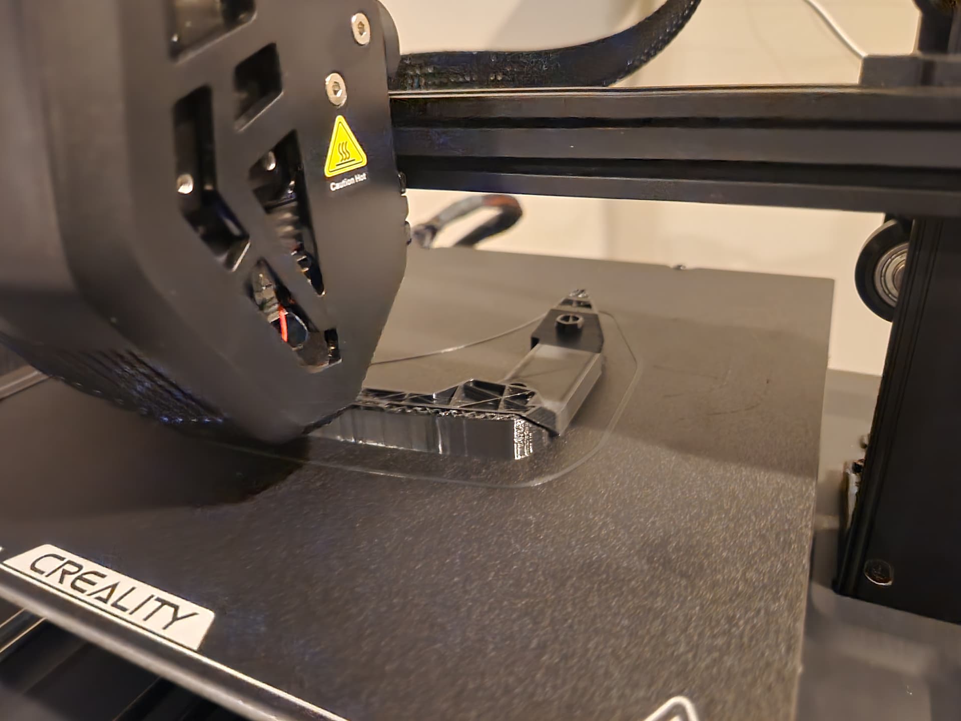

I finally jumped on the 3D printer bandwagon.
I got an Ender V3 SE.
I wanted to Bambu P1S.
But the 200 bucks for the Ender was a lot easier to swallow.
I basically got it to make these shims for my new fancy fender for the GT.
And it worked for that!!!
