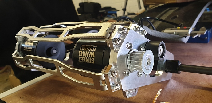

Evolve motor mounts have been solid for me. Old pic but closest I could find without going downstairs and taking a photo.
Sorry, I’m not on matrix. Im using street carvers with unik mounts
