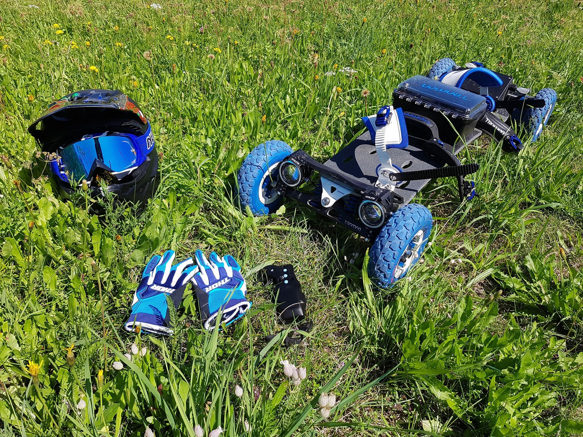

So had my first testride with the GT2B
Everything was fine but later when riding i noticed a stuttering on my VESC at around 60-70% throttle… I never had this on my maytech remote.
I recorded it with metr app - it is here around the last 3-5 minutes or so of the recording
Any ideas ?
Other than that - it was a nice ride…
Overheated or saturated motors? They were over 100C at some point.
@taz
Well it’s possible because I added motor protection covers (which are very needed at the mountain trails)
I thought below 110C shouldn’t affect the performance… maybe I was wrong?
No idea. It depends on the magnets the motor has among other things.
I never run my sealed maytech this hot though.
The vesc starts throttling them at less than 85C.
Yeah 85 is the limit, you might want to think of a cover that attaches elsewhere and allows those motors to breath?
Good to know… ok I might have to redesign the covers then :frowning:
Trying this new design… if this still gets too hot I have to think of an overall solution to protect the bottom and keep the motor without covers.
Ok screw that…
I will go for this solution
I will try to make a black cover for the top so that it will look nicer
Covers fitted
Just to let you know, the motors will get hot even like that.
This has always been my problem, overheating motors no matter what I do.
Well now with the motor covers removed I and the bottom protection I think it should be fine… i never had any issues before I put on the PLA Covers.
