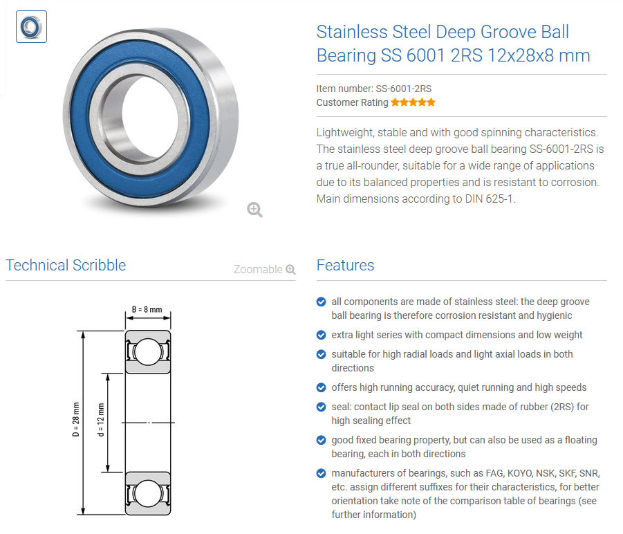

Looking for some replacement bearings…
What you guys think about those:
