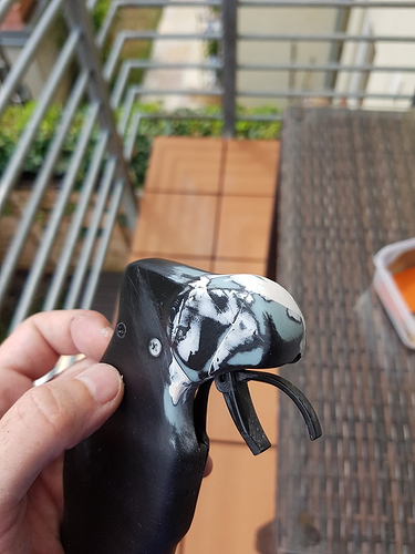

Had a small crash today and my GT2B broke and I lost a couple of parts of the case
But since I was unlucky already today with my portable charger I decided to not give up on this one…
grafik
Haha fantastic! Well done mate. Any more plans for this board?
@Lee_Wright
Well… not really - finetuning and getting the hang of it mainly…
I am happy with everything as it is now… My main concern was the damage I suffer when going on rocky mountain trails but the bottom cover that I made today now protects me very well…
So just need to repair my portable charger and do some tweaks here and there and be a happy camper
