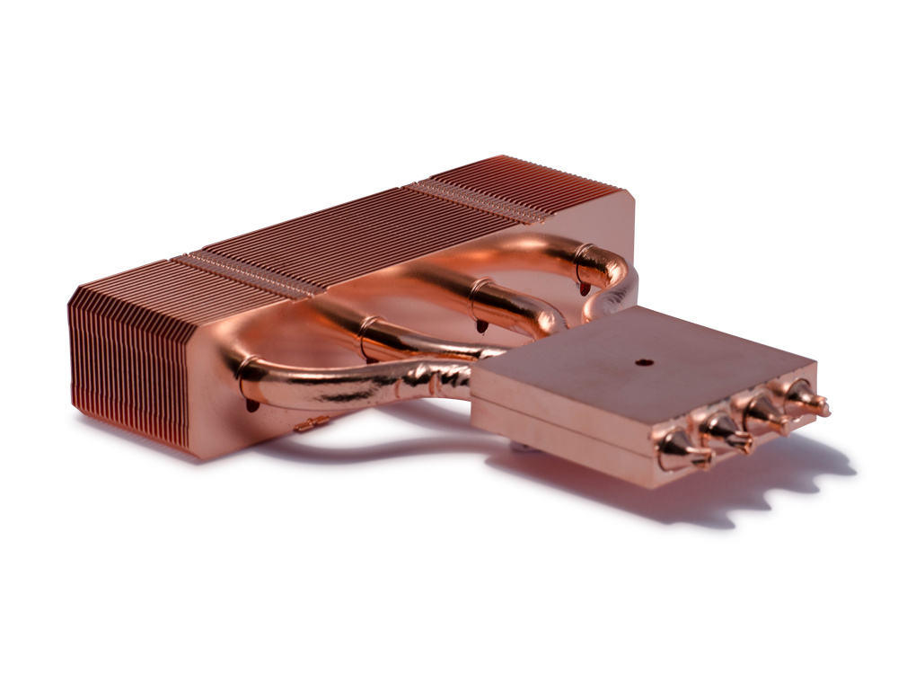

thats why a thin pad between motor and mount, to move the heat to a sink, seems like the best method to me. something like this
as thin as possible to accomodate pipes, and then you can heatsink anything you want. has to be thin interface so you dont lose a bunch of shaft length…

Keep in mind that heatpipes and heatsinks need a certain temperature differential to effectively move heat energy.
If the mounting plate of the motor is not getting more than a few degrees above ambient then there just wont be much heat transfer no matter how big of a heatsink you install.
