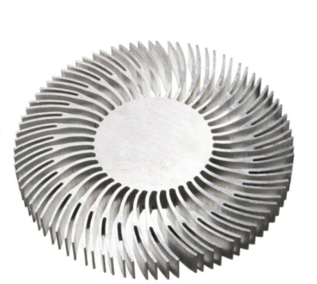

M Diy approach would be taking some generic heatsink , getting it red hot and wrapping it around a pipe. So two halves at a time. shave some fins off for mounting/gripping.

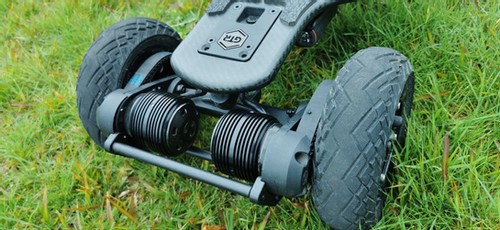

I definitely have been. I have gearing for 45mph and my little maytech 6374s get hot as hell (80c) and then start acting funny (no mo towk) that’s why I bring it up. I needs to keep up with the local Onyx employees
Good point. My initial test manufacturing method would require the two halves solution.
A single sleeve is much nicer for balancing.
That’s interesting. I think I’ll start my polishing up the interfaces on the mount//stator and making sure I get nice thermal flow.
Aluminum quickly goes from solid to puddle. I don’t think it would be easy to heat it up enough to soften it for bending without it melting.
THAT would be an interesting test to do!

How true is it that it’s the can vs stator that gets hot? @Battery_Mooch @RyEnd. Is this from experience or just what you’ve heard?
The stator is where all the heat is generated. With mostly nothing but air (a poor conductor) gap between the rotor and stator, most of the heat is transferred through the shaft/motor-face/motor-plate.
right right. I understand that part. Im just asking ā€œwhats your sourceā€ Im not saying your wrong. Im just trying to really verify this info.
So, if you think about it, where would the heat from the rotor come from? It’s just spinning through the air on a bearing. Current is only flowing through the windings in the stator in order to generate the magnetic field to spin the rotor, some of that energy is lost as heat, produced from the windings themselves.
So youre reasoning it? Ok totally fair. I tend to agree intuitively. I always like to know where my info is coming from is all! please dont take it personally.
It makes sense what youre saying. and Im no power engineer. But in Microwave (not for food, think 5g) engineering losses can occur in the dielectric (air in this case). Not to account for eddy current, hysterises losses, stray loss and what not. stray losses are literally parts of the EM not going to force, but directly heating the surrounding metal (think microwave, this time food kind)
Ill read a few sources and get back to you. Sorry to doubt you, please dont take it personally.
http://www.icrepq.com/PONENCIAS/4.320.ANDRADA.pdf
I’m just simplifying. The vast majority of heat is generated in this way.
6061 T0 with a thin motor interface less than 2mm would be easy enough to bend

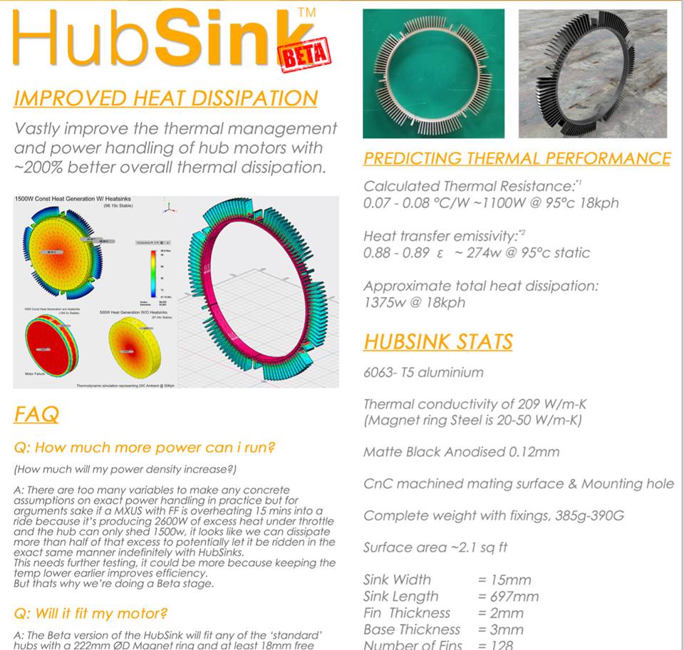

This exists for bike hubs already and turbulent airflow has been found to be more effective at heat dissipation than laminar. I’ve got a set of HubSinks I’m installing in my bike today, one of the big issues and one that can be solved in a sealed hub is the air gap by filling with a ferrofluid, in esk8 that’s not really possible, we don’t have motors completely sealed.
https://hubsink.com/
stator gets HOT… all my DDs I’ve added artic sliver thermal paste on the axle/stator interface…
I haven’t scienced it… because of the awful thermal filtering on FW5.01, but they feel cooler…

Their science is reasonable but that 18°C difference is in the stator? Or the surface? Makes a big difference. :slightly_smiling_face:

Now I want to try something like this:, but flatter (3mm) and with holes such that it fits between motor and mount
That looks KooL… but I’d rather have 6mm more motor diameter than 6mm of fins…
that’s just my way
