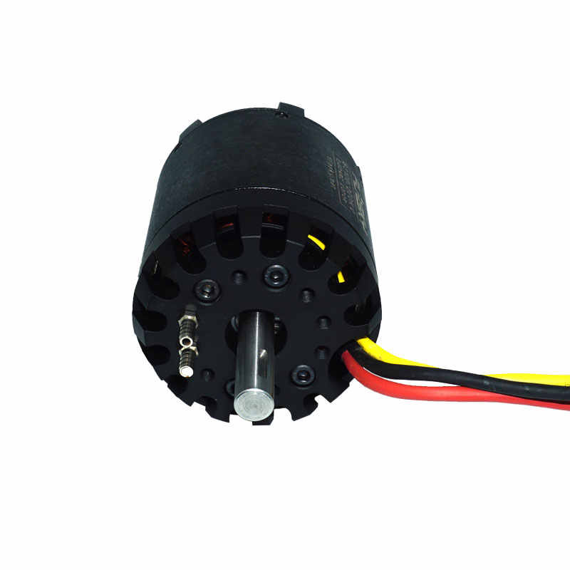

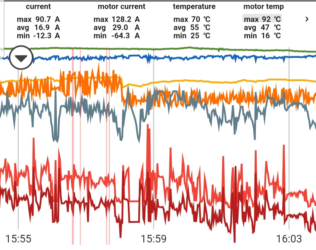

Lol my motors run hot AF right now. LIke 80C. should be enough seeing as ambient is maybe half that even here in socal summer

If your stators are overheating you probably should go to the next larger size of motor or go with an open motor rather than sealed.
Overheating a motor will wear it out just as much as dirt and dust.
Heatpipes contain a low boiling point liquid so yea leaks destroy them.
Yes, I already have 6384 on order.
I am moving from 6374 open to 6384 sealed. I ā€œneedā€ sealed because of dirt and dust on trails around here.
Something else to keep in mind is gearing and phase current. Heat in the stator increases with the square of stator current. So if you can sacrifice some top speed to have lower torque while accelerating you wont need a novel cooling solution.
