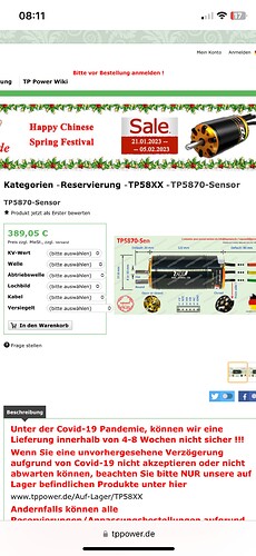

Anybody has experiences with TPpower motors?
Are they good?

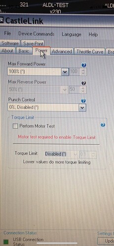

Yes the settings are done like in the stooge setups in general but i lowered the input voltage setting (it only says low medium and high there are no exact numbers tht can be selected)
Yes, they are good.
Low the battery current setting. What is it set to?
Current, not voltage.

There are no currents shown in the castle escs for the battery. Only the motor has current settings with real current values.
In the castle escs it looks like tht.
