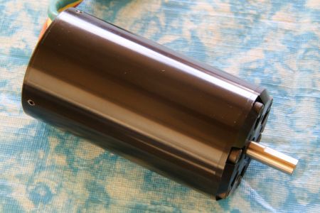

Hy guys!!
May i ask you a question regarding a inrunner setup from a friend of mine which isnt running and we want to figure out why.
I thought youre all pretty good in knowledge on those setups maybe you can give us a hint. The setup is the following:
Mamba xlx
Sss340kv 56114 inrunner
8s2p 12000mah 30c lipo
10/30 gear ratio
160mm wheels
The motor is spinning well with no load on it but it cuts out when you stand on the board.
So my guess is tht the low kv inrunner needs much more Volts to run and thts just not delivered/possible by the battery and esc.
this is the motor:
thank you all very much!!
