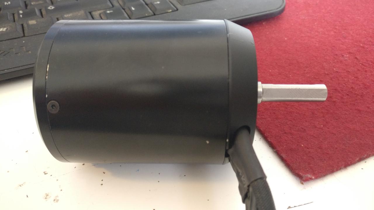

Fuck these, sealed maytech 6374

The sealed Maytech 6374 for me, the bell always ends up slipping on the axle.

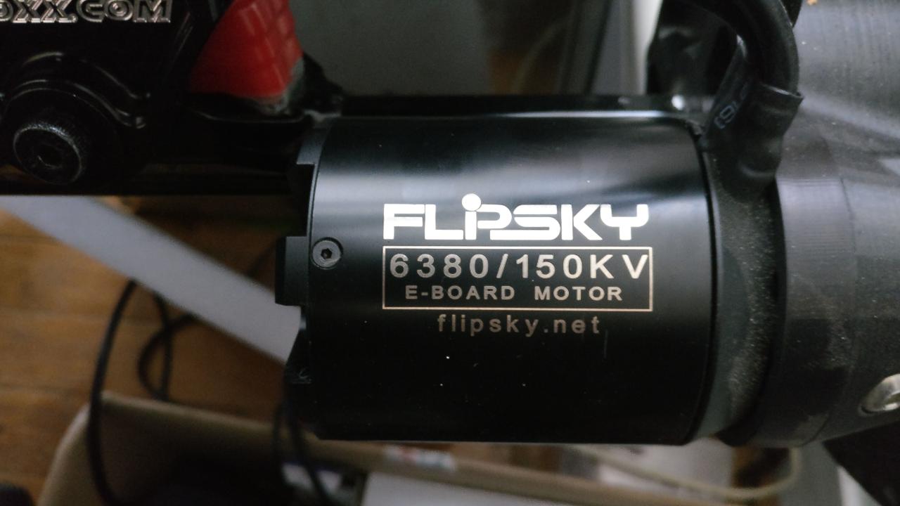

I order Flipsky motor in summer 2018 to use on my DarthVapor MTB setup.
It wasn’t easy, I ask some customs/modifications and they always “yes we can”, “of course”, “no problem”, “this is ok”, “easy” etc. etc. during a long time.
Once I have paid, hahahahahah you see it coming ?! They can’t do half that I have requested… Ok … I take a breath and I accept being fooled. I need >160kV motors asap anyway… so let’s see (the price is reasonable for customs motors anyway).
Then after the 1st little cruise around the block, I got some unknown sound coming …
2nd cruise after checking all screw etc. it even worst.
magnet lose already, just by a cruise on road with 200mm pneumies …! ARG.

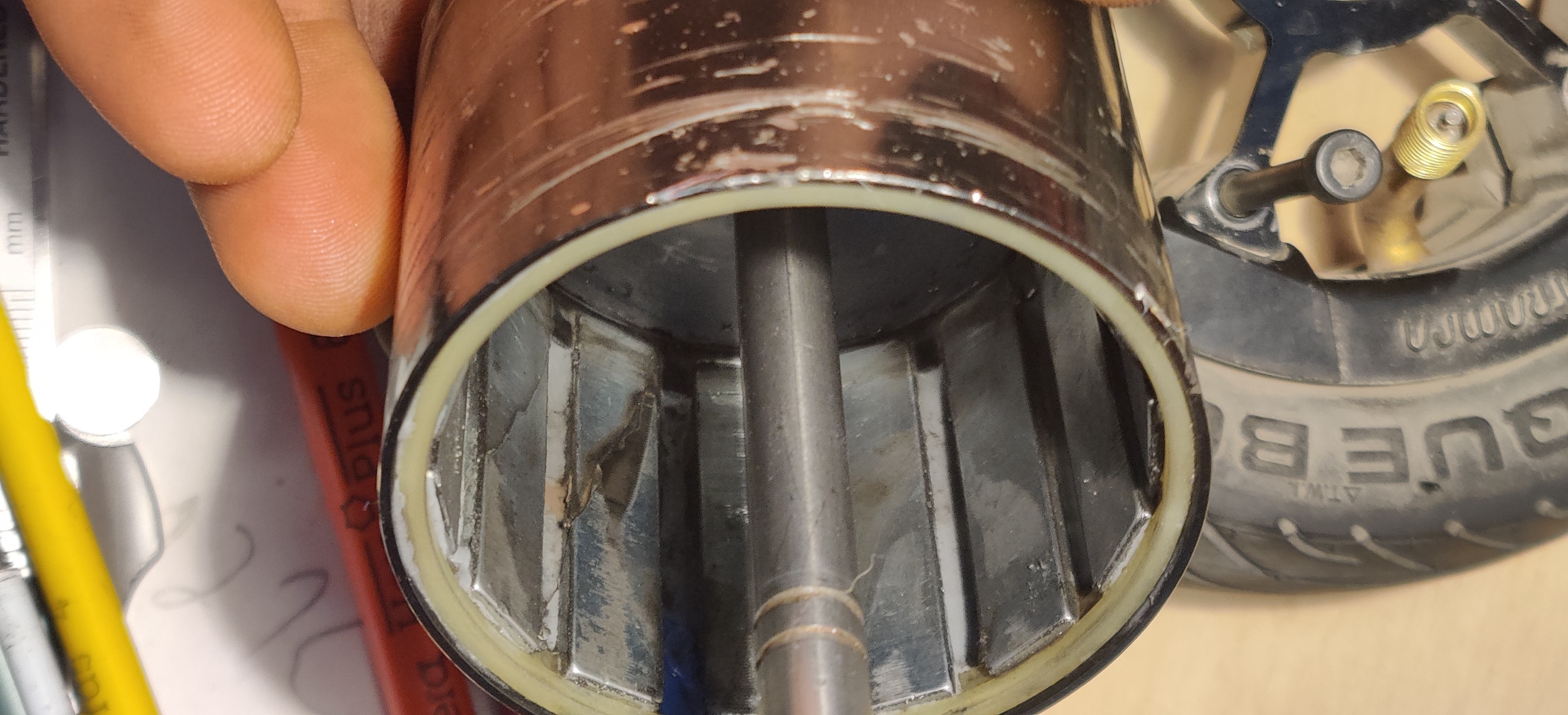

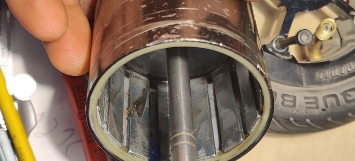

I decide to take these motors laying around for a year or so : FlipSky 6380 150kV for a quick build with stuff who sleep in boxes and collect dust…
Yeah, you see it coming again, and before myself ^^ 3rd time fooled (yes I’m an asshole)
I should have tested the replacing rotors just after received them !!!..

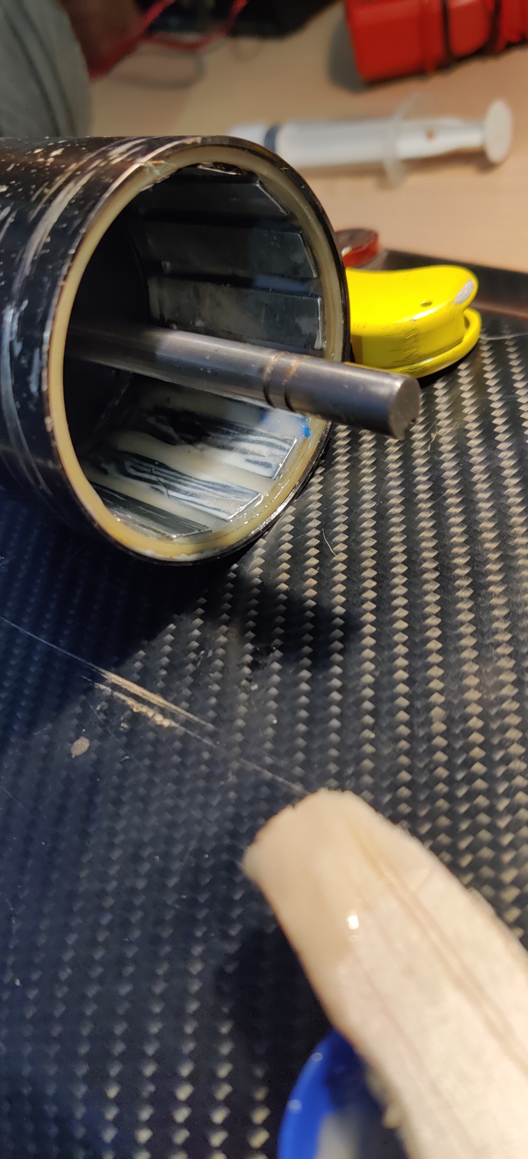

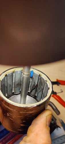

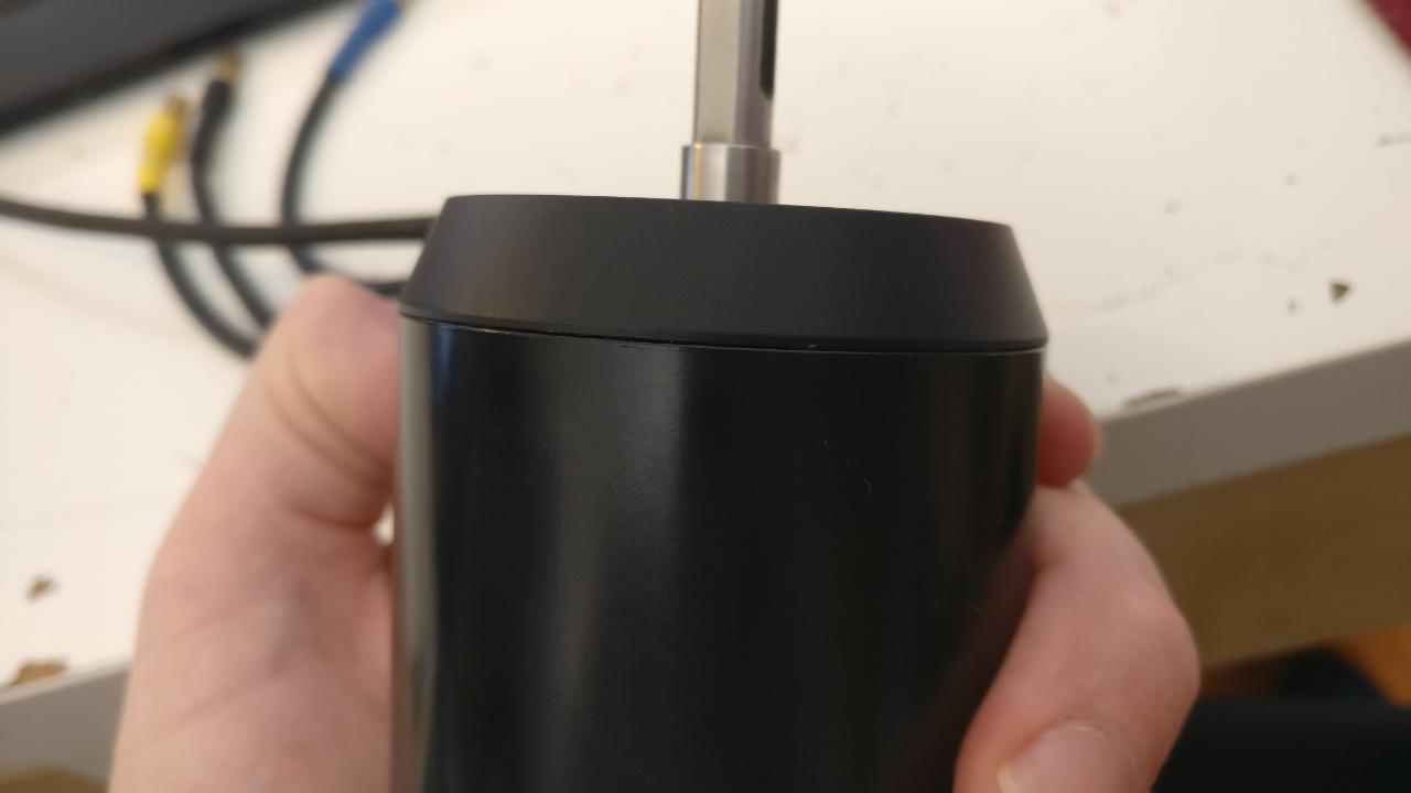

This is the issues I got :
The new rotor falls all the way into the stator !.. But completely !!
no space to allow the rotor to … rotate !..
What can I do now ?
Feel so scammed here, I can’t let this go like that. If I would want to resell them because, well, they’re new, like under 20kms of use … and Rotors are really brand new.
  • Is there a way to mod this ?
  • How can I separate the parts without damaging/scratching them ? If I can resell them if they work again that will be cool.
  • I guess Flipsky will just once again they will just laugh at me or just ignore my request like they usually do.
Looks like it possibly needed to have a spacer-washer which they forgot to put on the back side of the shaft, where it attaches to the bell.
If you bolt the motor onto a spare mount, and push the shaft against a hard surface, does the can move back from the stator front plate a bit to get the necessary gap? Or does the front circlip/washer prevent that?

Ho, thx Tipsy, looks like it yes.
Hooo yeah ! thx again for the tips I don’t why I didn’t think about that to be able to separate them … I was printing an adaptor that will pull the stator from the back of the rotor … yeah complicated ! >,<’
Yes, unfortunately, there is just space for the circlips, don’t know if a whaser can fit with the circlips… but anyway … no space for little gap :confused:

If I do what you say @tipsy :
I should be able to get the desired gap right ?
As the circlips/washer will be will be further ? right ? … I haven’t my ideas clear right now ^^

Are there any thin brass washers under the circlip?
