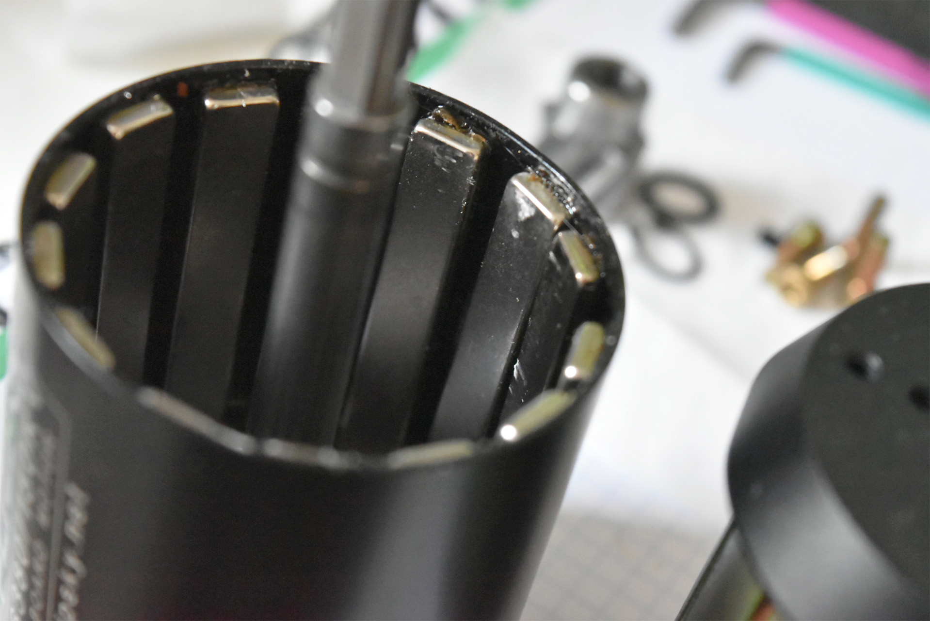

yes, it should … but honnestly I don’t remember and don’t where did I put them if so ^^ I should be able to find one or take from older motors
I was able to destroy flipsky motor by hitting the kerbs. Bell was bent, but replacing the shaft helped.
Nice motor, magnets glued well.
super well glued magnets indeed … … … … …
You can put a washer in the shaft, then put back the bell…it should`t be a problem…And epoxy the magnets of both motors…shity motors, shity service, shity brand…but can be fix…

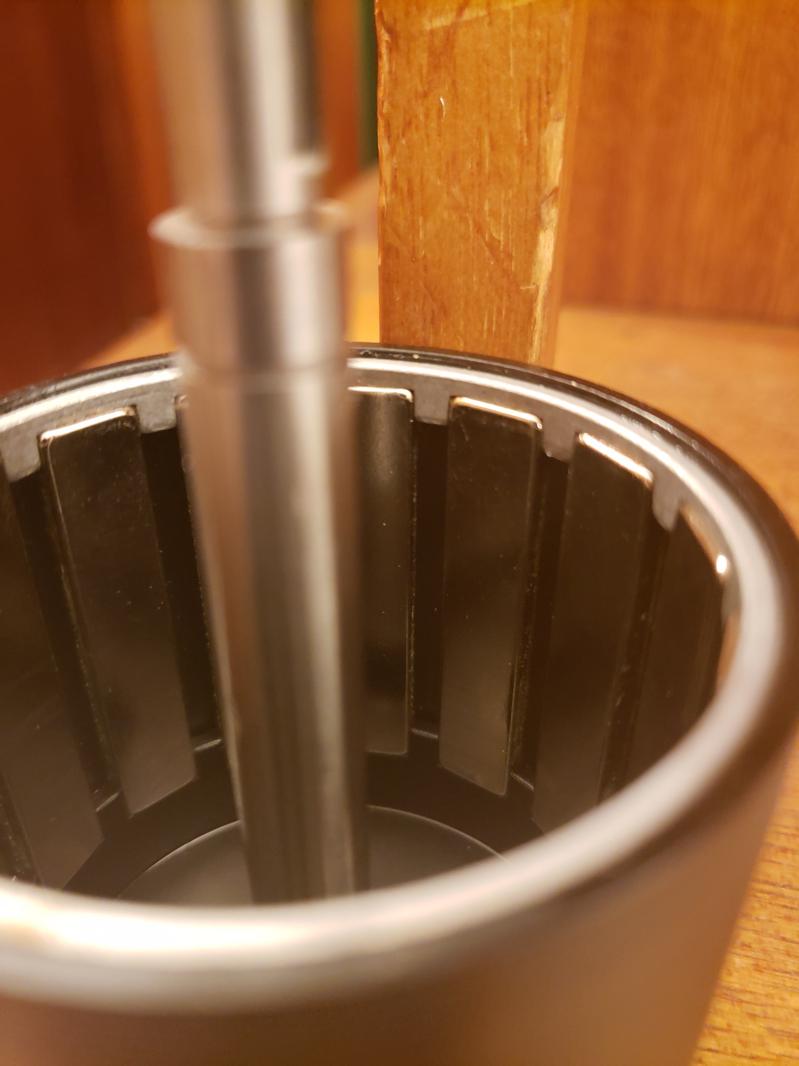

Yours motor from old batch. Now they all with retaining ring
Yeah Baz, read it all again :wink:
Also, the replacing part I got after that, looks upgraded that yours,… even if it’s older!..
you don’t have the clamps ring that maintains your retaining ring, and it’s newer ?.. weird.
Plus, I don’t see added epoxy between magnet, and they don’t look balanced (or it’s on the other side but I doubt about it). :v:

wait, you put them inside of the motor ? they are supposed to be spacers, how could they hold the shaft ?
The shaft it is attached to the bell…the rotor it is attached to the mount of the motor mount…The shaft it is hold by the retainning nuts from the back of the bell…unasamble the bell from the rotor and add a proper washer to the shaft to get some space to let the bell turn around freely…
