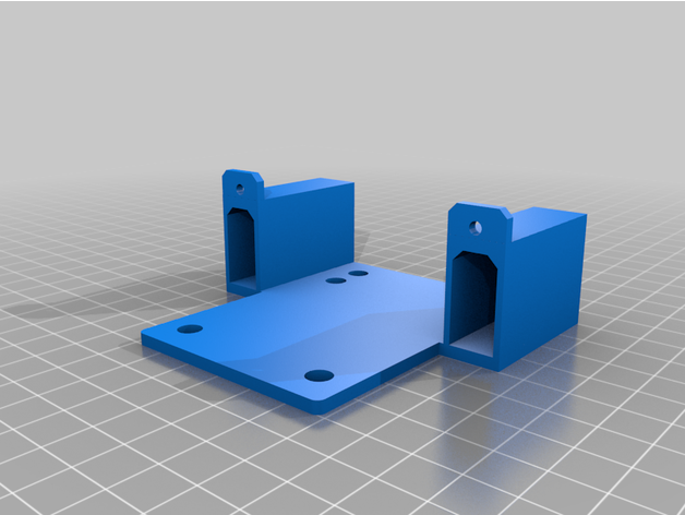

Im about to run a loopkey in my hurricane. im using a custom 3d printed riser that has space for 2 loopkeys, just run it out of the back where the motor wires come out.

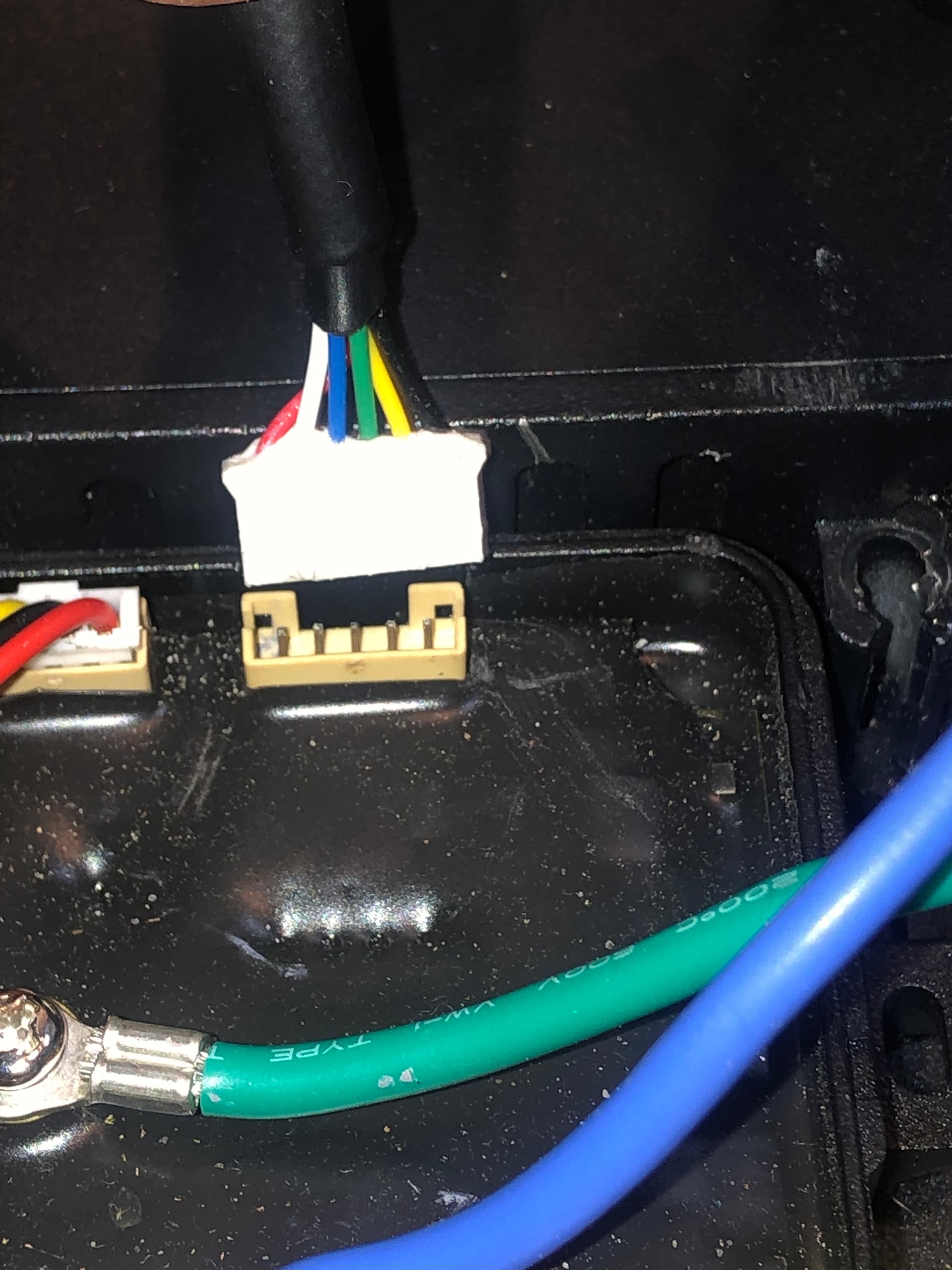

For reference, power is being delivered to my new 6384 Flipsky motors, but it will make a clicking noise? (Almost like slapping two magnets together, it’s quiet tho) and I’ve tried various configurations of the bullet connectors.
I hope I’m not stupid and the fact that they are larger is the problem.
A video would help to see if its normal or not
I really should have video’d it but because it’s raining today, I’ll open er back up. Get back to you soon, but just bought a sky art duo anyway
Walnuts!! The hall sensor is 5 pin on the shitty Ling-ayo ESC
Yeah thats correct. Should have remembered lmao.
Order this off of amazon, its what i use whenever i need to change a JST Connector: Amazon.com
This has 2-6 pin JST Ends and will allow you to unplug the temp wire and change it to a 5 pin. you can just wrap the temp wire end in electrical tape.
