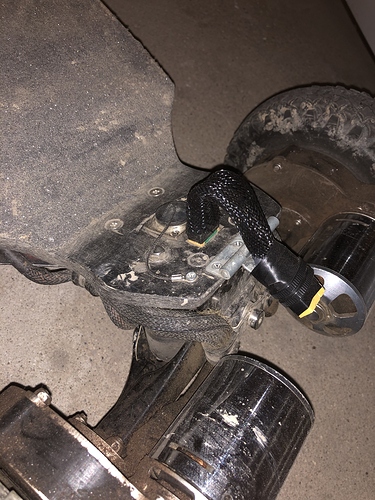

Ive got a retractable power cable coming from my backpack to keep slack out of the wheels. Its connected to a super heavy duty Key-Back. Everything unplugs if you were to fall… no damages to anything.
Nice! Link to the Key-Back and pics of the installation?
Yours has a battery board side as well though, so the changes to the ESCs conditions is not so severe as if phases disconnected under load, if it’s even felt by the ESCs at all.
Check this video
I dont have a perfect picture of the system but its something I’ve refined over the years with this system.
Boardside- Xt90 connector on a hinge to allow for movement.
Backpack side- Xt90 that plugs to the backpack
Keyback is connected to the power wire about 1/4 of the power wire is held up for slack. There is also a steel wire holding the keyback to the backpack in case of an over extension which unplugs all of the ports without damaging the keyback.
I’ll take pictures tonight…
How is the Key-Back connected, to the tip of the cable?
The main housing of the Keyback is connected to the backpack, the extending part is connected about 1/3 or 1/4 down the length of the power cable.
How do you prevent the Key-Back from unplugging the XT90?
Key-BAK Heavy Duty SECURIT… https://www.amazon.com/dp/B06Y3YLGPB?ref=ppx_pop_mob_ap_share
It’s a 13oz pull weight. So the cable is maybe 3 ounces or so… I’ve never had a situation where the key back pulls the connector out. You just have to keep your connectors new. I’ve had this board for 2 years and only replaced the connectors 1 time because it was a bit too loose.
So like me, you also rely on the friction to lock it in place. I’ve found the friction on dual MT60’s to be way more than enough.
Yea friction makes a pretty solid connection. You really don’t want any resistance if you need to bail.

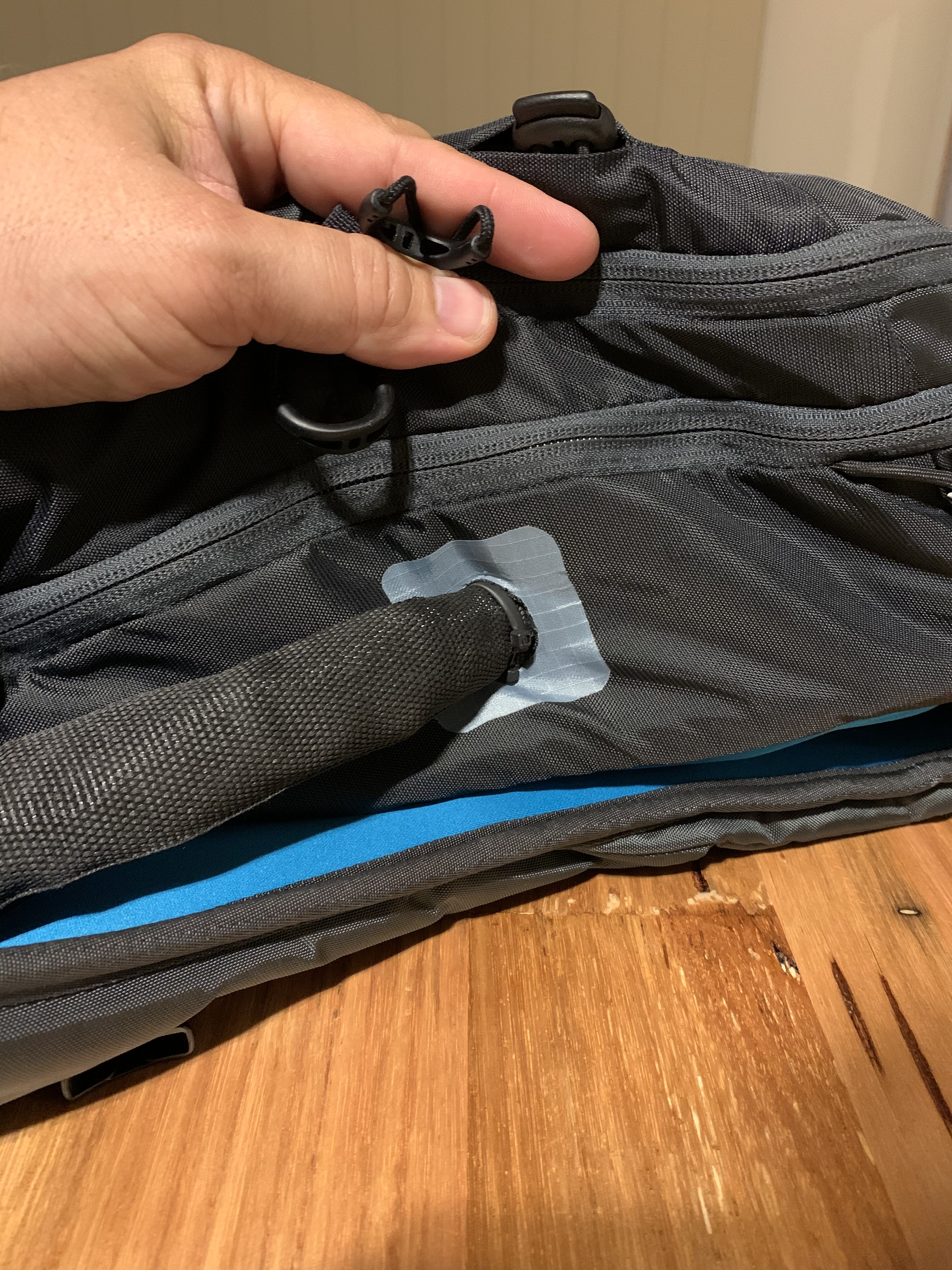

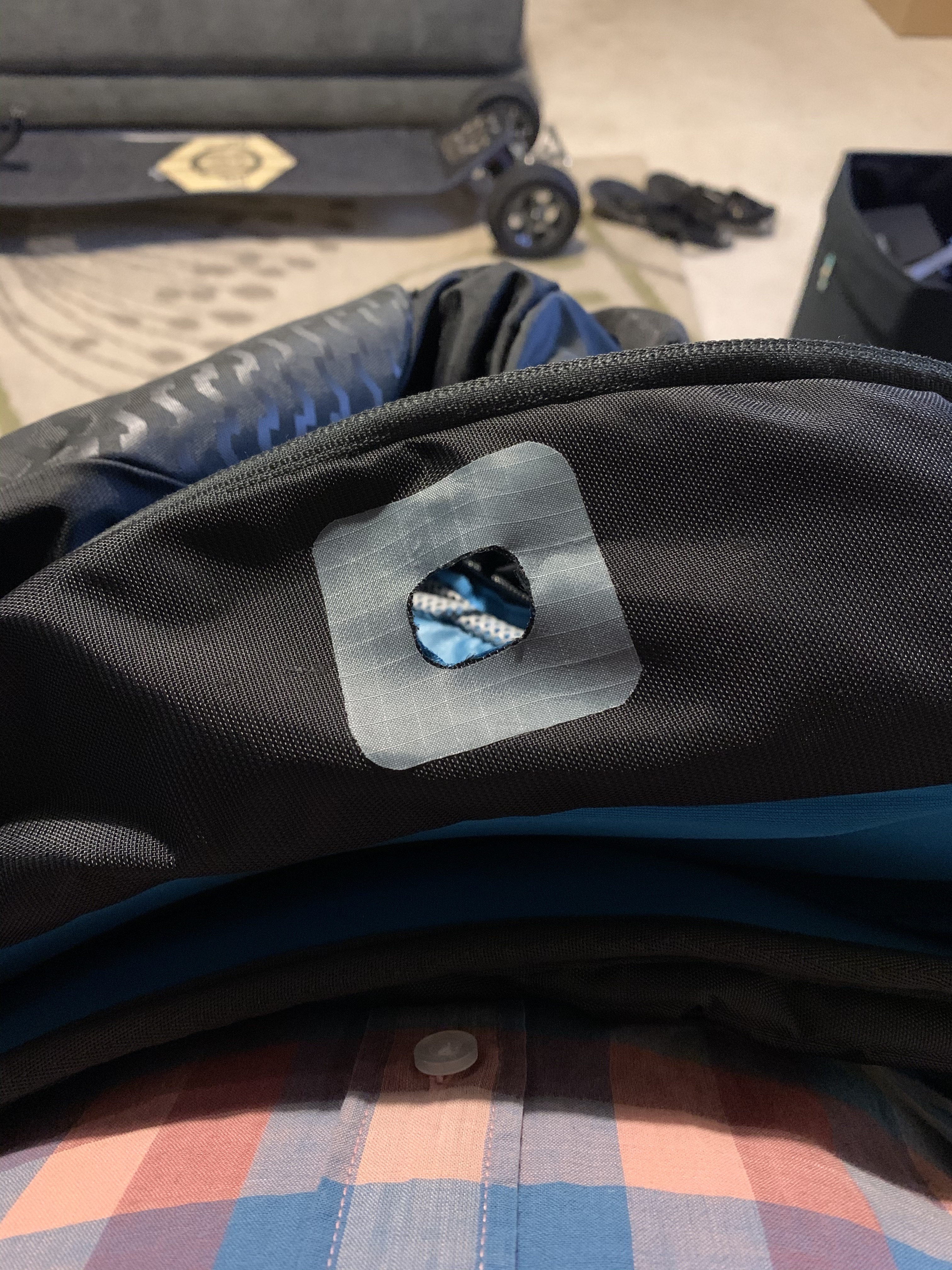

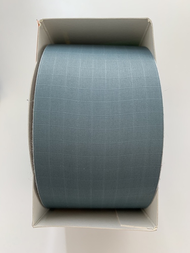

Time for some backpack mods. Ripstop nylon sail repair tape FTW! Hopefully.

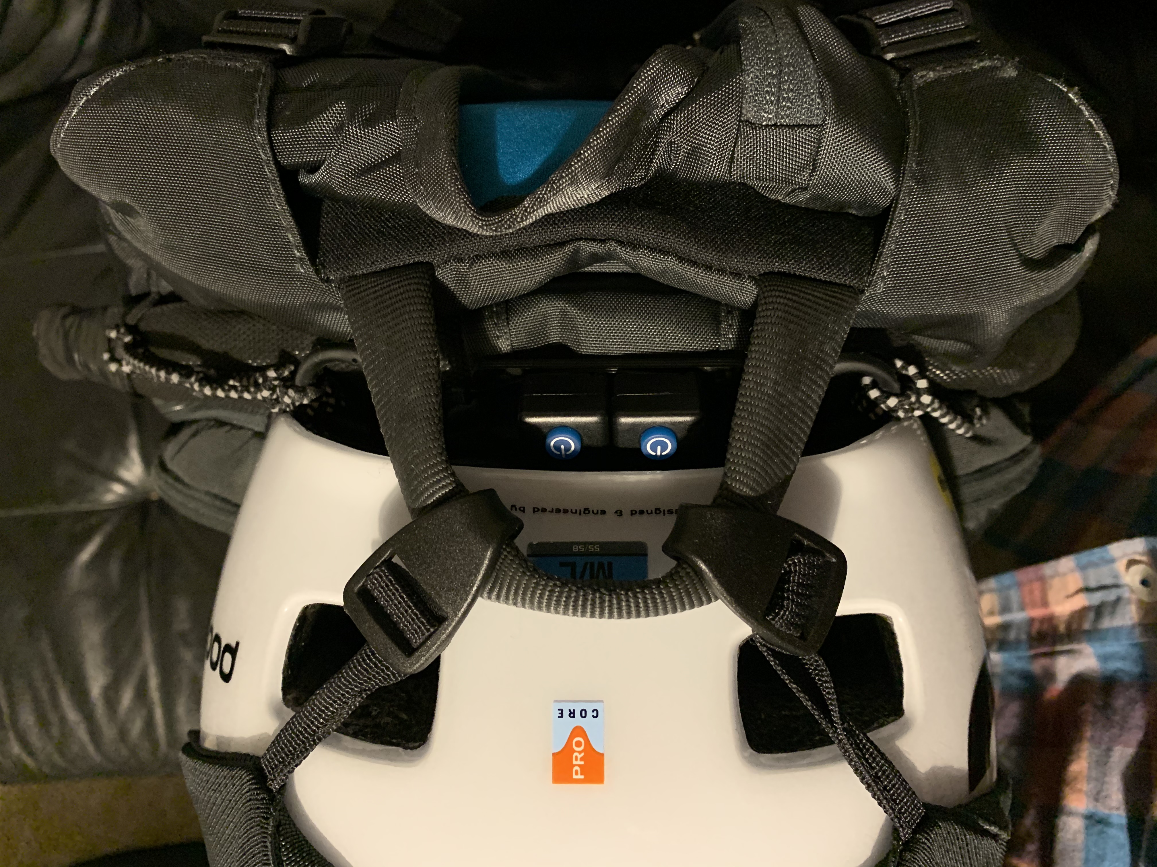

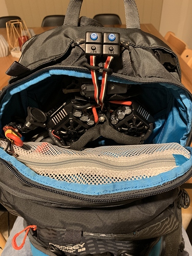

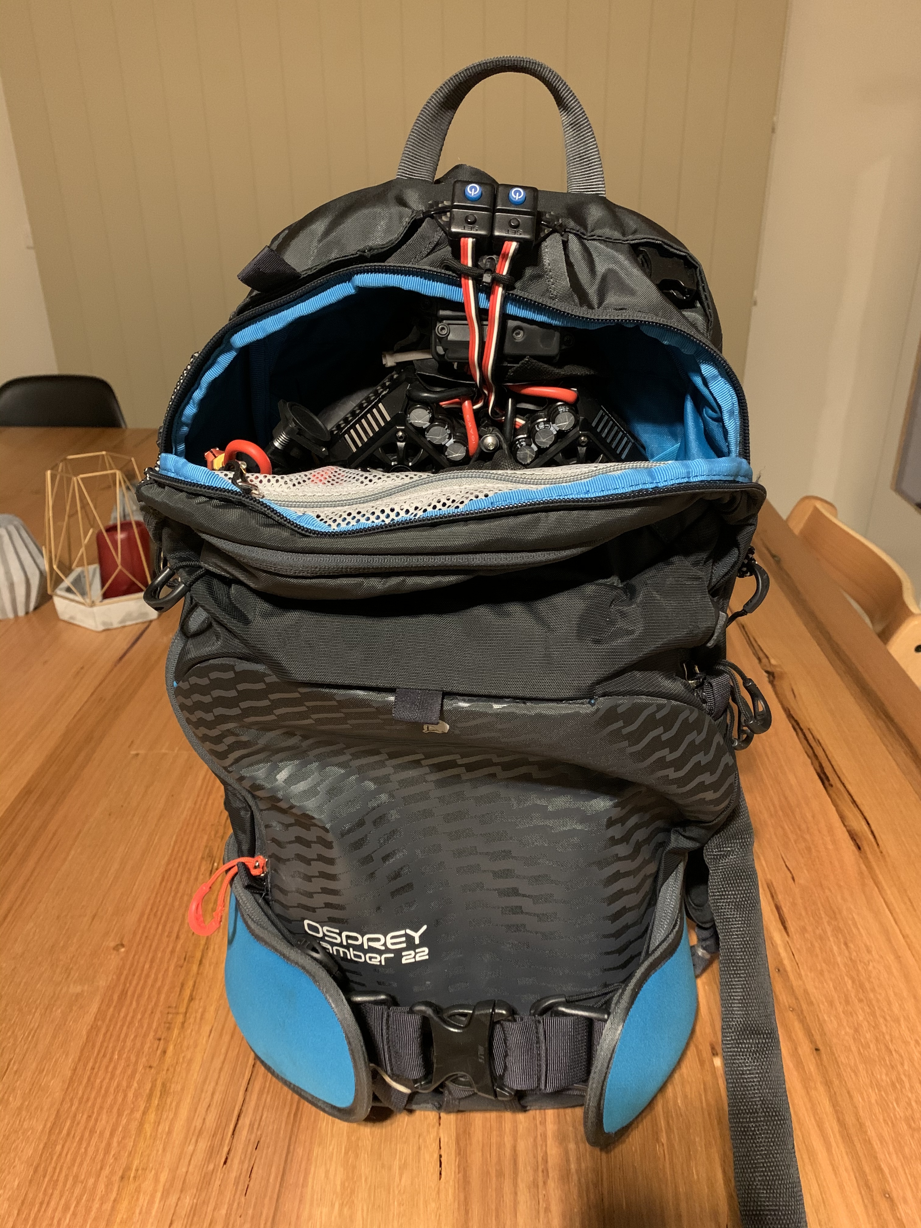

Stealth conversion complete. The photo where the top is open and reflective elastic bands are keeping it from fully zipping open, is how it’ll be for now during operation.
Currently the ESC mounting plate is hanging from a hydration pack loop on the inside. Complete integration coming just as soon as I have a 3D printer.
And how do you deal with the cooling?
