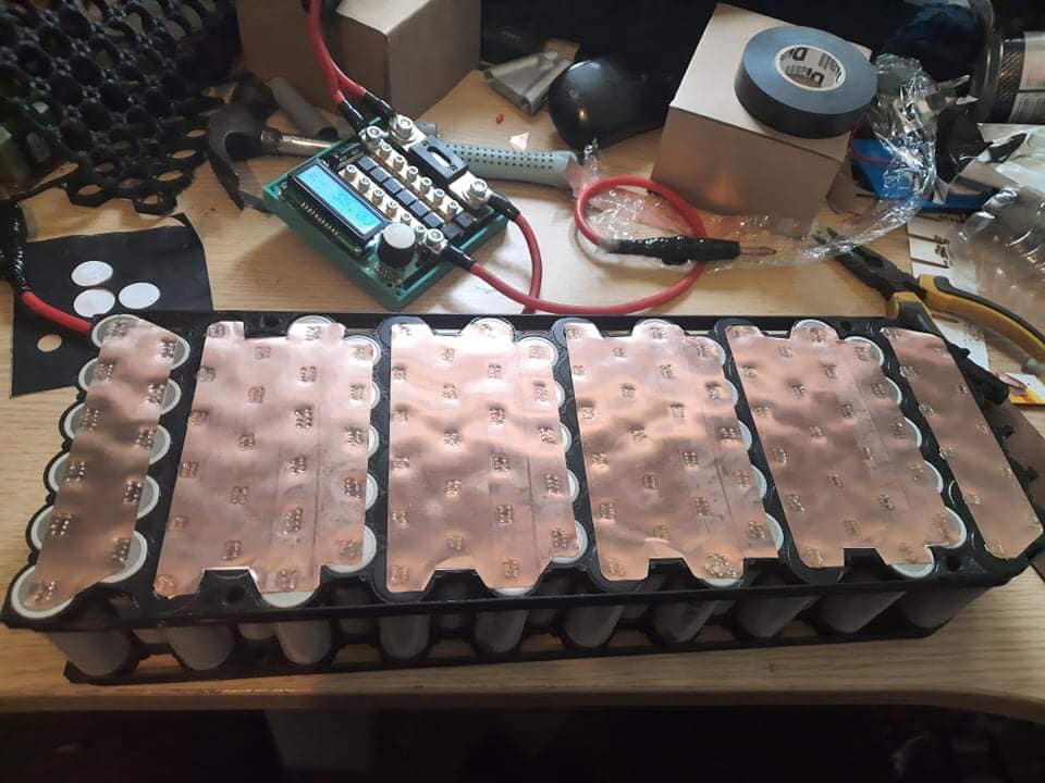

Woah. Now i wanna know how they are welding copper with only 35J on the kweld.
And why on earth their kweld isnt in a case :grimacing:
They do it for many years , i love to buy batterys from them but this one first time problem
poorly?
Lol. Apart from that, wonder how it sticks. I thought the nickel was necessary
I’ve welded just copper w the kweld and had imbalances after. Maybe due to the high current needed or maybe related to me I don’t know.

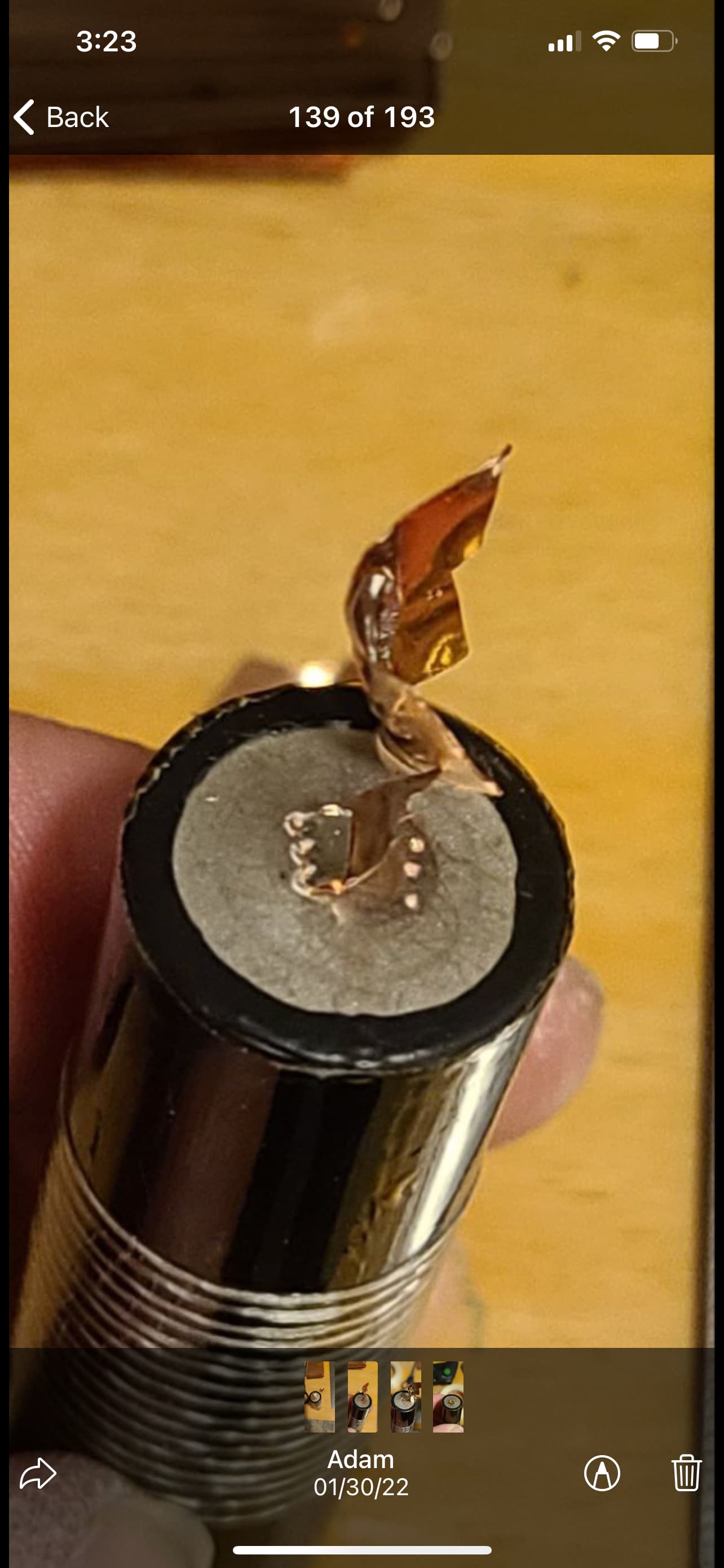

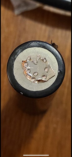

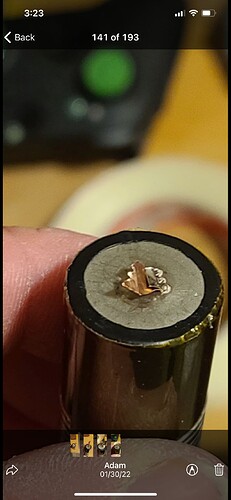

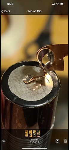

As someone mentioned above all these cells have a weld in the middle of the bottom and can cause higher resistance
This guy I know in the Vsett scooter telegram group made this pack with copper and little nickel tabs, welded with malectrics
His pull tests look pretty impressive
We can’t forget that the voltage sag we see from a pack is also caused by the spot welds, nickel strip, series connections, wiring, and connectors. That can add up to a lot of resistance, causing extra sag to add to that caused by the cells.
I don’t think this is true, I’m fairly certain the concern is that cell manufacturers say not to weld there for safety reasons. There’s a weld internally that connects the layers of anodes to the exterior can, if you use a resistance weld on top of that the heat can weaken the internal one. If you have sources to explain the higher resistance thing I’m interested though, not an expert
Just tossing out an idea…if the internal tab weld is weakened then, as you mentioned, the amount of metal actually welded has decreased or the weld itself is less secure. I think this would result in higher resistance for that weld in addition to any physical damage that occurred.
That’s funny I was halfway through a message to you asking if you have recommended reading for safety features (or maybe it’s better described as safety procedures to accommodate manufacturing features) like that in cylindrical cells. I’m mostly going off received wisdom on this one, I’ve only found one paper that gets close to it - it has good drawings of the cathode and some nice approachable language but no such diagram for the anode
Tab_Design_and_Failures_in_Cylindrical_Li-ion_Batteries.pdf (1.6 MB)
I can’t find where I read welding in the center can increase resistance but read it somewhere @mr.shiteside
I always thought this method looked really neat
Hard to find those as many pack assemblers do not want to, and have no reason to, share details of their assembly methods. I haven’t read these following papers in a while (just scanned some of the links I have) but they might be worth a look-through to see what they say.
A friend of mine, who works with cell manufacturers and pack assemblers, has told me that everyone says the same thing…they avoid the center of the negative terminal “just because”. Spot-welding to that place can never be a good thing, and could be a bad thing, so they just don’t do it. They have no need to, and no interest in, checking with the different cell manufacturers for the technical details.
