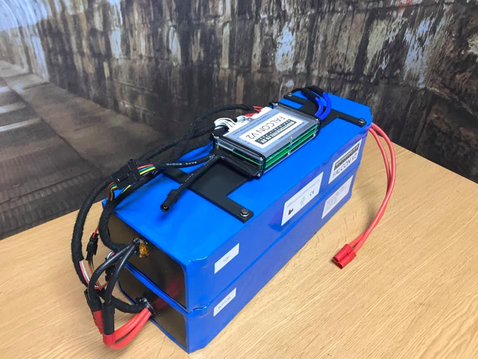

ok I’m very much not an expert, I have only built one half decent battery. But I have 2 thoughts here that could be useful:
  1. I think the reason the physical location matters is because the connection from groups 1-2, 2-3, etc is a fairly big nickel strip welded pretty well. But from 6-7 seems to be a much longer cable, rather than a tiny strip of solid nickel. Resistance is still very low, but at 160A dropping ~0.2V seems sort of expected. Do you have pictures of the assembled pack other than what you showed?
  2. To test if a cell in that group is defective, run the pack at high currents and see if it gets hotter. If it is in fact the connection and not the cells, the cable will get warm. If a cell is unhealthy it will likely get a lot hotter than the others

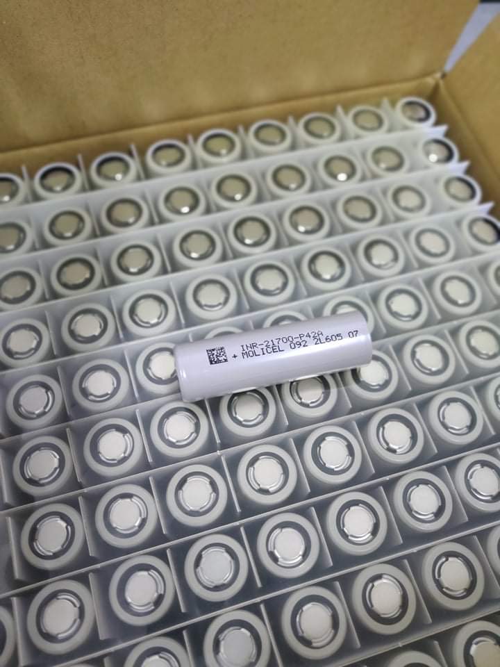

No production P42B’s out there. There can be a few samples though. :slightly_smiling_face:
Edited to make it clear that my original reference to samples meant that they can be in the hands of some people but none are in production.

You’re saying they were purchased from a retailer or distributor and are production cells, not samples? If so that is contrary to what I was told by those who know about Molicels.
There are none available for purchase anywhere, it’s not listed as an available cell on the E-One Moli web site, and both Molicel and NPE have said that the P42B is not going into production and is being passed over for the P45B. :person_shrugging:t2:
Nah we got samples to test :slight_smile:
Currently evaluating some EVE and molicells. Think the P45 is in there too.
Ahh…okay. I mentioned samples being available in my post so I still stand by it. :grinning: I have edited it though to try to be clearer about what I was trying to say.
A couple of the EVE’s have tested pretty well IMHO, especially considering their price. The P45B I won’t say anything publicly about yet (just to my patrons) but the testing I’ve done the past few weeks has been verrry interesting.

The top floor and bottom are connected with cable , that is way polish do,That group works normal, when is charged battery has 0.001v difference just that group is quicker on discharge and drops 0.176v i both packs has same temperature in bms app

Thanks for the picture, can you show the cable that connects the floors? Because it is indeed a cable rather than nickel, I think my guess that it is just voltage drop across that cable is correct. If you have a way to draw a high current from the pack and measure the voltage on that wire, or directly on the cells in group 7, you can get an accurate answer.
If you have a multimeter that can probe directly across the wire and you find that at high current it’s dropping 0.2~0.3V then you know that the cells are fine. If you can’t access both ends of the cable safely, but you can access the cell terminals then you can also measure the positive and negative of group 7. I can draw a diagram if that’s not clear, describing batteries in text can be messy
In Poland all high end ebikes company that make high discharge battery do it like that way,because you must use o+minimal two or three floors and tje only way to connect it is by cable,because you cannot fit all pack together in same time in frame,but that is not a problem they did hundreds of them,cable is not a problem.I will show you now how that looks ,this battery on picture is 300 amp discharge and no problem ! We will see one cell or something alse not cable …
