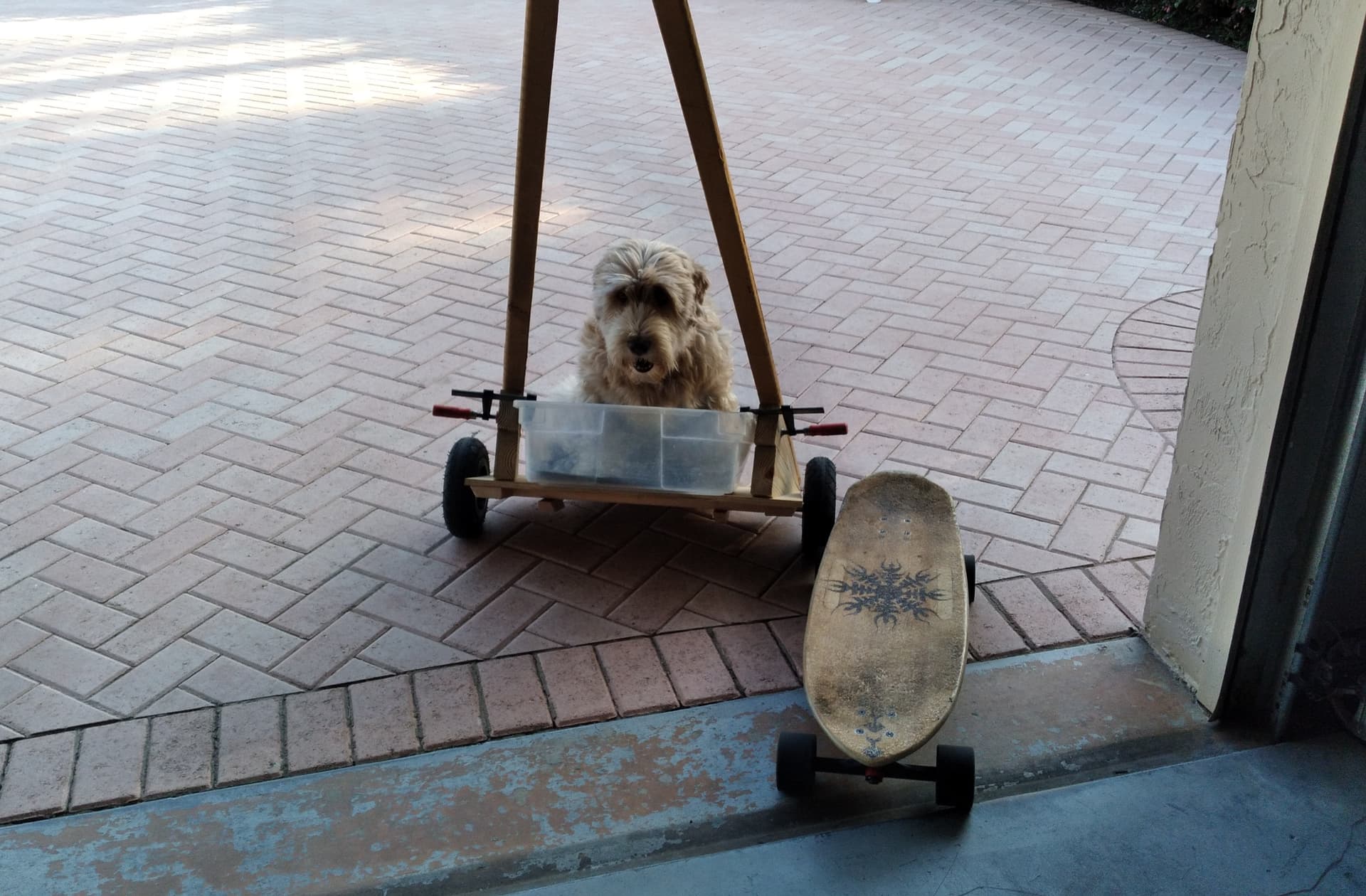

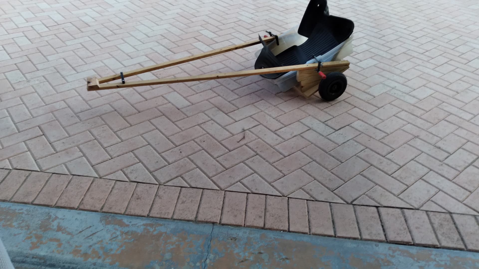

Another successful Fyak mission with the dual diagonal drive mini tow board.

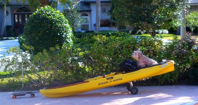

The radar speed sign was up.
11 MPH towing the Fionayak into a headwind.
It showed 12 the other day when I was
alone.

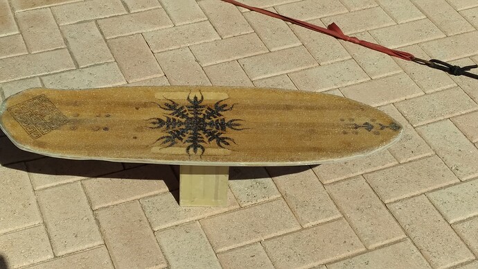

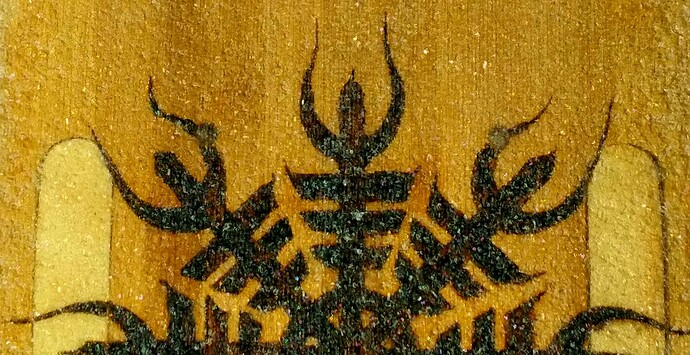

My long cruiser, when I laid the saturated roving diagonal grid on the deck, and applied a thick weave fill coat over it, I sprinkled the whole deck with coarse granulated brown sugar, and applied light pressure to the crystals to force them shallowly into thickening epoxy.

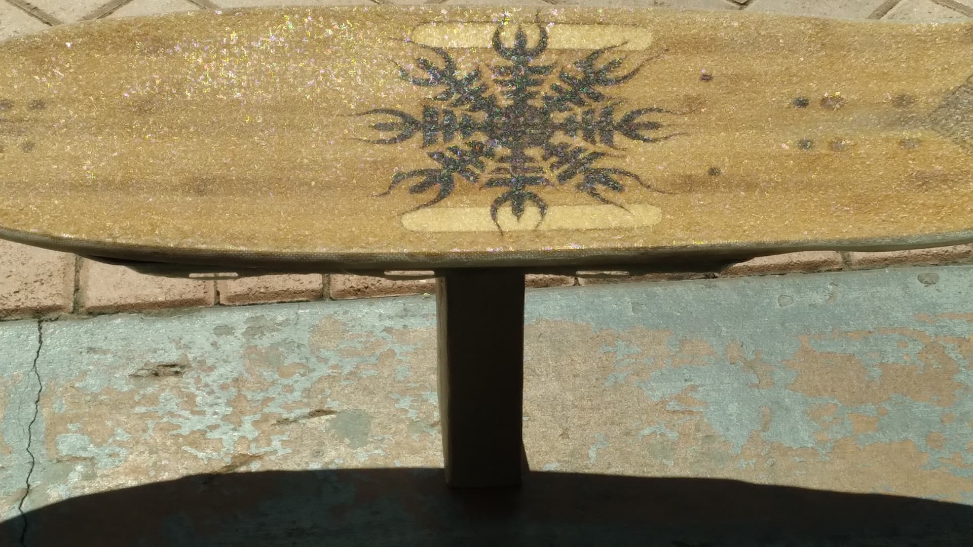

Once cured, rinse with water, the sugar dissolves, leaves behind a rough transparent surface.
Pretty easy to clean with more water and a bristle brush.

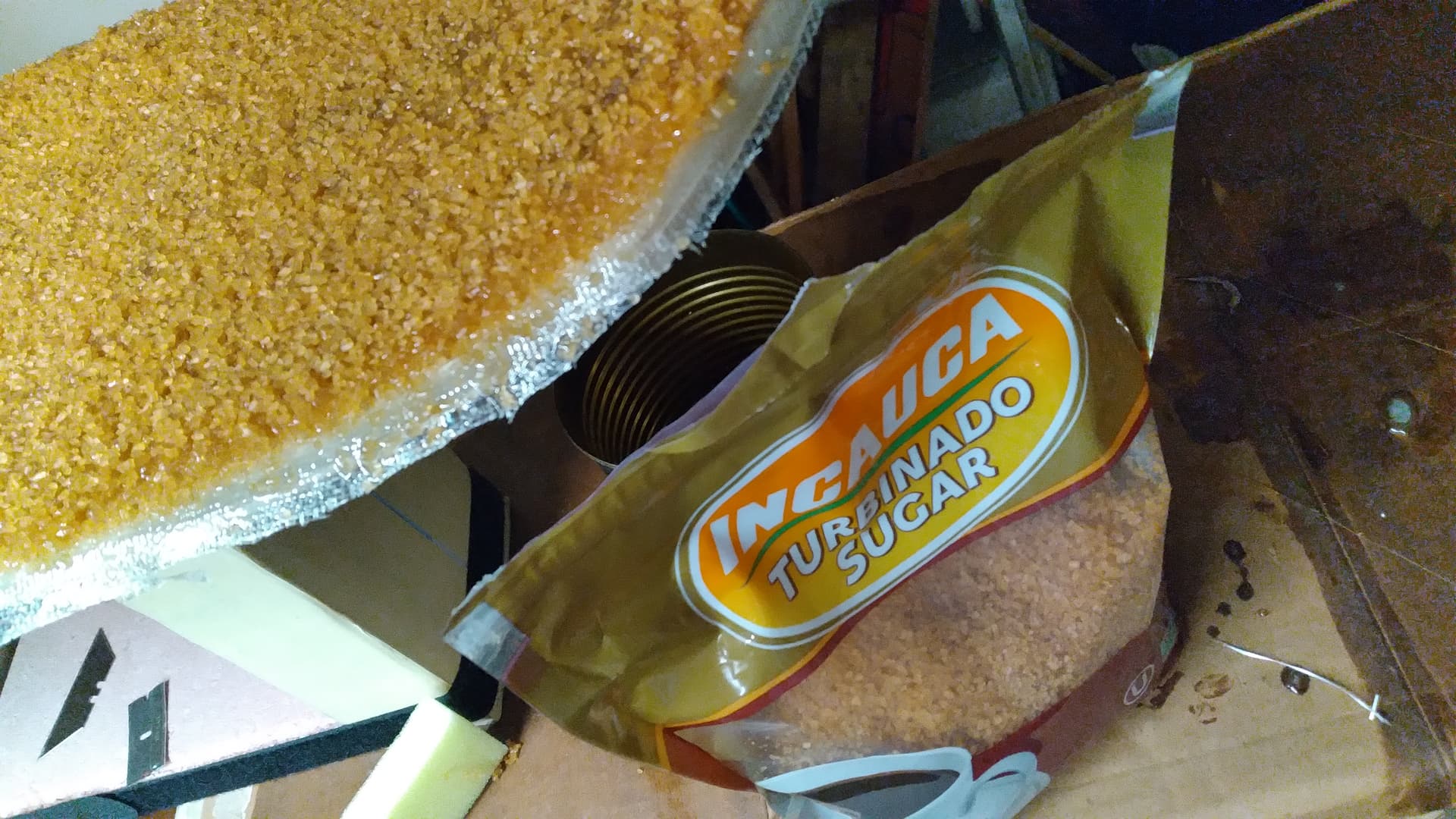

I found some coarse ‘Turbinado’ sugar recently.

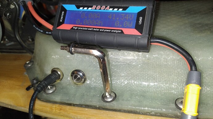

Every time I recharge anything, I have an amp hour counting wattmeter inline.
Yesterday’s kayak outing with diagonal drive mini, required the least amount of amp hours to recharge fully, at 1.3 amp hours. The worst round trip was 2.31ah, When I had the soft flatspotable squishy kayak wheels. Average has been 1.8Ah on 7s voltage.

The diagonal 70mm wheeled mini, proving to be a capable Fionayak tow vehicle has been detrimental to previous plans. It’s far lighter, and the Fyak is nose heavy already with Fiona on her bow platform.
But it can only achieve 11mph on 7s, which causes more interaction with traffic in same direction.
My 83mm hub motors can hold 14mph towing on 7s
Speed limit is 15 and 20 mph.
Few exceed 25, but old people will pass us so slowly, it is annoying as fuck. Go!!! Going same speed as traffic means less chance old beehive hairdo fereaks out, and is likely safer in long run.

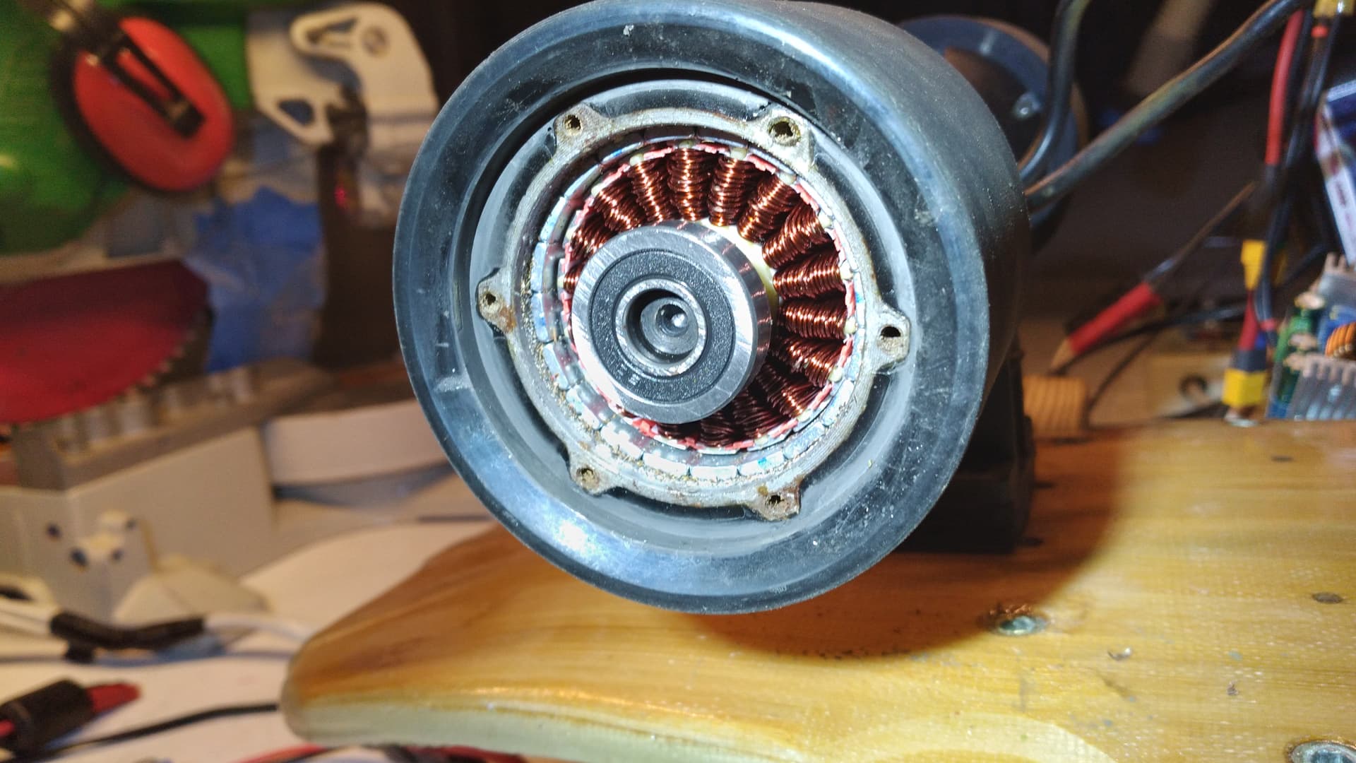

Here are the 82mm hubs on the linasquat cruiser.

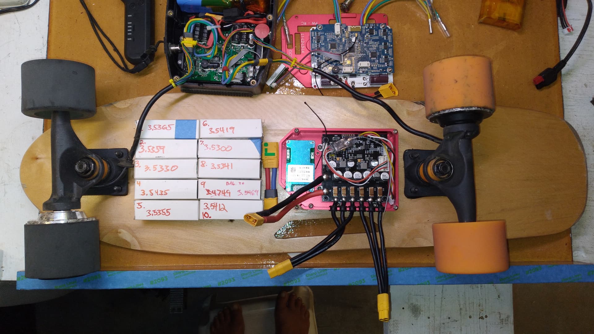

With metroboard Flipsky 6.6 housing, and my 10 p42as.
10s5p of p42a will easily fit a segmented flexi enclosure
I’ll probably order a VX1 pro tomorrow.
50 p42a or some other 21700 cell are still a ways off, finances wise.
I think a new hub motor truck comes first, so I can swap only the new 10s2p enclosure from Midsize kicktaik to the Linasquat cruiser, until linasquat has its own enclosure ready to have a battery built inside it.
Ideal, i think is the backfire 9" rubber wheel hub motors, or the 6.5" rubber wheel hubs
But Backfire has 96mm urethane hubs in dual 4O0 and 600 watt flavors. Got to be tons better than my dual 350watt 83mm hubs, and has swappable sleeves.
Then Meepo has the 105mm cloudwheel knockoff dual 540 watt hub motors, replaceable sleeves.
Then the cheapest acceptable option is Puaida 90mm 400 watt hubs which can use the 105mm glow wheel sleeves. They claim 30 mph possible with ‘their’ special 10s esc, which I have, but my 83mm hubs can only do 22mph on it.

I remember the sugar dissolving faster the last time I did this.
Perhaps the hose was in the sun back then.
But it came out super coarse grit, but not really sharp.
Plenty grippy.
Didn’t lose too much clarity.
I prefer it to clear grip tape.

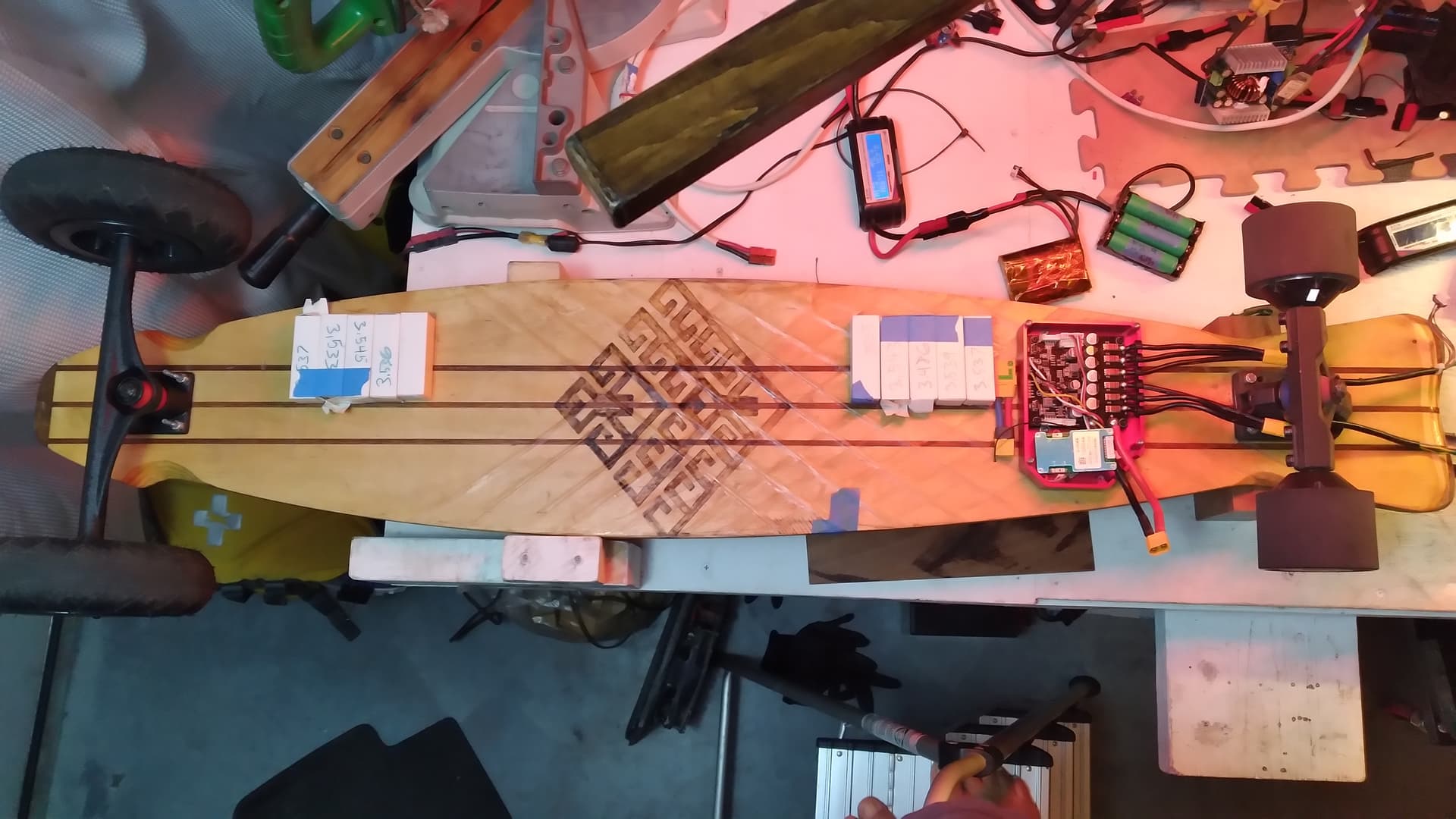

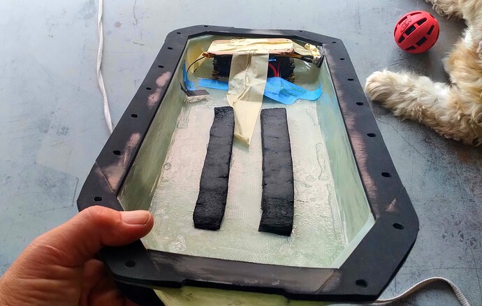

My fiberglass enclosure is functionally done, so I reinstalled charge port, power switch, ESC, and velcro cinch strapped it to the Linasquat, and explored all the new local asphalt, and with a tailwind, hit 24mph, according to the remote.
I can definitely feel the one wobbly pneumatic tire, and the 82mm urethane in the back feels the parallel seams in the new asphalt that the pneumatics do not.
I don’t think I want to go such speeds on the short wheelbase kicktail, but on the Linasquat, I’d go faster if the hub motors allowed.
The kicktail is basicLly done too.

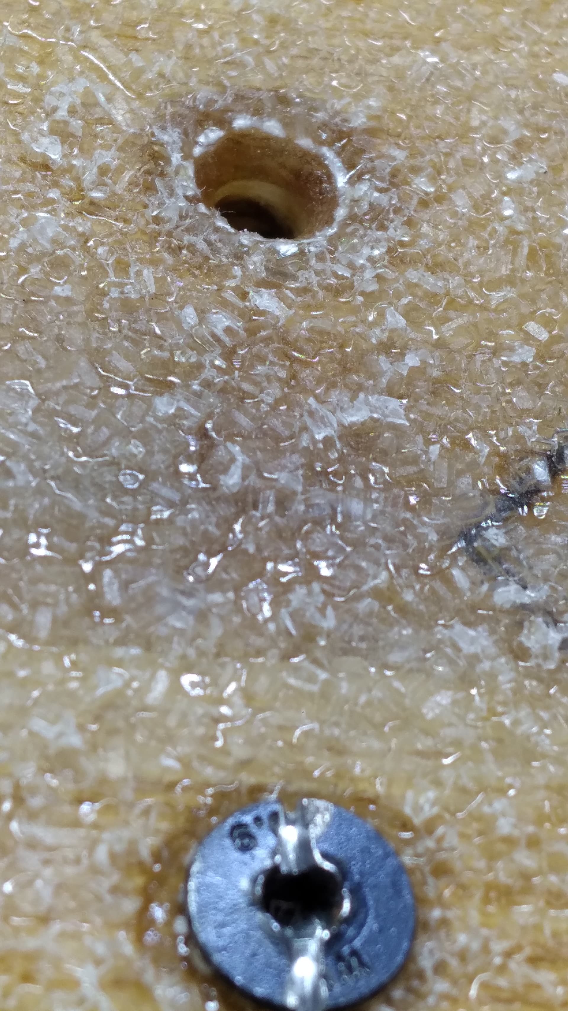

I drilled the hardware holes for the trucks wider and filled them with epoxy, as a sort of antisink, and more waterproofedness. Still need to drill 8 holes through the center of the epoxy columns.
Drilled the epoxy columns and countersunk the original screwheads, which need to be replaced. Not all the hex heads stripped like butter, but i decided to dremel a slot in all of them in anticipation of the inevitable.
Shows the texture of the brown sugared epoxy fairly well.

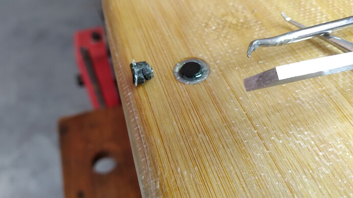

I sacrificed a extendable telescoping magnet wand, in order to cut out nice round holes through the hard neoprene gasket.
The bungs fit nicely into the inserts, to prevent the final layer of epoxy entering and corrupting the interior threads, on 16 of the 18 anyway.
I dremmelled a flute in a screw to clear the two which didn’t prevent epoxy seepage.
I’d waxed the internal threads so the epoxy wouldn’t adhere strongly, if it did get past the bungs, and a curse fest was avoided.

The 10s2p 187watt hour battery was not intended for long range, but as my first battery build, I am pretty happy with the 40$ worth of 2600mah 15 amp DMEGC cells.
I do wonder how much sag there is under full acceleration, and how much better 10s2p of 42a would compare.
I set my DC to DC booster to 41.51v , and upped the input amperage to a bit over 13 amps (13.22v input) and have a strong fan concentrated flow aimed at it. 117f/ 47.2C is the hottest spot I can find on it. Output is about 3.7amps. 1C would be 5.2 amps.
I’M not feeling much heat making it through enclosure over the ESC, but have no actual data. The rather extreme board flex is allowing plenty of airflow into the ass end of the enclosure, as is. I could remedy this easily enough, but this enclosure was not designed for this board, and removing it takes about 5 seconds, undoing the velcro cinch straps.
The 18 screws will take far longer.

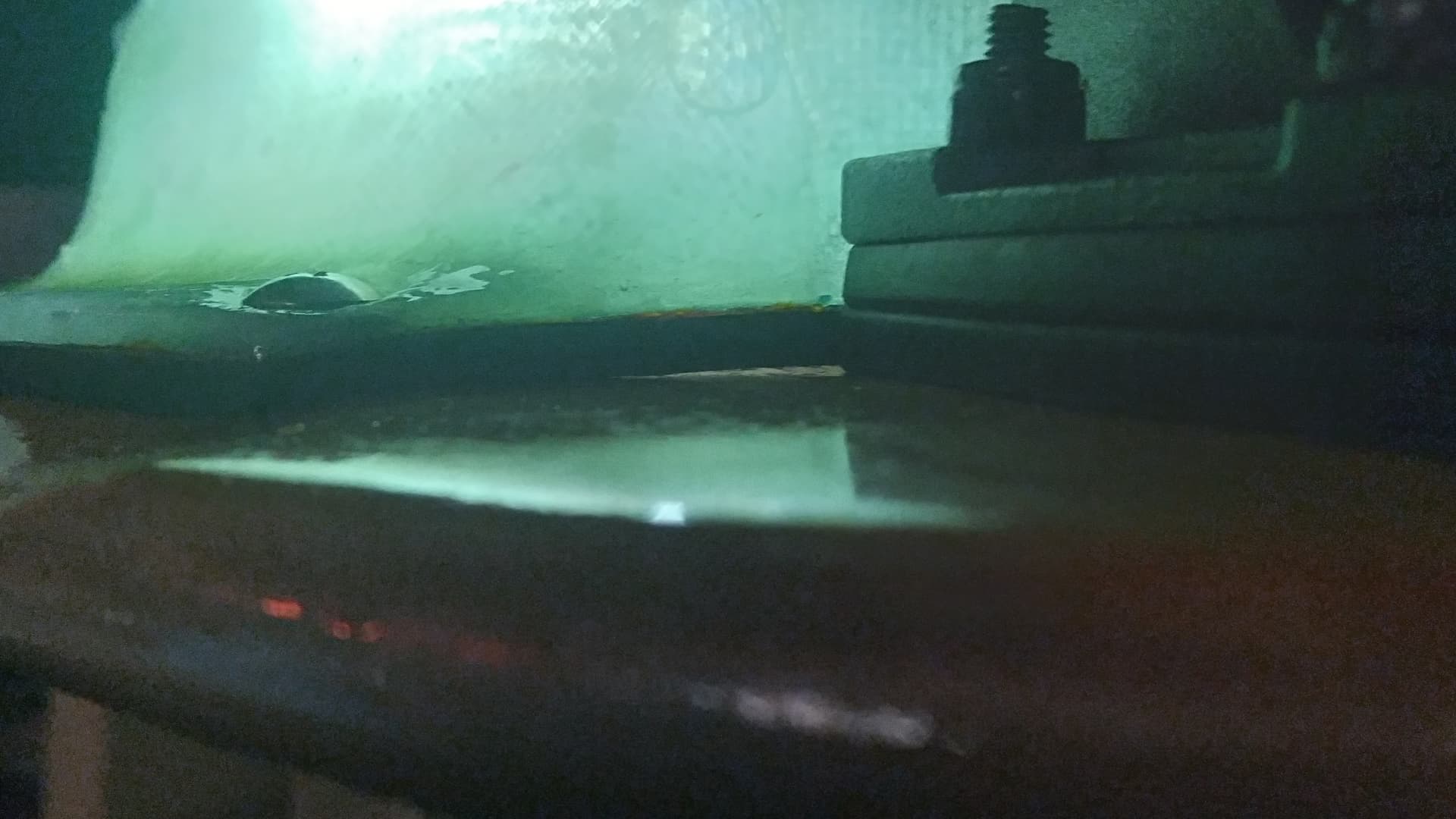

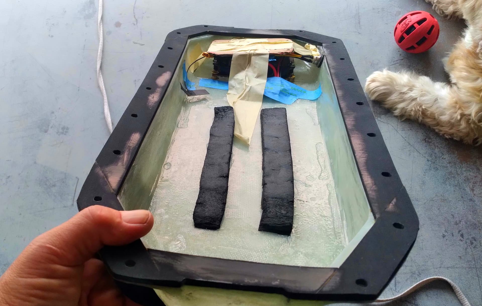

Not unexpected, but a bit annoying to see light escaping between the hard gasket and board.
However, this is the only gap I can find, and it’s far from being impossible to remove.
The shiny spots on the gasket are where it was not yet in full contact with the underside of the deck.
I really thinned out the gasket enough to where the screws are almost bottoming out inside inserts, and the area behind front truck is still an issue, with a gap.
I decided to weigh up some 30 minute epoxy to fill the gap, rather than thin whole gasket even more by sliding tape re enforced sandpaper between deck and enclosure.

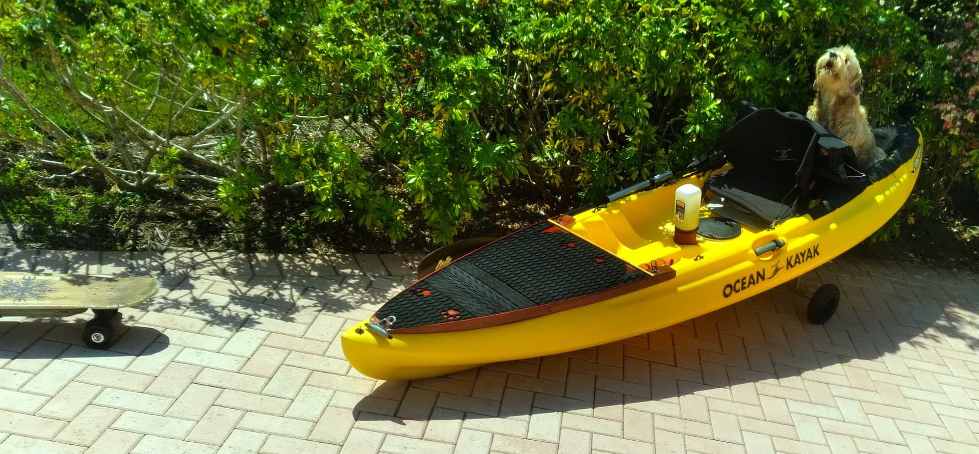

There are 3 different routes to the kayak trail head.
I avoided the main drag previously as it has the most, and the fastest traffic.
Today I took it, as I can now go the speed limit on it. A little over too, at 21mph on a slight decline.
The kayak feel super stable behind me as I rolled into the throttle, exceeding 15mph
towing for the first time.
Fiona loved it.

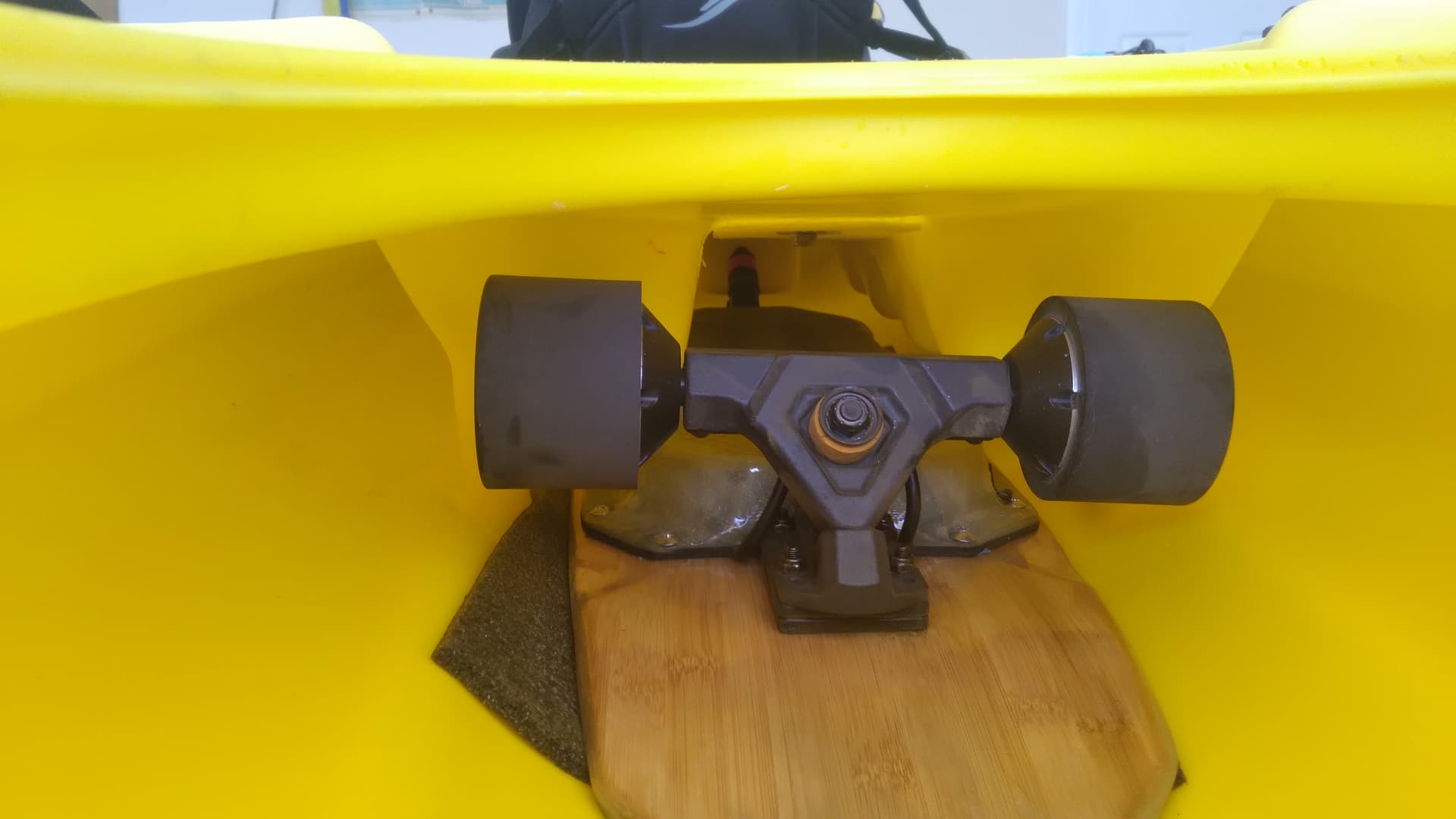

With a fiberglass roving perimeter on the deck , the board barely squeezes into the hatch, but with front hanger removed, and sliding it all the way under my legs, makes it far easier to store the kayak cart, than with the diagonal mini, and kind of negates its
extra weight.
I’ve also been plugging the scuppers in the rear well, and filling it with water as ballast, which helps it steer better, but makes me wish I had more paddle, to get upto speed easier.
Paddled close to 6 miles, and took the long way back, as there is plenty of battery capacity, the asphalt is new, and the 8" pneumatics on the kayak cart are so quiet and low drag, it is a joy to pull.

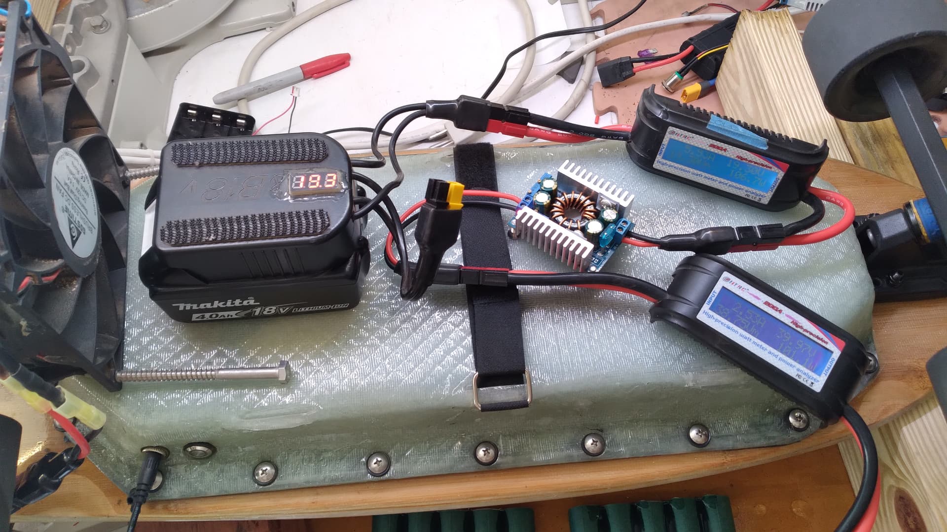

Performed a little experiment today, using one 4.0 amp hour 18v 72 wh Makita battery, to power my DC boost converter, to charge my 10s2p 187wh Esk8 battery at around a hundred watt rate.
I dialed the output, unloaded to 41.98v, and dialed currnt way down, then hooked it up to the Esk8 battery, then dialed output current upto 2.53 amos. 2.6 would be 0.5C
The converter was turning about 6 watts into heat.
106.7 watts going into boost converter, 101.1 watts out.
Better than I expected.

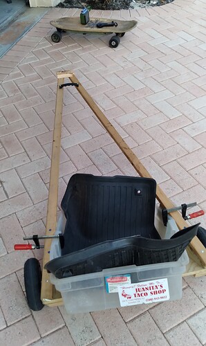

I don’t really require range extension, at this point, but am building a Kayakless cart for
Fiona, and wish to start exploring farther and wider when it is ready.

Radar sign clocked us at 21mph, and there was a 15mph headwind.
Paddled close to 3.5 miles upwind up and against the tide, then back to our island to chill.

Towing the kayak, I just hold its front handle in my right hand, remote in left.
I can feel when she shifts her weight, or when a wheel hits a branch, or the seams in the new asphalt.
When braking, I can put kayak nose into my hip and stop in a respectable distance.
I can offset the kayak to Port or Starboard, pull it close, or keep it at arms length.
Today, I slapped this together, to see if it was a viable plan.
This is the Kayak cart’s hanger, with its 8" pneumatic tires, adapted to become the base of Fiona’s Chariot.
I clamped a plastic bin to it, threw a rubber floor mat inside, and she jumped inside even before I told her to.
We took a tentative, slow speed lap around the block, returned, and I drove a half dozen more screws, then we tore up the fucking neighborhood for 7.5 miles.
It is stable, she stays low and centered, and never once tried to get out.
In fact, when we stopped in a spot she has never before sniffed, and I did a quick check of the mechanical vitals, she didn’t even try and jump out.
I’ll beef it up, make it more comfortable and sturdy and aerodynamic.
It’s way easier to tow than the Kayak, being ~60 lbs/27.3kg lighter.
All sorts of freedom has just been enabled.
Happy dog, happy master.

After one of the longer trips and measuring the hub motor temps with IR gun, and spining them, one motor was making noise.
Opened it up to find sand had gotten inside through the outer cap.
Looks like the assembler used something like E6000 as a thread locker, and used too much, which prevented the cap from sitting at full depth, and allowed sand to sneak through.
I cleaned it up really well, polished it really, reassembled it, and now there is interference when spinning it, louder than before disassembly.
I tried rotating inner and outer caps 180 and 90 degrees, and was barely able to influence the noise of interference, before giving up for the night at 3am.
So right now have no head clearing vehicle to ride.
Will have to reassemble the diagonal mini, and then see if i can get the hub motor to not have an interference fit, but I am not hopeful.
i ran into this kind of issue when doing maintenance on v3 meepo hubs and replacing the stock bearings.
depending on if i tightened the truck side screws or the outside screws first would determine if it seated correctly or not. I don’t remember the exact procedure except that i had to seat the truck side fully before i put the outside cap on to get it aligning correctly. good luck
