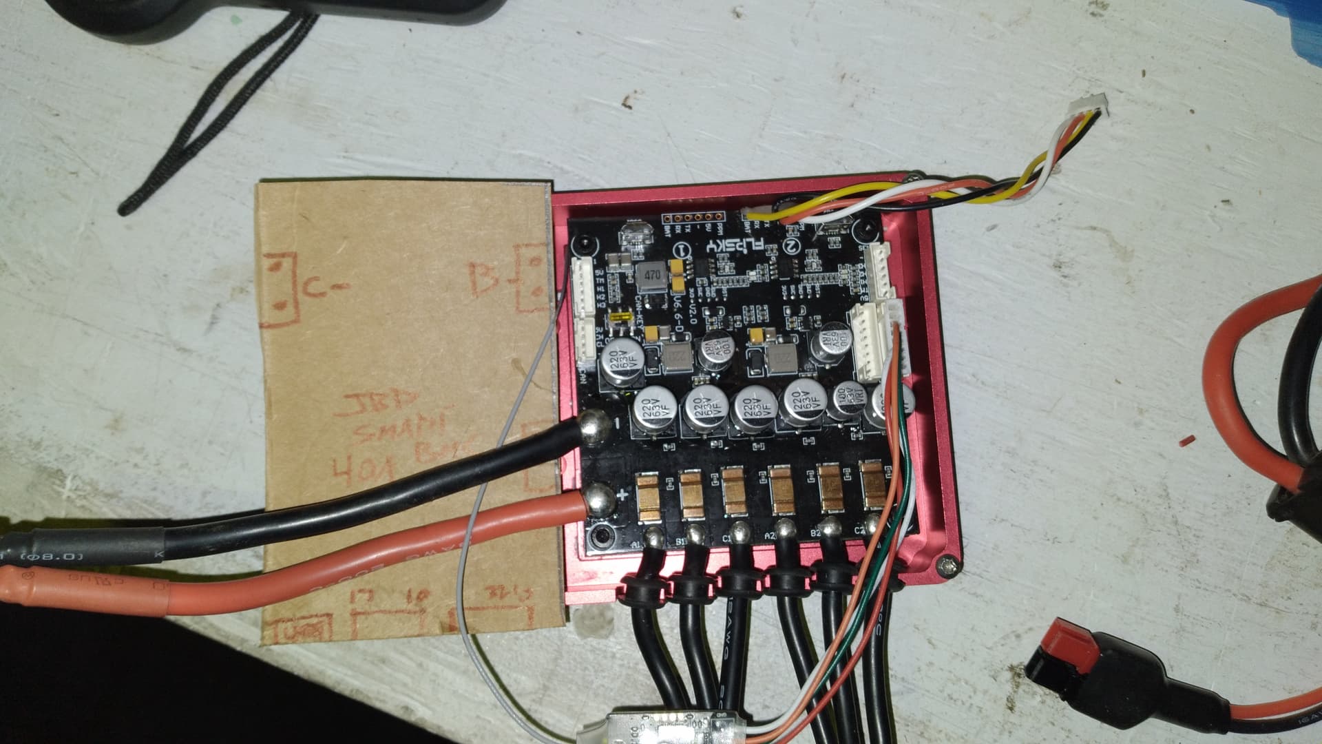

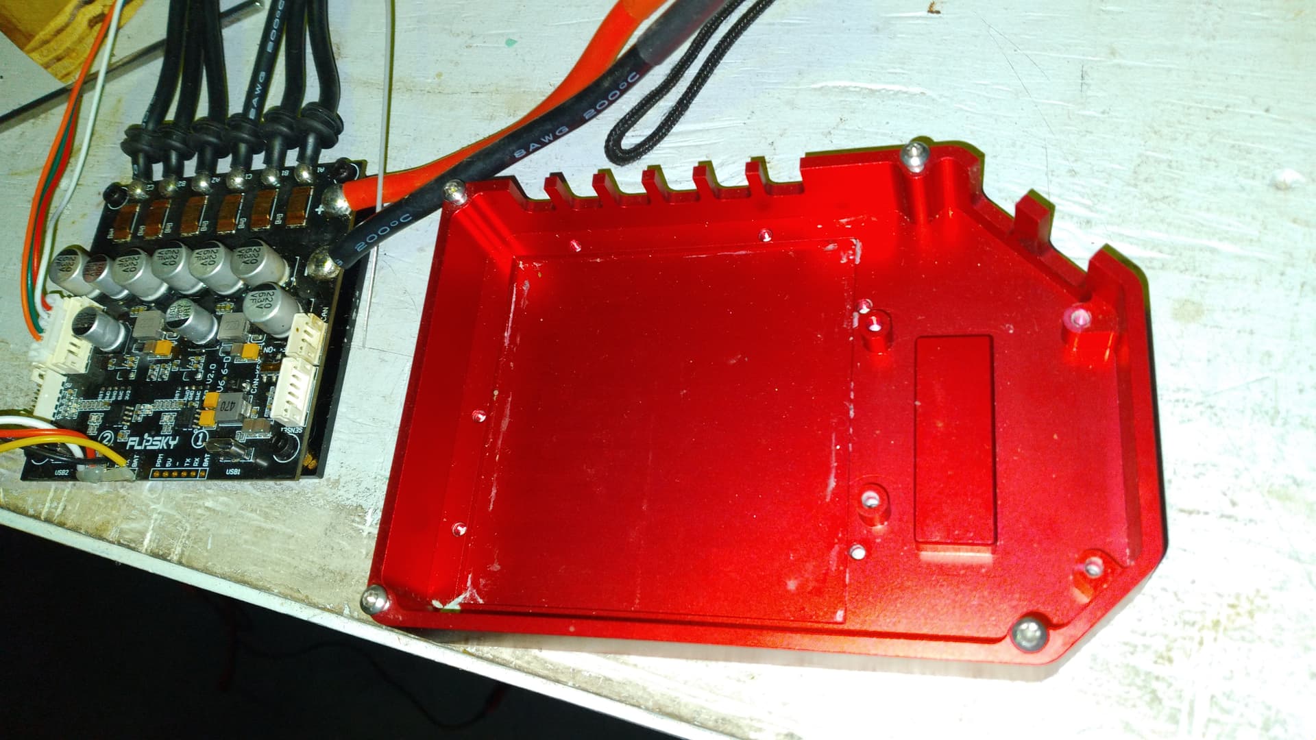

Staring at the 10p42as and the beautiful Metroboard Vesc housing/heatsink on the diagonal mini, I decided that the portion next to the flipsky 6.6 v2 could and perhaps should house the BMS.
Even a small dumb bms like daly 20amp common port, would require hacking into the housing to fit properly, and I got a hankering for a smart BMS.
Can’t hack housing with ESC adhered to it with nuclear grade double sided thermaL tape, so used some heat and leverage to remove it.
Hair drier worked, didn’t have to bust out heat gun.

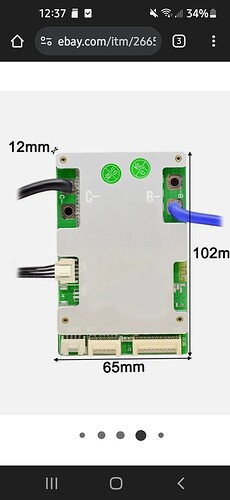

JBD makes a really small smart BMS for peanuts these days.
Just found this amazing item on AliExpress. Check it out!
SG$18.98 37%OFF | JBD Bluetooth 7S to 14S 13S 48V 52V Lithium Battery Protection Board Smart BMS Balance 24V 36V Li-ion 8S 12S LifePo4 20A 30A
https://a.aliexpress.com/_onrCXfq
(Edited because I linked the wrong one originally.)
That specific JBD model linked says normal, not Smart or Smrat, like lots of JBD product descriptions.
I got a Daly 20 amp normal and a 20 amp smart JBD ordered, looks like both cleared customs.
The JBD is pretty big , but with enough cursing, I could make it work, I think.
But will likely use the Daly, and save the JBD for when I can afford 50 p42a’s and transfer vesc to long cruisser

This is the bms he wanted to show you
https://www.aliexpress.com/item/1005006270799101.html
Ya. I did a dum.
If the noise returns, i was thinking of tapping the two small holes Id drilled in order to tap the bearing from the cap, and inserting grub screws to push against outer race…
I’m hoping the order of reassembly makes this unnecessary…
It likely would definitely have been, had I not been an idiot and tried to seat the bearing deeper in the cap the first time i had it apart.
That is the bms I should have ordered. I guess it needs an external BT module plugged into its uart port, where the larger 35$ one i ordered has it built-in?
I’ve yet to order anything from aliexpress.
The little bms has built in bluetooth as well
Wish I were aware of that smaller JBD before ordering the one I did.
I won’t be requiring 17s.

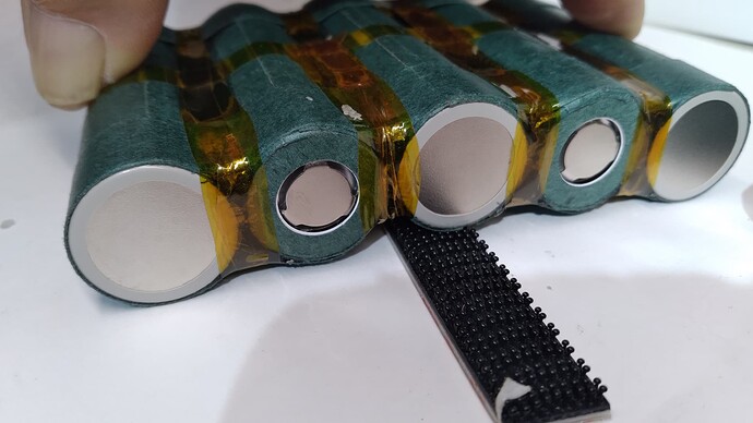

I like this Kafuter K-705 silicone. It dries so clear, and remains highly flexible.
It’s also pretty thin viscosity, and will self level to a degree, and can be influenced by airflow, to form the skin and slow gravity’s flow, at least in 68f /20c ambient temps.

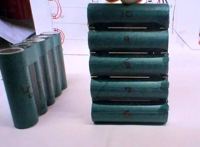

I wrapped my 10 P42a’s in fishpaper, then used fiahpaper dots to separate them a bit more, clamped them together, then kafutered them, both sides, several days ago.
edit. The kafuter also has zero smell.
E6000/amazing goop/shoegoo, smells for weeks.
Mmmm Mmmmmm, tolulene stank.
There are two fishpaper rings, and two layers of fishpaper on the cell shoulders.
One wrap of kapton around all 5, then 4 thin strips between the 5 to cinch.

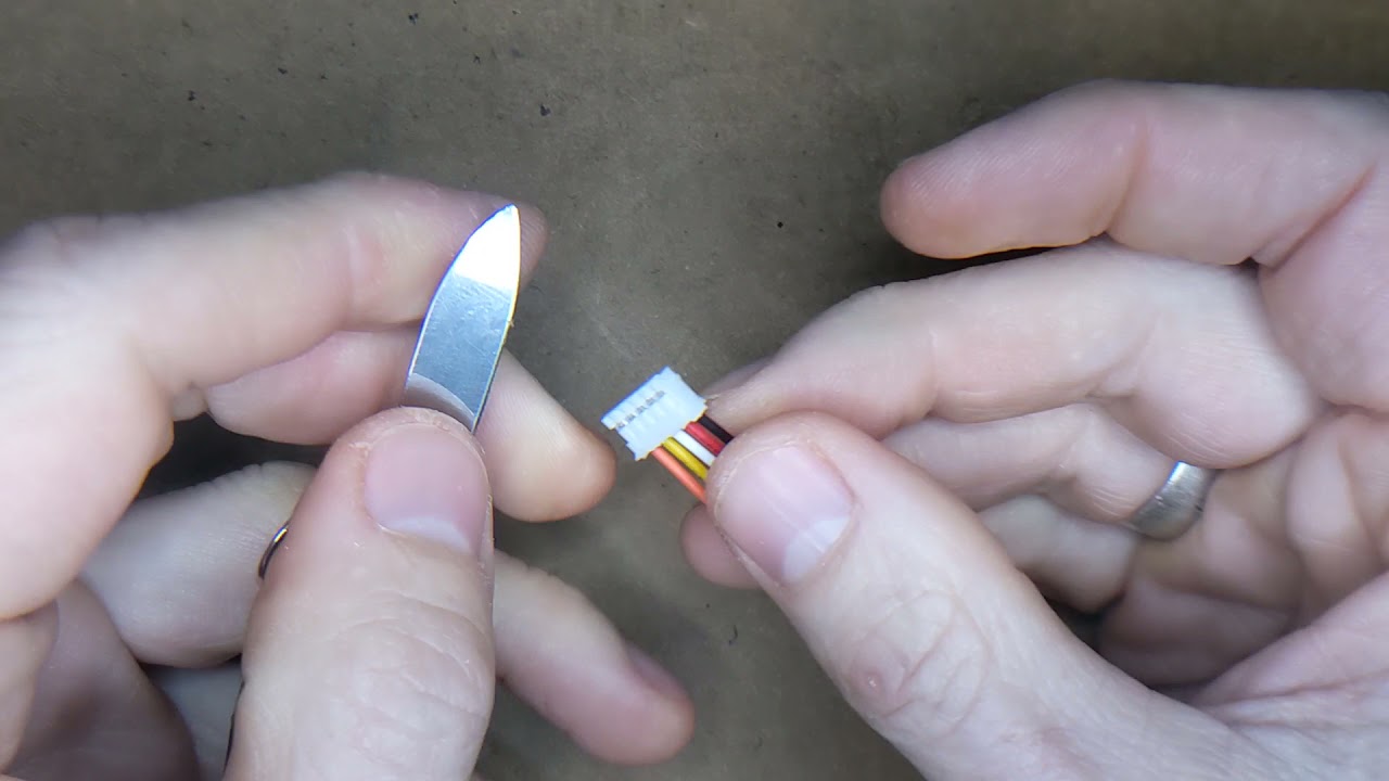

All my hub motors have 5 pin sensor connectors.
I have 2, silicone wire 6 pin JST pigtails
I was thinking about splicing the 6 pin pigtail into the 5 pin sensor wires, and have two sensor connectors on each motor, and be able to plug my 83mm hubs into Vesc, or back into regular Puaida (or nuclear cockroack lingyi) Esc.
I’m thinking the Puaida ESC needs to go into diagonal mini, once I finish its battery and its enclosure, and the Flipsky 6.6 needs to go into my recent enclosure.
But If I fatfinger and mushbrain the Flipsky into magic smoke, I want to be able to return the Puaida with a minimum amount of hassle.
Is this a bad idea?
I figure I’d heatshrink the connector not in use.
I guess a female 5 pin to male 6 pin adapter is a possibilty, but is more resistance, and another potential failure point, and I’d have to order and wait.
Is there other considerations of this 5 pin to 6pin thing that have overlooked?
5 pin is just hall and no temp sensor, simple plug and play and shouldn’t be a hassle. I just take my 5 pins and put them into a 6 pin connector and skip the temp sensor but i also have them running into a connector so taking my enclosure off is easier as i can brake the male female connection there instead of at the esc. Haven’t had any issues so far but my connector is either mechanically screwed together or taped just to keep it from rattling loose.
Yep im with @pecos
I’d just take the wires out of the 5 pin and put them into a 6 pin. It’s pretty easy to do and the original housing will be reusable still no worries.
I use an exacto blade, but you can use anything small and reasonably sharp.
Thanks, I hadnt though about swapping wires into different connector shells.
I did once try to swap wires on a JST on a voltmeter, pressing down on the metal tab, without success, but had another 3pin JST that didnt have red and black swapped, and i just slid some yellow heatshrink over the extra black for the Vsense.
