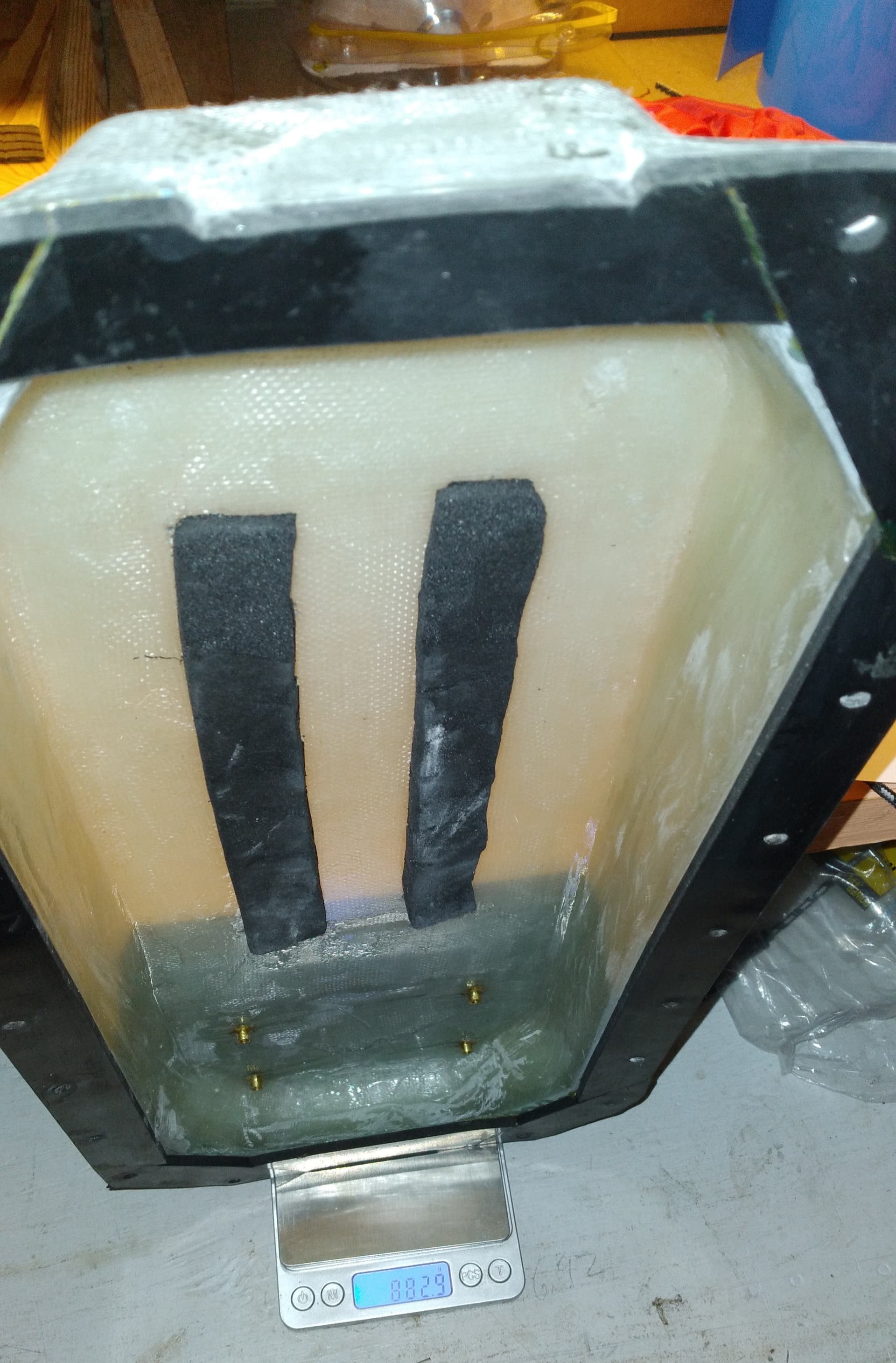

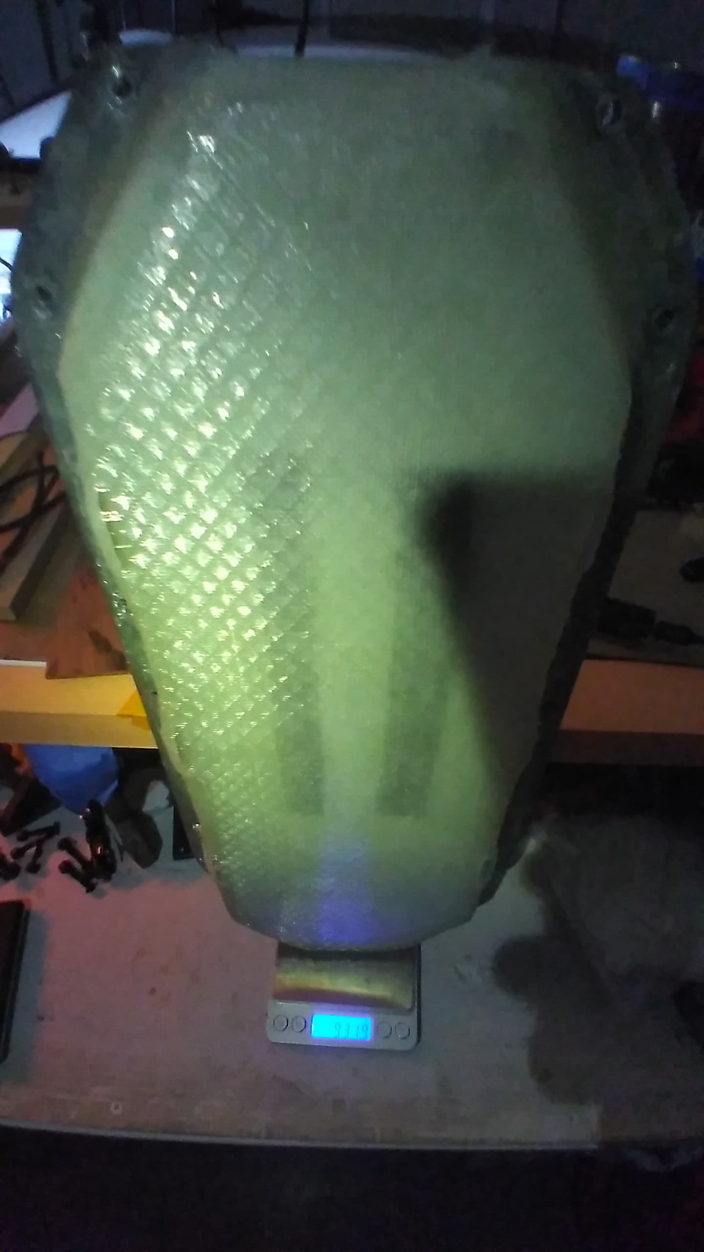

That’s the thickest area by far, but yea, it is pretty heavy.
The gasket material was a poor choice too, if I was worried about weight.
I always preferred my surfboards on the heavy/durable side too.
I’ll see if I can weigh it somehow later.
It should not max out my 3000 gram epoxy scale
About 890 grams
Oh that’s not too bad!

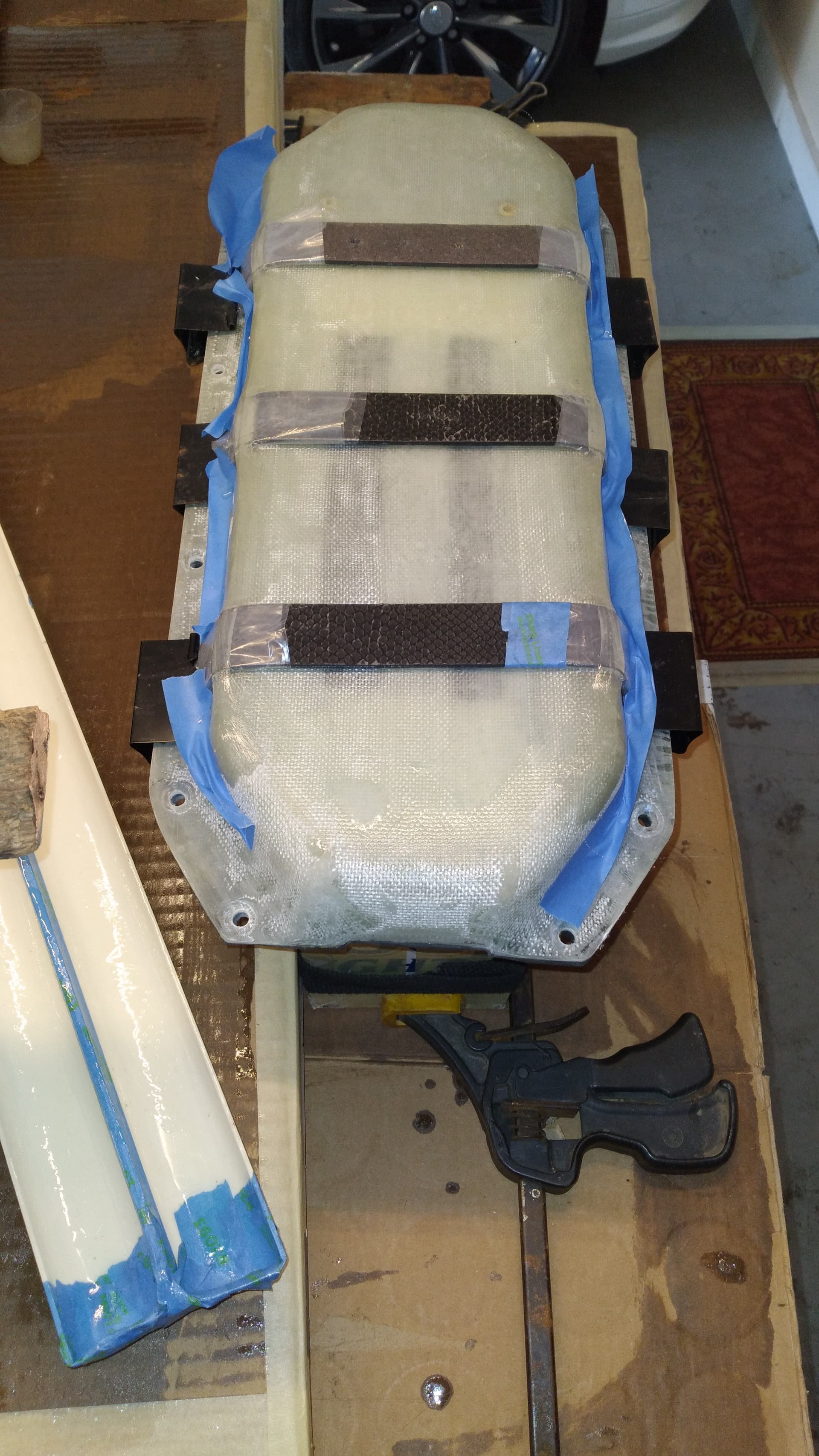

I made the vertical sides a lot thicker than everywhere else.
After adhering the 0.5mm G10 strips to widen the flange, there was a fairly big lip on the interior underside, which i filled in , in 4 stages , with unidirectional fiberglass tow/roving/fin rope.
I knew I’d have to recess the power button and charge ports, and the swiss cheese nature of such an area would benefit from the added strength.
Also, I didn’t find any XT30 panel mounts, or Anderson Powerpole panel mounts I like,so figured that thickness could allow me to drill dremel and file to precise size, without having to add support later…
Hoping to maximum ease of future adaptability at a later date, and I have a tendency to overbuild everything anyway, whether I intend to, or not.

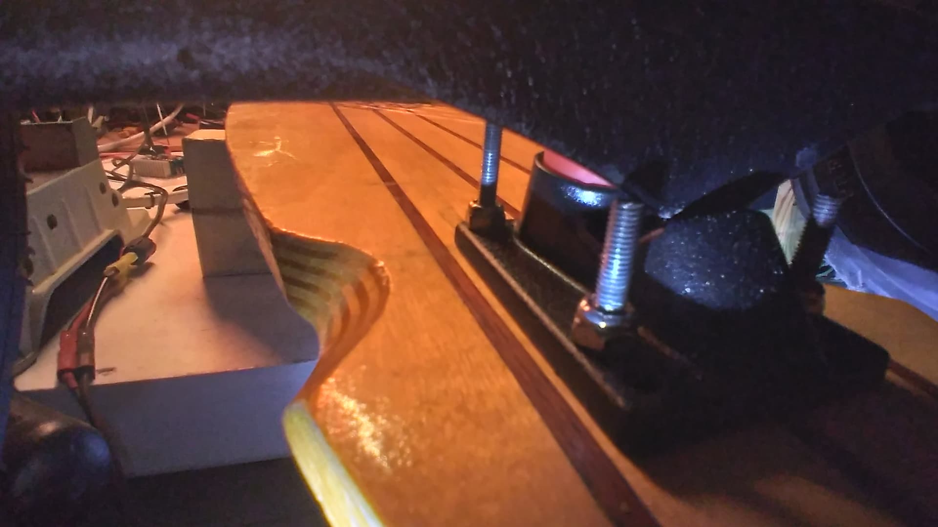

The 99$ mini 7s1p single hub motor skate I first bought, with 7s2p and a second hub motor on front truck, proving to be a capable kayak tow vehicle, has me rethinking everything, as does my long cruiser skate on 10s with 8" pneumatics on front.
The mini could get 10 p42a’s, and likely go faster with far more range than i need it to tow the kayak on the new asphalt. Its smaller and lighter, and so easy to take into beer store. Respectable range with 104watt hour and 10s1p of p42a is 151.2wH.
It almost makes the midsize 700 watt hub motor board, redundant. The 10s enclosure I made for this board is likely to spend more time strapped to my long cruiser, until I make a dedicated enclosure for Mesc6 12s unknown#p for the cruiser.
I want the cruiser to have 4 pneumatics, nkt just 2 with 2 80mm urethane hubs pusbing, but am still enamored with the quiet hub motors and the long free roll, and can’t budget cells for 3 operational boards at this point.
22mph only seems fast, sometimes.
Definitely would enjoy more acceleration and stronger brakes.
I added more weight to my enclosure today.

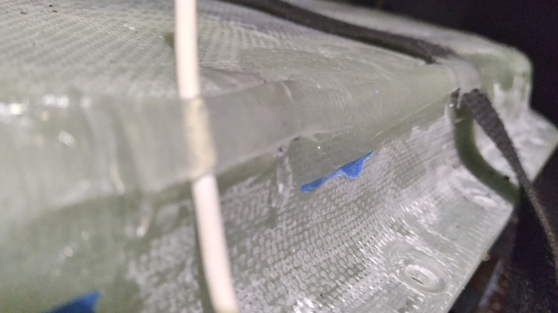

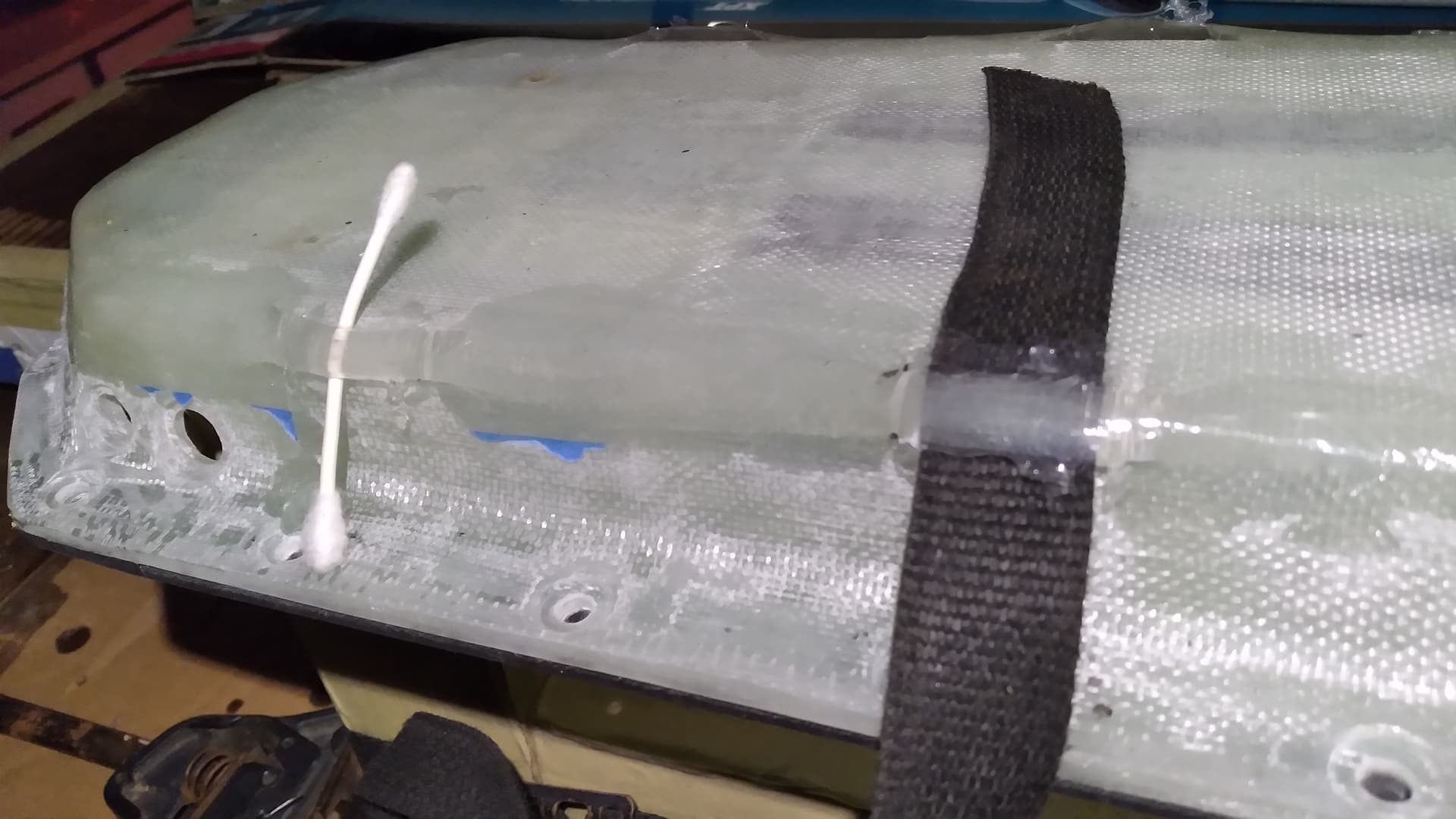

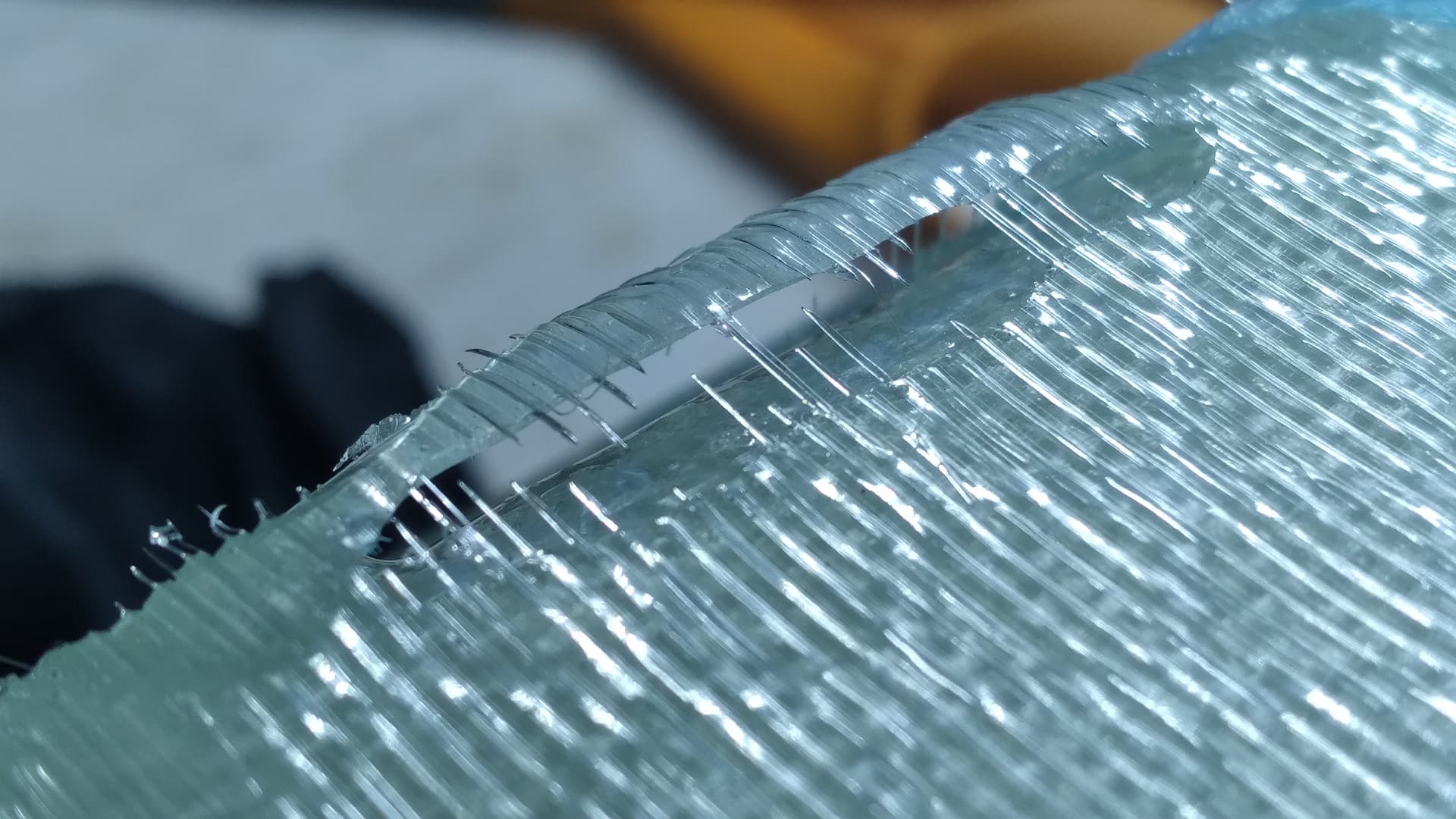

Surfboards, have either leash cup, which are resined into a recessed hole drilled through the fiberglass, or they have fiberglass ‘leash loops’ made with unjdirectional roving/tow/finrope, laid atop the fiberglassed shell.
The latter can be far stronger, but is not as accepted a method by stupid sheep surfers who cant determine quality on their own and need a logo to do that for them.
The glass houses also prefer to drill a hole and insert a leash cup, and let the sander deal with the rest. The leash loops.require.more skill to do cleanly and are harder to sand around, in a.production setting.
I added 3 fiberglass leash loops on each side of my enclosure, to make it easy to cinch velcro strap to my long cruiser skate.
The old waist belt, is wrapped with polyethylene plastic. Epoxy will not stick to it, the saturated roving laid across.
When epoxy has had some time to thicken and harden, there is a time window where it can be molded like a hard clay, aopens uo ootions and can reduce sanding requirements.
These leash loops will not reduce ground clearance, and will contain the velcro cinch straps, and add some strength.
I love having attachment points, without having to drill holes for fasteners.

I just pulled the polyethylene’d belts.
Not my best work, but function before fashion.
I’ve nearly run out of roving,
Wish i knew where to buy some locally, that is not both folded, and far over priced.
It’s a sin to fold fiberglass.

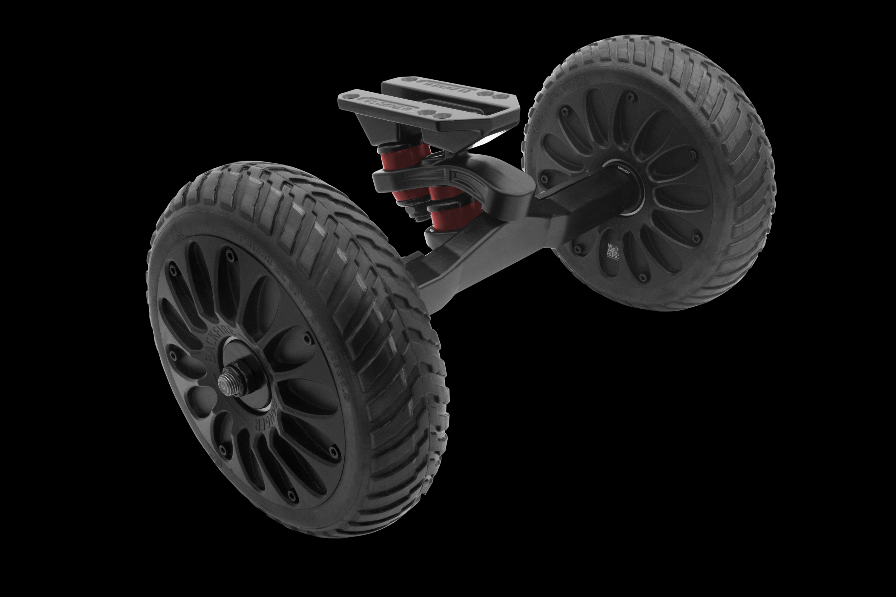

@SternWake have you thought about h7b motors like these
Bookmarked.
Interesting 9 pin connector.
Wonder how those tires feel compared to pneumatic

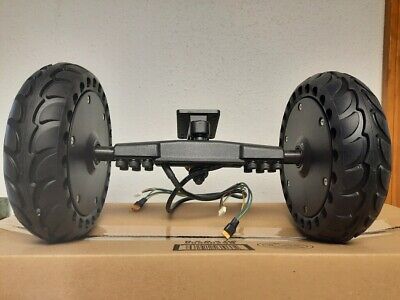

I see this ebay option too

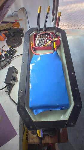

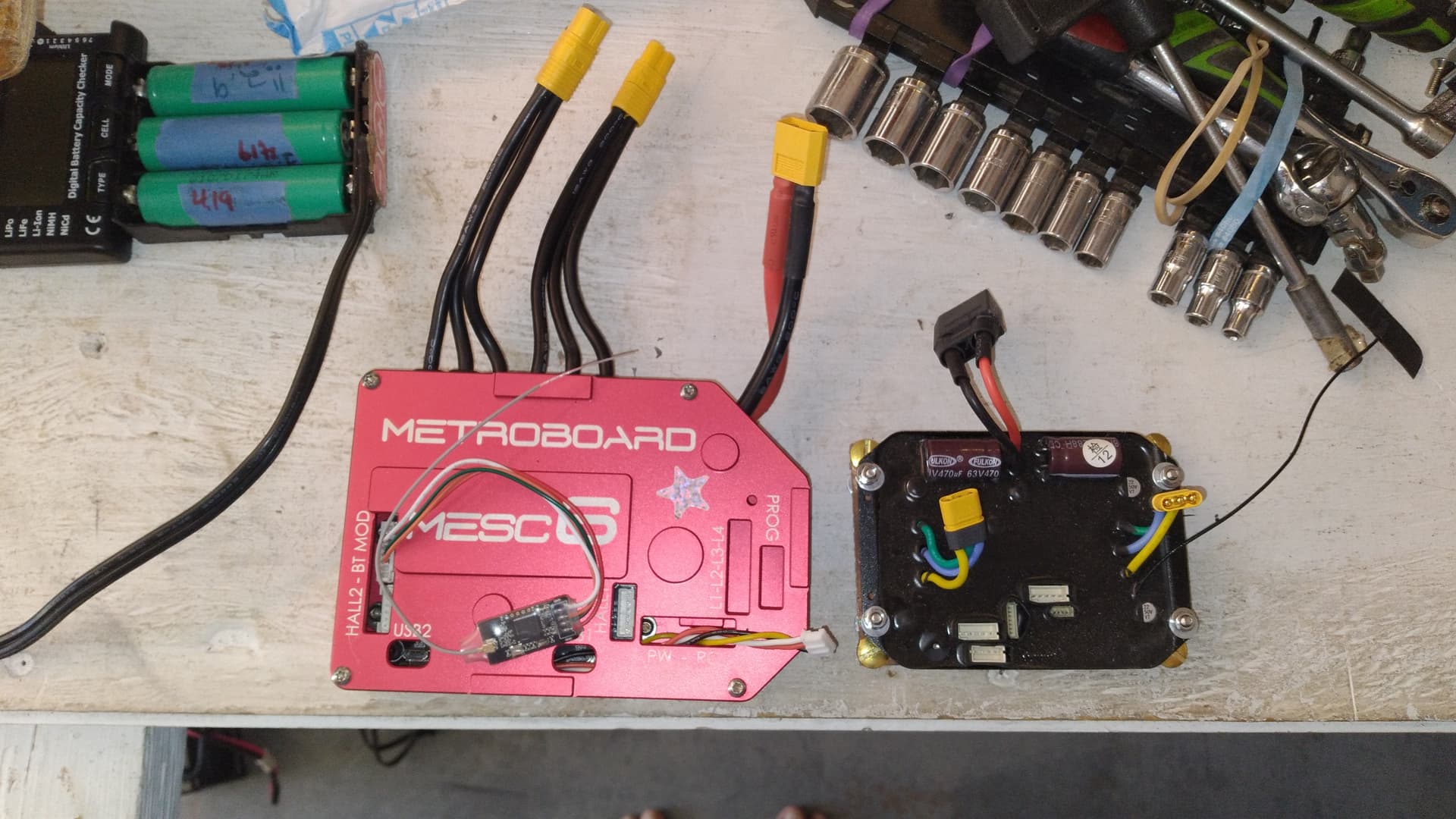

The Mesc6 aluminum casing is pretty impressive.
I love that it has 8awg to the battery.
I could certainly make it work in this enclosure, as is.
I think I will build segmented enclosure for the flexi long cruiser, around it, and 12s perhaps 4p p42a battery.
battery.
It’s so excessive and it’s mostly cosmetic. It’s also almost impossible to desolder… Dont get me started :rofl:
I was thinking a small 20amp dumb BMS might fit where the LED driver once resided, if the 8awg was angled a bit different.
I like fat copper. One less source of heating in a tight enclosure where everything is making heat.
Says the guy with 10awg, and XT90s, on a 30 amp 10s2p

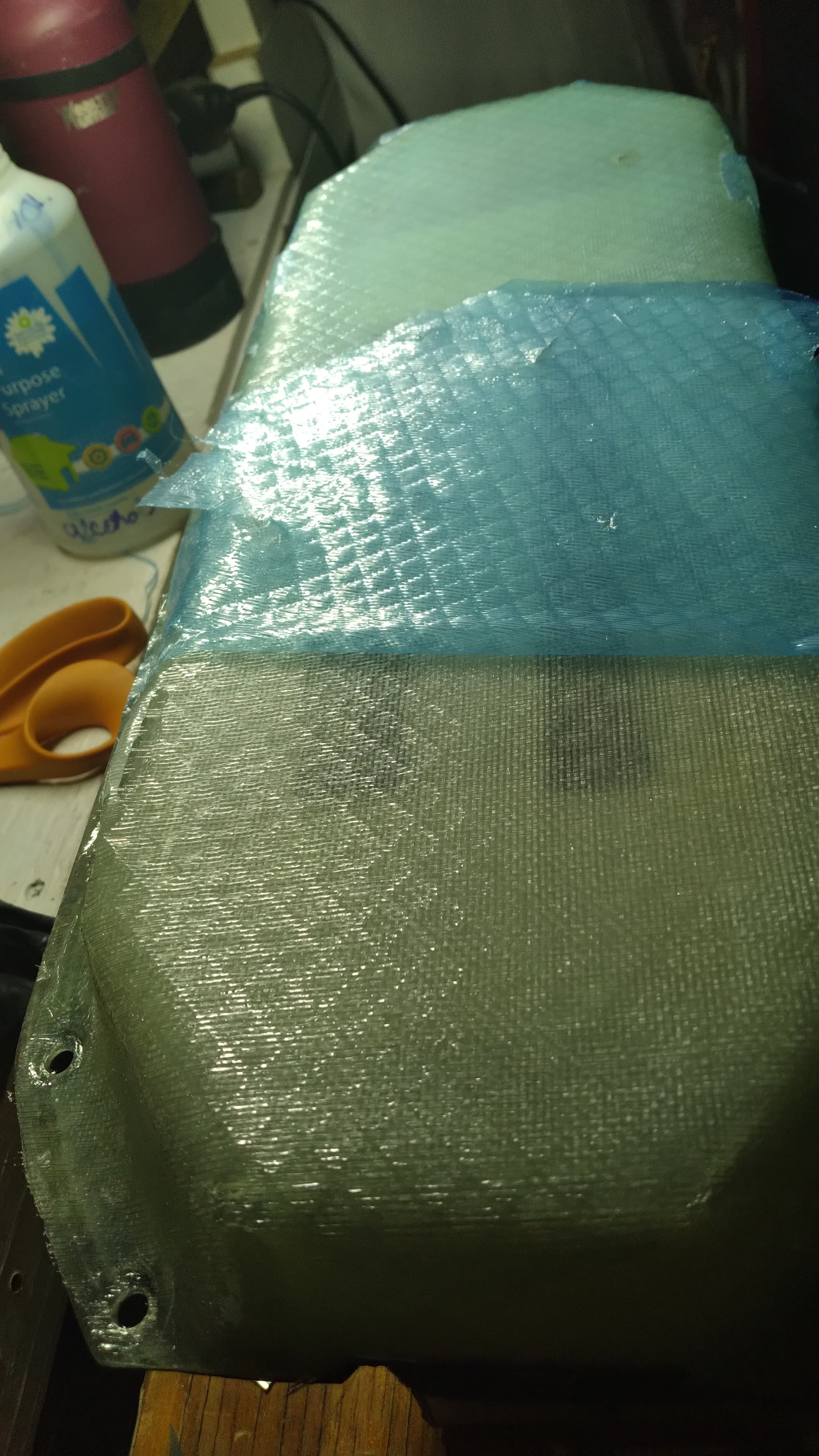

Tried a different method with the final layers of epoxy.
I saw this large ziplock bag, that has a pattern designed to stretch.
I did not sand my enclosure perfectly flat. I applied 45 grams of epoxy filling the sanded weave, which was about 10 too many.
This layer thick layer fisheyed, some areas just repelling the epoxy, as expected.
I mixed 20 more grams about 40minutes after the first layer tacked off, and applied another layer.
This one was not fisheyeing but i laid the patterened ziplock freezer bag tightly across, and cut reliefs at the corners, and squeegeed from middle to edges, made sure the recesses for truss head screw heads did not fill up.
Babysitting it as epoxy thickened, and once it laughed at gravity,
The diagonal drive mini towed us to the kayak launch.
Just peeled off the ziplock baggie.
I’m kind of digging the texture.
Upto 932 grams
