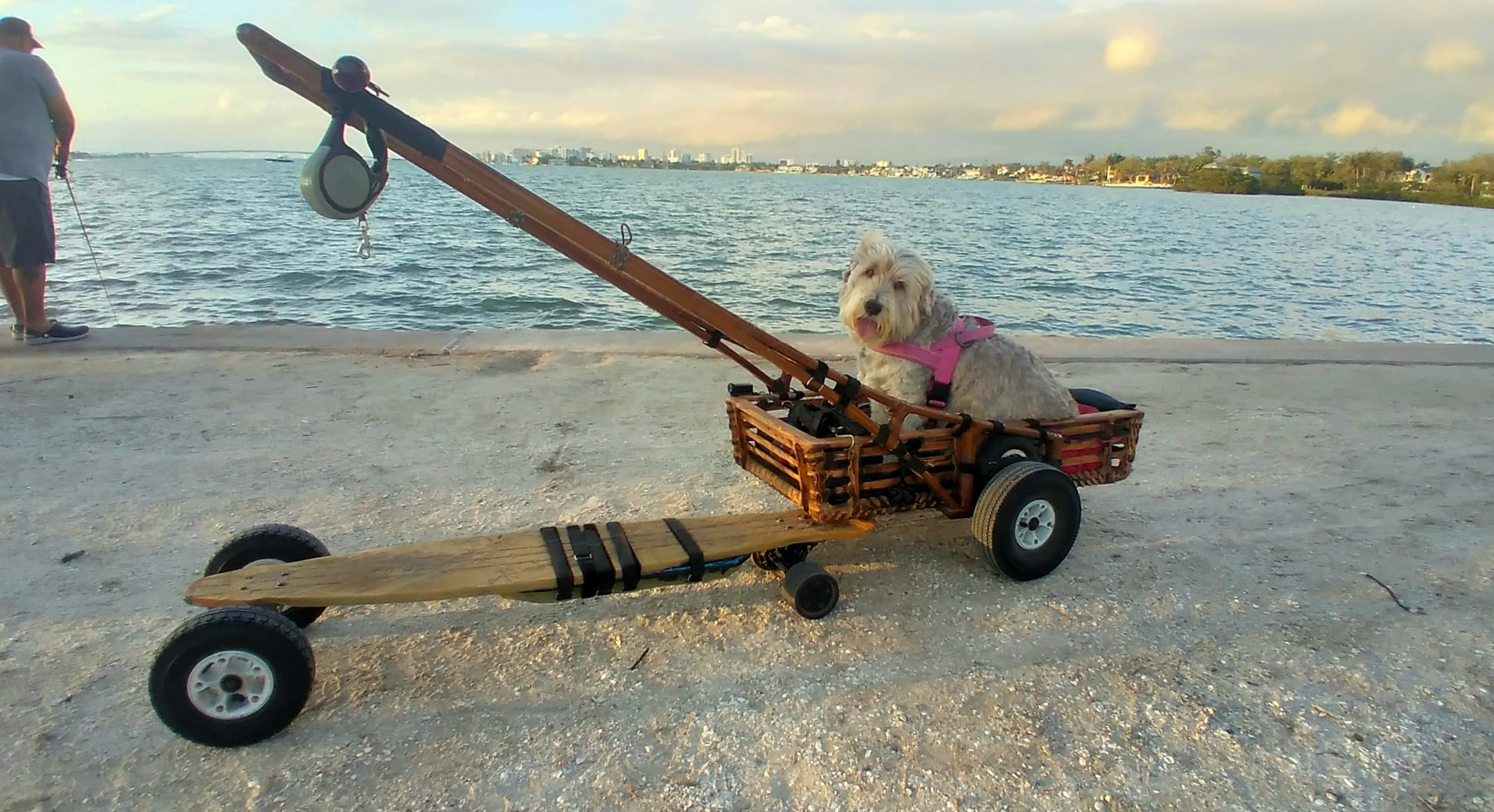

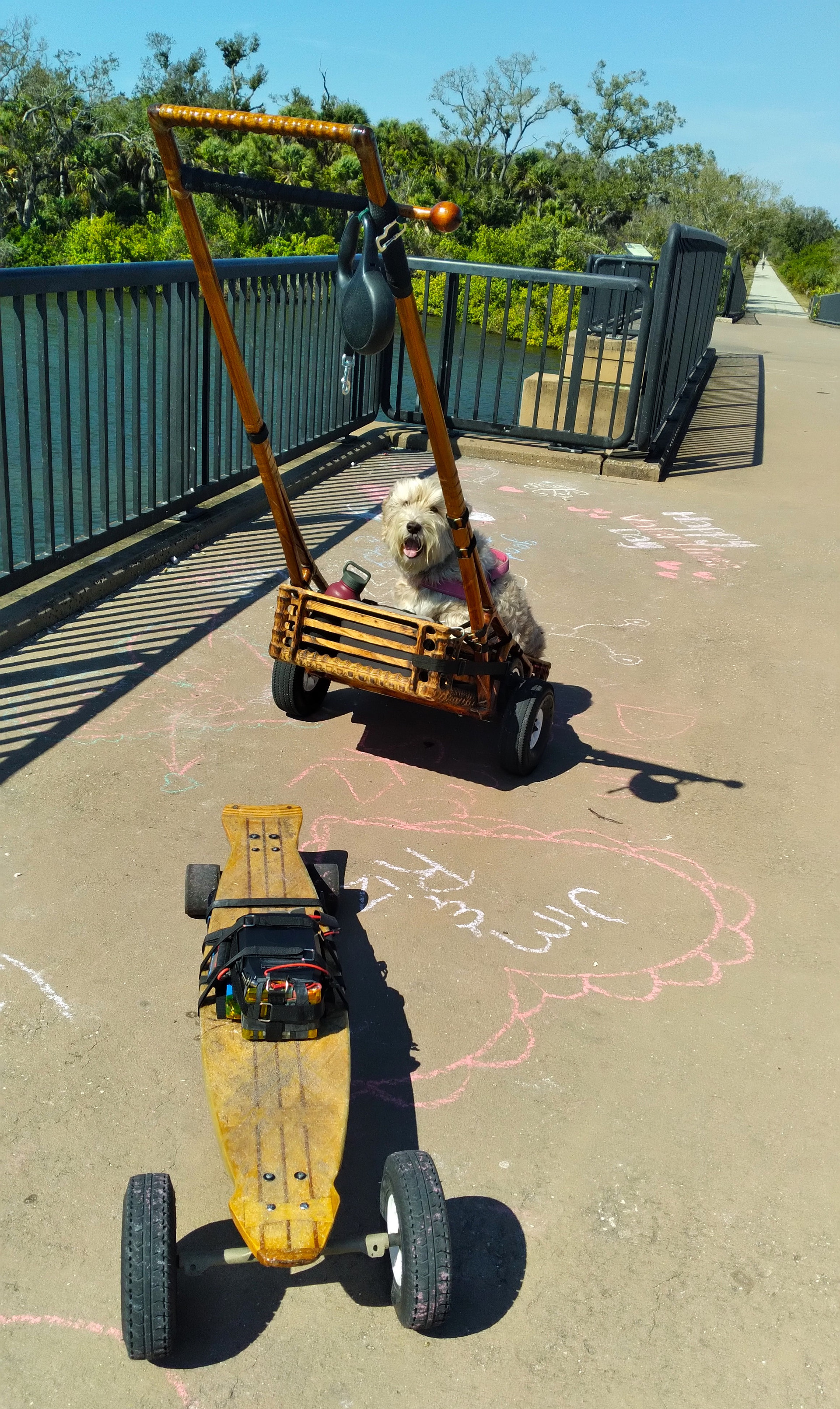

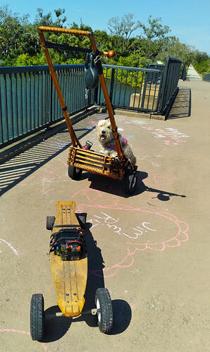

Today was our Longest roll yet.
Nearly 34 miles/54.7 km round trip, and new areas explored.

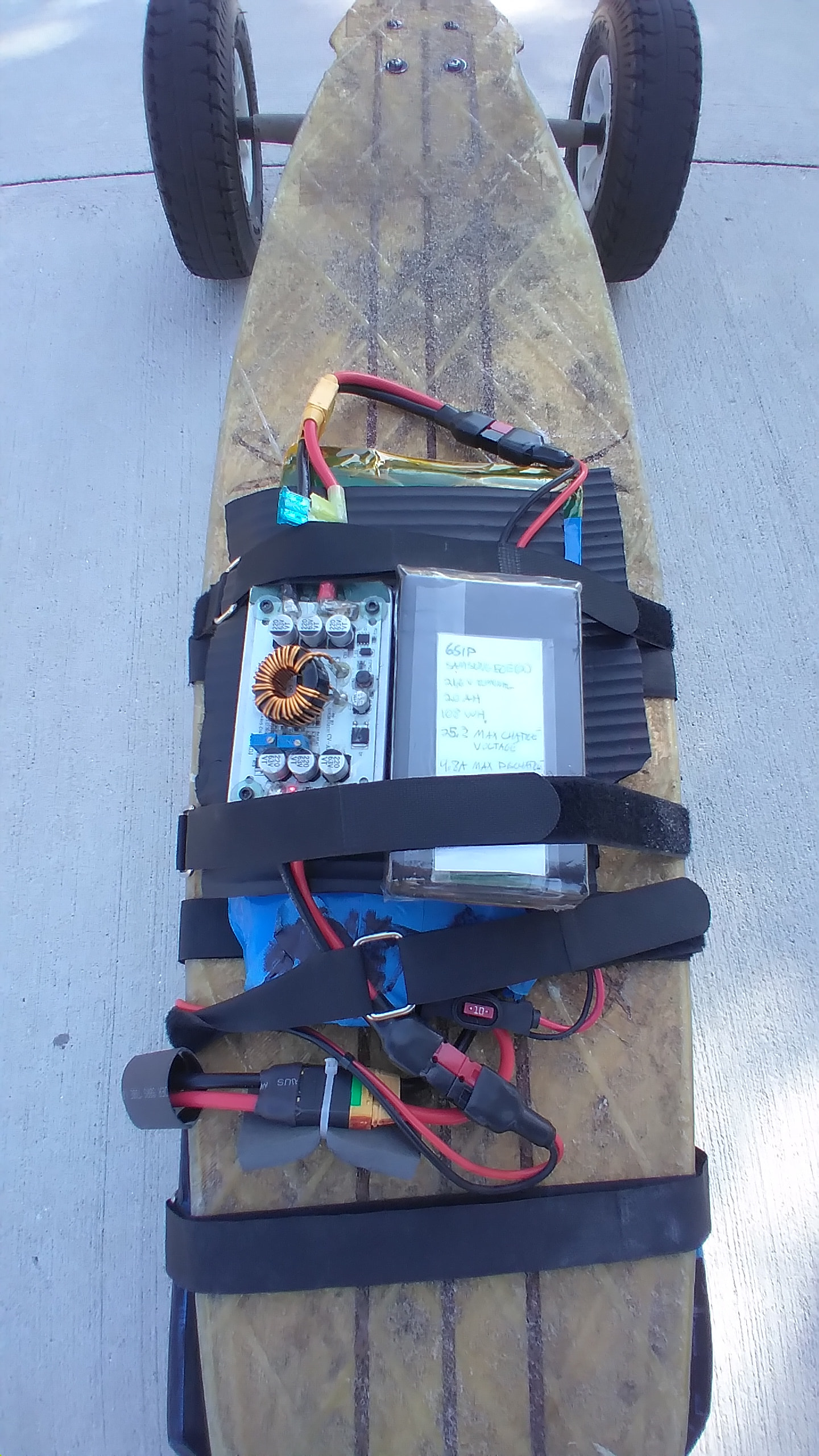

I have not yet finished the 10s2p Tenpower 50XG.
I strapped my old 187wh DMEGC-26E 10s2p to the deck between my feet and plugged it into the parallel XT90 panel mount ESC feed, so it is in parallel with 10s2P of BAK45D.
I then velcro cinch strapped the 178wh/7.0AH 7s2P EVE35V porta-charger on top of the DMEGC 10s2p, and I plugged the 103.7Wh DMEGC20P 7s2p into the porta-charger’s charge port, and strapped that to the portacharger. The CCCV booster inside the porta-charger had output amps set at 5.7 seeking a max voltage of 41.67v.
At about mile 5 we turned southward into a very strong, gusty headwind .

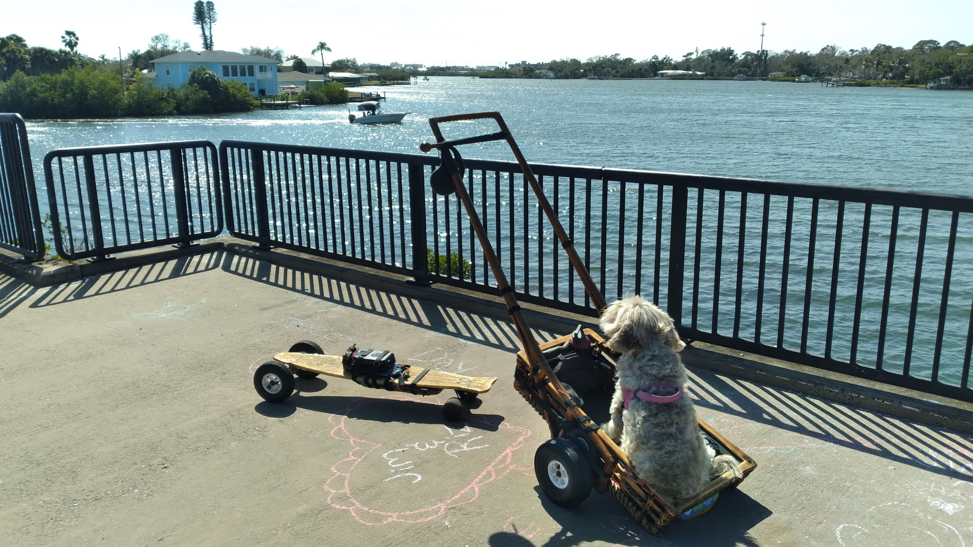

About 9 miles later we came to this bridge.
At ~ mile 16, I noticed the 7s2P parallel combo powering the CCCV booster was fully depleted. I pressed power button for booster, and turned around and found a shaded Picnic table to remove the porta-charger and extra parallel 7s2p battery. When I got to a good spot, I pressed power button again and booster turned on delivering 5.7 amps, but shut off again in 15 seconds, So off it came.
The 162wh 5s2P Makita battery I built with BAK45D cells and 0.3mm copper busbars, was then strapped to deck next to the white “600 watt’ booster, dialed to ~170ish watts output and we rolled quickly north with a strong tailwind.
The white CCCV booster has a recommended 10 amps max input and a 15 amp fuse, So I dial it down for 5 and 6S batteries, so when input voltage falls towards 2.7 volts per Pgroup, input amperage does not exceed 15
170 watts was not enough to prevent the 10s2P batteries from slowly discharging further, and I got a couple remote low battery warning buzzings when passing Ebikers, but it would stop when I let off the throttle and slowed back down.
I was getting a bit anxious that I would not have enough battery to roll all the way home, and was wishing I threw another power tool battery into the chariot, just for a bit more buffer.
I moved back on the deck, putting more of my weight over hub motors and less on the pneumatics, for less rolling resistance and tried to keep it under 20mph..
When the Makita battery was depleted, some 7 miles later, I swapped my Samsung 6s1P Samsung 50E to power the booster, and this got us to a park about 2.8 miles from home with the same remote buzzing the low battery warning off and on.
At the park, I swapped the 108wh/ 5.0AH Samsung 50E 6s1p with a 7s1P 2.2AH 55.4wh prebuilt battery using unknown 18650’s, and dialed down booster output wattage to less than 100, and we walked a hundred meters, then rolled towards home fairly timid on the throttle with a lot of remote buzzing in my grubby paw.
The last 1/4 mile was in full sag mode, despite still charging at 100 watts.
The 7s1P was not too hot when we returned, and I should have bumped it to perhaps 150 watts and then not had to deal with the slow speed soft cut.
So we made it with just a little extra to spare.
The 7s1P is now down at 25.2v, and the paralleled 10S2p batteries were down at 30.5v and the ESC hard cut is 30 volts.
So 324+187+178+104+144+108+~ 30 watt hours to roll 34 miles.
So roughly 1075 nominal watt hours to tow Fiona 34 miles, averaging roughly 31.6 wh per mile.
Rolling into a strong headwind no doubt chewed up a lot of battery. I was trying to keep it under 18mph. There were some very strong gusts and i’d try and get lower and more aero during them just to maintain 18mph.
Rolling back with that wind, I was waiting for one of those gusts, and heard it coming in the trees behind me, and nailed the throttle, and got upto 33mph.
There was no apparent wind at that speed for a little while. That is as fast as I have ever gone, riding Solo or with Fiona.
If I had carried an extra power tool battery or 2, I would have travelled faster. There were a few empty sections that are so smooth without warbles it would be idea for testing top speeds on a more capable machine than min, especially with a strong tailwind.
The portacharger at 5.7 amps max output was not able to keep up with the load, rolling into the strong headwind.
The run the other day set at 6.15 amps output it was able to keep up rolling fast, but the EVE 7s2p got too hot.
It did not even come close to getting too hot today in parallel with the DMEGC20P 7s2p at 5.7A max output and a LOT of airflow.
My feet started getting all tingly more than once, the first time that has happened to me, but I doubt we have gone 34 miles in one day before. The previous max was 25ish miles with longer rest/charging / walking through the park breaks.
The trail continues several more miles from where we turned around today, but I think it turns to wide sidewalk cracks which suck with hub motors.
The 187wh DMEGC 26E 10s2P is old and probably wasteful of charging current.
Looking forward to its third retirement.
The 360wh Tenpower 50XG 10s2P will be going into the enclosure and the 324wh BAK45D 10s2p can then be the optional top mount 10S2p range extender battery.
I should finish the TenPower battery right now, but I am beat, and need to go sink into the couch.
Fiona is snoring loudly. I think her butt gets as tingly as my feet do when rolling for that long.

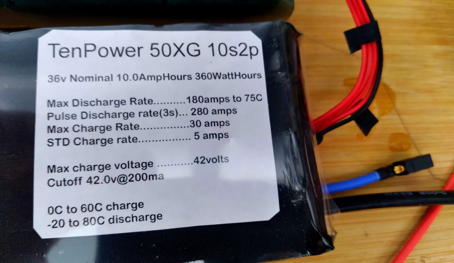

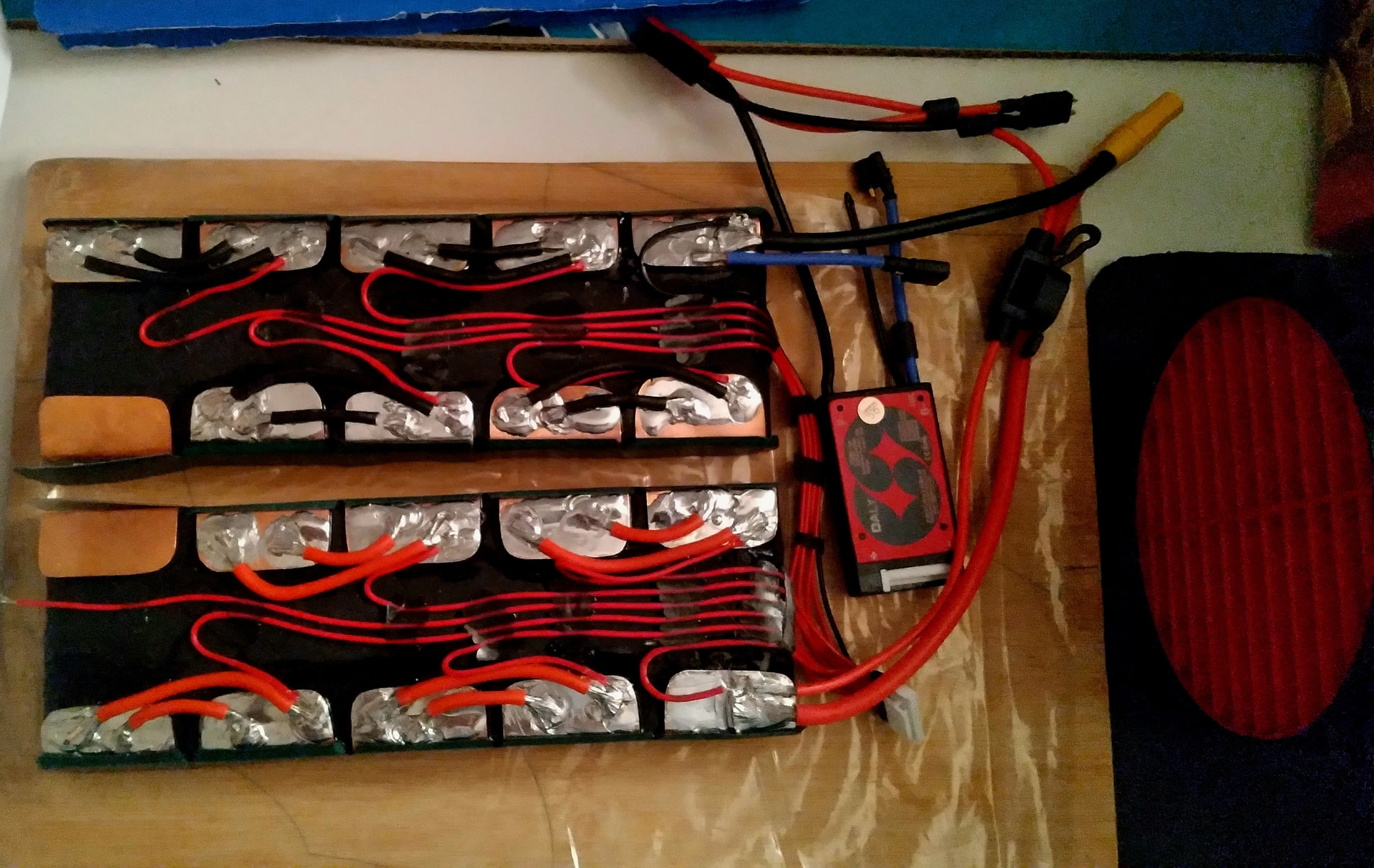

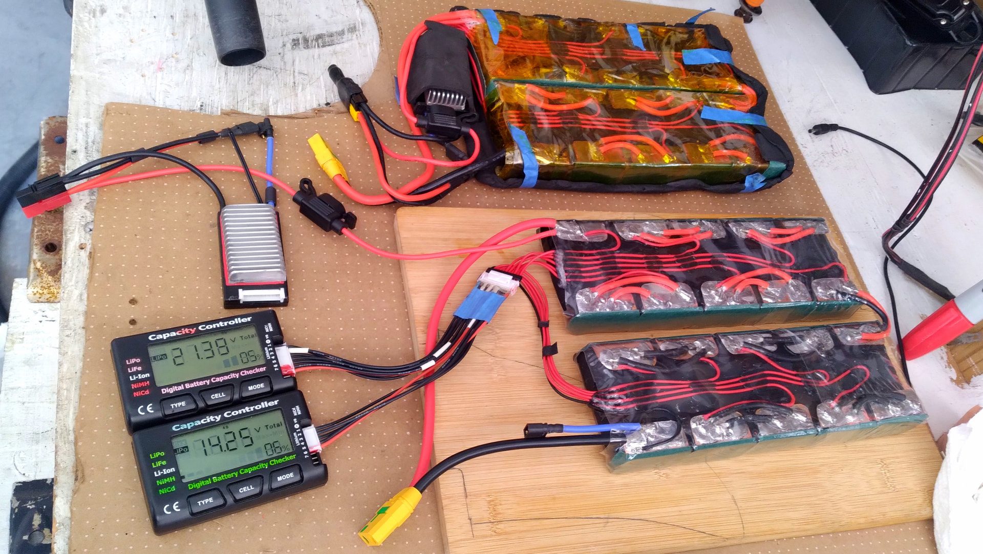

Been slacking on finishing my Tenpower 50XG 10s2p.
The BAK 45D 10s2p has about 540 cycles on it and ~ 2400 miles and is still performing well, but obviously not like new any more.
I figure when the TP pack has 2400 miles on it 6ah Tabless cells should be available
Saw a PT today about shoulder.
A lot of the recommended exercises so far are very similar to holding the chariot handle while walking Fiona, and rolling at speed carving, but clenching all those muscles surrounding shoulder harder all the time, and bring my hand closer to my hip or in front of it, instead of behind me when possible.
I got a bunch of 2 times a week appts lined up for a month, but I am hoping for more targeted strengthening of what is left of my shoulder muscles to prevent re dislocation and injury and slow the rate at which arthritis further develops, for as long as possible.
Supposed to rain later so after returning home, took an extremely Eager Fiona for a early afternoon roll.
Left at well below full charge but took the portacharger in chariot.
Should have just strapped it to the deck instead before leaving. Chariot charged esk8 while walking across park after 5 miles of some very enjoyable wind assisted high speed carving with clenched shoulder and core.
Dialed portacharger upto 257 watts while walking with Fiona across park.
Wattmeter said it delivered 0.98AH, 37wh into esk8 battery when I wanted to roll instead of walk.
At home same wattmeter plugged into portacharger’s charge port indicated that its 7s2p Eve 35v read 28.54v, down from 29.35v.
The Eve35V has a 3.65 nominal voltage.
It Didn’t have enough time to heat up much today, it was only on long enough to insure I could return home with lots of throttle left, and… mission accomplished.
I would like to be able to use its full capacity at 8 amps output at 10S charging voltages the whole time, but the EVE 35v will get too hot. I can elevate the portacharger for airflow underneath and try and eliminate dead air space inside enclosure with more foam for better battery to enclosure heat transfer, but I doubt that would be enough to prevent exceeding 60C
Really should have got Eve 30P instead.
But I can always strap DMEGC 20P 7S2P to the Portacharger and plug it into its charge port to share the booster’s load.
And then I have a 2.2AH 54WH 7S1P too, that should be torn apart and rebuilt with JP30’s and 0.3mm copper bwahahahwahwhahaaaa

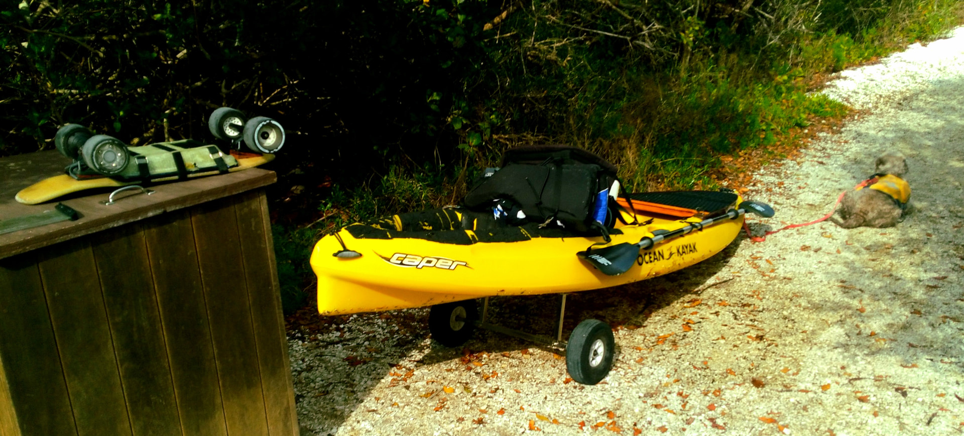

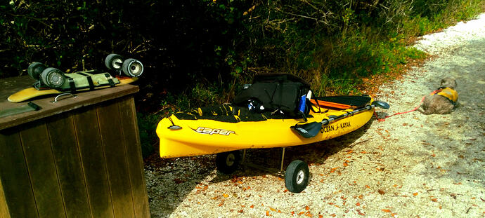

Today, we didn’t achieve our 10 mile a day average roll, but the mini did tow the Fionayak a bit more than 2 miles total, and I paddled us about 5 miles.
The mini has plenty of power to tow it over the crushed shell trail on torque level 3 of 4. Screw the cattle prod smuggling Karens.
They are going to start dredging the tidal toxic creek this month, so inland areas can drain easier.
Water quality will suffer and this could be our last esk8 roll from home to paddle for a while, depending on how toxic it appears to be.

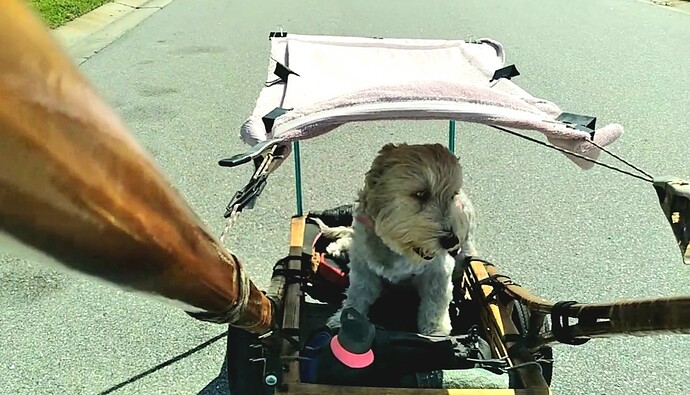

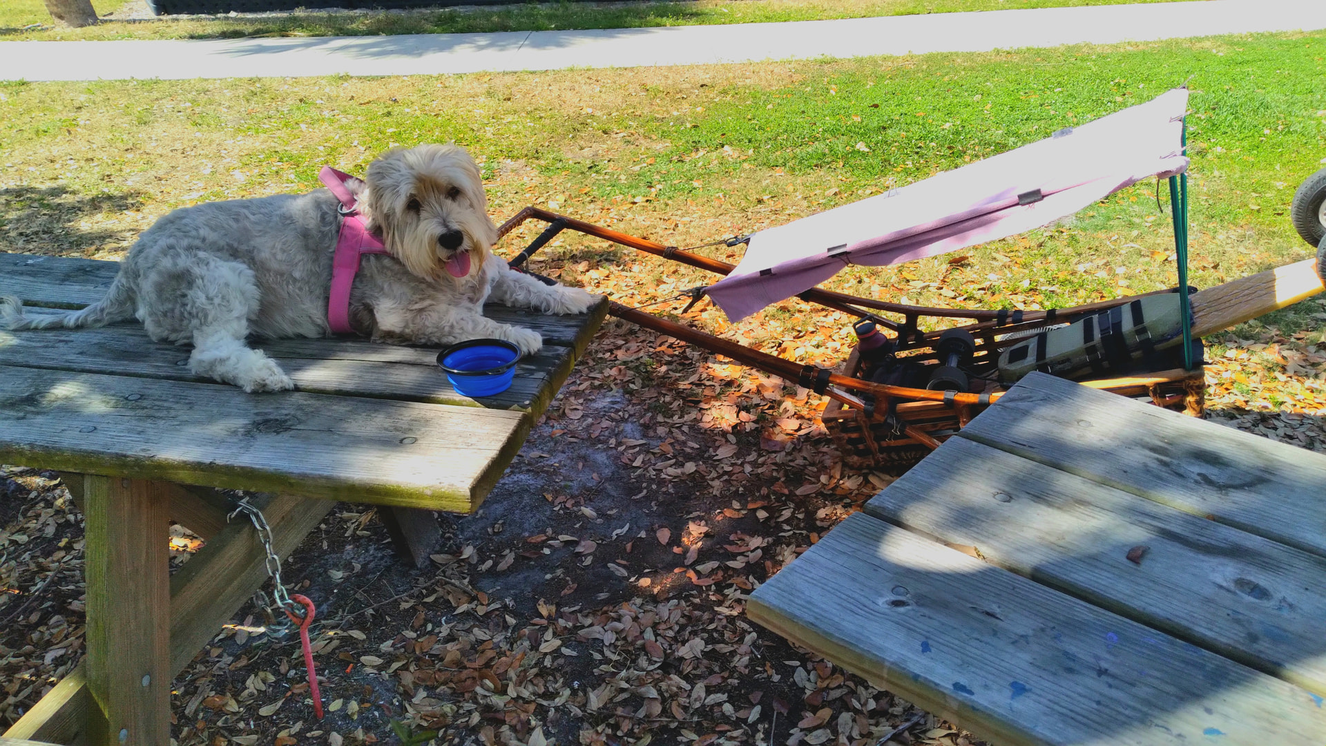

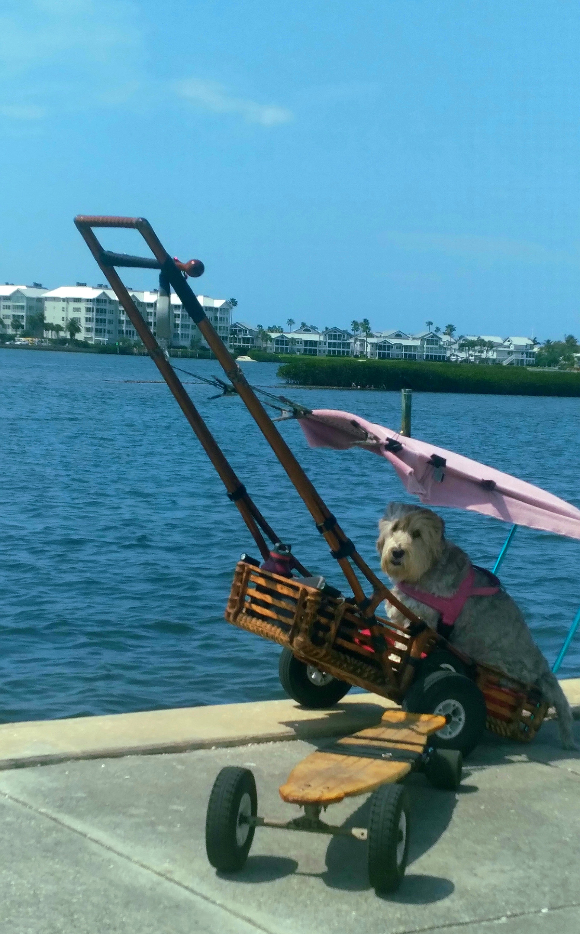

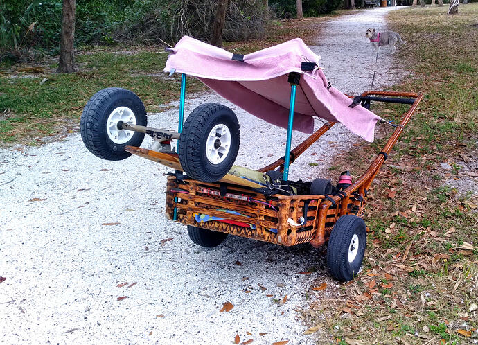

I was unsure how badly a chariot canopy/ bath towel would flop around at speed.
It was far better than expected, and Fiona seemed stoked to be able to bark at all the suckers who have to walk, with all her head and most of her body in the shade, Midday.
Tested to 26mph in gusty cross and head winds.
I can’t really notice any more drag in my hand, and seemed to lose no range.
The spring clamps and binder clips are just temporary as test of concept, But my temporary is likely a bit more permanent that I should admit.
I can pull the green aluminum tubes and lay it flat pretty quickly, as I store the chariot handle up against a wall with limited space to walk around it.

The Chariot’s shade bath towel now includes Teak and Stainless and Cork and a couple screws..
I can’t believe how stable it is at 25mph.

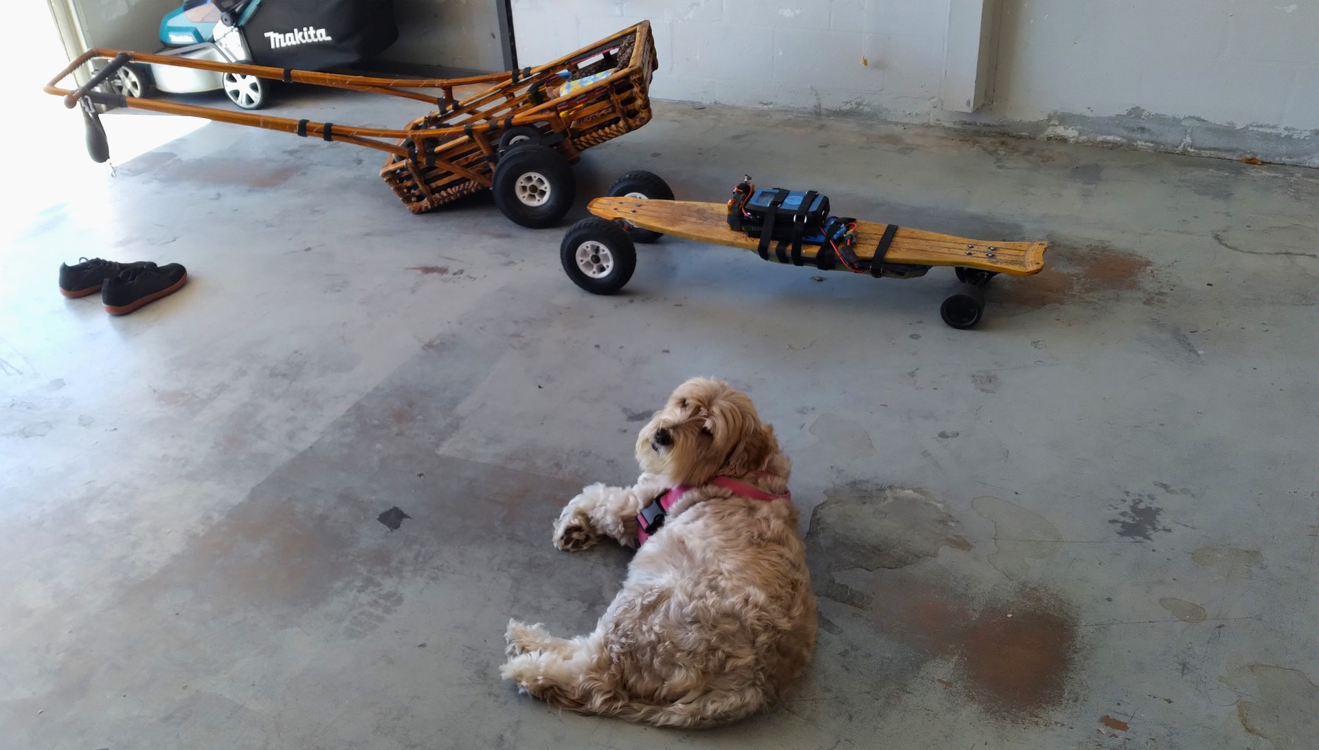

I then got an Esk8 so I could tow the kayak to the launch with her in the rear well.
She loved riding in the rolling kayak behind the Esk8 so much, I built her the chariot, and we have since rolled many thousands of miles together.

We just got back from an 8 mile roll.
I let more psi out of the chariot tires and am trying to keep it smoother and softer.
We still get up above 22mph on the straights, and then she starts barking with joy, and I join in.
She made another couple dozen people smile today, so far.
Got an appt tomorrow with her regular vet for pain management meds.
The new TenPower 50xg 10s2p allows for a noticeably extra spicy throttle, and does not drop nearly as quickly, once down below 34 volts.
Even in the 34v range the throttle responds with more gusto than before.
The BAK45D was still performing well, but with 500+ cycles and ~2700 miles on it, it has to have degraded.
I dont know if I will be strapping it to the deck between my feet as a range extender though.
It is getting hot again midday, and even shaded with a breeze, long chariot rides might be too much for the fluffy goofball to handle comfortably.
Many More miles rolled with the sweet goofball.
Her tires are down below 5 psi, and the inside of chariot is more strategically padded so that her sore mammaries take little pressure.

Scene of the crime. where i dislocated my shoulder 15 months ago.
I asked for my supraspinitus and subscalpularis back.
Didnt feel them knit.
But another roll with Fiona is priceless.
