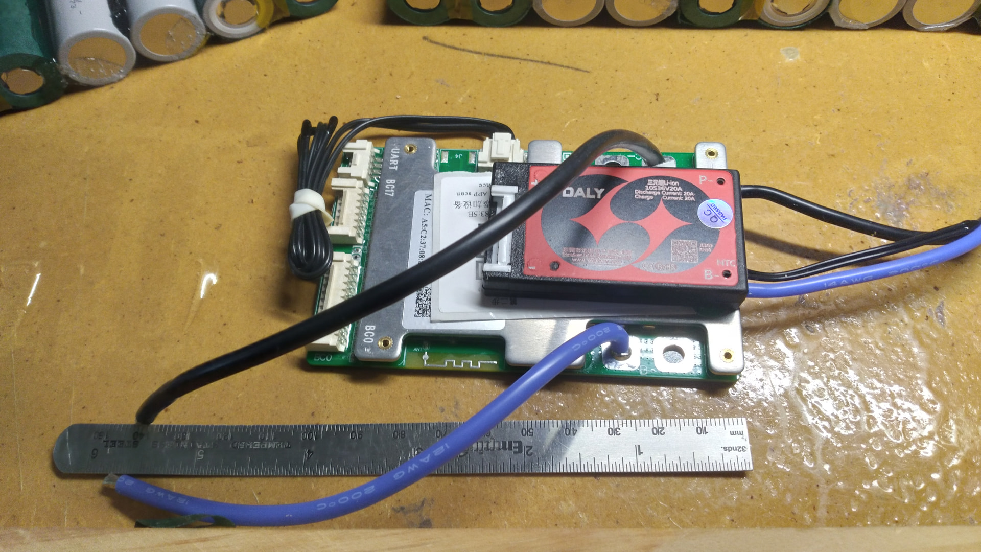

I have not yet tried a smart BMS.

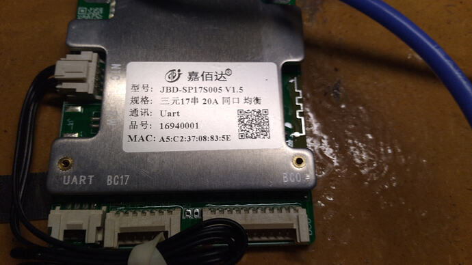

I have one, a JBD 10-17S 30 amp, but it is pretty large in comparison to dumb Daly, and would require a lot of new cable management in either of my enclosures, so it remains in its box.
I know smaller versions exist, but I just have not gone there yet.
I am dubious of the Dumb Daly’s ability to balance, as the one on my Dmegc pack definitely does not, but that could be my fault for ignoring the instructions regarding the order of hooking up the balance plug first and then B- wire second.
I do like the small form factor of the dumb Daly, and have another one for the Tenpower 50XG 10s2p build, but this a a newer version with 20 amp charge and discharge, 14awg, and a temp sensor.

I would have to do a lot of reworking things to fit my specific unwisely purchased smart BMS, and it is only 20 amps, not 30 as I incorrectly stated above.
The 20 amp Daly will drop into place.

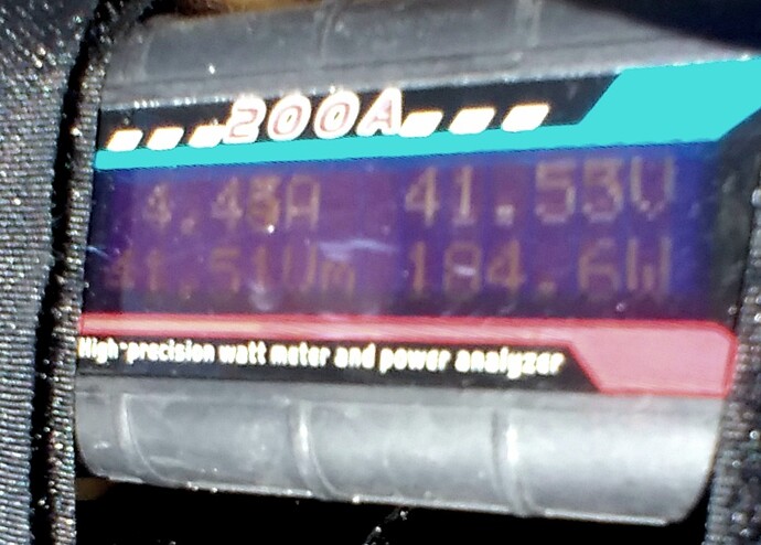

Second time that at the half way point, I strapped the portable charger to the deck, and then rolled and charged at over 7 amps.
This basically prevents 10s2p BAK45d voltage from going below 36v even with full throttling top for 2.5 miles of the 5 that I rolled with it attached.
i swear the throttle feels like the 10s battery is still at 39volts when charger is holding it at ~36.
I got to start a roll with it attached and charging.

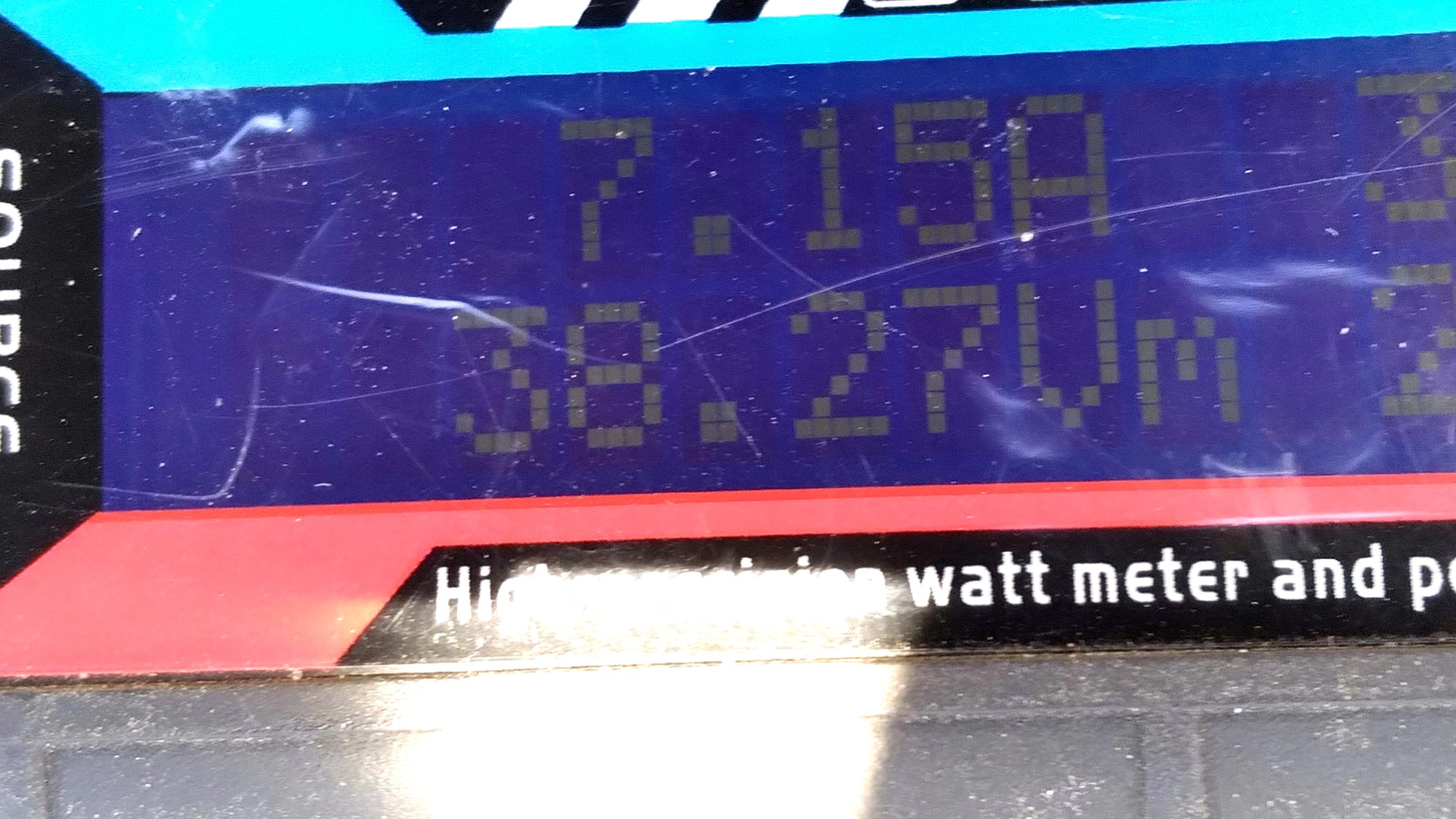

7 amps continuous output is perhaps a bit too high for the 178wh EVE 35v 7s2p feeding the booster, depleting it from 29.4 to the BMS’s LVD. The battery compartment exterior felt quite hot.
There is now a radiant and convective barrier between booster and battery the booster compartment felt cooler than the battery compartment.
The booster’s finned heatsink stays cool at speed at 7 amps output
Gonna dial it down to 6 amps.

We left for today’s roll with the portacharger strapped to the deck between my feet voltage unloaded set to 41.65v.
I spun the current limiting pot down a bit, but am not sure by how much.
At the 0.8 mile mark park we walked and sniffed for a half mile or so and the BAK battery was back at 41.65v accepting 0.00 amps when Fiona and the Esk8 swapped positions.
Got lucky with traffic, as the draw bridge cut off following traffic, and was able to hold a full lane for a few miles on end at near top speed without worrying about traffic wanting to pass me then taking the first right so I have to slam on the brakes.
At about 7.5 miles I leaned down and saw the wattmeter was reading 0.00 amps, So I pulled over and removed the portacharger from the deck. Esk8 battery was about 39.1v. The portacharger battery compartment was cooler than yesterday’s roll when I removed it
I was able to notice the board was lighter and more nimble between my feet without the portacharger strapped there anymore.
There is basically no noticeable sag for the first 7.5 miles when starting out with the portacharger set up and doing its thing. Wind was light and I It felt I was able to get going faster and still have some more throttle left.
The portacharger as an Anti-sag device and a range extender has me pretty satisfied.

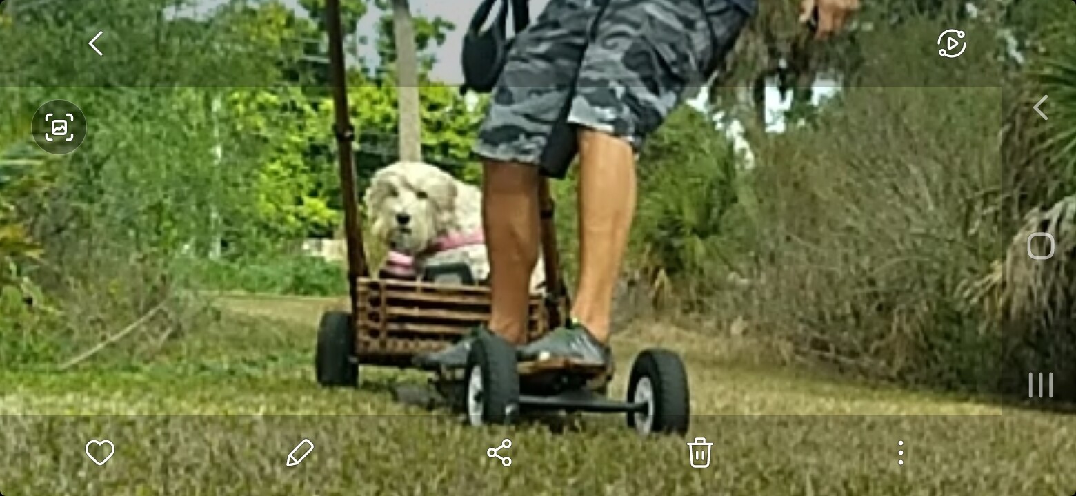

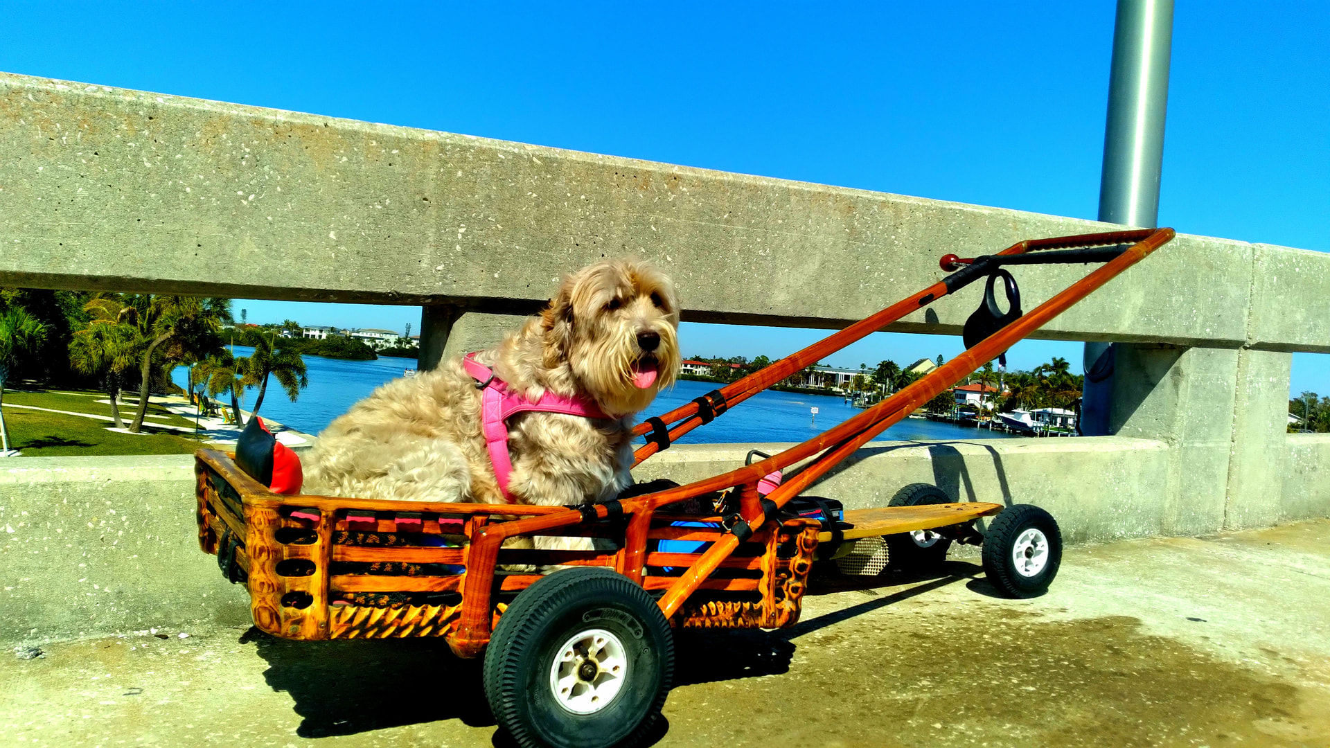

I then made a basic chariot for her, and once I clamped a plastic box to the base and put some padding inside of it she jumped right in before I asked her, and we have likely rolled 5000+ miles since then.
Only once, did she jump out, and that was when I had to brake to a stop at a stop sign and was close to fully stopped, when a loud blast of thunder scared the shit out of her and she jumped out.
Now, If I do not lower the handle for her to jump out, she will not jump out. She has gotten quite good at anticipating turns and leaning into them, and I have a few road islands that I call my racetrack, and I can roll it pretty aggressively, hissing tires/ urethane and such.
Rolling the racetrack aggressively, I will stop and lower the handle to let her out if she wants, but she always chooses to stay put, as she finds rolling a fun as I do.
Her chariot is balanced pretty well with her butt up against the back wall, and the faster we go the more likely she is centered with her butt where it needs to be, and her front paws splayed wide, and a shit eating grin on her face.

I rode the Mini the other day with a nearly fully charged 10s1P Eve 40PL battery.
Aimed at a radar sign full throttle and towing Fiona, it read 23mph where the Guppy usually never gets us above 22mph.
So the 10s1P Eve 40PL Mini, is indeed faster than the Guppy, as suspected, at least when fully charged.
