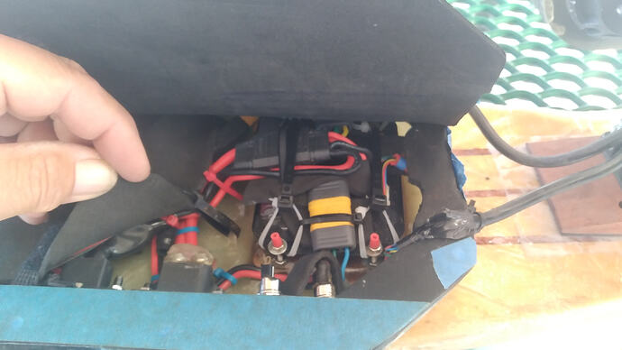

I pulled the tape off my parallel ESC feed XT90.
I pulled loopkey and plugged in old DMEGC 10s2p battery to parallel ESC feed, to decide on extension size and battery location on deck between feet.
Later on, went to go roll, and plugged loopkey into parallel ESC port.
Direct short!
Stepped on board and pushed, to only find brakes.
Quickly realized my midtake and yanked loopkey.
It Was not even hot!
WTF?
Plugged loopkey into proper receptacle spun a wheel and beep beep.
Seemingly no damage done to battery or ESC.
Rolled to park.
Just dropped enclosure in park and half removed neoprene gasket
14 awg from parallel feed to ESC XT90 not burnt.
no smell.
Nothing even hot.
I dropped enclosure as i thought
The 14 awg from parallel port to esc must be toasted.
Must have been shorted for at least 5 seconds.
WTF?
Where did all that juice go?
Was the charge port fused?
The charge port is fused.
The parallel ESC feed is not.
I plugged the loopkey directly into the parallel ESC feed, directly shorting the Healthy 10s2p BAK 45D battery, for several seconds, and somehow, nothing bad appears to have happened. We rolled a mile to the park where I charged it at upto 315 watts earlier today, rolled 5 more miles, and am charging at 84 watts as I type.
I can still read battery voltage on parallel port. I figured it must have melted the solder joint of 14 awg to panel mount XT90, but everything seems solid, like it never happened.
Edit, sorry I wrote 2 posts above that I plugged loopkey into parallel charge port when i meant to type parallel ESC port. I edited the mistake.

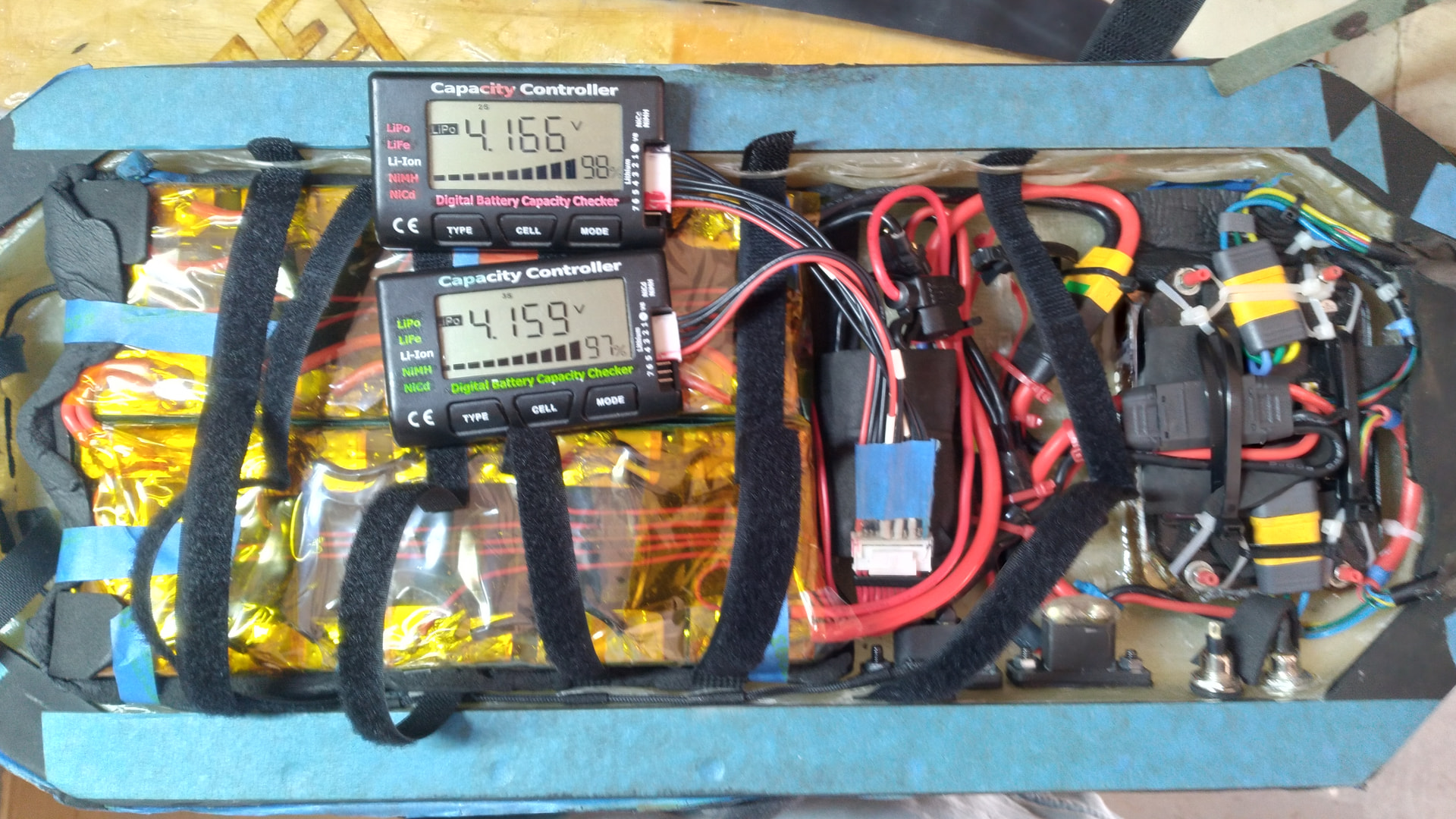

I pulled out my First Esk8 battery, (10s2p of DMEGC 26E cells) and checked its balance. It has one partial cycle on it since June 1 and was at storage voltage. I charged it towards 41.98 volts and noticed the BMS cut off charging early. The voltage delta was over 100MV, and did not seem to improve much, if any after I discharged group 7 from 4.25v, to below 4.178v and then charged the pack as slowly as I could back up above 41.8v bumping it up in 0.03v increments.
I was planning on strapping it to the deck between my feet, plugging it into my Parallel ESC xt90 receptacle, and acting as a range extender pack and exploring some new areas today despite it being basically as cold as it gets here during the day, and I have lost a lot of my tolerance for cold whilst living here.
This battery was getting too hot during use after about 2k miles. or I should say I noticed it getting too hot after 2k miles. It was returned to duty 2.5 months after I destroyed the P42A submerging it in the bay and destroyed my shoulder trying to prevent that occurrence.
So not sure whether the Dumb Daly BMS is actually capable of balancing as it had plenty of time to do so.
I’ll check delta again after discharging it to the ESC cutoff, then recharging it again.
It is unlikely to overheat today even if it was not in parallel with the BAK45D 10s2p.

Heard a rattle when transitioning board from workbench charging station to the ground today, and delayed the park run.
Rattle sounded precisely like a M4 nut on fiberglass.
It was from the xt90 panel mount, and getting the nut back on and cinched tight, fought me.
I decided to check battery balance while I was there and had already loosened the battery for better access to the Nut.
My capacity controllers do not really agree so I swap green and red and record both. Seems Group 4 on the green controller always reads a bit high.
My BMS only starts balancing above 4.18v and I was charged to below that.
I’d prefer less of a delta, but 30mv is of no consequence and could be lower if I regularly charged low and slow to 4.18v then lower and slower to 4.20 regularly.
