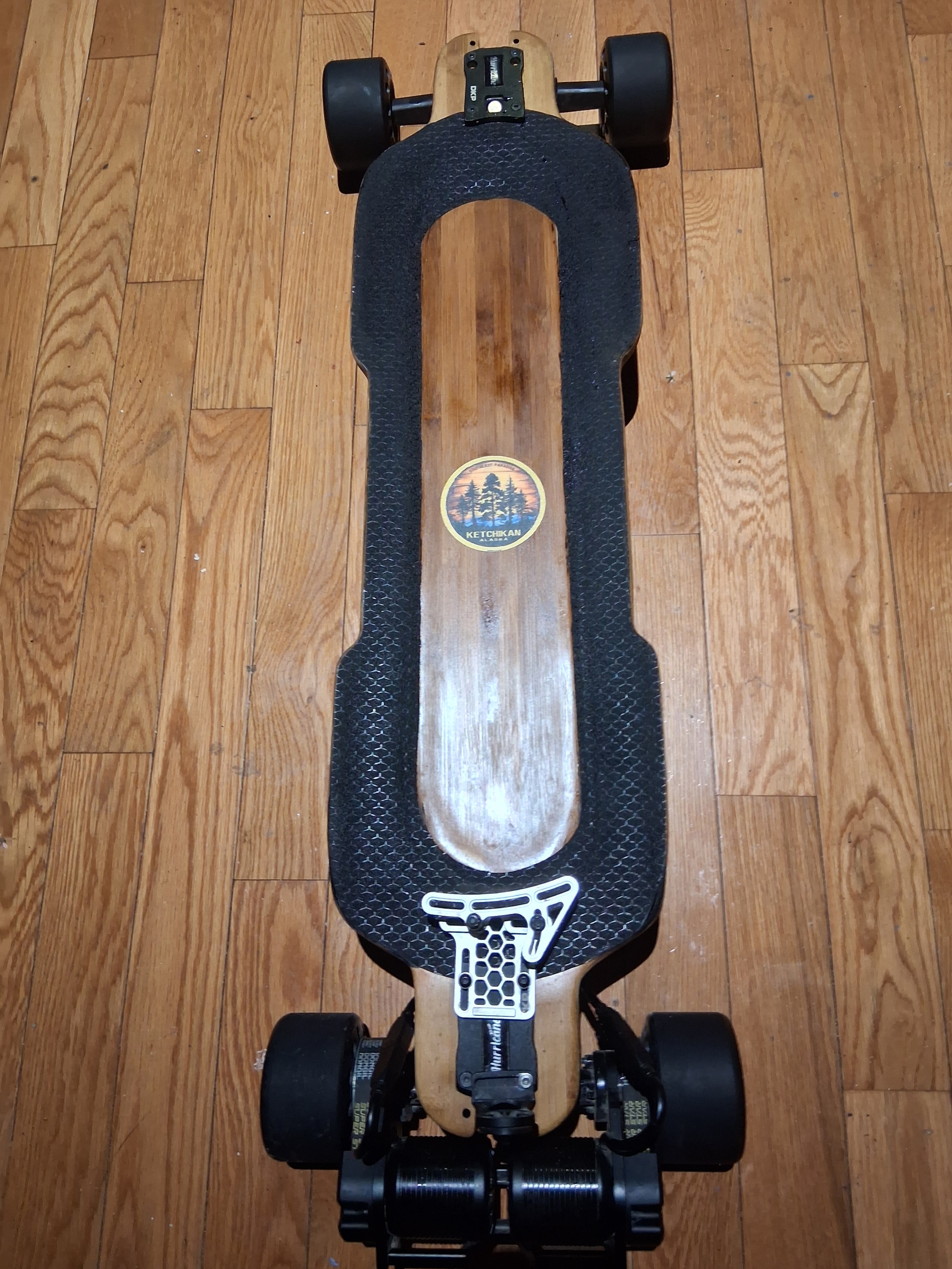

Getting warmer here and I’ve been IR temp gun scanning my board everywhere after a ride.
The hottest spot, always, is this outer sleeve cap, by 20-25F. The inner cap will be 137F-142F, this outer cap will be 170F after a long roll with a lot of full throttling around towing Fiona and returning with a 10S battery in the 32-33v range
I have these round star like heatsinks and I was thinking of cutting them down into slightly less ankle shredding width, sticking out a mm or 2 past the lip of the urethane sleeve. I am not really sure how to best drill the 4 holes to center the heatsink and keep it balanced.
I was going to use screws and JB weld, as the thermally conductive epoxy designed as such, is just too rich for my blood.
Sleeve chunking throws out the balance pretty good by itself So i am not sure how being out by -.25mm or so will actually effect balance.
Probably going to order new Puaida sleeves since the softer urethane is cast onto Aluminum where the meepo sleeves are cast onto plastic and are a looser fit on the motors too.
I also fear the Future unavailability of these sleeves. When Installed I was very pleasantly surprised how much nicer the board rode. now that they have worn mostly flat they are starting to follow parallel grooves a bit more and lost some smoothness.

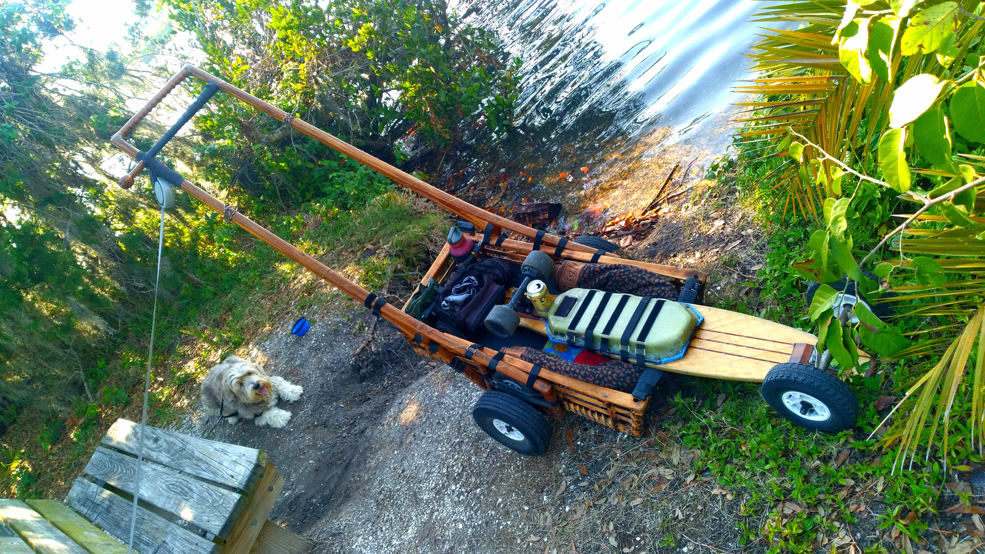

The 3.50/4.10-4 chariot tires on MBS fivestar’s are now down at 4.8 psi, and get a lot louder and draggy at 20+mph, and so our top speed and range are down. I can tell through the handle it is riding a lot smoother over the bumps, and that is far more important than range or top speed at this point.
The above photo is a new to us park, but she was not keen exploring it. She was pulling hard towards the exit and no interest in sniffing.
I had left homebase with the the 7.0AH 7s2p EVE35V powered portacharger attached, lowered to 5 amps max output, and it wound up delivering 3.71 amp hours back into the 10AH TenPower 10s2p 50XG, and did not get too hot at this lesser output.
My 5.5x2.5 charge port is wearing out. My 5.5x2.5 plug from portacharger is a 90 degree plug, and I run the wires from portacharger to the receptacle with strain relief, but it has seen 100+ miles of significant vibrations and has loosened up, and I will need to replace it soon. It has vibrated loose on its own, but today I had employed some Gaff tape to help it from doing so.
We walked a few hundred meters away from this park along the tourist traffic fusterclucked main road, when I got annoyed with walking, removed the spent portacharger, put it into the chariot, and I commanded Fiona back into the chariot and hit the throttle for that blessed manufactured breeze and rolling bliss.
I did discover that the eve35V data sheet says 70C is acceptable, in a pack, but if I could go back in time regarding portacharger battery, I would choose the economical Eve 30P or Molicel p28a and run it up at 7-8 amps output.
Between the park above, and the park below, the main road seems to have really taken a beating since the last time we rolled it, when we got chased by a pitbull.
The main tire grooves were deeper more cracked, and more warbly as was the area just on either side of them. We hit this area with No following traffic, for the most part , and I was just uncomfortable trying to maintain 20+ mph on it so Just slowed way down and hit the sidewalk instead.
The Chariot has a 12v LED rear strip light which I have flashing red , and two forward facing shredlights @trancejunkie gifted us, that I also have set to flashing during the day.
We made it back home with plenty of battery to spare and the chariot tires were kind of stinky hot and measured 124F, from rolling fast at such a low PSI and the equinox approaching, even though today was relatively cool in the low 70’s Fahrenheit/22.2C.
It was a 3 park outing, and later we rolled the full length of the Crushed shell trail for the evening roll session, FUCK the HOA and their fucking rules!, and then we barked up the hood for a couple laps at full throttle.

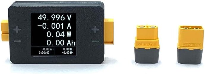

I loaded them with my ‘1800 watt’ CCCV booster at ~30 amps, rising as high as 34 amps, to charge my 10s2P BAK10s2p at 9.24 amps, then my older 10s2p DMEGC-26E battery, then my 10s1P Eve40pl battery until one SAFT cell almost touched 2.5v
My inline wattmeter reads about 1.45 amps low at 33 amps, yet it stated the SAFT4s1p delivered a total of 27.066 watt hours. I feel that the 28 amp hour rating Battery hookup gave these cells to be realistic, perhaps even a bit low

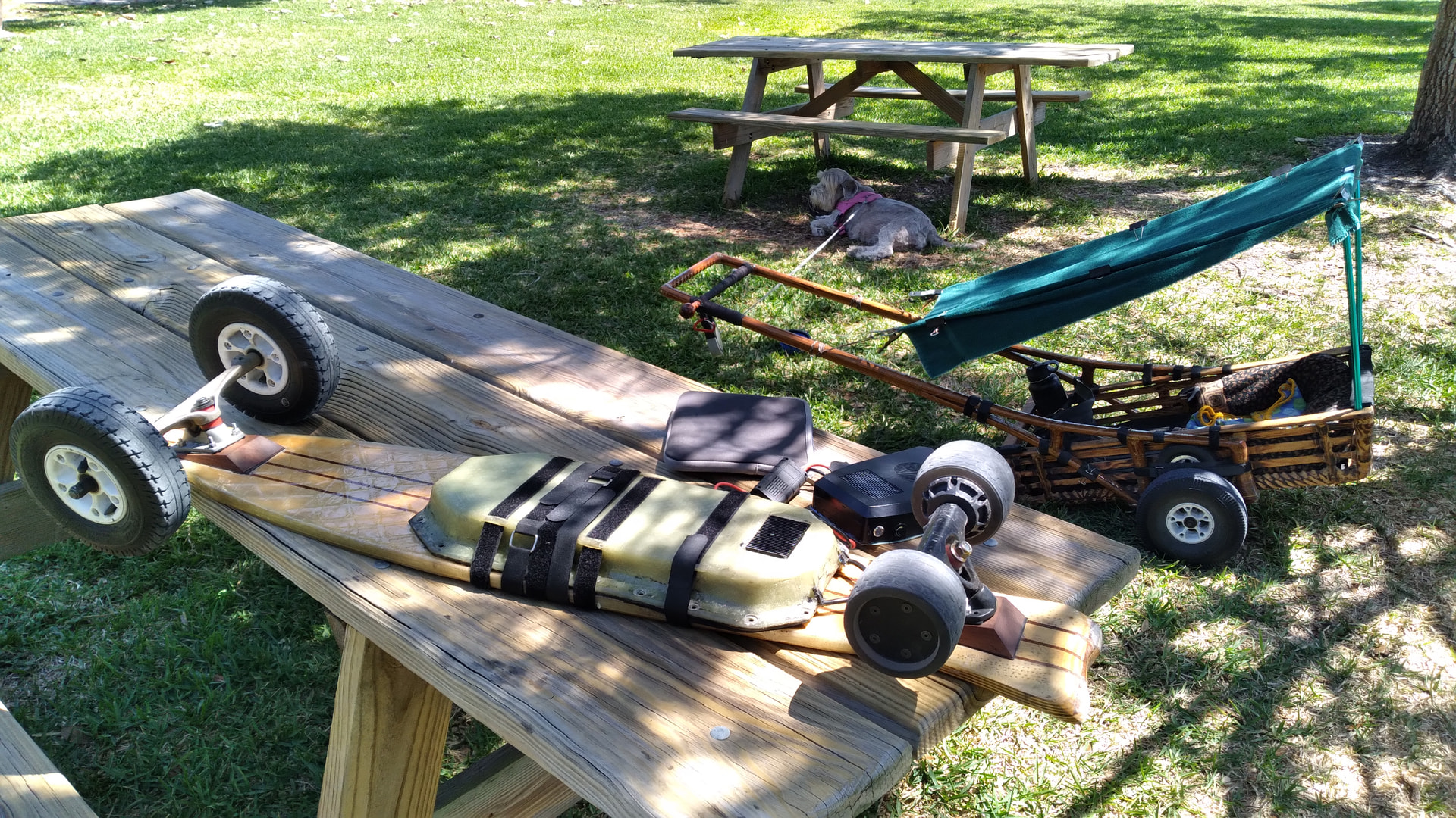

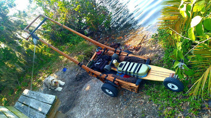

Park #2^
park #3^
park 1 is kinda boring, so no photos.

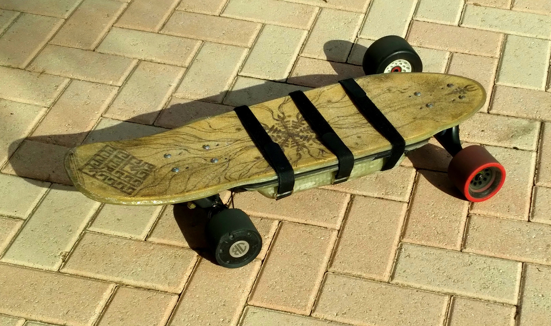

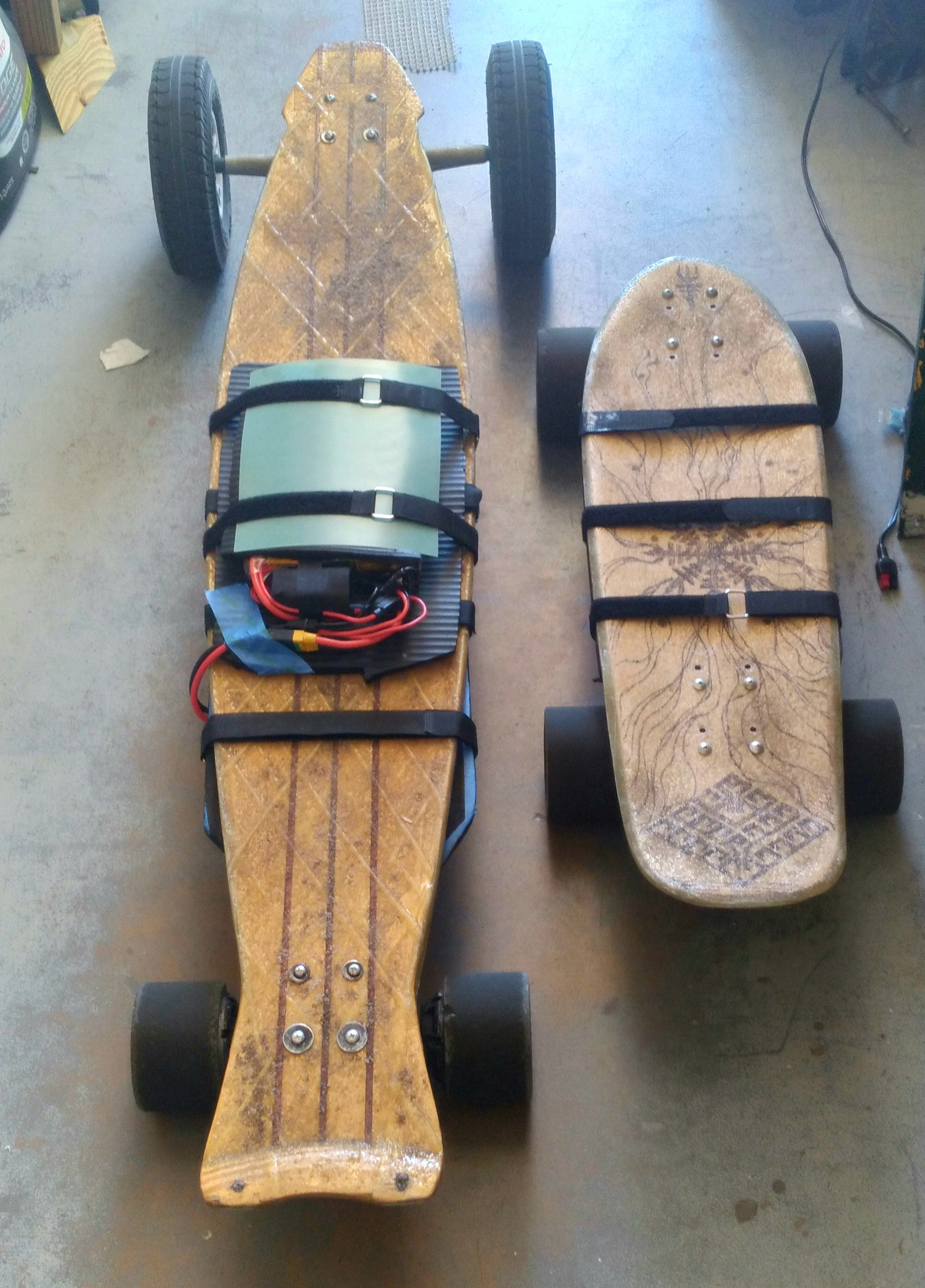

In between park 2 and 3, the mini was tearing up the racetrack out front. I was getting too confident.
I was solo, and Fiona was just chilling and watching from garage, but then stood, and started barking at me.
So i busted out the chariot and she jumped in and we did a thousand carves together.
I kept stopping and tilting the chariot so she could jump out, but she stayed put.
So we kept carving up the smooth asphalt.
NOT including the mini’s carve sesh, we did two 9 mile runs with The Guppy as chariot tow vehicle.

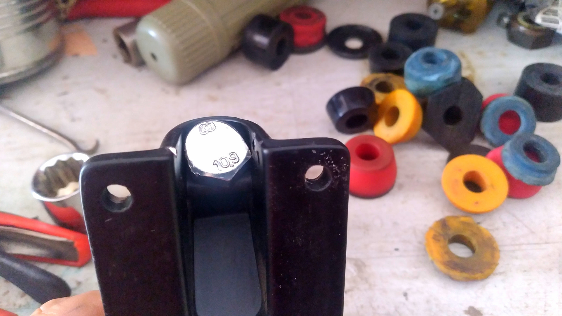

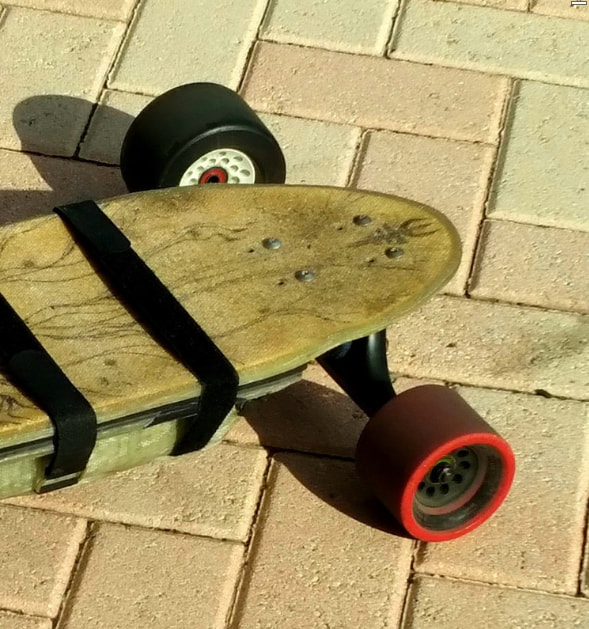

My 70mm long grade 10.9 M10-1.25 bolts arrived yesterday.
I pulled out an old baseplate from a Puaida truck that was retired long ago, as it had a super wobbly kingpin.
That 3/8” splined Kingpin tapped so easily out from the baseplate, I had to chuckle.
it measured 9.49mm on the shank/ unthreaded portion.
The M10 bolt would not hand thread in from the bottom, but it would from teh top, so I did so and then used a tool with very little pressure to thread it through the bottom.
Then it easily hand threaded from the bottom up to the shank.
I then took my angle grinder to the 17mm Hex head to get it to fit into the baseplate.
Slowly. I tried to keep it cool and a water quench never sizzled.
The new kingpin seated dreamily, pulling it with spacers by bolt threads with a Nut. No more Kingpin wobble, no more kingpin weakening splines, more bolt diameter, more strength, yeehaw..

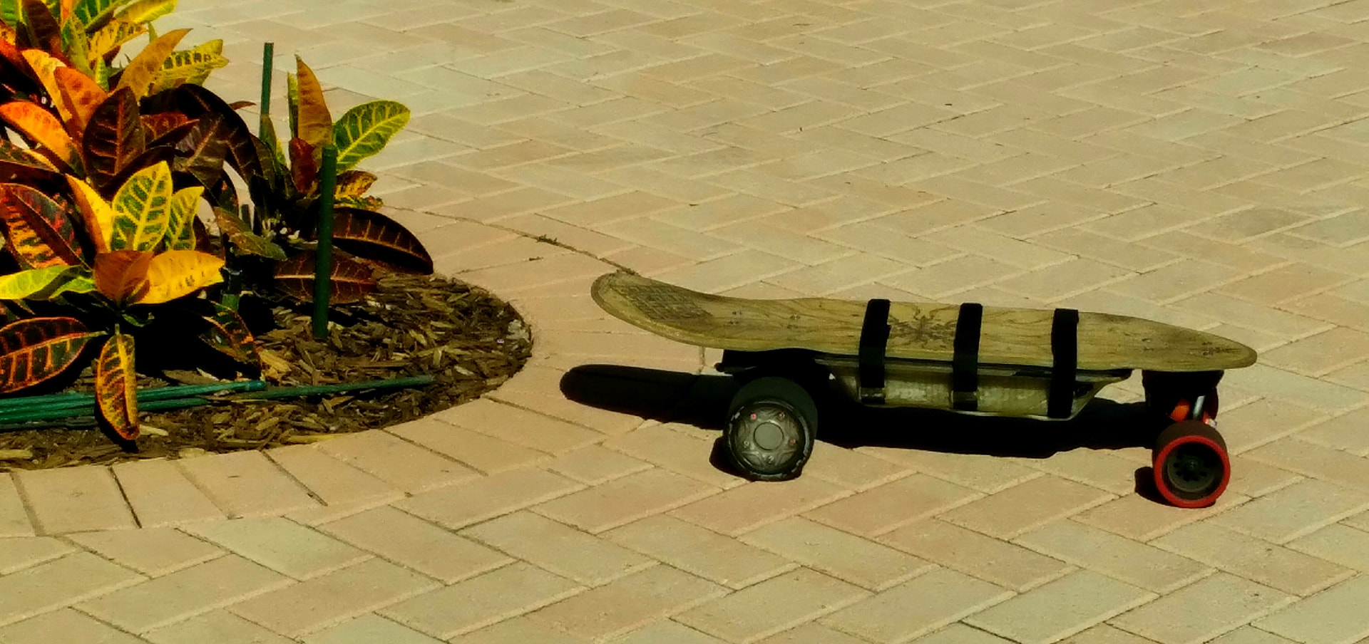

The Mini has been using a caliber two front truck on ~ 14 degrees of wedges, and I wanted a bit more turn for the lean. I remembered the Puaida trucks seemed to be a bit more twitchy, more turn per lean, so i put Newly kingpinned Puaida baseplate onto mini with Puaida hanger, and swapped my 105mm meepo ‘donut’ wheels and my same bushing stack.
The Mini test roll with m10 Kingpin on Puaida front truck did certainly change the handling, for the better.
I am using the same bushing stack at the same tension but the turn radius was a bit shorter, and it seemed both trucks had the same turn, with back wheels in the same track as front instead of swinging wider, despite the rear being dewedged by 7 degrees.
The M10 Nylock stop nuts i ordered are tall/ thick have a flanged bottom side, and I learned the hard way they have some threadlocker pre applied.
I need to order some riptide pivot cups and bushings.

I will be replacing each and every 3/8” kingpin, splined or not with M10-1.25 grade 10.9, even on the baseplates with non wobbly kingpins.

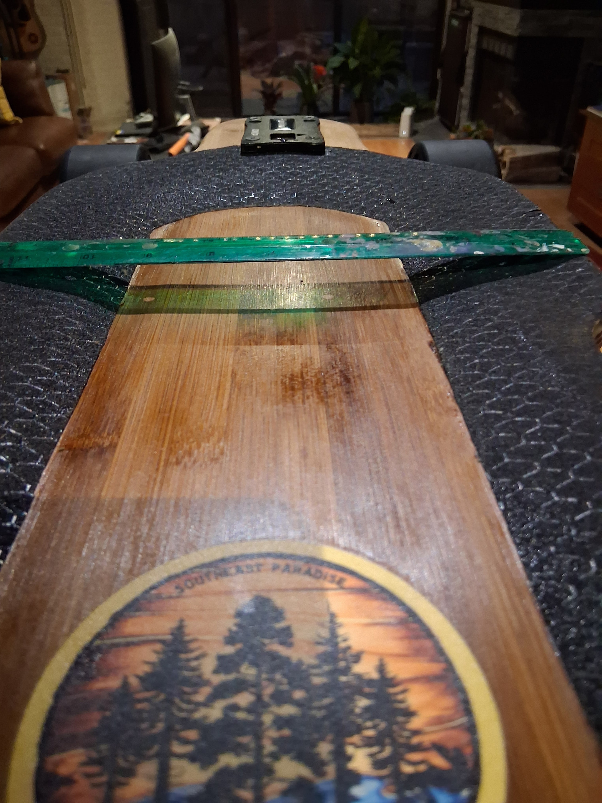

I have a MBS ATS.12 truck on the front of the Guppy. Its 3/8” kingpin was the most wobbly.
After Kingpin removal I saw that the Kingpin receptacle was not perpendicular to the base, and just yesterday I noticed that the Pivot cup recess is not centered either. I now see this specific baseplate as a lemon not worthy of a new kingpin.
I got the MBS trucks mainly as I feared fatigue of my 270mm 10mm axle ‘Vevor’ MTB TKP truck and thought he hanger had bent.
I then learned of venom 1212’s incident with the hanger pivot snapping, and while I am using one of these trucks on my front, I do not trust them. I swapped to my other MBS ATS.12 baseplate and hanger 200 miles or so ago and this baseplate kingpin is not yet wobbling, but I have not inspected it as closely to see if it as as much of a asymmetric lemon as my other one.
Anyway I like the handling of these TKP trucks, but I fear the pivot snapping and trying to kill me.
I am considering contacting Tito and seeing if he will sell a single flatboard 270mm front Duality truck. I cant really afford a pair of trucks, and only need one at this point.

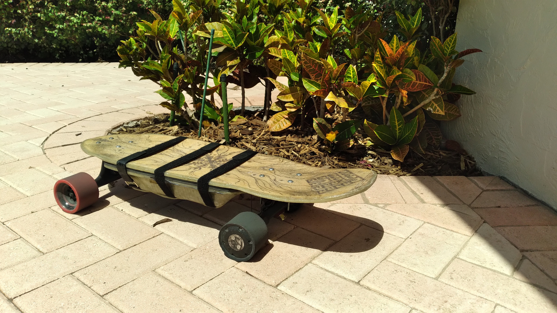

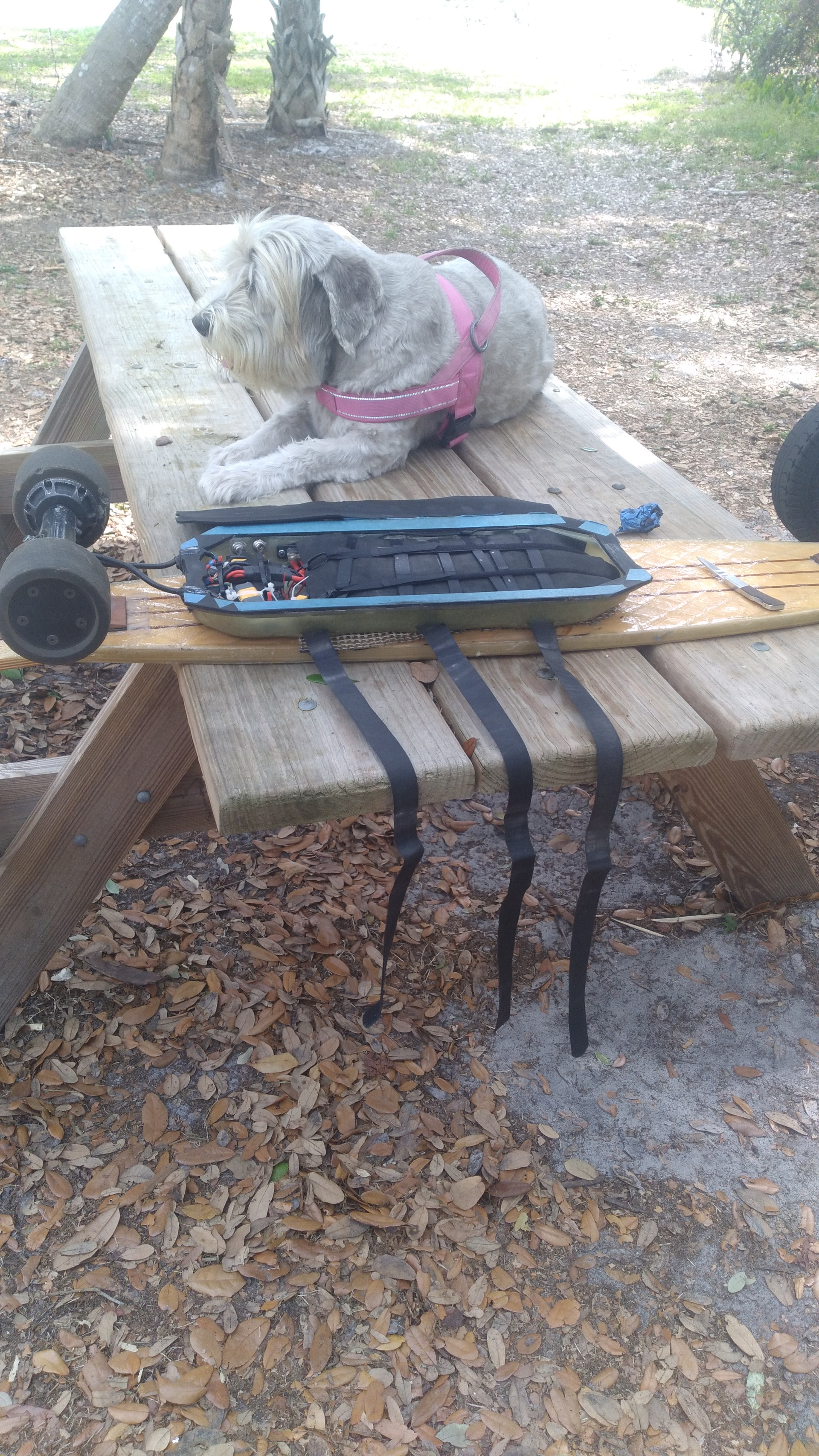

I had stopped a few miles previous to this picture and busted out the tools, as something was rattling. I got some more tension on baseplate hardware, but the rattle was still there.
I decided I had to check to see if the XT90 panel mounts m4 nuts had again loosened up, even though it did not sound like that kind of rattle.
So dropped the enclosure in the park, pulled the masking tape holding the neoprene gasket and had a peel inside. Everything inside was good and tight, So I restrapped it to the deck. The rattle was still present, and we rolled home slowly.
I suspected perhaps my baseplate hardware was stripped and or stretched, and when home, pulled the baseplate, but the 10-32 hardware was fine.
With baseplate off I decided it needed a new M10 grade 10.9 kingpin.
Its 3/8” kingpin was not wobbly and it did fight extraction. Heating the baseplate to 185F and holding a series of quickly melting ice cubes on the kingpin worked. It tapped out without getting serious with the hammer, or getting a heavier hammer.
Getting the new M10-1.25 Kingpin seated was a bit more effort than on yesterday’s baseplate, but I think I got a solid procedure established for all future kingpin swaps.
I had reassembled the board and dialed up 10 amps of charge current, then took out the mini for some Carving the road in front of garage. The Mailman stopped short of the mailbox, and handed me a package.
Inside were 2 new sets of Puaida 105mm hub motor sleeves with 20 new screws with preapplied blue threadlocker, and a new 10S Puaida 2024 ESC and remote, for the mini.

When i ordered the Meepo 540 watt hub motors with e 105mm sleeves, the hanger it came with is not compatible with any of my other baseplates, and it came with no baseplate.
I transferred the motors to another hanger, and all is well, but the Meepo hanger is 10Mm narrower, and different geometry which might benefit the Mini.
I was able to determine which Meepo baseplate I needed for this hanger, and that is en route.
I’ll probably not immediately knock out its kingpin and insert an M10, but that is basically the fate of every truck I own.
I am really liking the handling of the Guppy since I M10’s its baseplate, used a taller roadside cone bushing and skipped the cup washer entirely. it just mates with the bottom of my flanged M10 Nut.
Between that bushing swap, a fatter stronger non splined fresh kingpin , a less worn pivot cup, and the new 105mm hub motor sleeves laughing at sidewalk cracks, Today’s rolls were extra pleasant, so we got in 18 miles, and one slight downhill grade coincided with a 25+ mph gusty tailwind, and 30MPH/ 48.3kmH was easily exceeded, and we ran out of road before acceleration stopped.

The New Puaida ESC refused to work properly with the New old stock Puaida motors.
It would work If I put the remote in sensorless mode, but the brakes were weak, the power curve was not linear, and the motors were Noisy, and I like nearly silent motors.
So I swapped in the well worn 83mm Jking motors, with sleeves now worn to about 75.5mm, and the 80mm inboard bloodorange urethane wheels up front.
The JKing hubmotor hanger only fits the baseplate it came with, and its Kingpin was wobbly so I replaced it with an M10-1.25 G10.9, which went smoothly.
The lower ride height is noticeable when stepping onto it, but riding it, it barely feels different when carving, compared to the 105mm wheels.
The brakes are now strong enough to lock up, even when braced for braking with 90% of weight on the back foot.
Acceleration is nearly as strong.
In general, the Mini performs well with the smaller hub motors and wheels, and carving is fun, but not much different than with 105’s. It has enough acceleration and top speed, for the mini. The significantly lighter weight is noticeable in hand, but not underfoot.
As a backup board, these smaller wheel limit where I will/can ride to, far more than 105’s would.
These Jking hub Motors have unobtanium replacement sleeves, so their clock is ticking.
I could switch back to the older ESC and 105’s, or perhaps get different hub motors that I know work well with this ESC, like the Meepo 540’s on the Guppy.
It’s hard to go back to a smaller wheel, even on a low speed carver.
In other news. I ordered a new inline power meter with XT60 input and output, as I feel blind deaf and dumb when charging and not knowing the current flowing, and Want more and more accurate inline meters.
This one largely agrees with my more trusted inline wattmeters and DC clampmeter, from 0.05 to 10 amps, and is a bit smaller.
I have another one ordered which has a 5.5x2.1/2.5 connector on input/output.
Supposed to arrive Sunday. I’ll review these in more detail in the pocketable voltmeter/fuel gauge thread after testing them and gaining more familiarity with them

I played with top speed, acceleration, and current settings on the 3 lower power levels and proceeded to mind carve the smooth asphalt.
With a fully charged 10s1p 40pl the thing is a little rocket on gear 4, and even gear 3 was having me torque wheelie out of turns, so I dialed Gear 2 to ~85% of gear 3.
Can dial gear one so low it can barely get out of its own way.
This hubmotor hanger is more stable at higher speeds than the Puaida motor hanger.
The much lighter weight is becoming more noticeable, the more I ride it.
Changing the brakes levels don’t seem to change much at mid to higher speed .
Strong AF lock’em up.
Very linear upto the brief lock though.
I’m digging it.

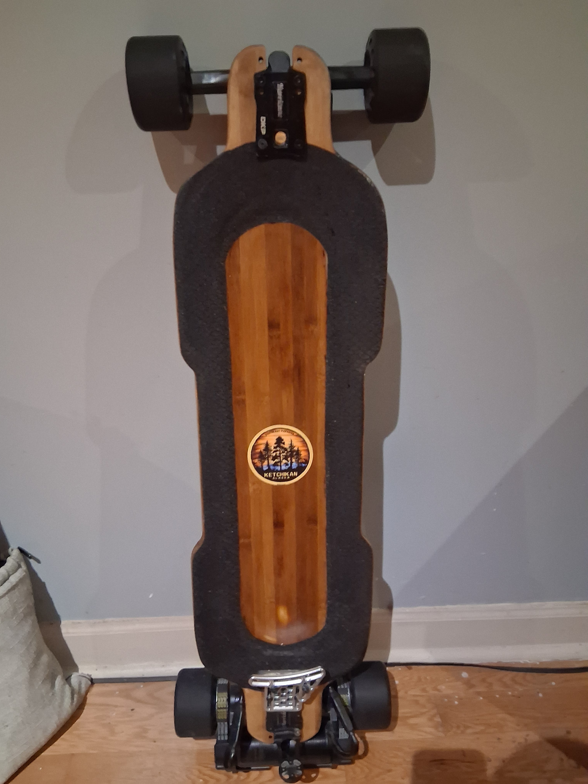

I hated the stock Meepo Hurricane Deck. IMO, it was like riding a wood plank (boring and lifeless). So I never rode it and it was my least favorite board. So I decided to shape the Meepo Hurricane Deck. I used and angle grinder to grind-out 2 layers of plywood in the middle section of the deck and it gave the deck some flex and more importantly - it gave the flat deck a lot more concave. Now when I ride this board, my feet feel really locked in and i can carve from rail to rail.
. I also shortened the board by approximately 2 inches and I shaped the waste with a dremel. Now this is one of my favorite decks to ride. I consider Meepo.Decks to be like surfboard blanks. They are the beginning point - but they need shaped and customized to make them more lively.
