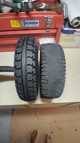

Some Kenda 2.80-2.50-4’s arriving, …

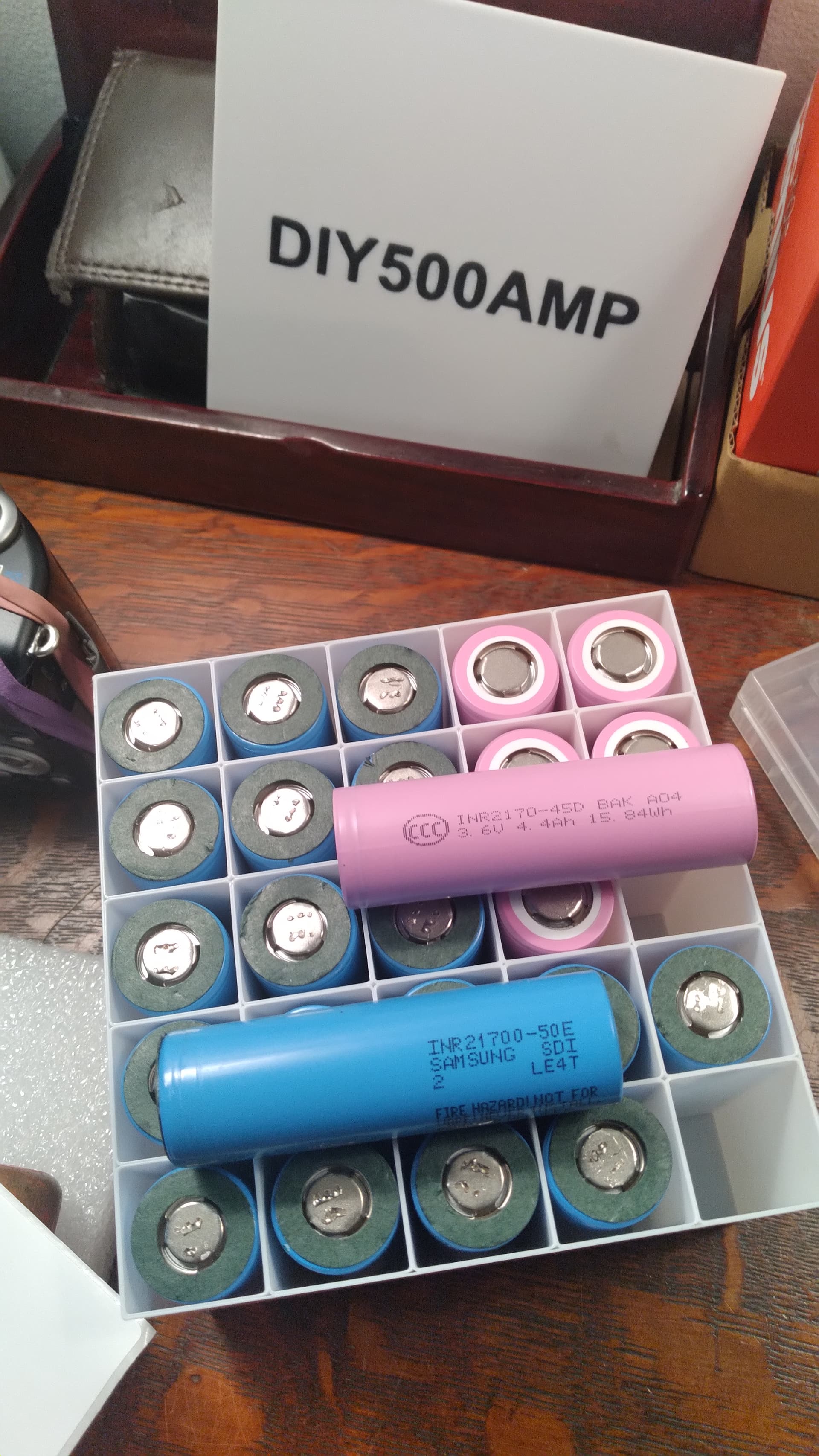

Paled in comparison to Nelvick’s goodie package containing 12 JP30’s, 6 BAK45D, 19 lightly used, pre fishpaper ring’d Samsung 50E, and some 0.1mm stainless steel and various thickness and width rolls of copper, and another tube of Flux/ brazing paste
The 6 BAK’s and 19 Samsungs came in this neat 3DP 5x5 cell holder.
The Kenda’s are lighter than my worn Cheng shin 8x3" turf tires.
With a 200x50mm tube, the well worn cheng Shin 8x3" turfs weigh 622.2 grams.
With a 200x50mm tube, the new Kenda K473 weigh 580.1 grams

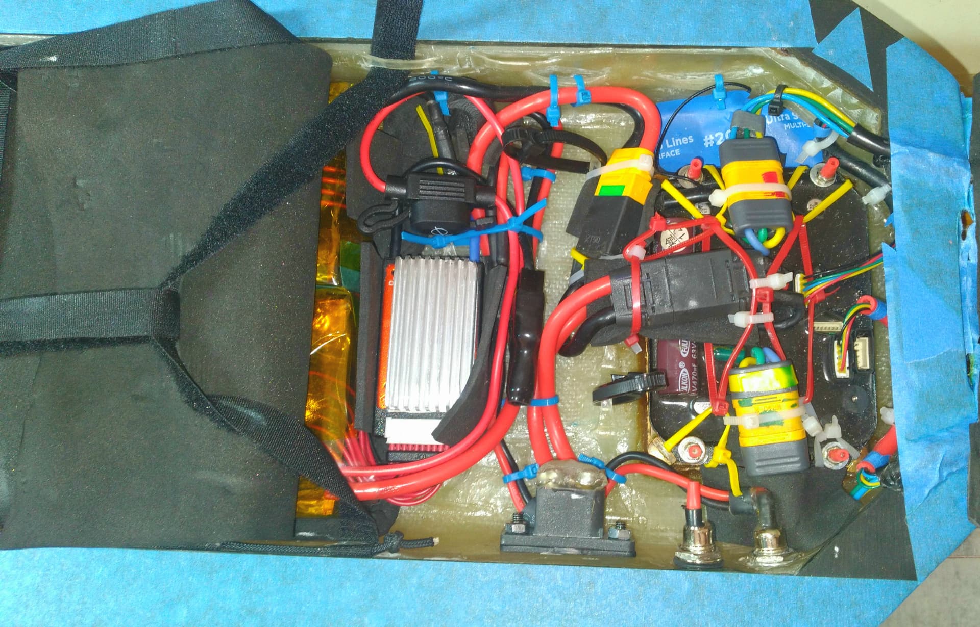

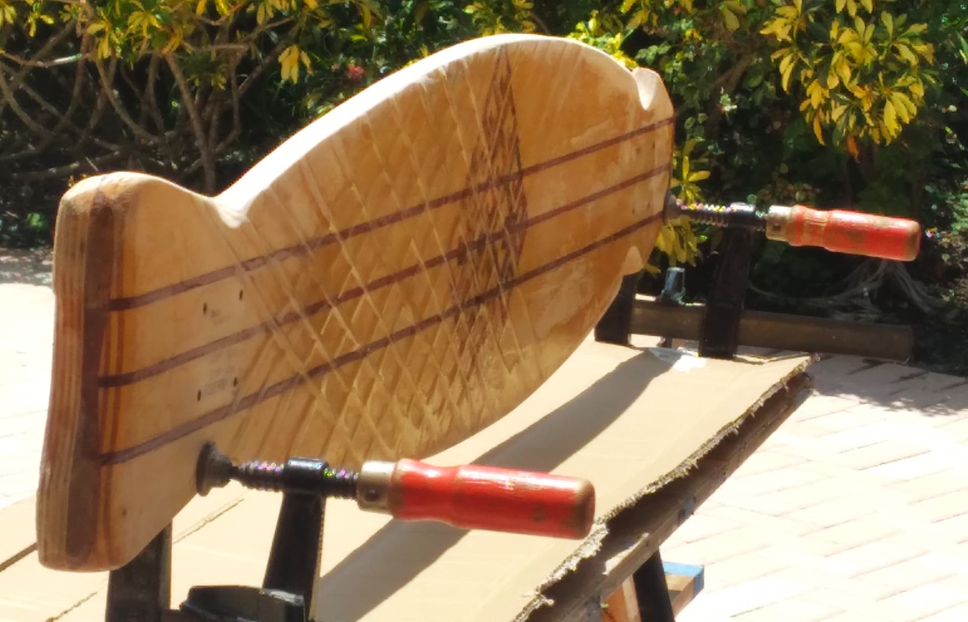

My Long cruiser deck is needing some maintenance, so I transferred my enclosure and powered hanger to my Midsize kicktail.
The 105mm sleeves and foot and deckbite tried to hurt me, so I went down to 90mm. The torque accelerating and braking are the most I’ve yet felt riding Esk8.
I am very interested in the spotwelding with 0.1mm 304 stainless steel right now, but might have to repair a toilet instead.
The midsize kicktail has no issues on the crushed shell trail, power to spare, but my eyeballs start vibrating in my skull.
I gotta work on my cruiser deck.
I wanna try those Kendas.
But I got to get them to seat properly on the rims…should probably get the right size tubes too.

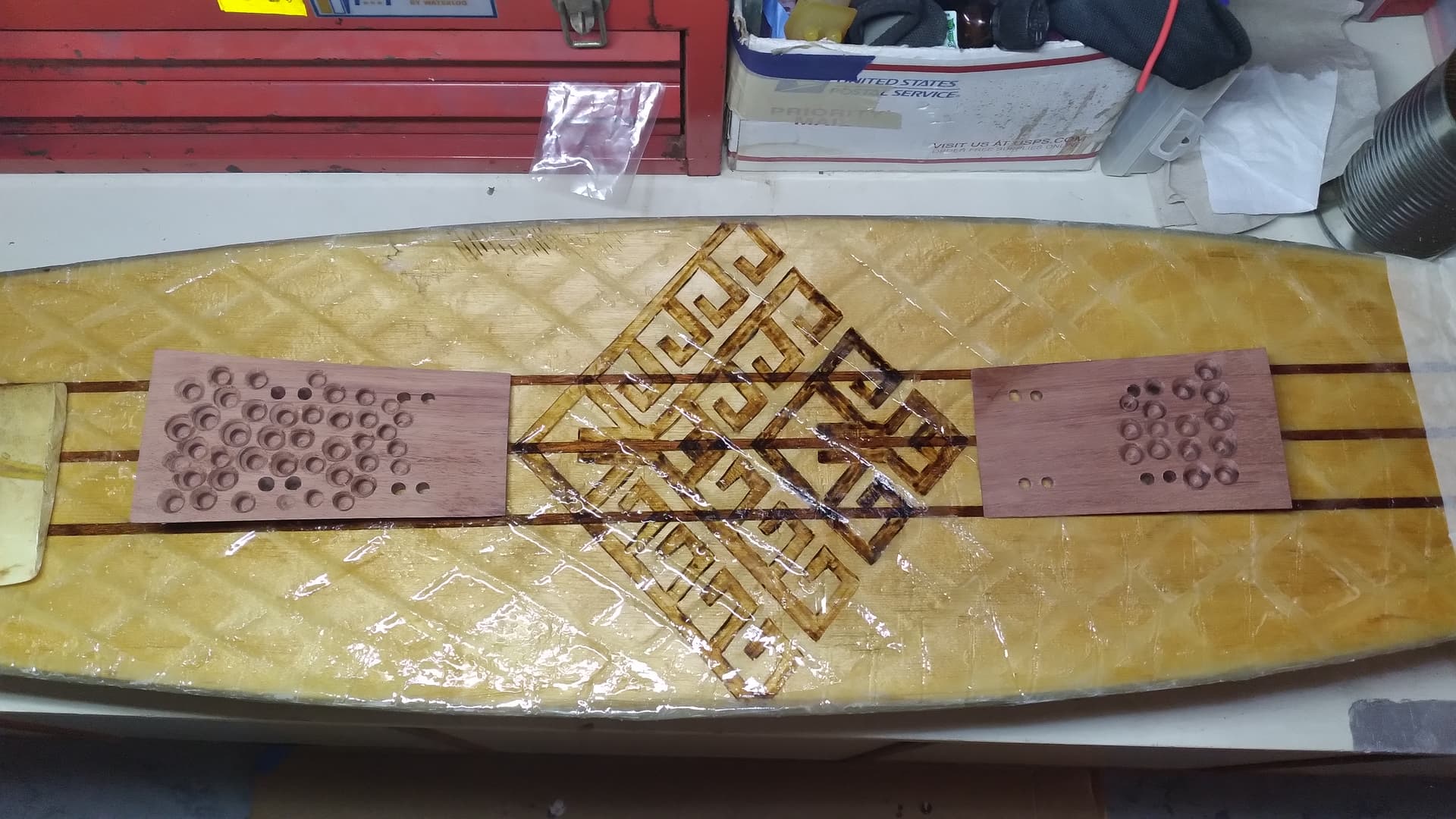

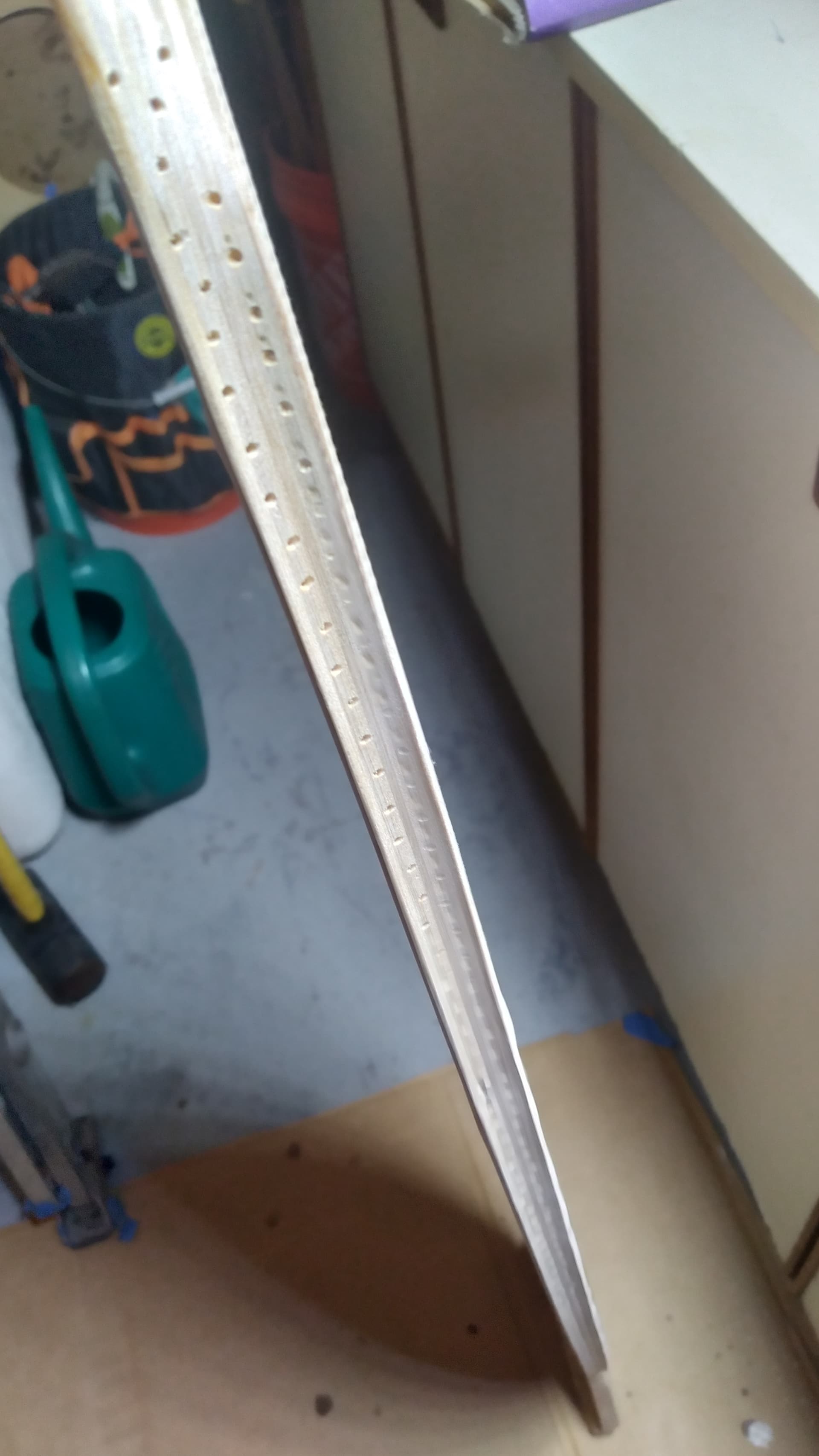

The cruiser deck was getting slippery, and more flexible.

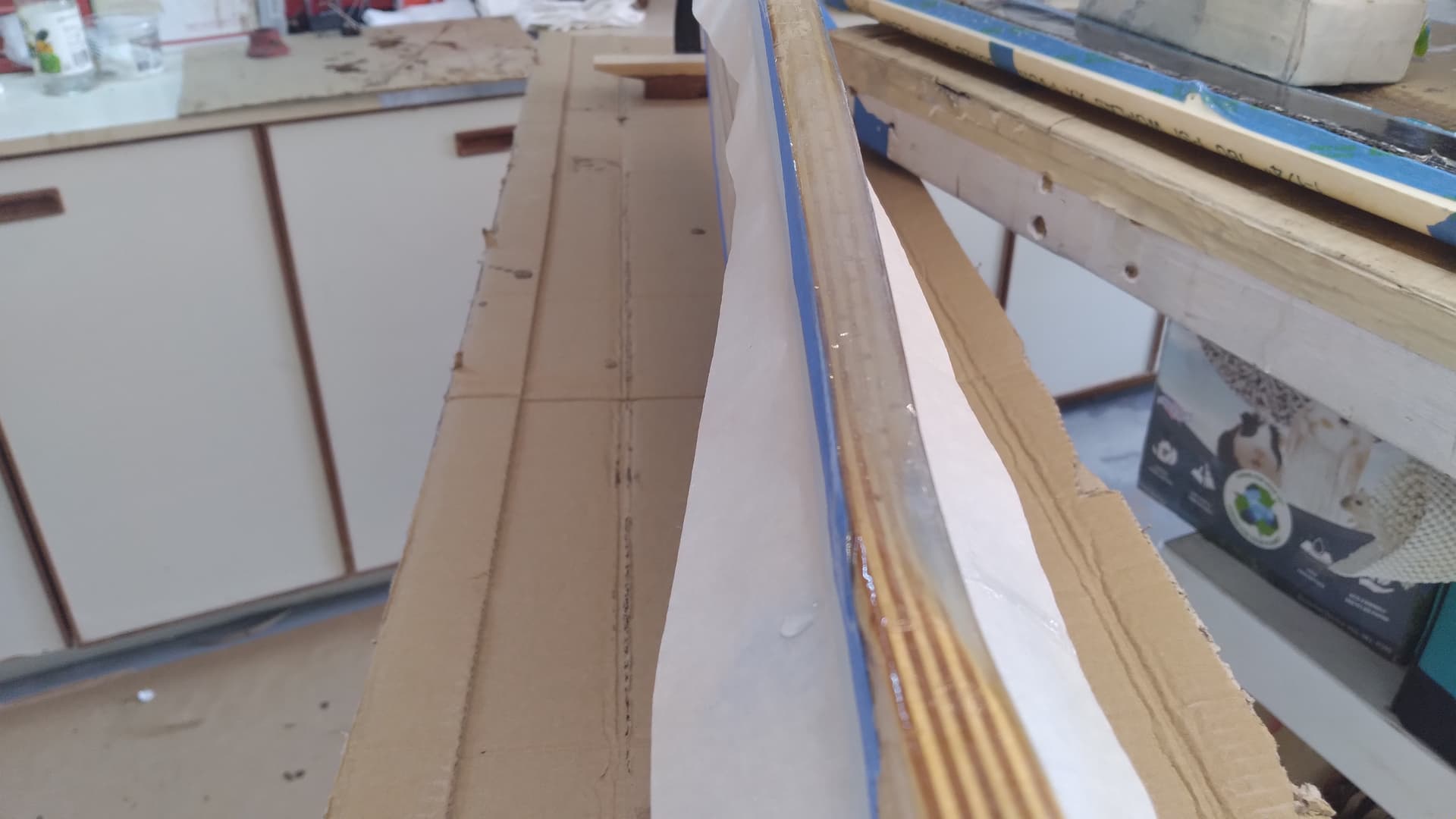

I was gonna add some fiberglass tow/roving to the perimeter, and sanded it free of previous coatings, but end grain plywood soaks up epoxy or polyurethane deeply, and I recall that this deck I originally used polyurethane, 22 years ago.
So out came the dremel and rotary rasp and barrel sanders to dig a cove into the perimeter, into which I will lay the prewetted unidirectional fiberglass. The holes are drilled at opposing angles and the epoxy will fill them and act like locking fingers.
The cross hatching of roving strands was done several years ago as I would pump propel this board and it would bottom out too easily.
I’m gonna add some more to the front half after the coves are filled.
The topside too will get some more reinforcement too, and then a new Brown sugar epoxy grip.
I’m not going for showroom quality finish, I just want it to be a bit stiffer, a bit wider and fully sealed, and grippy.

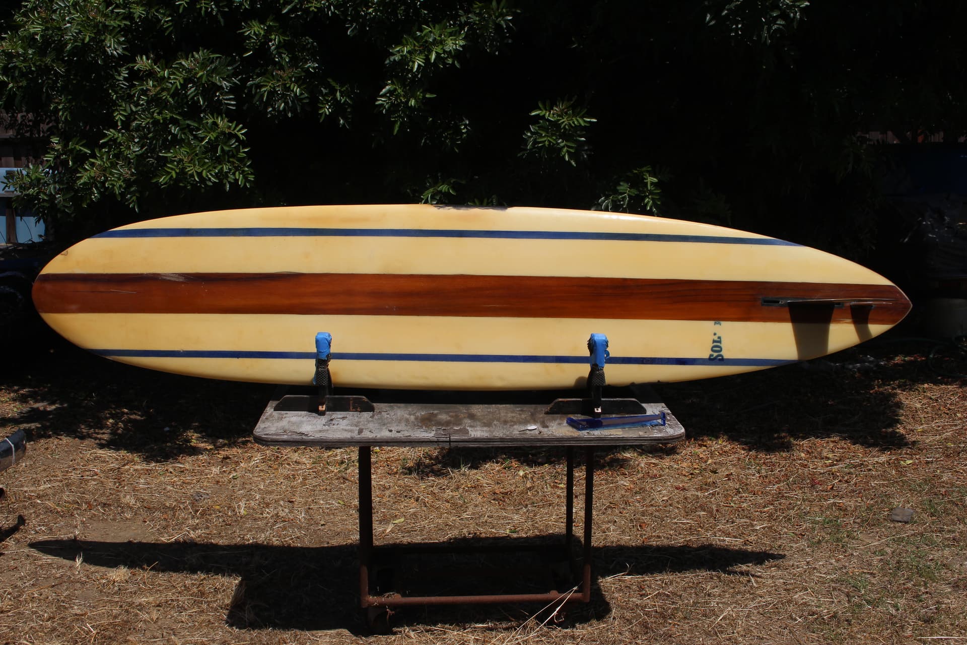

At that time I had access a complete surfboard factory, and I had a 10’8" foam blank, intended to be shaped into an old school 10’6 noserider, but that night I drew out a super narrow pintail, 9’3" singlefin with a longboardish nose. I had only shaped 3 surfboards at that point, but stayed in the empty factory all night by myself, refining the outline rocker and rails, just zenning out on the process.
The guy who was teaching me to shape , who was not a longboard rider or shaper, came into the shaping room in the morning and remained quiet as he ran his eyes along the rails, Checked out the rocker, the foil, and walked out without a word.
I kept going, and later on that morning one of the factory groupies, came in had a look and said, that thing looks like a guppy, like a baby longboard.
The name stuck.
It was also my first lamination job, and because the board was shaped from a much bigger blank, I’d shaped away the harder foam, and the board was soft, and the glass job, my first or maybee second lamination without assistance, was far from good.
But the board rode really well, and even in small conditions it was not designed for.
It was smooth and predictable, and when it got big, it did what I designed it for. I could be duck dive it, it paddled fast, allowing early entry into big waves, small waves, any wave, and it could handle the power and speed of a big wave.
I had other longboards I preferred in small gutless conditions but as an all arounder The Guppy was really a good board.
It was a loaner, ridden hard, put away wet, not fixed as promptly when the rails would get dinged.
Sometime around 2014, I was resigned to letting it break in half. It had big stress cracks on the bottom, huge deep footwells, that were delaminating, was starting to get yellowed. Obvious repairs everywhere.
My regular longboard was in drydock, and it once again The Guppy became my daily driver, and I got to the breach, and realized forgot my standard 9.5 inch deep fin, but I had an 8" deep fin with me, and I wanted to surf, so I threw it in the fin box, and on the first wave I was blown away at how well it rode.
Looser, faster, and no signs whatsoever of being underfinned, and I had an incredible session on it, then another, then it got big, and I absolutely dominated the lineup with it. Nobody else was even in a position to catch the outside monster sets I was waiting for, and every time I caught a monster set way outside, everybody was hooting.
It was like I had a wave magnet in my pocket and could do no wrong.
I got to the beach and was like, this freaking thing is magic with this fin, I cannot let it break in half.
I wound up spending a huge amount of effort inlaying in some Cedar on top and below the stringer for the I beam effect, and then pulling carbon Fiber strips tightly rail to rail, to keep the two halves together, and glassed over it.
I wound up making a new 8" deep fin for it. It had gained a good 3 Lbs of weight, and I knew the loss of flex and added weight could potentially ruin the way the board rode.
My first wave on it I knew that I did not, that I could push it even harder off the bottom and through turns, and the extra weight just added to its flow.
Big or small waves, the board felt amazing, like an extension of my Mind, and when it got big, I could sit farther outside, and wait longer for the biggest ones, and have them all to myself.

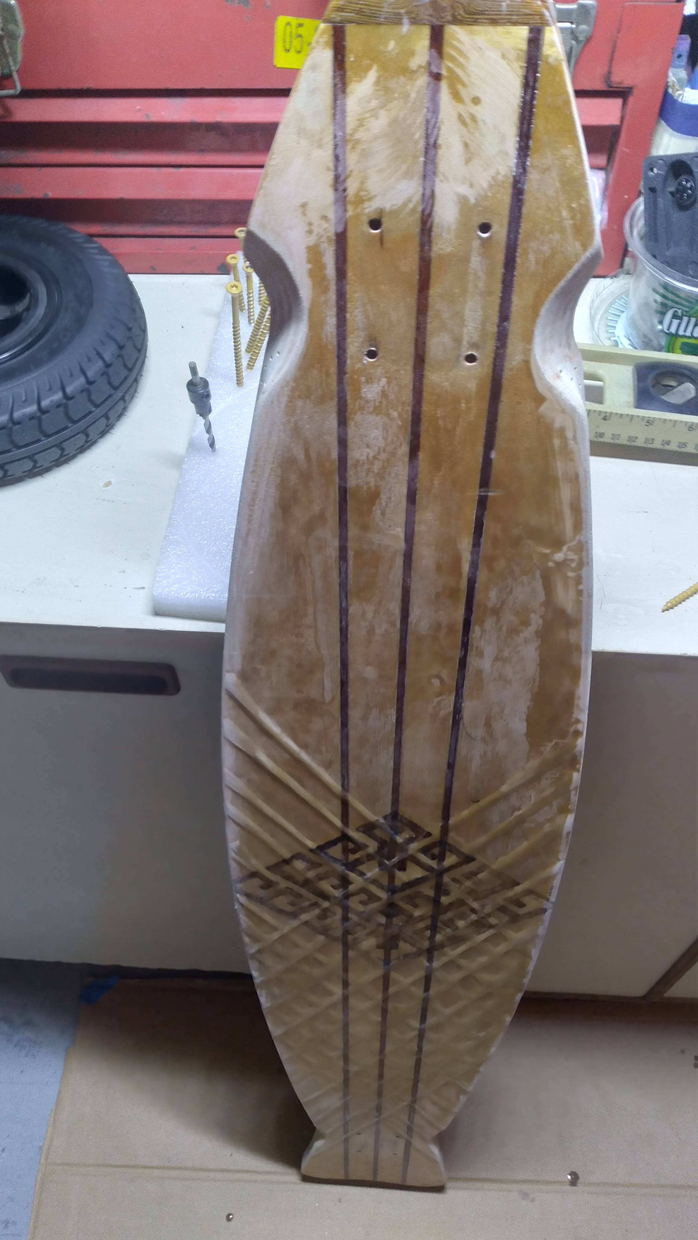

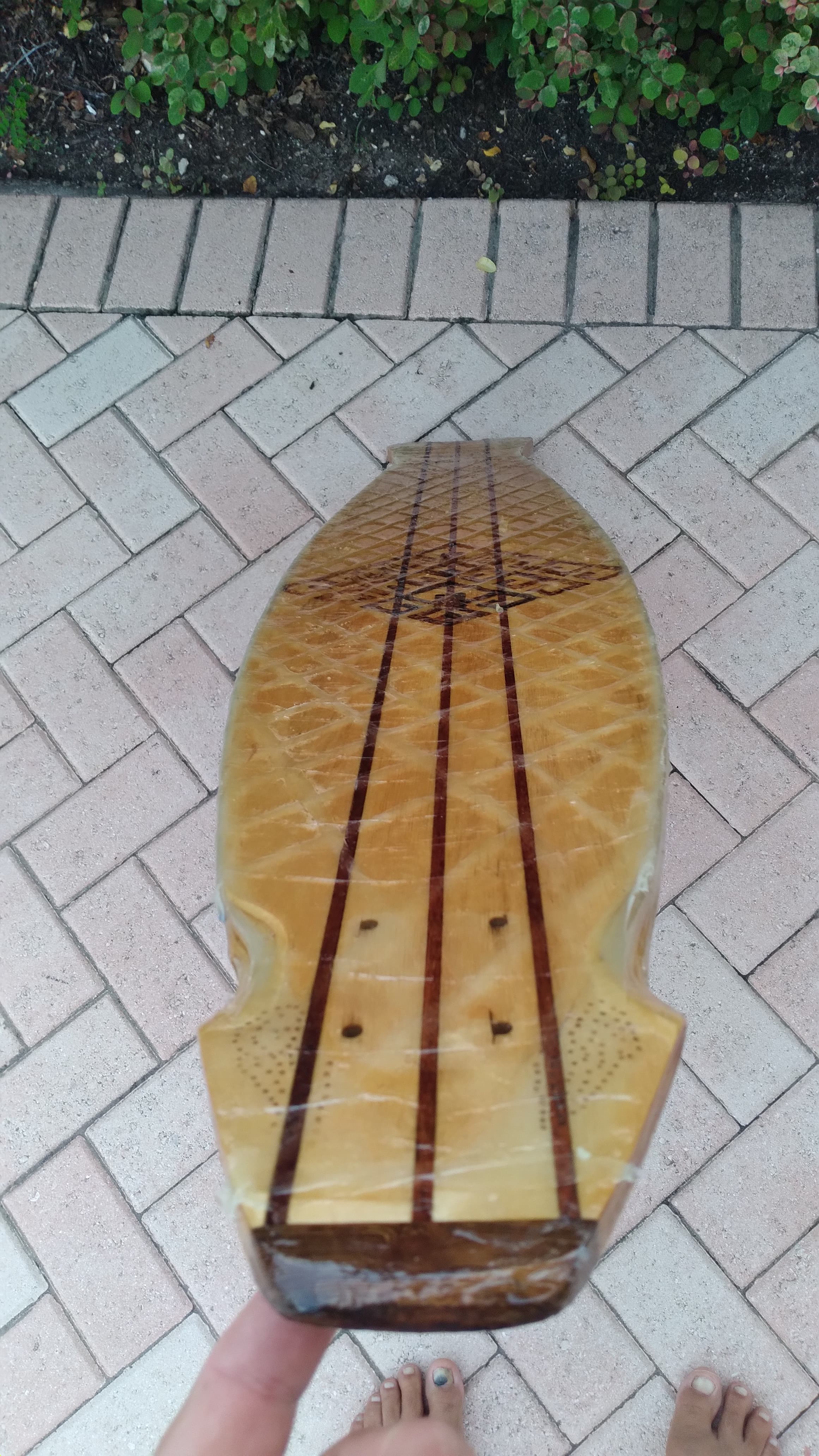

Today I was working on My Esk8 deck.
It too is old. I made it in 2003, from some 13 layer Baltic birch plywood which came in 5x5 foot long sheets and was advertised a Finnish baltic birch, not Russian.
I’d added three mahogany Stringers to the middle, and used biscuts and some water based wood glue I got talked into using against my better instincts to join it together. After riding it for a bit the glue lines started to fail along the mahogany, and I made another deck from the baltic birch without stringers, and this deck sat unused for many years.
When i broke that deck, I busted out the triple stringer deck, and decided to add some White oak butterflies across the top to hold it together. That worked well, and the board got ridden hard and started getting more and more flexible. So I added the cross hatching roving strips top and bottom to stiffen it up a bit.
When I got into Esk8 in October '23, I was like, hey, I can strap that junk 7s enclosure to it with the 80mm Jking hub motors, and my first ride on it I was like I am never riding a short kicktail again, why did I not do this sooner?
I had an extra Mountainboard TKP truck left over from my kayak cart build, and 200x50 pneumatics I threw on the front, just so see, and I was like, I never want to ride urethane on this board’s front truck again, and have not.
This deck has at least 3k miles on it since I electrifyied it, and always flexy, has gotten more so.

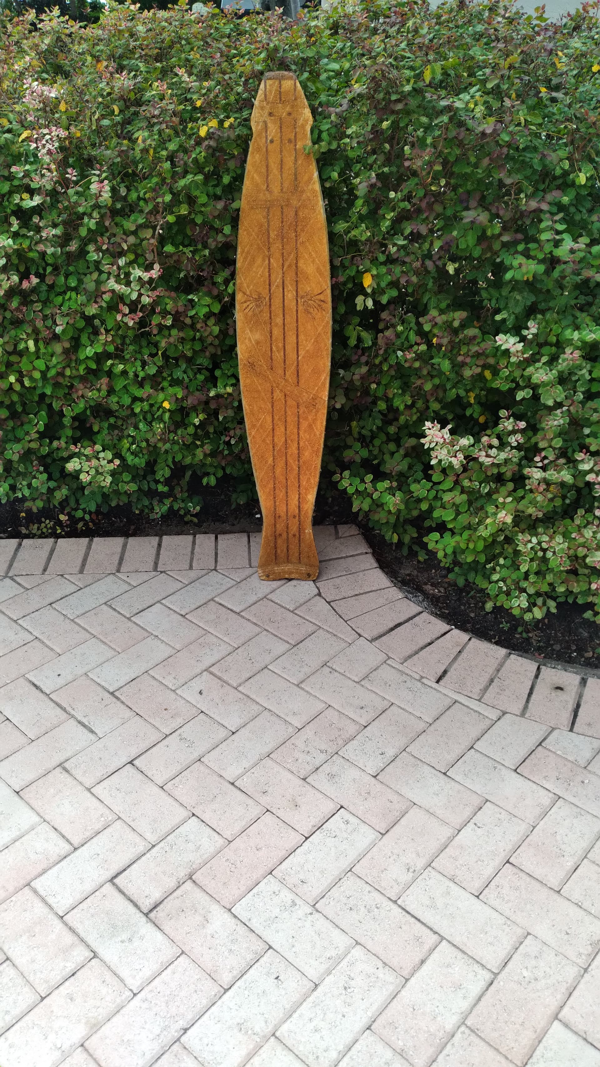

I never knew what to call it. and was just calling it my long cruiser.
but today looking at it on the workbench, I was struck how much it looks like a fish.
A small Fish.
A guppy.
So from here, it shall be called the Rolling Guppy.
It will be continue to rebuilt and reinforced and prevented from breaking, and providing me with untold amounts of Joy, just like its foam fiberglass and Cedar big brother, patiently hanging on the garage wall, waiting for the next time I get to surf again.

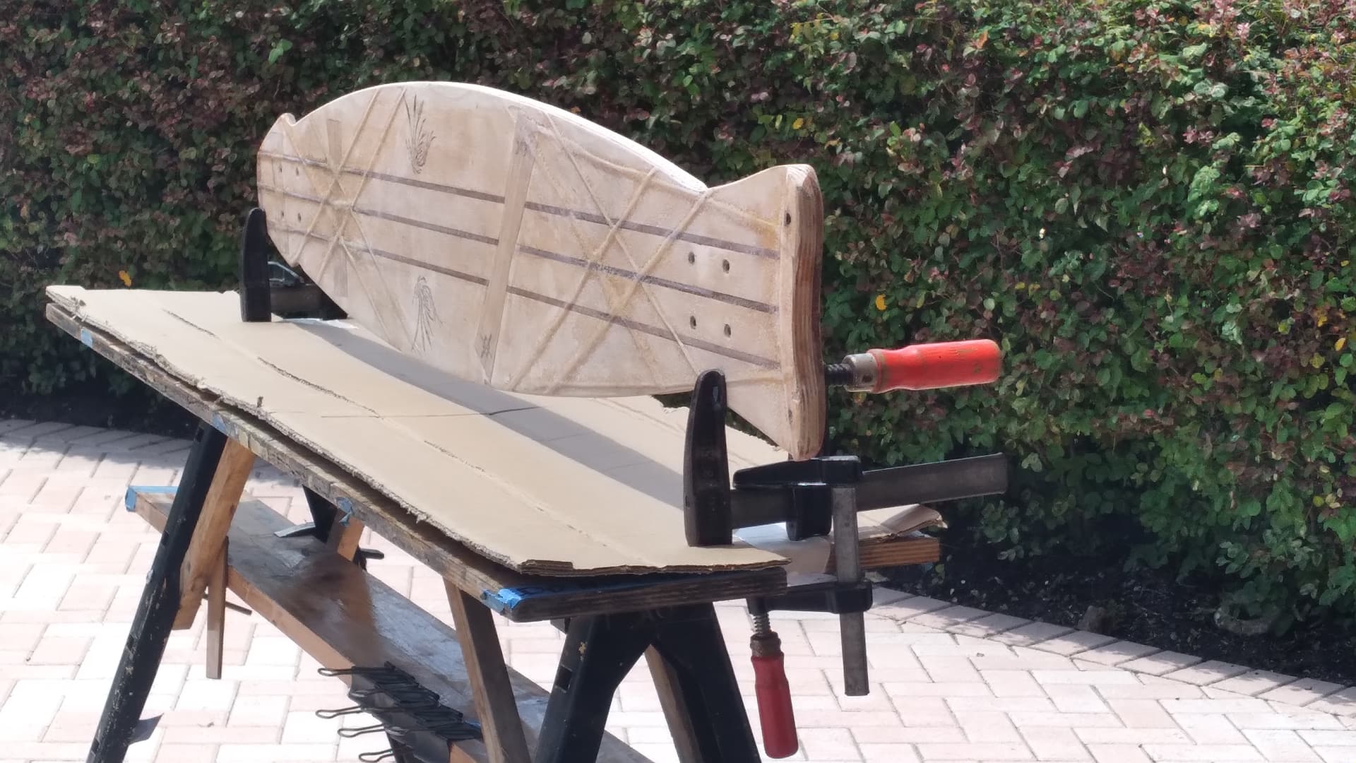

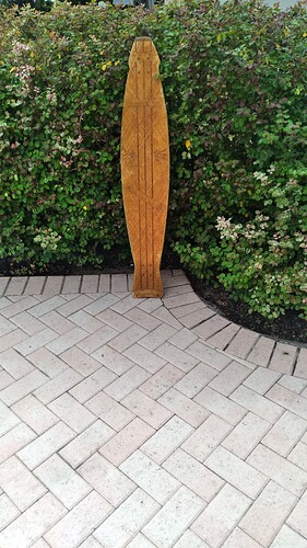

Here is the original Guppy:
9’3:x 22" wide, 3 inches thick
I filled each rail cove with 8 strands of fiberglass tow/ roving saturated with ~75 grams of epoxy
The deck also got 8 more strands 2 along the perimeter and the other 6 diagonally rail to rail. The I did the turbinado coarse brown sugar deck grip. This is before the sugar dissolving rinse.
The roadside also got 8 more strands, 4 along perimeter and 4 diagonally.

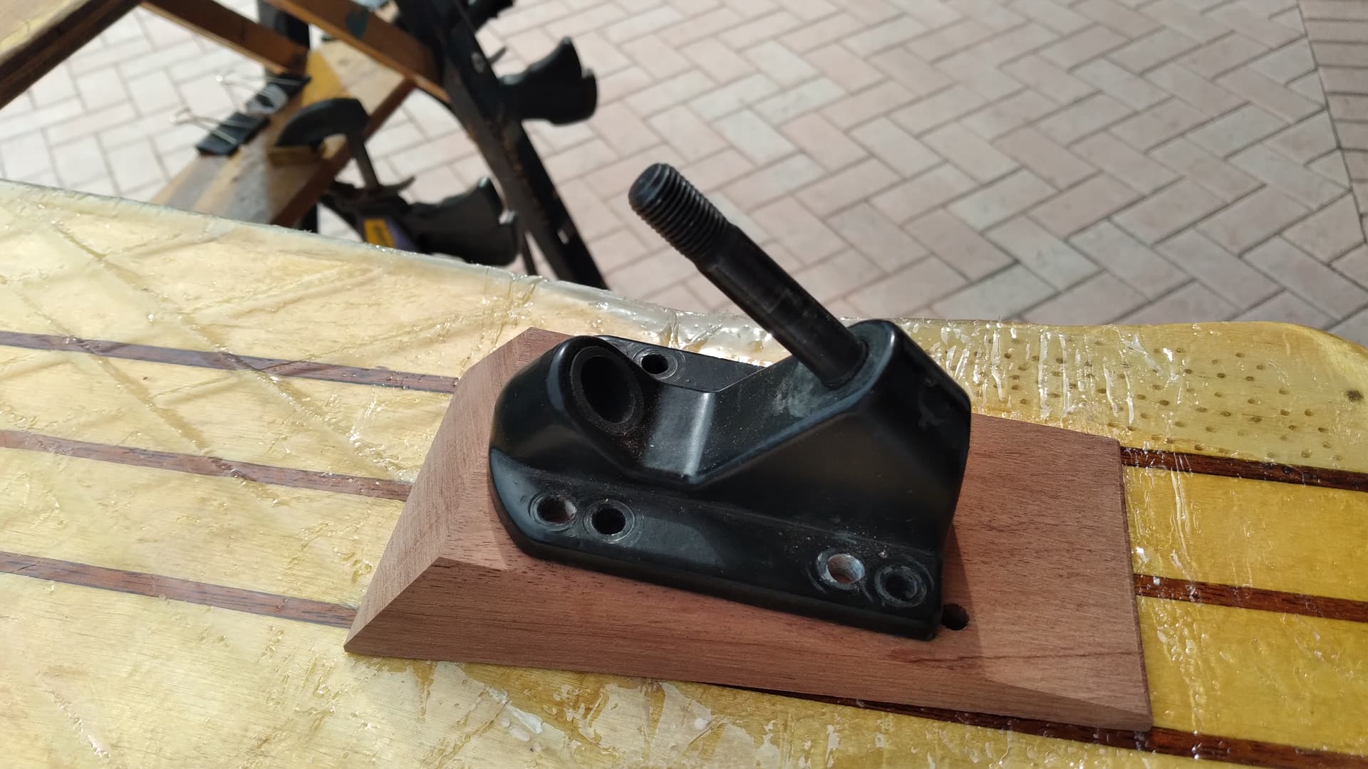

Made some 9 degree wedges on my miter saw out of Bubinga, a deep dark red heavy super dense west African hardwood.
These will rest atop some of the hardened strands, and I need to make sure the load is spread evenly, not concentrated on the hardened strands.
I am fearing that I might have reduced the flex far more than intended.
My midsize has been rolling daily on 80mm front wheels and the 90mm sleeves. I am not feeling the kicktail. My average speed is way down as is my confidence on it. That one wheelbite episode, even though I tucked shoukder and rolled and popoed back to my feet like a younger version of myself is a bit.of a wake up call.
I want the guppy rolling on the new Kendas and back on the 105m sleeves
i wanted to spread the load of the baseplate across more of the deck, or maybe I just wanted to use my Miter saw and make sawdust dust and waste time.
I added a degree of angle from the 1994 era plastic wedges that came on my gravity longboard. My front TKP truck’s wedge I had used a belt sander to add more angle, but the rear dewedge was stock angle.

Regular sugar for 120 grit
Coarse brown ā€˜turbinado’ raw sugar for 50- 36 grit.
Let cure fully.
Spray with hose, sugar dissolves, leaves textured epoxy.

Screwed up my attempt to flatten where the Bubinga wedge risers will reside on the guppy.

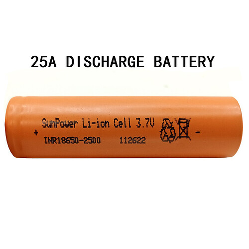

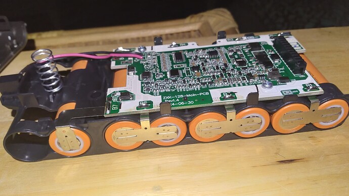

Opened up my cordless vaccuum battery. It was advertised as 8s, but is only 7s.
It did claim 2200mah cells, and the cells within are Sunpower 18650-2500.
I have to be frugal with this battery, and not use the higher speeds as often as I otherwise would in order to finish.
Gonna remove the Sunpowers, and install Ampace JP30’s
Had to get some longer 10-32 hardware to mount Puaida baseplate on the new, thicker Bubinga dewedge riser.
One of the new 2.80-2.50-4 Kenda K473’s had issues not wobbling on my rim, and in the initial attempt at dewobblification, I discovered my TKP Hanger from the analog Vevor mountainboard is bent slightly.

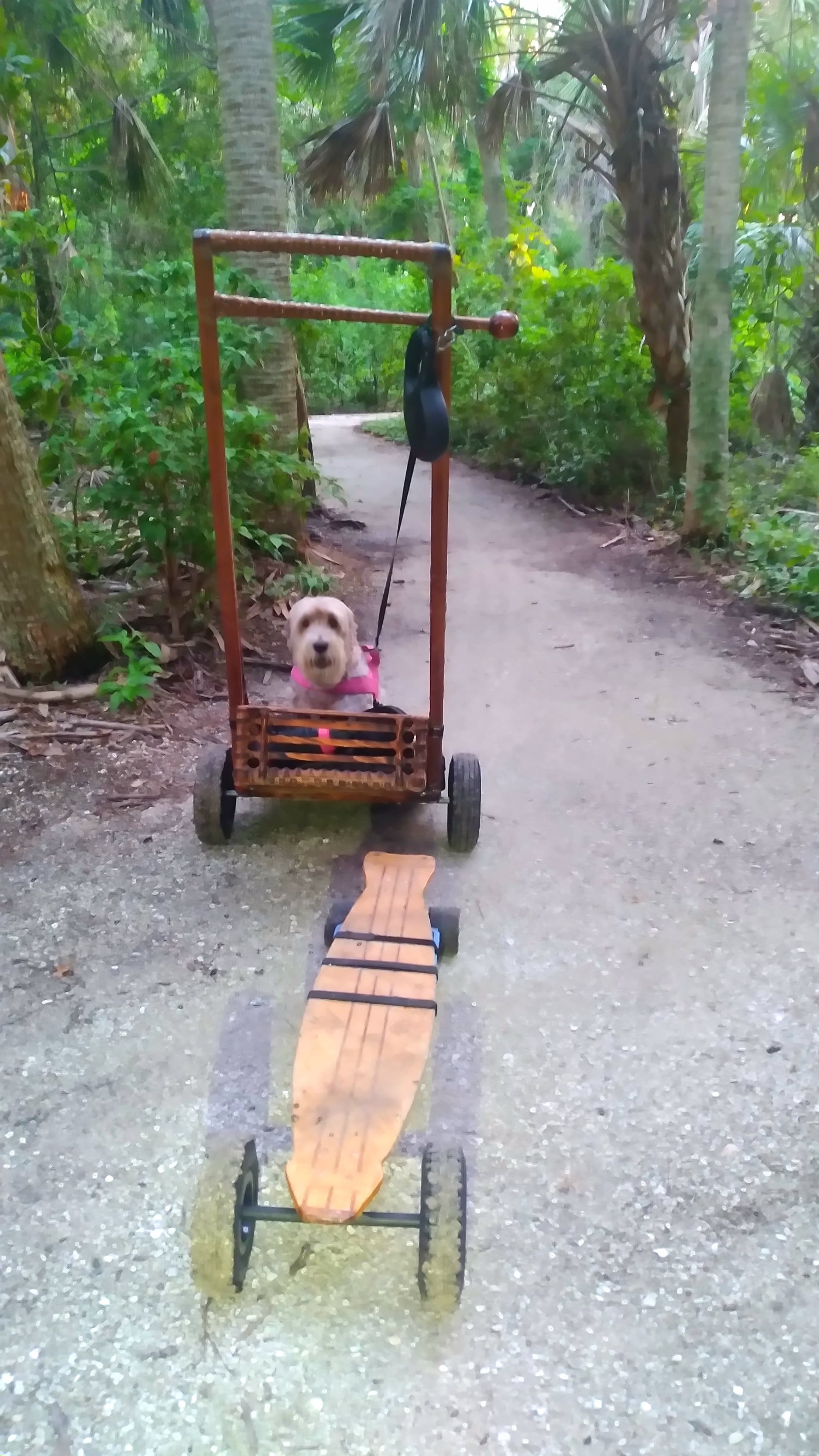

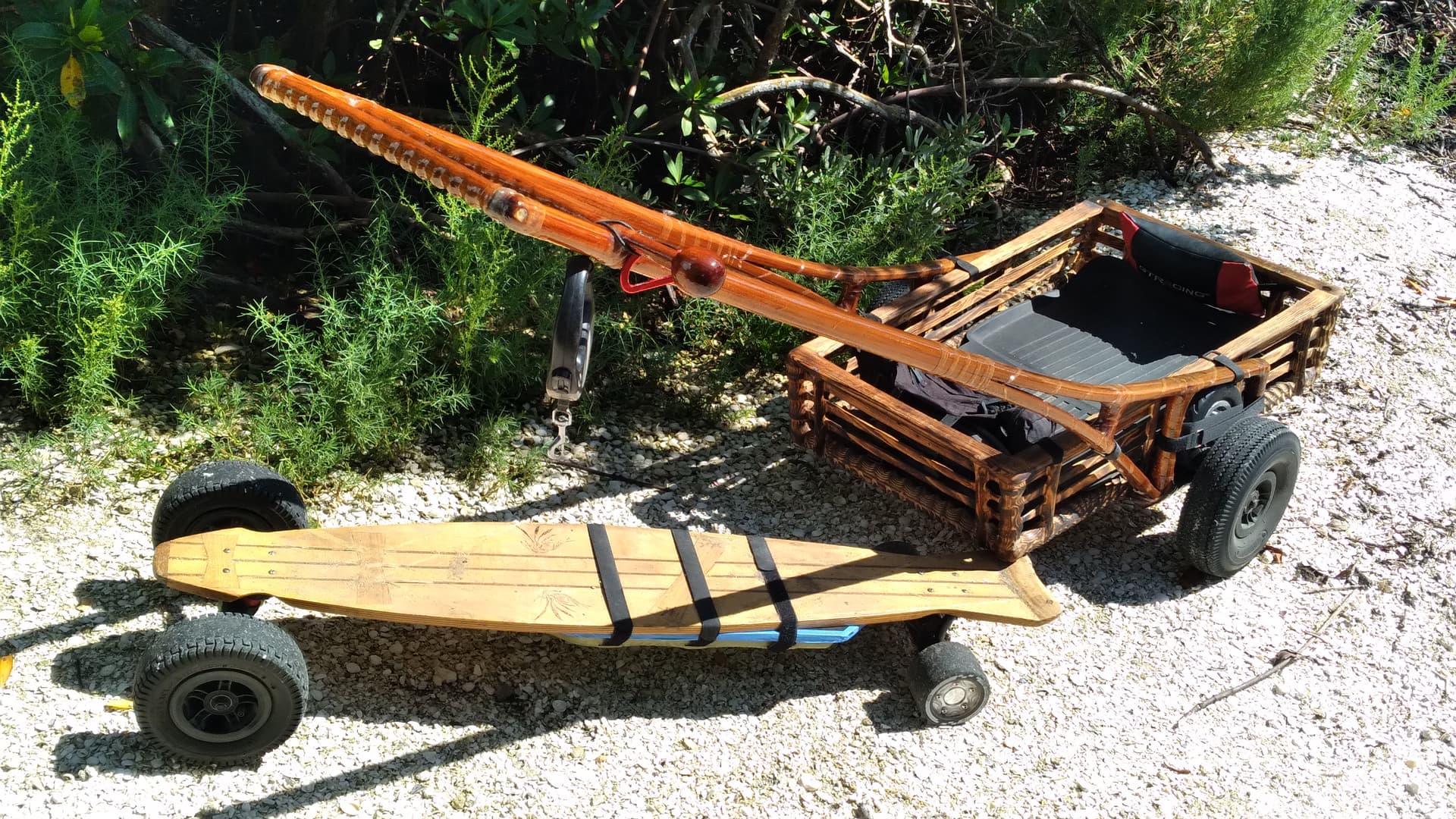

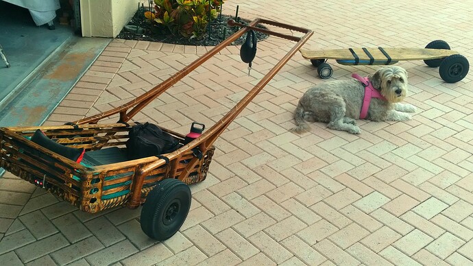

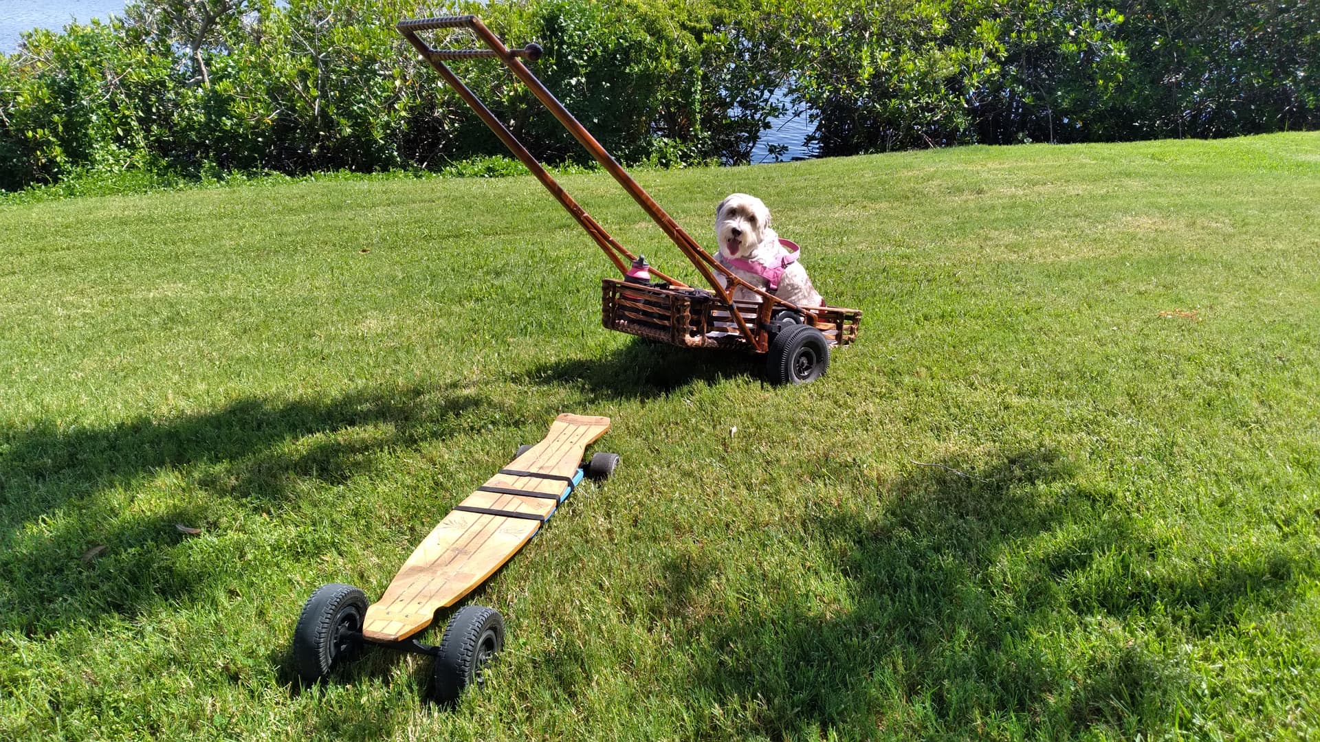

Fiona was upset at my solo test ride, so out came the chariot and we headed to the closer park and hit the rough section of asphalt, which is almost intolerable on the midsize.
I still have the worn 90mm sleeves on my hub motors, and the vibration absorption of the reinforced, less flexy guppy did not seem affected.
The Kenda’s ride very smooth, but there is a lot of tread squirm, and cornering feels and sounds weird, but I assume they need to be broken in.

They are very quiet, and seem pretty efficient at 25psi, but I was running my worn 8x3" cheng shins at barely 8psi, trying to get the shoulders to bear some load and reduce center wear.
I’ve not balanced them yet, but they are almost completely wobble free.
The new epoxy raw brown sugar grip is great.
Confidence inspiring.
I’m digging the lesser flex of the deck too.

Cut a ride short yesterday because a rattle developed.
Pulled the tape on full size neoprene enclosure gasket to go rattle hunting, as it sounded plastic on metal to me, and nothing outside enclosure was loose.
Note to self, need more small zipties.
Nothing was loose, or responsible for the rattle, but I added some more padding and zip ties to interior roving bridges, just in case.
I then assumed the rattle had to be the 105mm sleeves on the hub motors. I was never impressed with the fit. I wrapped one layer of nashua flexfix tape around the motor’s edges, and there was at least a friction fit on the sleeves when I reinstalled them.
But the rattle was still present, and the high heat tape will likely make an ugly mess on next sleeve removal.
Everything was tight, and I was getting annoyed, but pretty sure nothing was going to cause streetface.
This morning’s roll the rattle got bad towards the end, and immediately after an expansion joint slammed the rear, it got worse.
I figured then it was slop on my new oversize Bubinga wedge risers, even though it sounded more plastic on metal. The hardware was tight and tightening it more had made no difference.
So I made Neoprene gaskets for between wedge riser and deck, and baseplate and riser. Tightened the hardware slowly in stages to compress the neoprene evenly. Took 3/8" wrench with me on the test ride and…
No more rattle.
Sought out the rattle road, and no more rattle.
Yeehaw.
