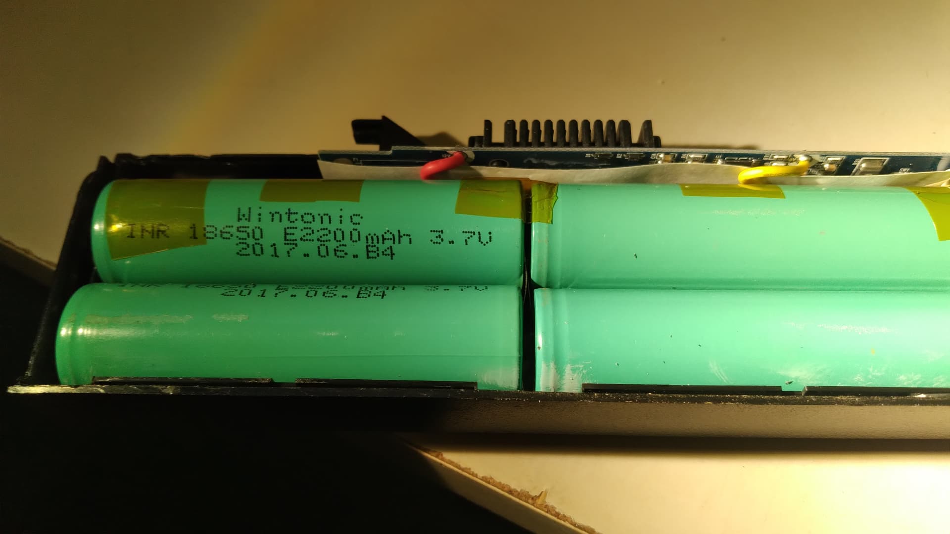

Yeehaw, some Gen U wine Wintonic e2200 cells, from 2017, with a max 6.6 amp max discharge current.
They ran my laptop for 20minutes. It Said ~56% when it just shut off, no warning.

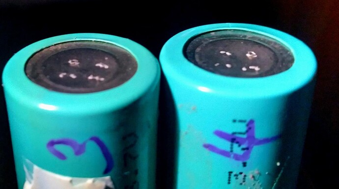

These Wintonic cells are not going to be great for test welds. The center of the anode has a raised portion in the center, which was then compressed by the spot welder used in china 8 years ago. The can was then easily deformed when removing the weakly spot welded 0.1mm nickel plated steel series/parallel connections.
Cells 1&2 were in parallel, 3&4, and 5&6.
cells 3 and 4 registered 3.5559, and 3.5594
cells 1 and 2 were 3.6129 and 3.6113
cells 5 and 6 were 3.6163 and 3.6164
I ran cells 1, 2 and 3 in a 3S 18650 leaf spring holder, powering a 12v variable speed fan.
Cell 3 hit 2.8v first, triggering the LVD. Cells 1 and 2 were 3.48v and 3.49v under a 1 amp load
Same test with cells 4,5 and 6.
Cell 4 hit 2.8 first again and 5 and 6 were 3.44 and 3.45.
Cells 3 and 4 were in the middle, in parallel, and have the most dented cans.
I’m gonna run them all way down and test weld on them anyway, but I suspect the cans are far thinner than my Eve 40PL’s or BAK 45D, and not great for refining the settings on those cells, but they have to be better than using razor blades just to determine the general power and pressure required with the P20B welder amd 0.2mm copper.
