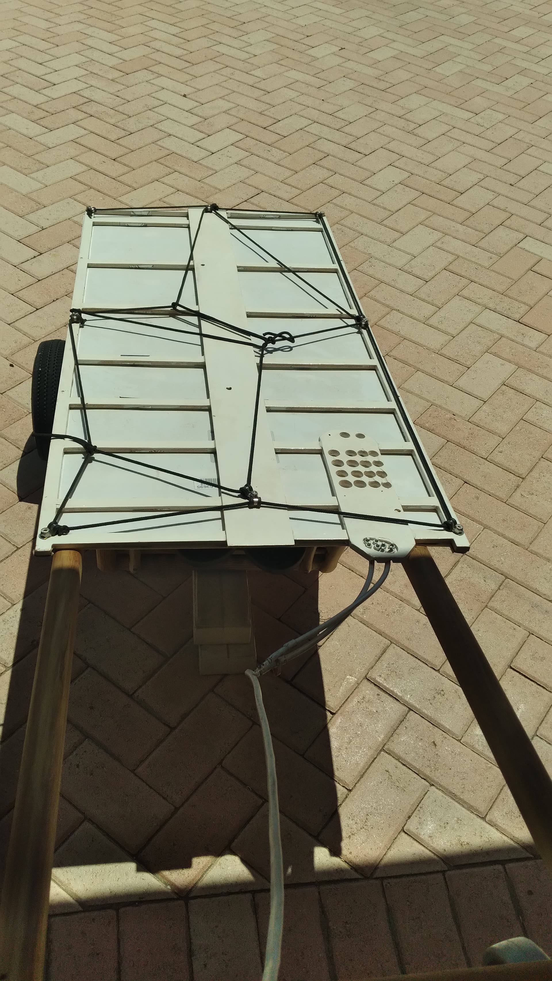

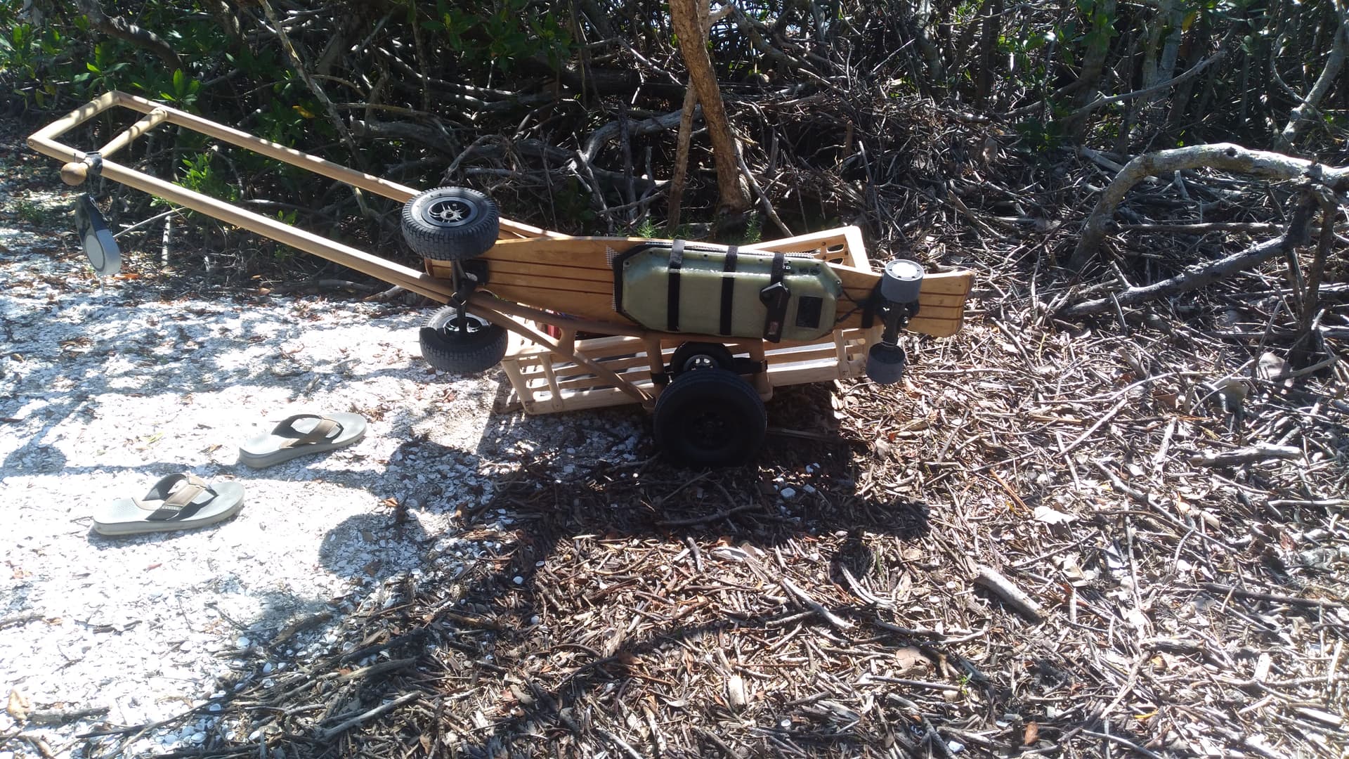

I had a few extra velcro cinch straps today, and attached esk8 to chariot like this for the first time.
Can face the pneumies on back too, and handle is balanced close to perfect.either orientation.

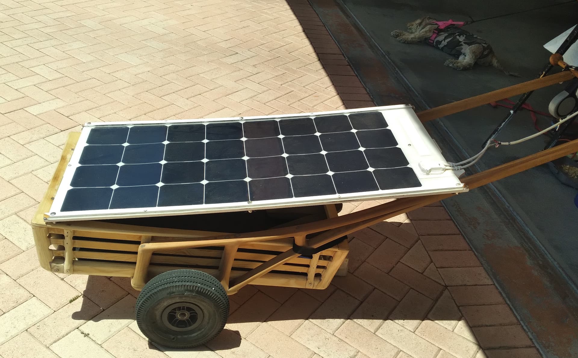

Another experiment.
100 watt 12v Nominal SunPower ‘flex’ panel to CCCV booster set at 41.5v output charging depleted 10s2p Esk8 battery.
Input booster voltage drops into high 16’s when dialing current trimpot higher. At some point, input voltage drops to 9.87, and watts in drops to about 53
Any passing shadow when dialed to 80ish watts input, has input voltage drop to 9.87, and wattage about 53. Got to dial down current pot enough to go below 53 watts to get voltage to jump back above 17.
If i keep it set to about 53 watts then passing shadows or complete shadow and it recovers to 17v+ input and 53 watts output.
So nearish noon, I can dial as high as 77 watts into 10s esk8 battery in perfect conditons meaning no shadowing.
Reliably 53 watts max in likely conditions.
Gotta check at 7s output voltages too.
Am seeing how I want to mount Fiona’s new Awning to chariot.
solar shade? :smiley:
Sun angle becoming brutal.
The breeze when rolling only helps so much.
53 watts charging, is not nothing.

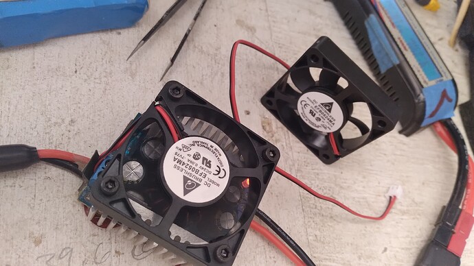

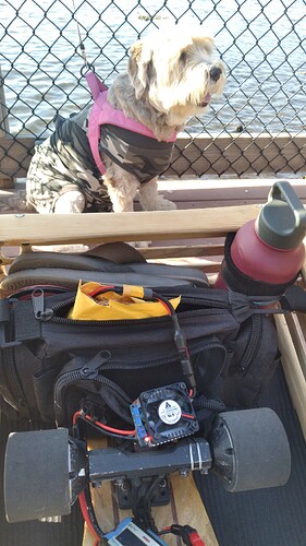

Two Delta 50mmx10mm 24v fans arrived today.
Tested them at 12v, up through 29.6v.
Have one Now bridging my 150watt CCCV Booster’s heatsinks, with a little gap between, via some M2.5 screws, sucking air through.
Not much flow at 12v, but nice and quiet. Better than no airflow.

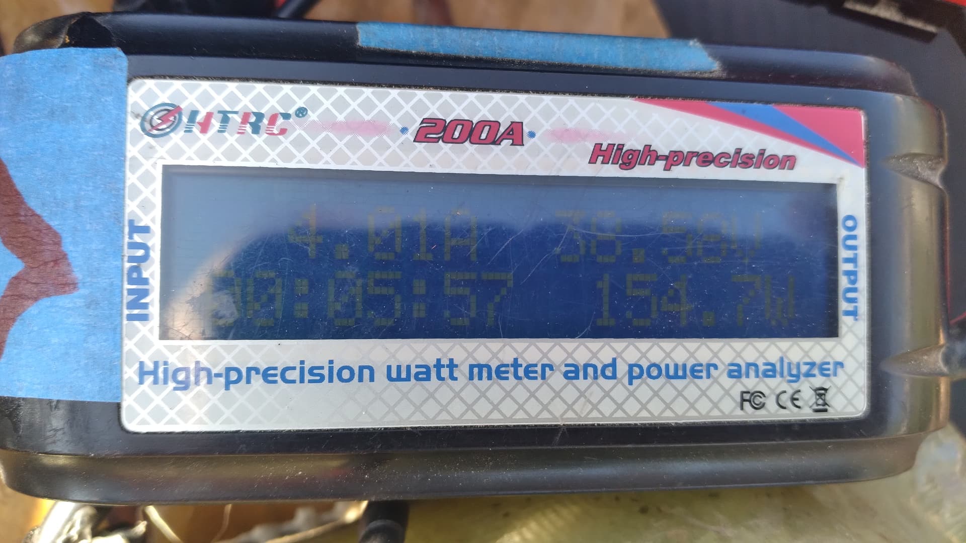

Now Charging 10s2p at 154 watts/4 amps walking and chilling the far park, from 7s2p.
Finned heatsinks staying cool with 24v fan at 24v+
This same booster with no fan on 5s at 2 amps/ 80 watts, got very warm.
Battery gonna be quite warm on return.

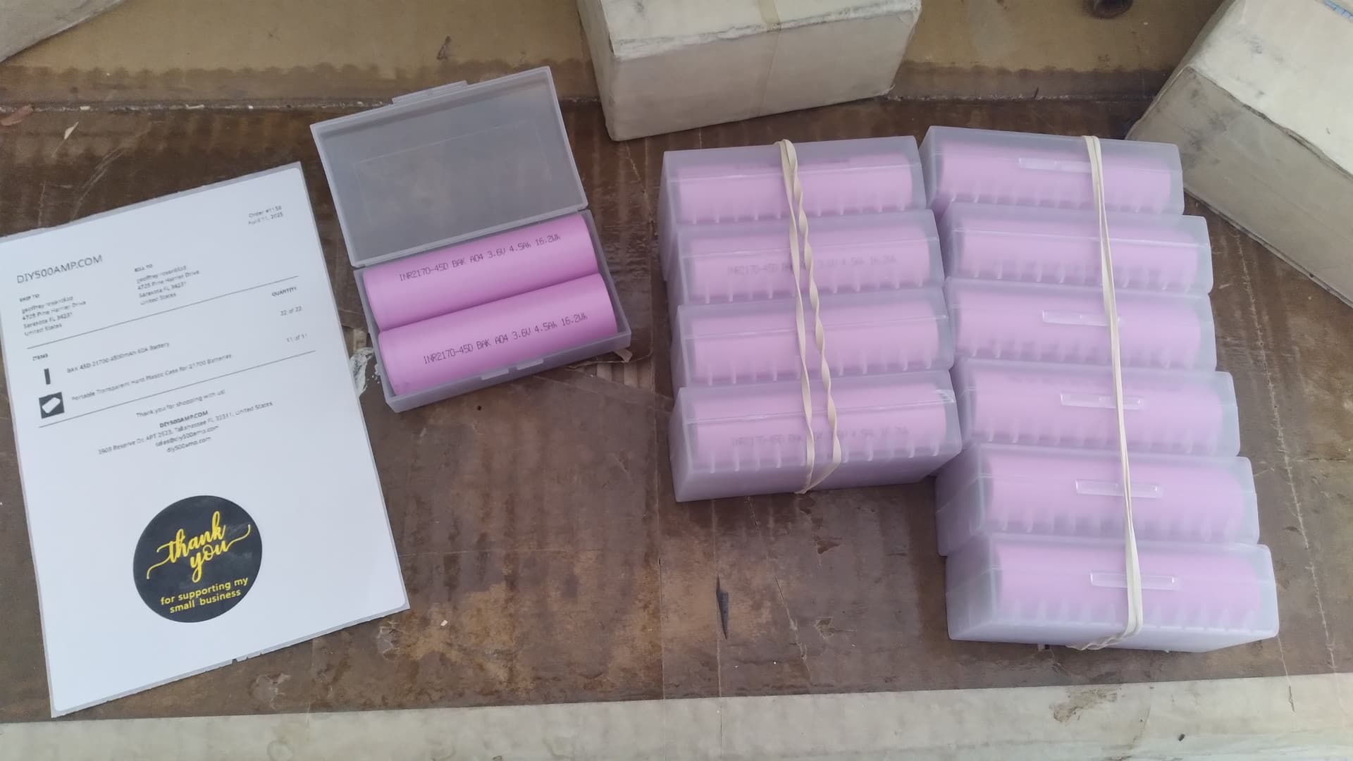

Just ordered 22 Tabless BAK45D from @DIY500AMP.COM
He included 11 dual 21700 plastic case holders, gratis, and I just got a UPS tracking number within a half hour of ordering.

I am glad my experiment with a 100 watt rated 12v nominal solar panel feeding a CCCV booster, feeding a 10S2p esk8 battery has stirred interest.
I am still Vesc challenged, but am willing to absorb the conversation, or try to. Please continue here, or if this topic deserves its own thread, then make it so and no worries from me either way.
A short summary of my experiment, is that I could spin the current potentiometer of the CCCV booster upwards and get 83 watts output from a 100 watt rated panel in full noonish florida sun mid April.
This output is similar to previous maximum recorded output of this warm to hot panel, when feeding either a MPPT, or PWM solar charge controller, on a 12v nominal Lead acid system.
If the solar panel was shaded briefly at that output, then voltage on input side of CCCV booster, fell to below 10, and total output wattage to 53. I had to crank current potentiometer on CCCV booster way down, for input voltage to recover to 16v plus.
If I kept max output wattage, via CCCV booster’s current trimpot, to 53 or less, then input voltage after shadowing the panel, would recover to 16v plus.
@16v plus input, I could then dial current potentiometer to 83 watts again, but 84, and it would collapse to 53watts max and 9.87v input, and the booster documentation says 10v is the minimum allowable input voltage, so how long it could handle 9.87v input is the ?
So with what i have now, I can get 83 watts at noon, in Florida, this time of year, if babysitting the panel and booster with jeweler’s screwdriver ready to spin current trimpot down, then back up, while watching hard to read wattmeters in full sun.
If I want to set it and forget it, I can dial 53 watts max. This 53watts max lowers as sun drops toward western horizon.

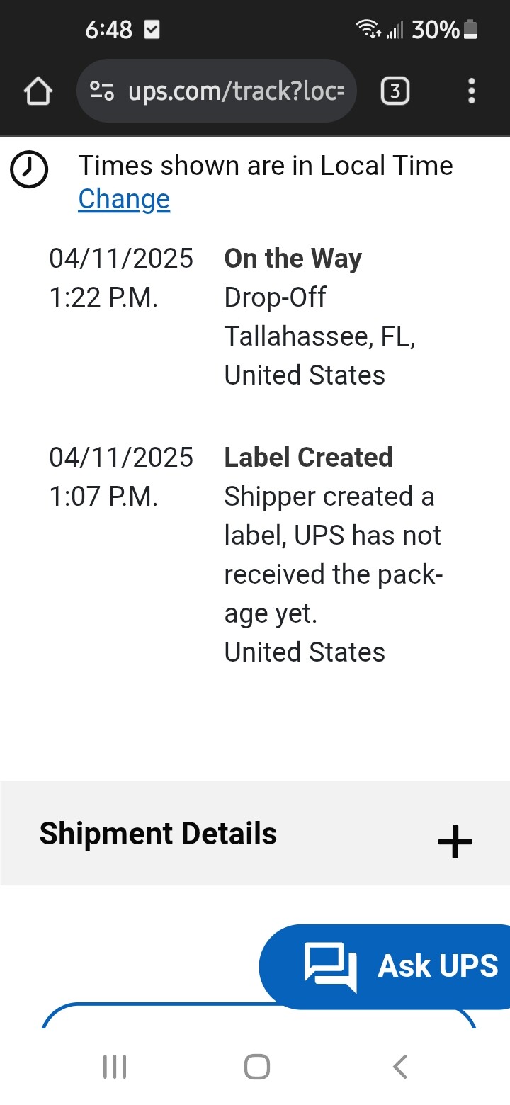

In other news, I placed my order for the 22 BAK45d at 12:36pm today.
A shipping label was created at 1:07pm.
UPS was delivered the package at 1:22pm
Expected delivery, Tomorrow, between Noon and 4.
I could be building a battery this time tomorrow.
Faster shipping service !!! :smiley:

I glad it make it fast and safe !! Thank you for supporting the store buddy !!

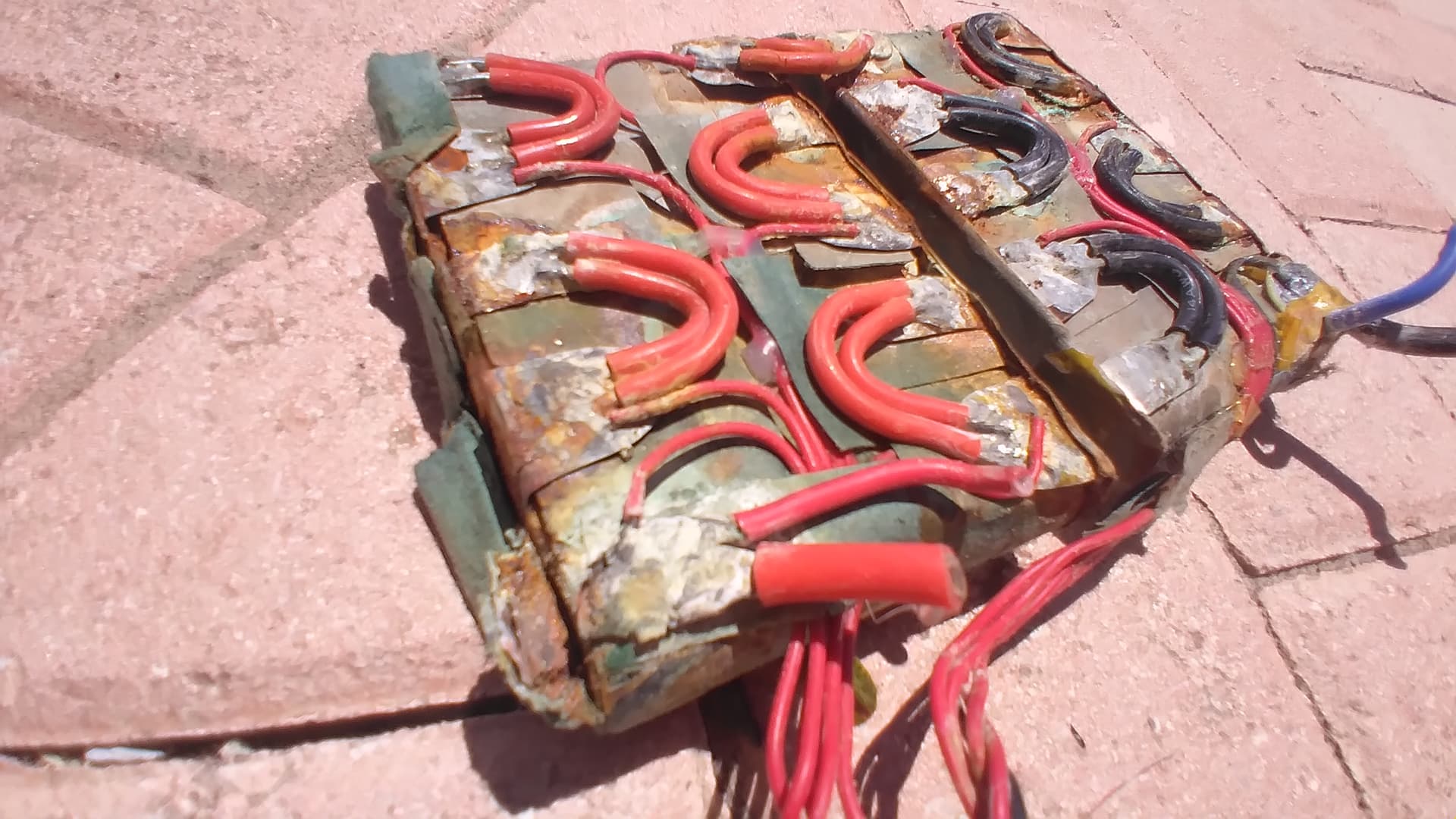

Here is my poor saltwater submerged 10s1p P42A, 4 months later.
lets rebuild the pack !!!
I was able to push that 1P P42a pack to above 58C too, on a hot day, riding it hard.

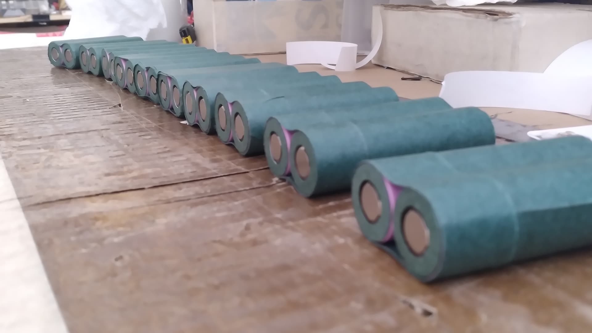

I am assuming in the picture are the BAK45D?
Yes. They are the BAK45D.
