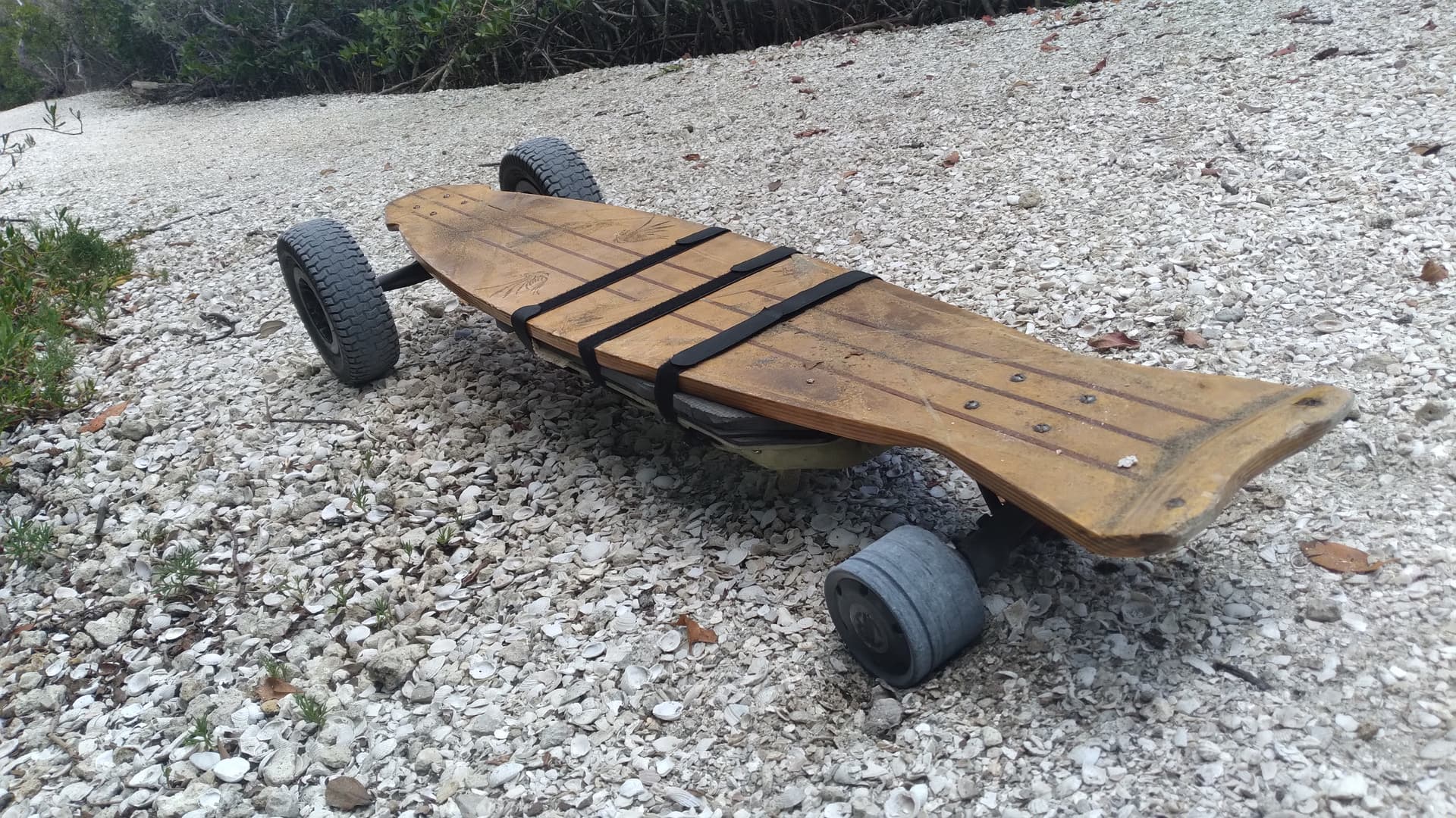

While she was at the Hospital, I went for a roll, and allowed a 240lb guy to ride my board briefly, a short distance. I used to ride the snot out of this deck as an analog, several years ago, when weighing close to 220lbs/100kilos, and figured this deck could handle his weight. I put remote on speed level one(4mph max) and did ask him to take a wide stance with feet closer to trucks, and he stepped in the middle, then moved his feet.
Holy board flex batman!
It survived no issues, but the enclosure looked so damn close to the road.
Glad the enclosure is so overbuilt and rigid and there is some give on the velcro cinch straps, as I was envisioning broken welds.
Went to the CST afterward. A lot of new shells have been laid down. Uncrushed, uncompacted, soft, dusty.
Areas without new shells are soft from the tracked machine used to transport them.
I could feel my 8x3 turf tires, at 9psi, plowing trails, the 83mm hub motors tried, but failed to maintain momentum and the black paint on the hanger is now coated with calcium carbonate.

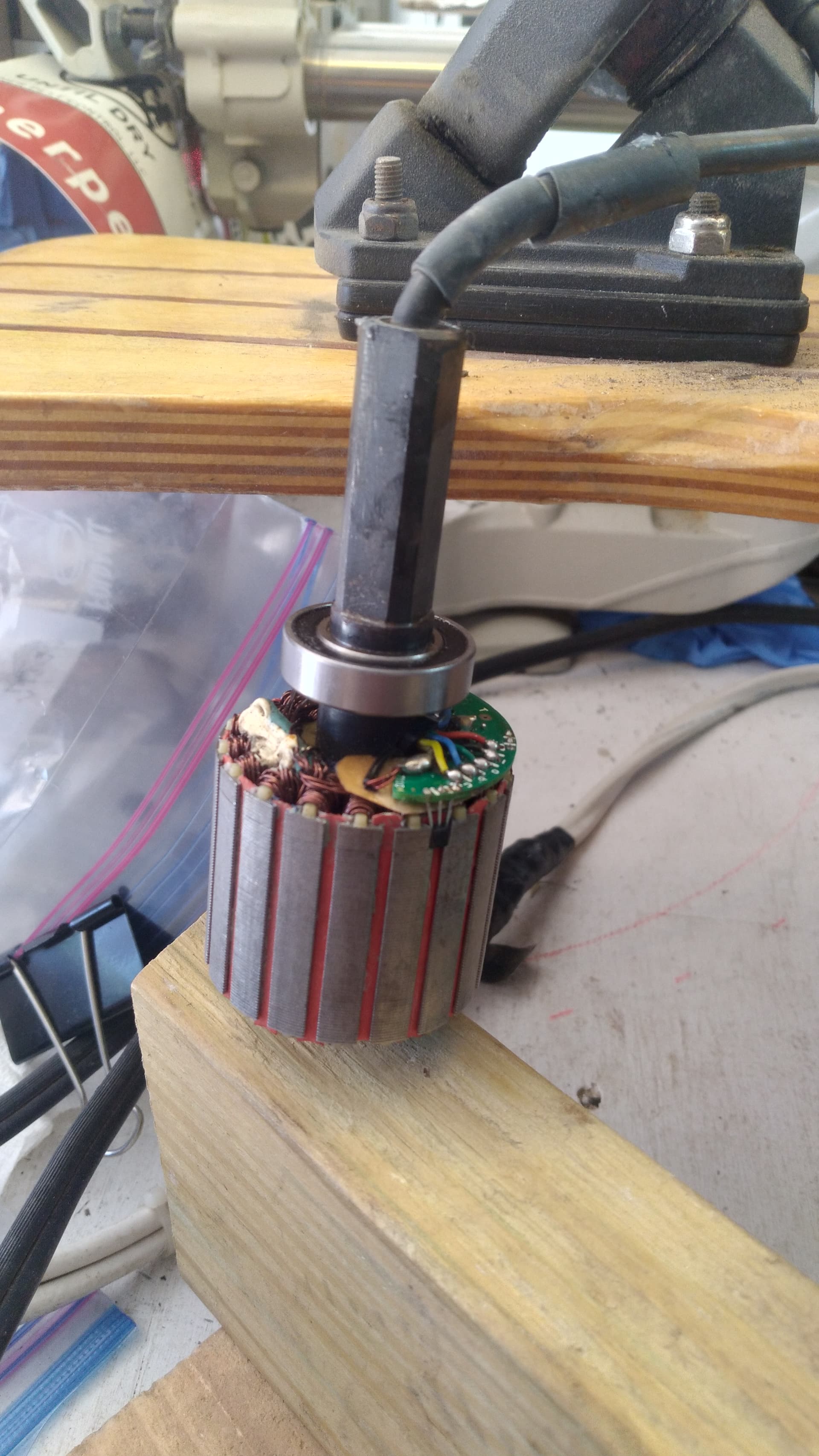

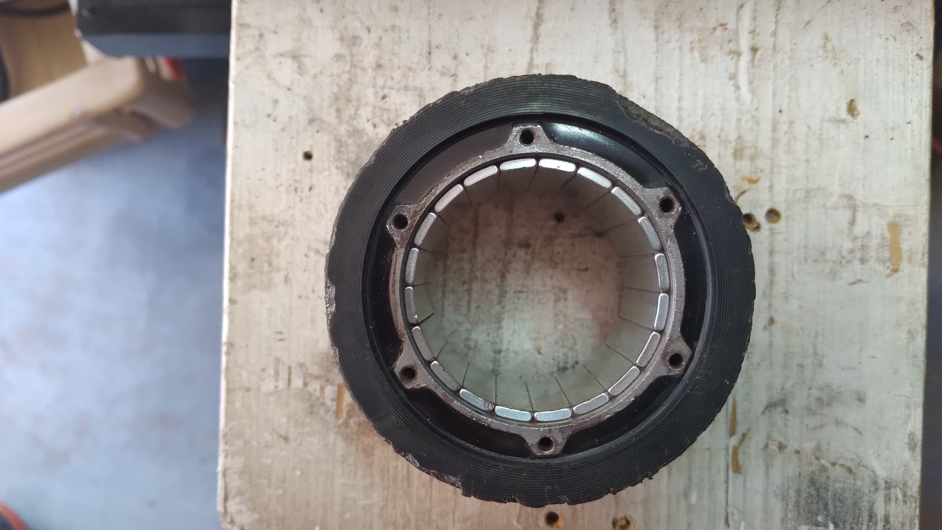

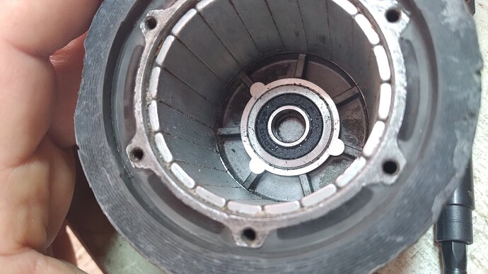

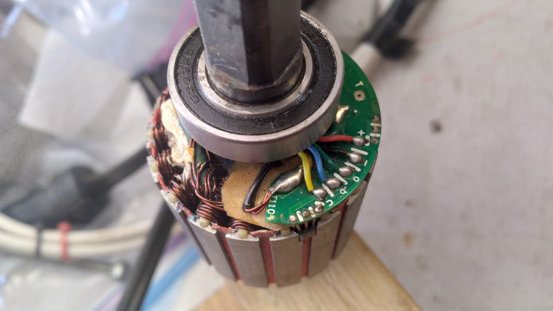

I disassembled a hub motor, and got a look at the interior bearing. I pulled the rubber seals they looked good and clean inside. I added a bit of grease and reassembled.
Still some motor noise.
Will do the other motor later.
The inner hub motor bearings are 6902 RS
15x28x7mm
I did not try and remove it from the axleshaft, as I have no new ones to replace them, as I had no idea what size bearings they were, and am not sure how to get them off anyway.
I just popped off the outer rubber seal, expecting to see grey sludge, not clear clean grease.
Also, these 83mm motors came with the tiny MR30 phase wire connector. Which will fit through the 15mm center of these bearings. I put MR60’s on them which will not.
No big deal, but I also used some gorilla grip clear goop under the cap before seating it on the mr60, so basically will need to cut it off to replace the bearing, and the phase leads are already shorter than I’d like.
The outer cap bearing is a 16000 2rs.
10x26x7mm
I replaced this one already, and it too looked and felt fine with a similar amount of clear factory grease inside. I have one more new one, somewhere.
I had issues with this specific hub motor making weird interference noises in the past, then got the 90mm Puaidas and then tabled these.
One issue previously noted, was that on reassembly of these hub motors, one has to attach and tighten the inside 6 m3 screws first, then seat the outer cap. and its six screws.
The reverse order had the an internal interference sound occur.
Thanks to @Pecos for that helpful tidbit of knowledge.
The other hub motor did not seem to care about this order of operations, IIRC.
I speculate now this might be because the 6902 rs bearing was not seated to full depth inside the inner cap, and maybe why these motors seemed to allow sand to get inside as the caps were not fully seated against core.
I found no sand inside today though, but it was not sterile in there either. The photos were taken after cleaning.
These hub motor sleeves seem to be unobtanium, so putting new bearings in them might be a waste of time and effort, especially as the bearing cages and grease looked fine, on this motor anyway.

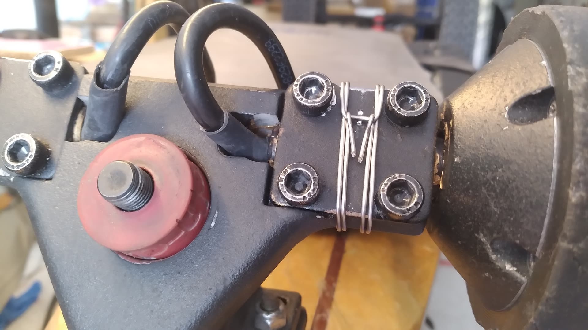

The 4 screws holding the flat steel plate to hanger, looked, at first, to have taken some cast aluminum with them, but it was some sort of grey threadlocker I dug out with a pick. I used some Loctite blue to return them.
The other motor, one of the four screws was tapped at a slight angle.
I am leery of taking this screw out. But if it strips the hanger, I have the Puaida hanger and assume the square axleshaft is the same dimensions.

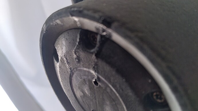

The cleaning of the starboard hub motor and its greasing of bearings, definitely produces a noticeable improvement in noise and vibration.
I had drilled two small holes in outer bearing cap to extract bearing.
I forgot to cover these holes with masking tape sharpied black.
They oozed some extra grease.
I took off sleeve of port motor while motor was still hot, and measured bearing caps, and stator body and sleeve interior temperature.
Hottest parts…Bearing caps, by 12 to 15f.

The starboard hub motor was cleaner inside than the port, but not pristine by any means.
There is ample room through the stator axleshaft, for the phase sensor wire combo cable. I gave it a blow, and zero restriction to airflow.
Definite potential for being sand and debris entry point. I put a bit of gorilla grip clear to block it off.
The bearings have no slop, no roughness when spun, and the grease under the seals was clean and clear. I just added a smidge more and reassembled.
The squared axleshaft on this side was not a friction fit in the hanger, like the other side I think some aluminum foil as a shim might take up any slop.
Hopefully can get a few hundred more miles outta these hub motors.

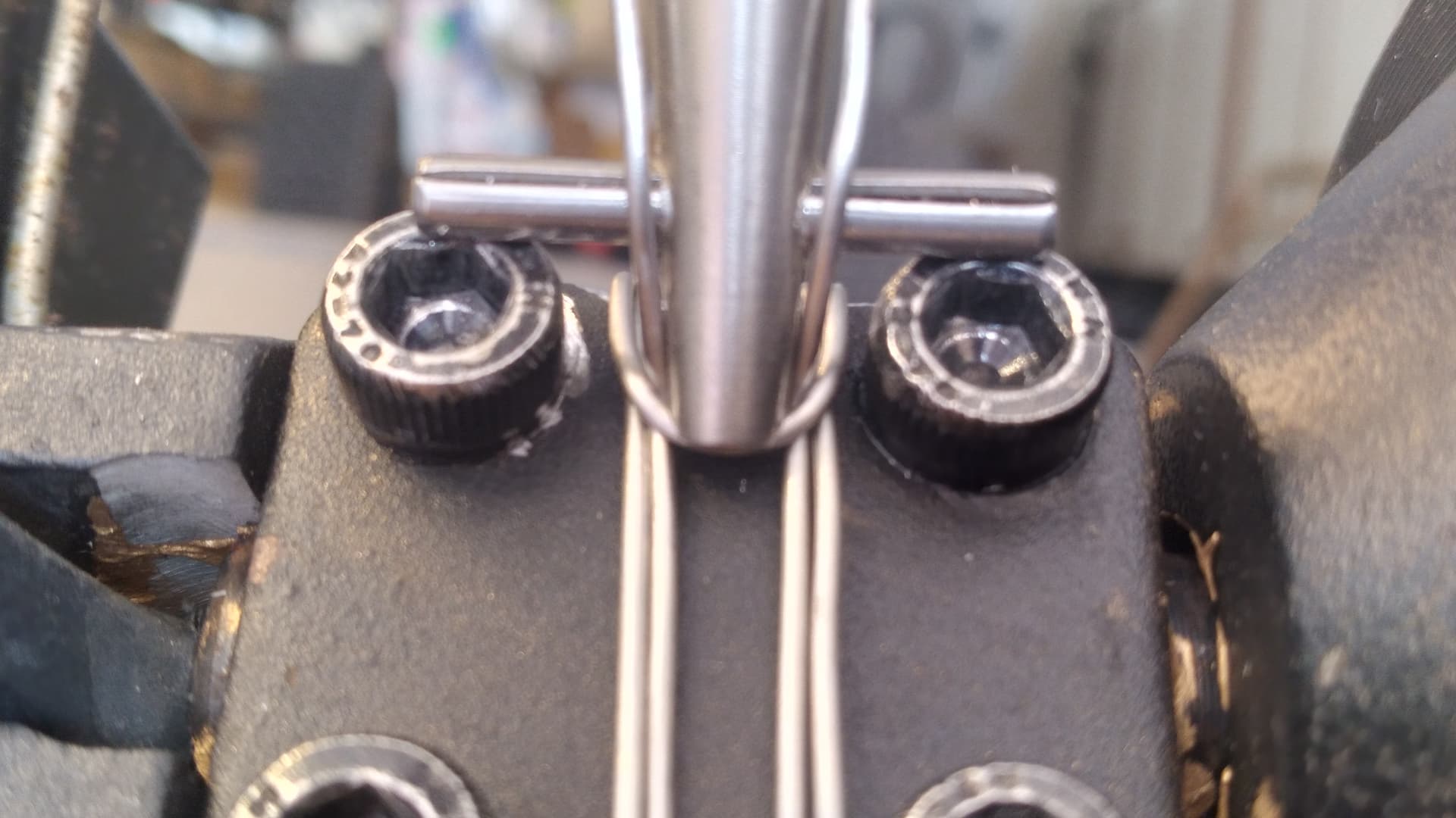

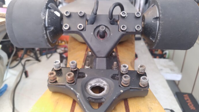

I pulled out the Puaida hanger, and tested the motor fit, and it was exactly as loose as the Hanger it came in. The square stator axleshaft is a bit small on the outside, and there is a tiny bit of slop before steel plate and 4 hex bolts returned.
i should probably just have JB Welded it. Used 1 layer of aluminum foil as a shim on outside, and thermal grease.
The bolts got loctite blue.
One bolt was factory drilled and tapped at a slight angle, so underside of bolt hit plate on one edge. I tried to dremel the plate so that full underside of this bolt head was in contact.
Imperfect result.
Quite different boardside bushing seat on the 2 different hangers.
I rounded the corners of the steel plate, and added a smidge of thermal mass and maybe some redundancy, with a ‘Clamptite’ tool cinching some stainless wire tight…Wish i had made 3, maybee 4 full wraps, not two.

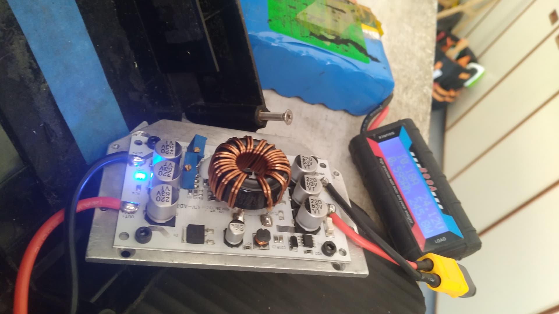

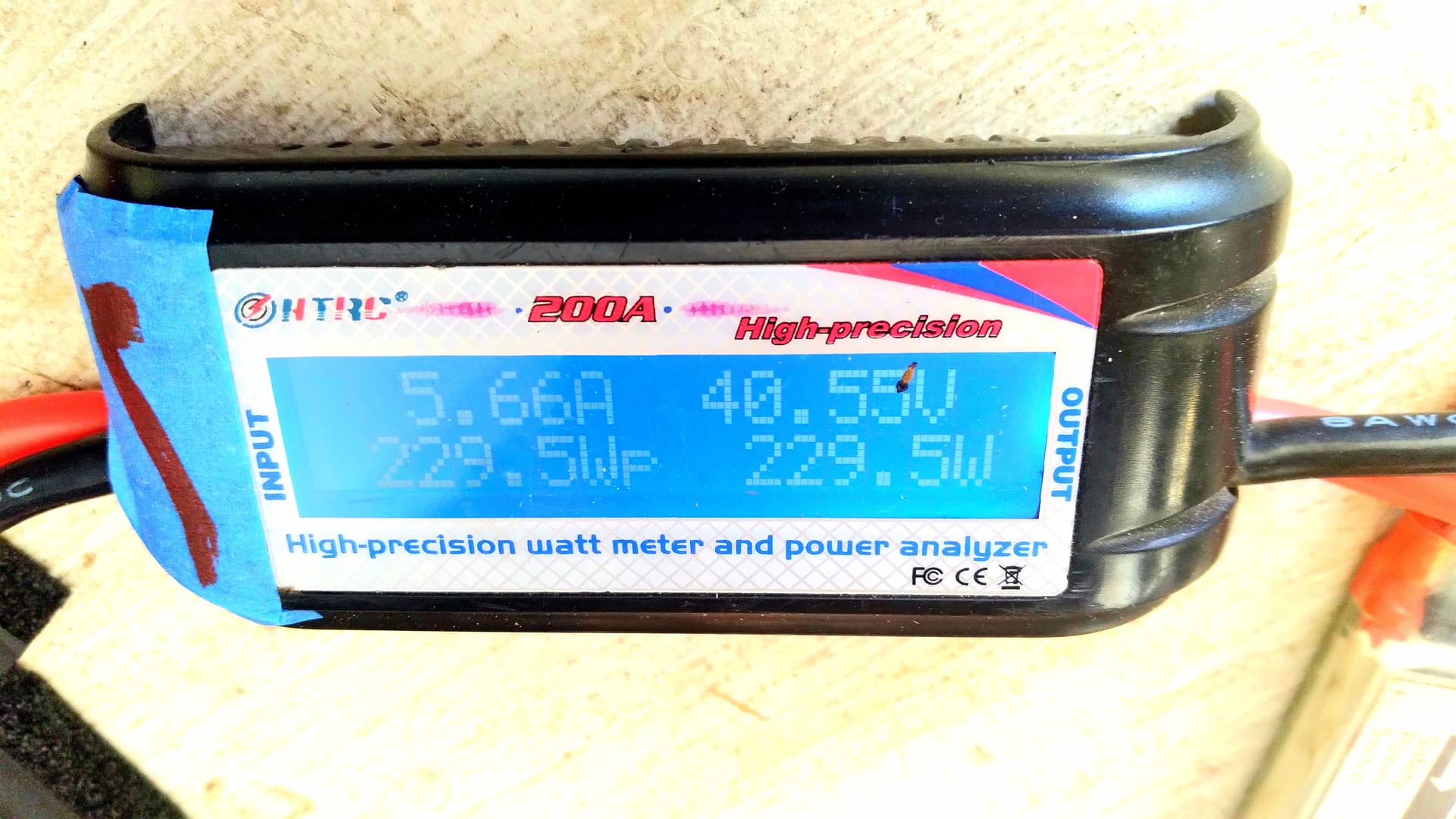

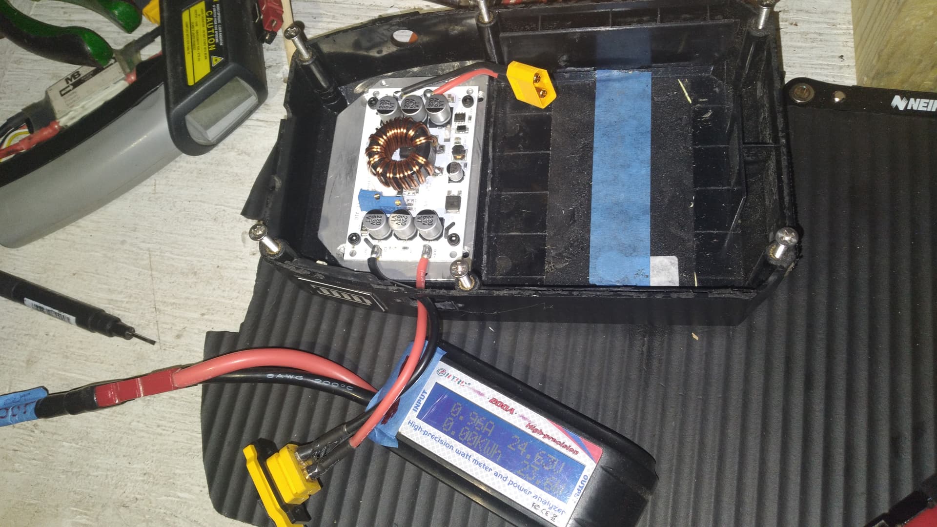

I tapped the 7S2p enclosure’s ESC heatsink for the M3 screws and the 10amp white voltage booster. I want to use the antispark switch TJ gave me rather than plug and unplug xt60’s. Kind of tight inside, so i wanted to lock down the booster and then work on the layout of the AS, and the 7s charging input
I had JB welded 6 small finned heatsinks to underside of the aluminum ESC plate in November 2023 when it was new. I decided it would be better to remove these and add a bigger deeper finned heatsink, that I have on hand.
I got a 1 inch wide sharp chisel, to pop the 6 small thin heatsinks off, and tapped once firmly with a hammer on joint to separate. No chance they are coming off. I recall going nuts on the surface prep. Cross hatching at opposing angles with razor. No fasteners, but might as well be one piece of aluminum.
I then tested booster on 24.5v 7s2p 104wh battery, boosting to 42v. Dialed it upto 165 watts output and was waiting for things to heat up, and then ran out of patience.
Pretty sure I can dial it to close to 240 watts with it without forced ventilation and not overheat, but could be wrong
My other 2 boosters get as hot as I am comfortable with, at 80 and 120 watts output, on 5s input, without forced ventilation.
This white CCCV booster is odd, as both the voltage and current pots are CCW to increase, CW to decrease, but I intend to just set it to 41.9v and output as high as 5.2amps or so, and leave it. My other boosters I change voltage and amperage frequently.
The 7s2p battery has unknown 2000mah cells. Ill assume 10 amp CDR.
Id rather cycle it, than my 5s powertool batteries. In theory I could make a 7s2p of EVE 35v for a 7 ah pack instead of 4ah. I do have another 7s bms, not sure why.

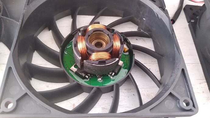

Here is half the guts of my favorite 12v 120mmx 36mm axial fan.
Delta FFB1212EHE. 4000 rpm@ 12v. It can handle 14.5v, perhaps higher, but no need.
It responds wonderfully to a 5 amp xl4005 voltage bucker as a speed controller from whisper quiet to screaming banshee Not all fans do.
I have had corrosion issues when they are sucking in fog on the regular.
This one I potted the circuit board with Karfuter k105. it self levels nicely, and cures into gummy bear like consistency.

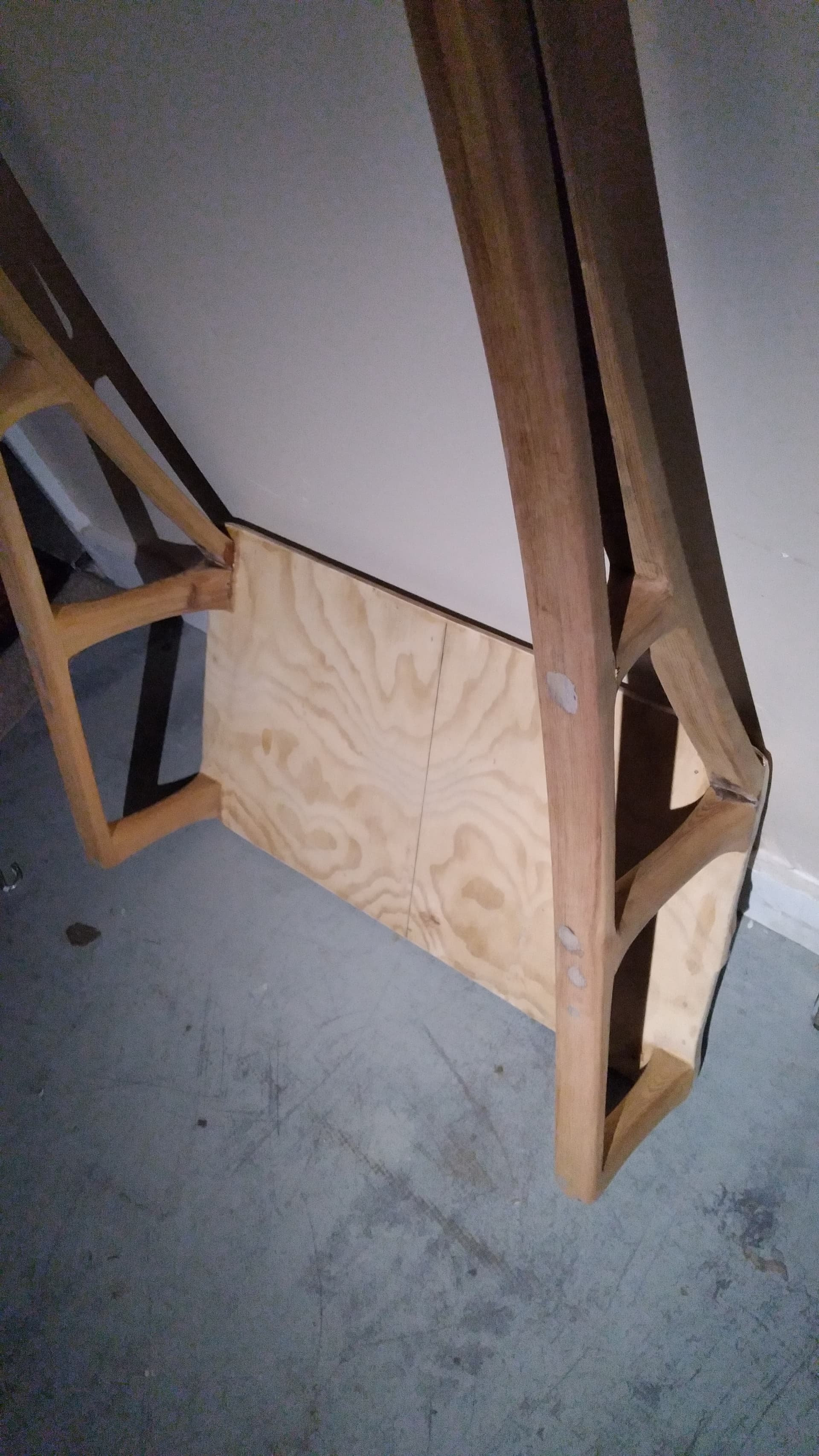

I hand sanded the chariot’s Cedar today, ‘hourglassing’ the vertical stiles, more for the visual and wind slippery factor, not the weight, as cedar is so light already.
Ways to go still.
Chariot is looking fiiiiine!!

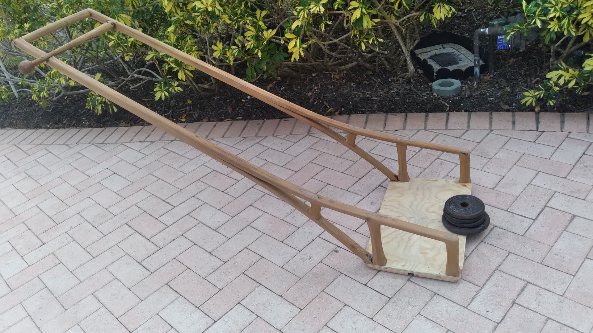

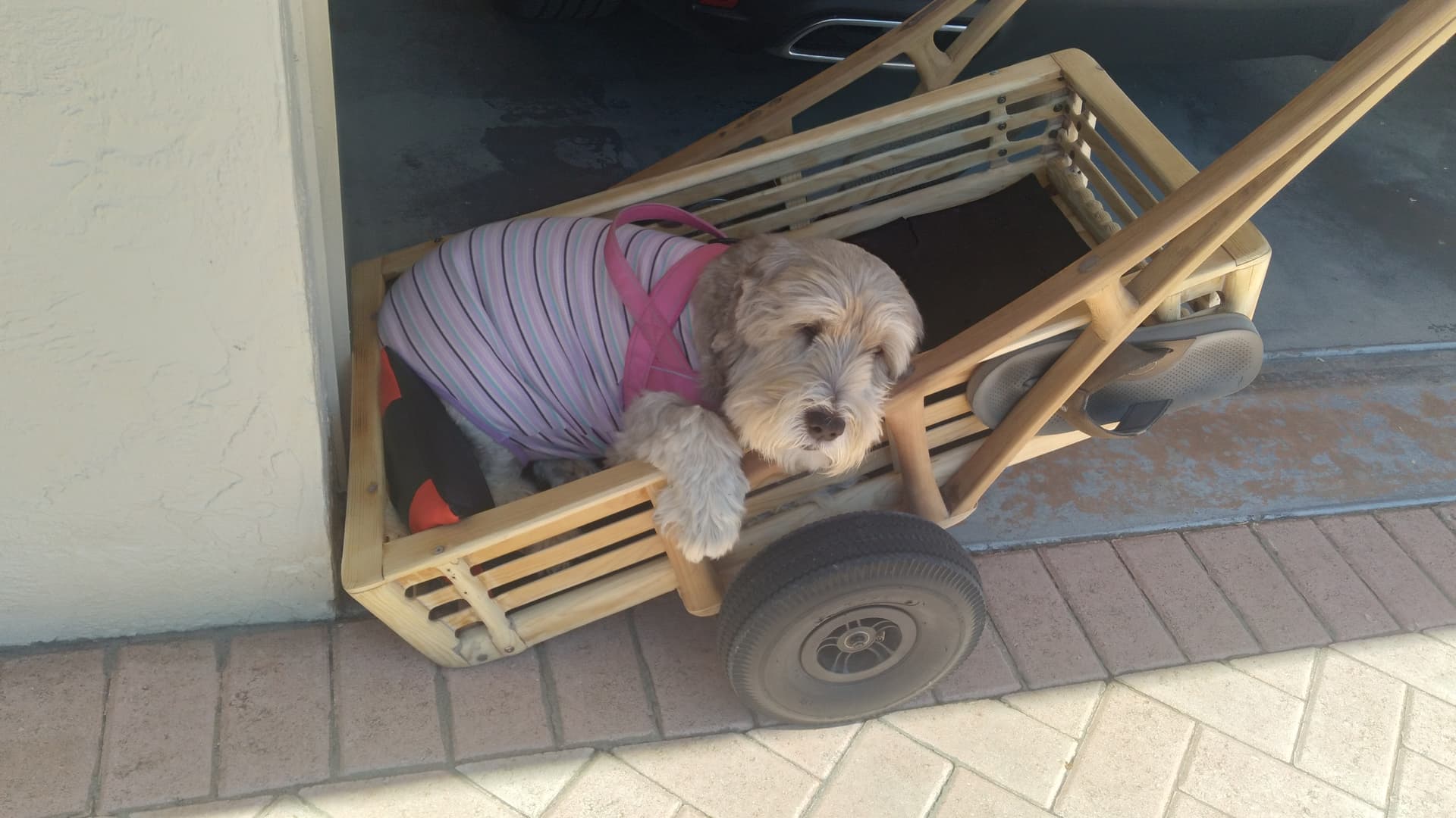

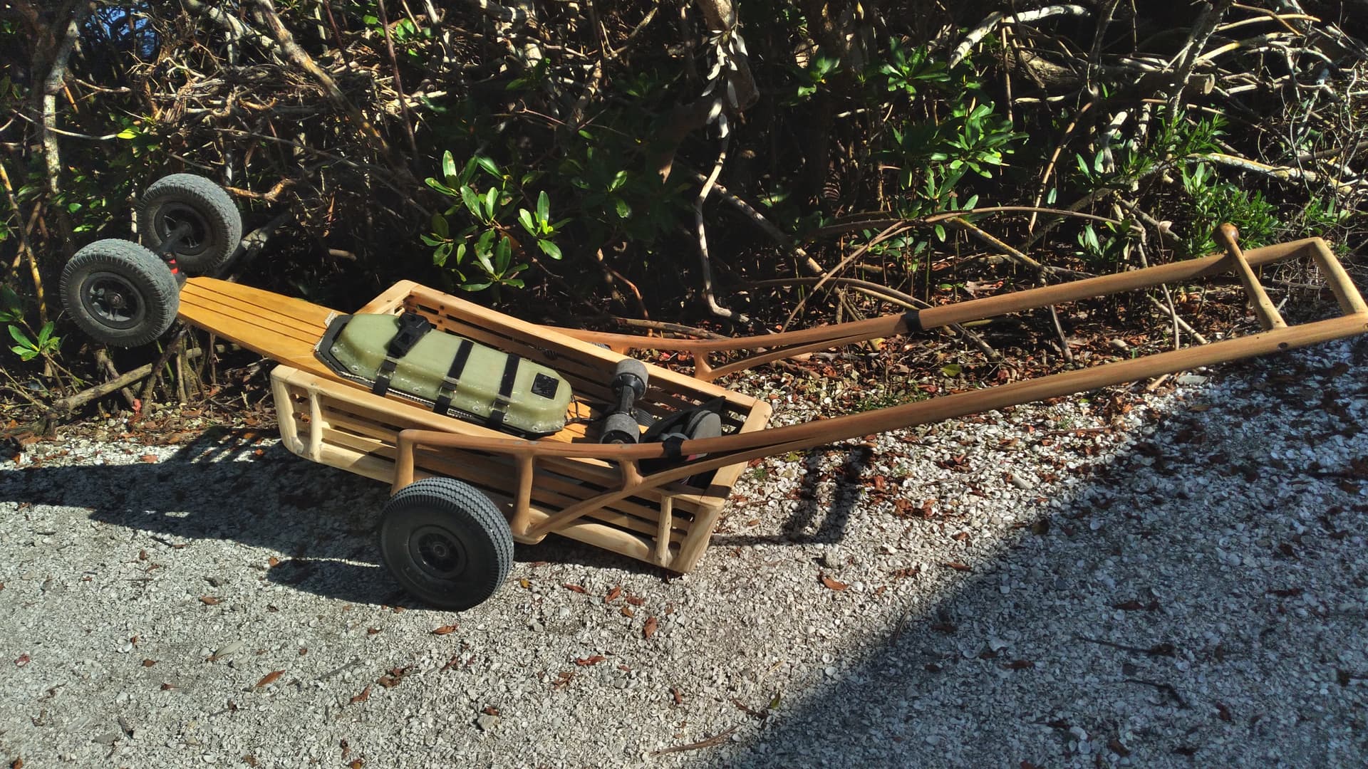

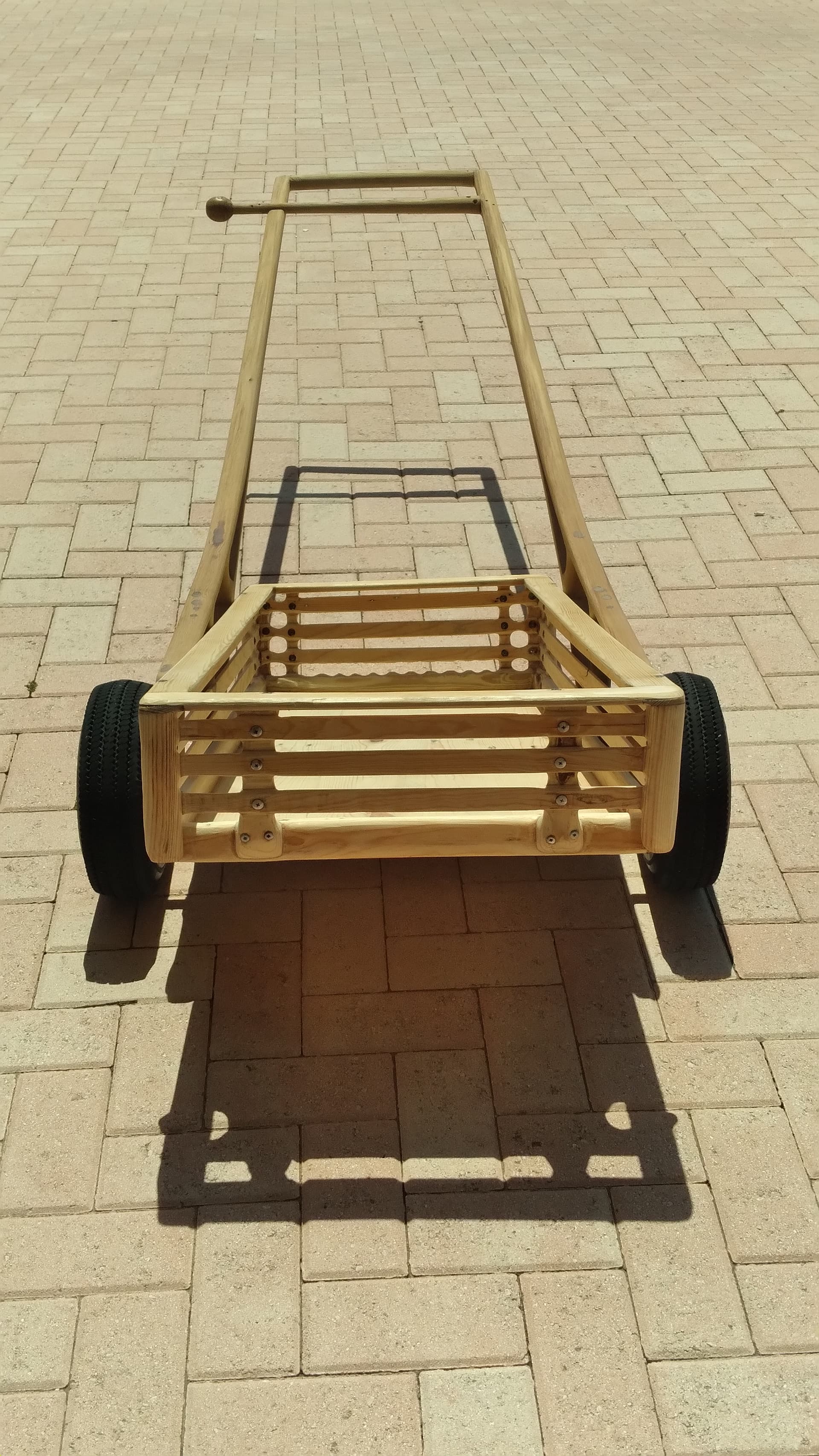

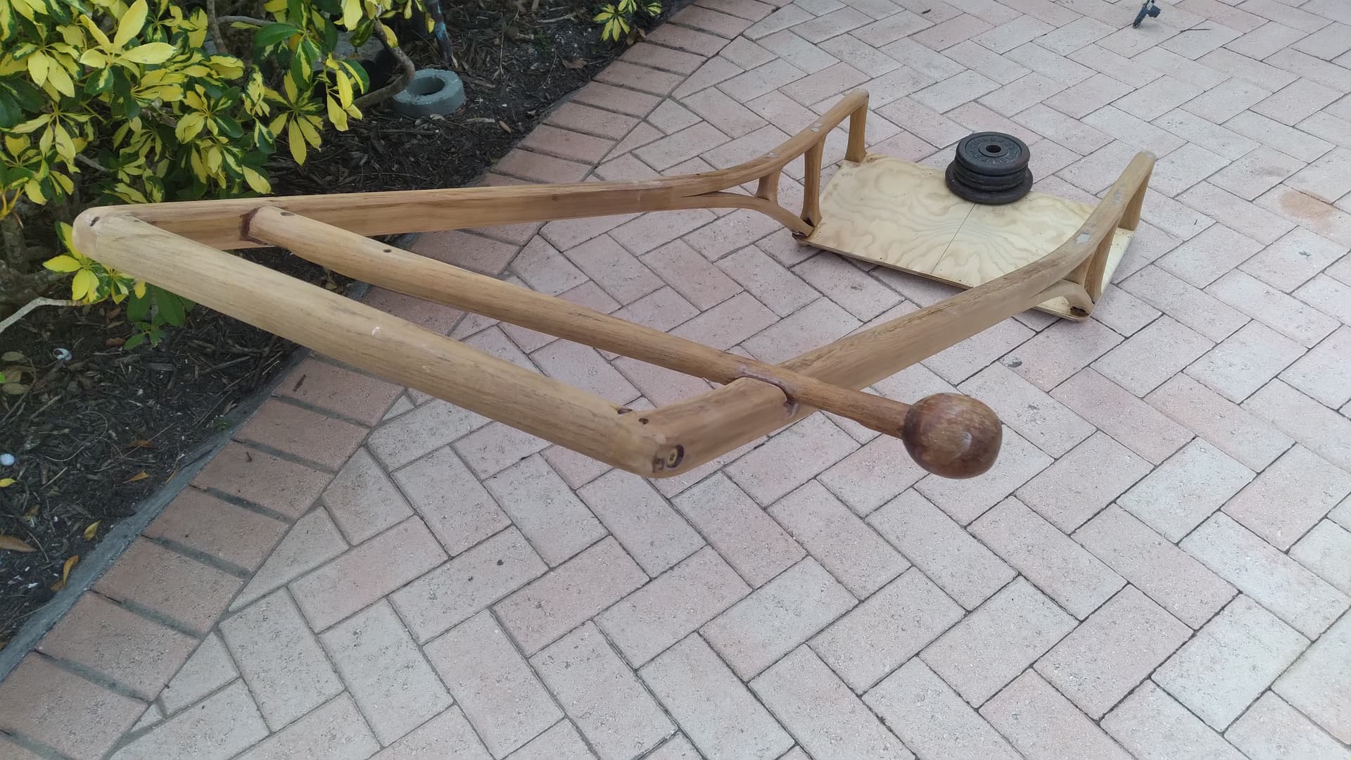

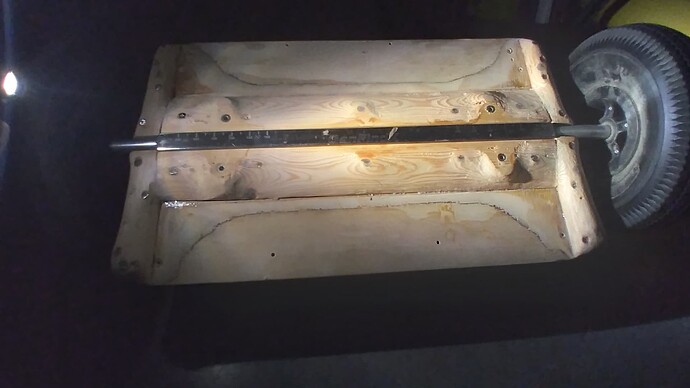

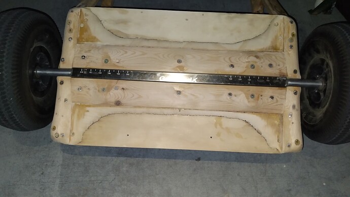

The roadside of the chariot platform lost a lot of volume today. All the screws are.either CA glued or epoxied, so am.just removing all unnecessary wood around them, imagining an air molecule contacting leading edge.
Would do it differently if starting over, but this was intended to ride immediately at every stage, and right now I could drive 8 screws and it would be fully functional, and stronger, and lighter, than on every prior run.
The rims, axle and plywood base have to have 2K miles on them.
Still on 80 grit paper stage.
I switched to dremelling basket when i ran outta time, but thats where most remaining weight loss and aero slippy gains can hope to be made.
I am gonna be wrapping/lashing all joints with fiberglass roving, and maybe some paracord.
I’ve yet to bust out the scale to quantify results, but I have been making huge amounts of wood dust and micro chips, all day every day this week, removing strength and weight from chariot base and basket, where it is overbuilt.
All hand sanding motions can basically be implemented as if one were using elastic bands, and doing rotator cuff exercises, and holding the heavy rotary sander at every precise angle imaginable, is also a workout.
I am looking forward to getting the western red cedar to drink epoxy, and highlight the incredible beauty of this wood. It has a bunch of pinks and purple hues, and every shade of brown. I love its smell and just get all zenn’d out working with it.
Still on the 220 grit stage, but most of the ‘hourglassing’ is done.
When shoulder pleads for mercy, I’ve been chewing through drum sanders on he dremel, on the chariot’s basket. A lot more air should now be able to flow through it, rather than be restricted, and choose to flow around it instead.
On more windy, days at 20 mph I was really able to feel the wind drag on the chariot handle. Hoping the slightly reduced weight and air resistance are worth all this effort.

The 7s2p battery charging 10s2p through the 10A ‘600 watt’ booster works very well. It stays cooler than expected.
The 7s’s unknownn BMS is weird, in that it will not read voltage on the charge port, and the xt60 output, which will disconnect at about 3volts per cell, always reads at least 0.2v lower, even when charging at very low rates where voltage drop should not be a huge factor.
Charge to 29.4v at charge port, 29.02 to 29.20v on XT60. I guess of the charge port reads no voltage when not connected to charge source, there has to be a voltage dropping Diode involved. I turn up the booster to 29.62 to get 29.39 on xt60. This battery came with an Acdc power brick that says 29.4v output, but is actually close to 31v unloaded. I almost always used it with a bucker set to 29.4v or less

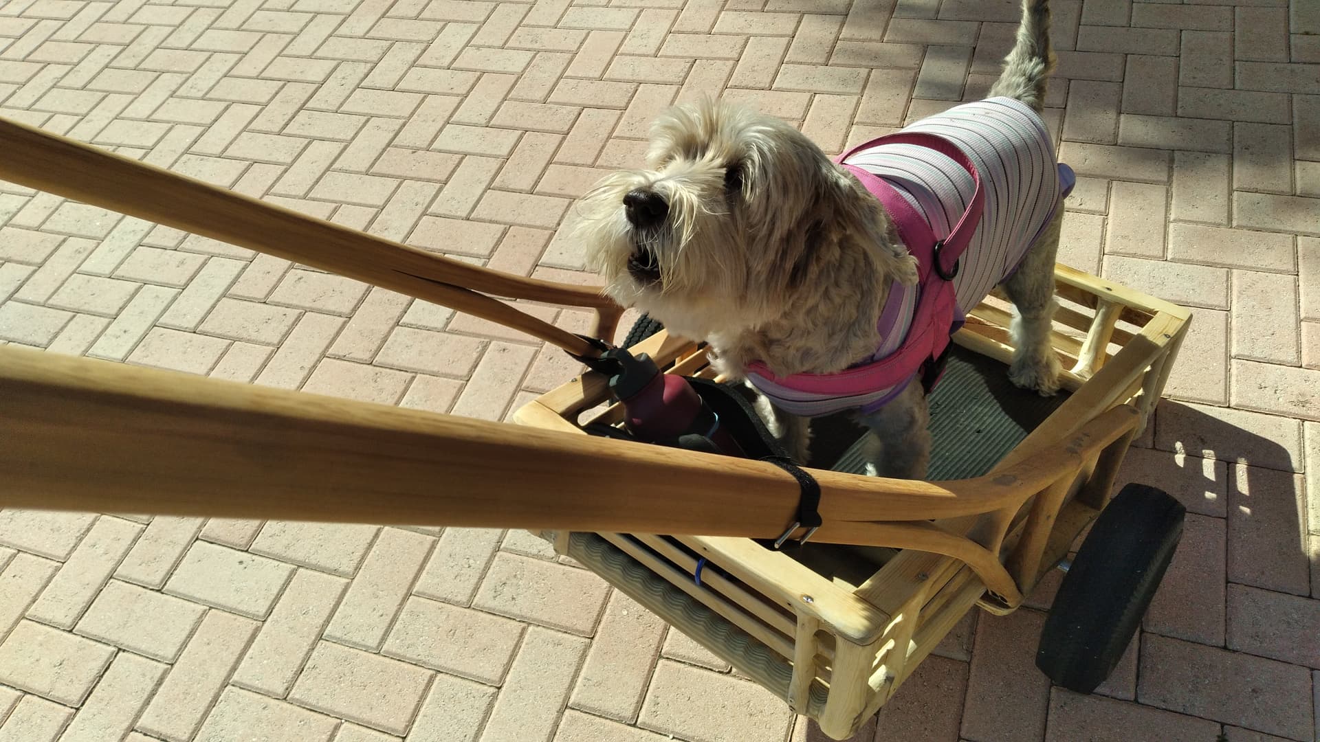

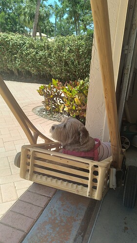

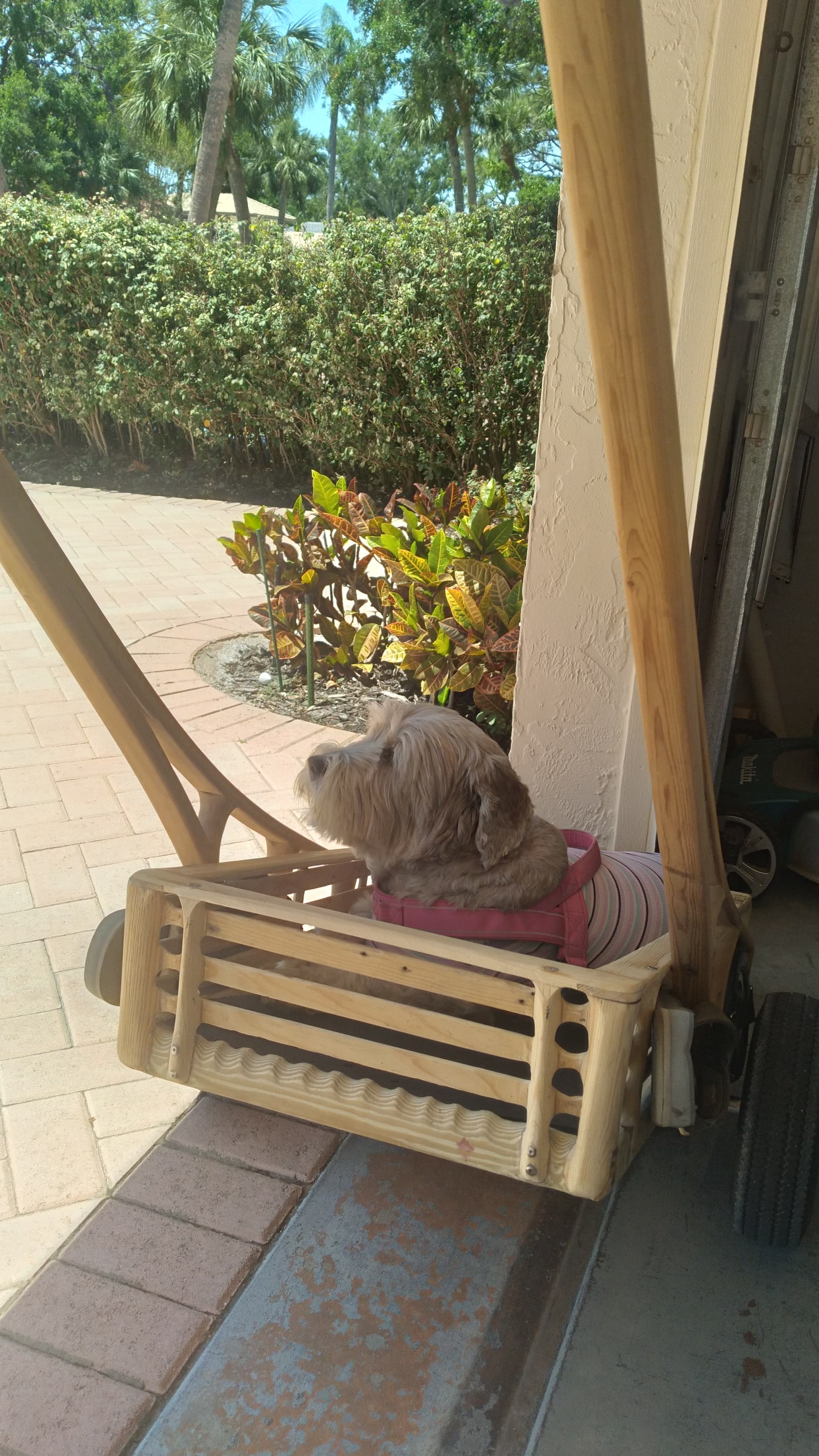

Fiona with her butt up against unpadded back wall of her chariot has the lightened teak handle push my hand up with about 5lbs of weight. It Handles funny. Can feel her bark through handle, every subtle shift of her weight.
20mph into a headwind also feels like reduced air resistance through and around, but it feels so different overall it is hard to tell for sure. There is certainly reduced frontal area, and weight.
Fiona is refusing to leave chariot when we return to garage.
Just performed experiment.
7s2p, charging 10s2p from 35.8v, through white CCCV Vbooster. 7s2p supposed to have 4 ah capacity.
Started at 5.2 amps output, lowered to 5.0 as input amperage rose towards 10a limit.
My wattmeters are imperfect, but it claims it delivered 3.945ah , 99wh and I was hovering watching when BMS cut out at 21.3v.
Got 10s2p to 39.9v and delivered 2.21AH.
Booster got as hot as 64.7C, this lowered to 56 with some light forced airflow.
The 7s2p got at hot as 42C. These are when hunting with IR gun, for hottest spots.
She is still in chariot, during this test and the time to write and post this.
I think the cells in the 103.6wh Chinese built 7s2p are more than 2000mah. They didn’t get very warm being discharged at ~4.8 amps each, and the BMS shut off at right around 3 volts per cell.
The Vbooster temp gets a bit high at 5.2 amps output. It is not attached very well to heatsink right now. no thermal grease, one stripped m3 corner screw.
All sorts of room for improvement.
Seems to be a Viable portable charger.
