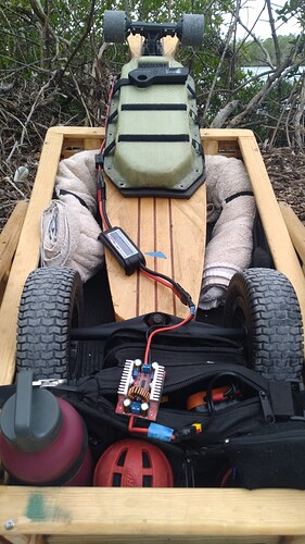

Been carrying a DC boost /step up Converter, and a 4ah 5s 72wH Ridgid drill battery and a wattmeter in Fiona’s Chariot, on the last couple rides.
Not that it is required.
The crushed shell trail can chew a lot of my limited battery capacity.
Getting to the end of CStrail at full throttle, and then charging at 120 watts/~3 amps while we bark at cormorants pelicans, ospreys, and turkey buzzards, allows us to then cruise back a lot faster, and be able to make it up the ‘hill’ at the entrance. Then have 6 more miles of range, and not have to baby the throttle.
The ‘400’ watt’ booster gets pretty dang hot at 120watts output.

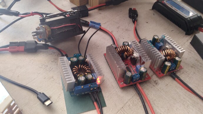

It is this one:
This booster is odd, as one turns the voltage potentiometer CCW to raise voltage, but CW to raise amperage, and it is not linear. Dialing in 42.00v unloaded, requires a very fine touch, amp dialing is linear though.
I much prefer this smaller booster.
It has a third potentiometer, that controls the amperage at which the red LED light turns green. Voltage and amperage adjustments are much nicer and intuitive, than the larger red booster, and it seems to stay cooler boosting 12v nominal to 42v, at 2 amps output, than the larger red one, which has no led at all to indicate it is powered up.
I smoked one of the red ones at about 250 watts output, boosting from a 12v battery without enough airflow.
Since my charge port can handle 5 amps, and 5.2amps is a 1C charge rate, and the BMS is good for 10amps charge, the hot booster is the limiting factor.
I have 2 charge ports, but the second one is still unwired.
I have 2 boosters.
I have two 4.0 ah Ridgid drill batteries, and 2 2.0ah.
I don’t know if it is safe to parallel these boosters.
I don’t know if I need to charge at the parks, at 6 amps, but 2 amps has proved a bit too slow.
Also this battery gets too damn warm as is.
So all of this becomes unnecessary with 10s2p of tabless cells. Far less voltage sag, far more capacity, far less heating.
But I have no funds for 20 tabless cells at the moment, or anytime soon.
I do have a third style of Voltage booster. 6amp max input. It can be easily attached to a heatsink.
I smoked one of these being an assuming idiot. Both the voltage, and the amperage potentiometers are turned CCW to increase.
https://www.amazon.com/Adjustable-Booster-Constant-Voltage-Converter/dp/B0DSZY7XJ7/ref=mp_s_a_1_6_sspa?crid=P5Y1HHOR5Y3X&dib=eyJ2IjoiMSJ9.SszIu69e26cd07eK9teO78PfwNQMUV1quvjSxXQnTRP-RRr0mOHWvRTAfQsLptFhb8czcEHlaXCVzGG4NErLMThN-YiLwk2bzAqJ1Cbx1Whlwm9CBSuxw5ZxyHClYIWUKhd50ag-CCfZIjZJ4YaXz3wfurUYL2QRV5L2YQe9qhfpJn0BAyGTnaAaZdXq9pLJykgJWdjJnhCbvLtsd0xU0Q.CTzJOEQkped3BRJ3XTVFeEn8d4TDV-GIo7SXfFhJKRE&dib_tag=se&keywords=voltage+booster&qid=1742087364&sprefix=voltage+booster%2Caps%2C137&sr=8-6-spons&sp_csd=d2lkZ2V0TmFtZT1zcF9waG9uZV9zZWFyY2hfbXRm&psc=1
The plan with this model is/was to use my 7s2p prebuilt enclosure, and attach booster to the ESC’s ventilated heatsink, and make an enclosure lid, and use the Antispark switch that TranceJunkie sent in the esk8 goodie box and have a 104 wh portable charger. Perhaps even charge while riding.
I was working on this before shoulder separation, but not since.
I have second style of this white booster rated at 10 amps input, that I have tested boosting 7s to 10s, but not at 10 amps input.
Again, both potentiometers are CCW to increase volts or amps.
https://www.amazon.com/Aobao-Constant-Current-Converter-Adjustable/dp/B09KRTZLB8/ref=sxin_31_pa_sp_phone_search_thematic_sspa?content-id=amzn1.sym.2c40dce0-8be6-4097-8d91-573606278bf4%3Aamzn1.sym.2c40dce0-8be6-4097-8d91-573606278bf4&crid=P5Y1HHOR5Y3X&cv_ct_cx=voltage+booster&keywords=voltage+booster&pd_rd_i=B09KRTZLB8&pd_rd_r=d89e0ddb-89e6-4bcd-8599-f8e8e5226264&pd_rd_w=FBtwH&pd_rd_wg=IZcjG&pf_rd_p=2c40dce0-8be6-4097-8d91-573606278bf4&pf_rd_r=4J61NPRTPAKKFX7WWQSK&qid=1742088514&sprefix=voltage+booster%2Caps%2C137&sr=1-1-6024b2a3-78e4-4fed-8fed-e1613be3bcce-spons&sp_csd=d2lkZ2V0TmFtZT1zcF9waG9uZV9zZWFyY2hfdGhlbWF0aWM&psc=1

Ridgid drill battery charging esk8 at 120 watts.
Earlier today, when I said time to go…
Bringing the portable charging set up, and departing our various destinations at full charge, is a bit regrettable, when I decide to not bring it.
Having the full torque available when leaving those destinations is very noticeable, even though I am trying to stay outta the throttle, and ride safer and stress my towing shoulder less.
Been storing Ridgid drill battery, booster, wattmeter and wiring in a fanny pack which is attached to the front of chariot basket.
So when we stop, I rest chariot level on the back.of the esk8, and connect Fiona’s leash, then command her to jump out.
I pick up esk8, put it in chariot and turn off remote, and attach it to velcro cinch strap.
Unzip fanny pack, extract booster and wattmeter. Attach barrel plug to charge port, and see battery voltage. Attach booster input to drill battery output, which stays in fanny pack, then connect booster(set to 42.0v, and ~3.1 amps max), to wattmeter, and watch 0.00 amps shoot to 3, and watts go from 0 to 120-128.
I use Anderson powerpoles connectors which seat and unseat much easier than XT90 or 60, but are sexless, and allow a self defeating idiot to connect booster backwards, which can fry it or pop the charge port fuse.
Fiona is usually at end of retractable leash and waiting, and then helps me pull the chariot.
The process must be reversed when leaving the park, and takes about the same amount of time, about 30 to 40 seconds, I estimate.

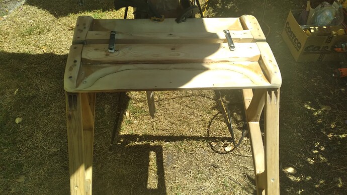

Yesterday, I loaded my 2 tall saw horse tables, and all powered and hand sanding tools into Fiona’s chariot, rolled them to the backyard, unloaded chariot, disassembled chariot, set up some shade and made ungodly amounts of dust, sanding the overbuilt chariot lighter, and more wind slippery, and perhaps more visually appealing.
Today, I did the same, but working more on Oversized teak handles, and Doug fir basket.
I meant to weigh it afterwards, and take photos, but there is still a bunch of dust to still make, and I need more sandpaper, and to look at it with fresh eyes.
It feels lighter, even though everything else felt twice as heavy, when I was wrapping things up for the day.
The surfboard sander requires a lot of strength and precision, and my shoulder is running out of steam far faster than it would have, pre dislocation, but the fact that I can even use it at all, has my spirits up.
I used to be able to use it one handed 20 years ago and sand multiple boards back to back all day.
No chance of that anymore.
The Milwaukee 5540 polisher/sander with the 8 inch or 5 inch sanding pad, is a heavy, torquey SOB. Mine is an older, Made in the USA version, and its only issue ever was fiberglass dust impacting the variable speed trigger, which was not difficult to ooen, cleanniut and return to service.
It is still on the original brushes, somehow.
80 grit sandpaper spinning at upto 2900 rpm on an 8" powerpad, removes material quickly.
There were times I was making so much dust, I couldnt see the workpiece, through the cloud of dust I was standing in, and a dust mask on top of a beard is not so effective, but better than no dust mask.

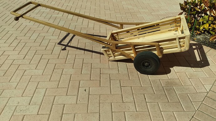

The chariot floor needs better padding, and furry footie traction, to increSe Fionas
comfort. I need to find a better method, so She if comfortable.with her butt centered uo against back wall of basket, and front paws splayed and planted.
Down to 27 lbs even.
Was really hoping to shed more chariot weight, before adding some more with epoxy and fiberglass. The power and hand sanding tools all have new paper, ready for Monday.
I glued a bunch of the chariot’s screwed joints together a while back, and can still extract the screws. I want to fill the recesses with epoxy and then return the 3.5" deck screws. The western red cedar is pretty soft, and the screws go into endgrain, so their hold is not profound.
Hydraulically forcing the epoxy inside should greatly increase their hold, and prevent long grain splitting, and seal them.
I did this with some other shorter thinner screws into the doug fir and plywood, but used CA glue.
As I needed to use the chariot, while designing and building it, a lot of the fasteners will not be hidden, and the woodworker in me is not enthused, but everythjng is a compromise.

Bunch of new unbroken, uncompacted shells on sections of the trail. The 83mm hub motors were not happy, or capable.
Have you considered a kydex floor for it?
Not familiar with texture of kydex.
am thinking a thin Volvo rubber floor mat over some Yoga matt padding, and making it so that neither can move on the floor or in relation to each other, maybee some butt bolstering .
Somethjng she can splay her front footies and have total traction, but not be harsh on her belly, for when she wants to lay down.
A lot of broken shells and twigs have been getting under the yoga matt.

I took 150 and 400 watt boosters out of the new unused parts bin, wired them up and functioning. The 150 watter has two empty solder pads, for a fan. I am not sure this works, and if so if it is for a 12v fan.
I should know the next time I can get it hot. A 50mm fan would bridge the heatsinks perfectly and it then could handle 150 watts output . 84 watts output with no forced ventilation has it basically as hot as I want it to get.
The 400 can handle ~120 watts 10s output with 5s input in free air, but has no switched fan provision.

I flipped the chariot base over, removed the long screws, and got the receptacles to drink thin warm laminating epoxy, and returned the screws.
4 of the rearmost screws seemed to have stripped their receptacles on their final drive. These 4 would have the most stress on them with Fiona in the back and me pushing the handle down, pre wood glue.
The joints have all been wood glued for 6+ weeks and that glue joint has not failed. These 4 screws were long coarse thread Pocket screws, with their flat underside. I used these so the cedar would not split from the V shaped head of the fatter longer deck screws that I used on every other joint and which did split the wood slightly on some. None of those deck screws stripped their receptacles.
I counter sunk them a bit more, hand tightened the final turns, and covered them with wood flour thickened/colored epoxy, so perhaps they will be less obvious, and their appearance bother me less.
I have been trying to remove more chariot weight by ‘hourglassing’ the upright basket supports. The sander was taking too long and access is limited. I started using rotary wood rasps on the dremel. I’d love to get it to 26lbs or less, but not sure that is possible without compromising its strength, and whether it weighs 77 or 78lbs with Fiona inside is picking fly shit from the pepper.
Decided to test my newly wired 150 watt Voltage booster, which has two pads on PCB marked fan, and to which I soldered two leads
I was unable to spot anything which looked like a thermistor/thermocouple, but what do I know. I got it to 58C, at 140 watts output, and never measured any voltage on the ‘fan’ wires.
So that answers that, to my satisfaction.
Here is the 400 vs the 150 Vbooster, and a powerful 60mm x 27mm Delta 12v fan.
There is an xl4005 V bucker on the Delta fan. I removed the 10k ohm trim pot and replaced it with wires leading to a 2k ohm fingertwist pot and wired the 10kohm trimpot in series.
The trimpot is dialed low, to set the fan’s near minimum start up voltage. With 2k ohm pot then dialed to the max, max output voltage from a 18v nominal drill battery input is about 14v, which the 12v fan can handle no issue. Danger zone is ~15v+ on many 12v fans.
I might mount up a 50mm fan to the booster’s heatsink’s with a similar bucker so I can use any 7s, or 5s powertool battery to power the booster and portable charger my 10s junk.
I did order some inexpensive 24 v 50mm fans, and presume they can handle 29.4v, but will they spin with only 12vdc input?
I basically don’t own an AC/DC 10s charger. I just use these boosters from my 12vdc Lead a id Agm batteries, and have adjustable voltage power supplies to keep those topped up and happy.
On the workbench, I aim larger 12v fans to blow over and around the boosters, but exceeding 80watts output, or 120 on the 400, without forced ventilation, has them get uncomfortably hot.
These boosters work well as ‘car chargers’. With a good fan mounted to the heatsink they should be able.to maintain a respectable charge rate without overheating. Both say 60v max output, though I have never dialed either past 42.5v. My inline wattmeters say 60vdc max, and I dont wanna risk them but will check with a DMM, if requested, to ascertain their max output voltage, under no load.
