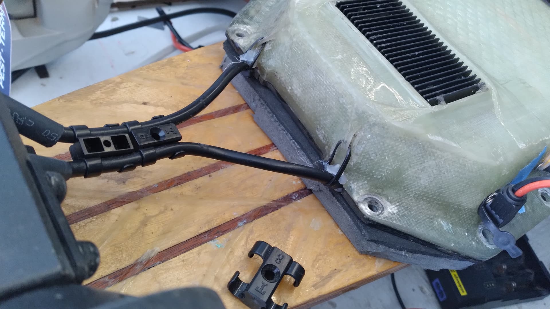

8 months ago, Florida summer, when I took this ESC out of service, because of those disconnections, I had recently exposed the copper heatsink to exterior airflow, but had not yet JBwelded and screwed the deep finned aluminum heatsink to the copper.
I installed a different power switch, but the disconnects continued, and I figured i cooked the ESC.
So I took it out, then tried and failed with the Flipsky 6.6mini, then installed the ebay lingyi cockroach, and later on added the finned heatsink, which is now painted flat black.
Since this ESC does not require a power button, has roll to start, Auto OFF, and a Loopkey, I see no point in even having the switch installed, which might be the cause, or a contributing cause to the disconnects.
So I put another 5.5 x 2.5 charge port receptacle into the power switch hole, unwired, next to the one which is.
I like these 90 degree DIY charge port plugs. 16 AWG is a tight fit.
The phase wire holders are convenient too. Meant to be screwed down, but they stay put as is.
Previously, I had XT-90 panel mounted with Flange on exterior. I didn’t like how far out loopkey stuck, so this time I put it on inside.
The 4mm flange head screws have rubber washers,and cut their own threads in the panel mount.
I used the rubber gasket and flip cover inside, though the cover has no function.
These 5.5x2.5 charge port covers fit really tightly, but the hinge side still needs to face forwards.

The esk8 itself is running well.
No remote disconnects, I wonder if that issue is gone for good, and if so, why?
Better than expected range, and acceleration. We can roll the crushed shell trail faster than ever before, but do not, usually.
The bearings in hub motors when cold, are kind of noisy, I can feel the vibrations from them in my feet, but once warmed up, it is much better.
I could try and get the 80 mm M1 inboard hub motors going. Their softer sleeves should be more comfortable, and I have a back up pair of sleeves as well.
I could wire up my second 5.5x2.5 charge port, hook it to my battery’s Anderson powerpole, with a soldered LP mini fuse inline. But i don’t really need a second charge port. I rarely have ever charged at 1C, 5.2 amps or higher.
Rarely dial CCCV V booster up past 4.5 amps, and the single 5.5x2.5 port , and plug, felt cool to the touch at that rate.
I would have to parallel ‘chargers’ to do so, and am not sure they would be happy in parallel, and the dumb daly BMS is only rated at 10 amps charge anyway.
My junking 7s2p enclosure and battery have a voltage booster resting on the ESC’s heatsink. It could become a charge and ride, strapped to deck between feet, or just a portable charger with ~ 104 watt hours kept in Chariot. My dmegc 10s2p is only 187wh, so it is a fair amount of extra, even though I don’t really need it at this point.
I would feel happy paralleling two basic, small chargers, 2A for example, together if it saved me money and made my life better. I would use a couple resistors though and take the output from the centre-tap. I was once going to do this with old evolve chargers, but as I’ve started accumulating 4A chargers I’ve also stopped using 10s boards.
I put ‘chargers’ in quotes, as I exclusively use 150 watt voltage boosters off my 12v lead acid battery systems, off my van, or garage floor.
The AGM lead acid batteries in garage are kept charged by an adjustable voltage power supply, usually dialed to 13.6v.
I always use an inline wattmeter on the output, and sometimes input too, and a fan blows over the unit.
I am often changing the target voltage, and the max amperage to get there. Like dial it to 41v after dinner, unloaded, plug in, dial in about 1 amp, then before bed disconnect it, dial in 42v unloaded, then disconnect everything. After pouring coffee, I plug everything back in and get up near 42v before our first roll of the day.
I do have 3 ac/dc 60 watt power bricks for 7s, which should be 29.4v max, but all 3 will go over 30v, closer to 31, so I was using a voltage bucker to tame them to 29.4v.
I did buy a 10s Ac/dc charger that advertised 2 amps/84 watts. It maxed out at 34 watts.
It measured 42.06vOC before using, and the one time i used it, I found my wattmeter reading 42.46v and 0.0amps.
The battery was 41.26v, so the bms did its thing when one p group got above 4.25v.
I gave the ebay seller a ton of shit, and a bad review. They offered a full refund if i would retract my review.
I declined.
Not long ago I got an email from ebay warning me about using that specific product.
I do have ‘400’ watt voltage boosters, but the ‘150’ seems to stay cooler, and have more precise voltage control.
I burnt out one 400 watter. The enamel on the wire wound toriod turned purple.
Parallelling these voltage boosters is not something i have tried. Perhaps when i make a 10s2p of tabless cells i will explore that, but that can be pretty far off.
I dont see me personally requiring higher than 10s voltages, anytime soon, if ever.
Thought I had new 5pin JST-ph pigtails.
I was wrong. They were all 6’s. I have 5’s, in 2.54mm spacing, and these do not have the plastic locking tabs one can lift for easy removal.
Pulled the wires from the salt water dunked Puaida motor’s JST-ph 5 contact housings.
The housing interiors were caked with green corrosion too.
I used Dentek mini bottle brushes and hot water to scrub them clean inside and out. The precrimped wires from the 6pin jst ph clicked and locked nicely into place.
I decided to undo the 3 screws holding the cap and urethane sleeve to one M1 hub motor. The used sleeve slid off the motor with surprisingly little effort. I busted out the new sleeves i have, and they were not going to slide over the motors knurling easily, so I didn’t bother, and returned the used ones, for now.
I wonder if these used sleeves basically spin on the motor’s knurling, which felt kind of slippery.
I have some Julet 9 pin extension cable pigtails to mate to these 80mm inboard hub motors. I decided to use check the wire colors matched this diagram:
The first one i checked was ok, but the arrow for aligning male and female was 180 degrees off. No big deal.
The colors were in order order.
The second one has a green sensor wire as 5v positive, so, I decided to roll to the 2 parks with Fiona instead.
The first attempt using one completed Julet extension cable to MR60 and 5 pin JST to power an Inboard hub motor, was not a success.
I used a known OK single drive 7s esc and battery to test each inboard hub motor individually, rather than risk my sanity saving 10s ESC.
Had to swap blue and green sensor wires to get them to spin at all, but random brief cogging was commonplace, which would loosen up the axle nut, which was torqued about half as much as I would have torqued it to ride.
Arza did provide a long Wera allen key to torque them proper, but i didn’t use it for the bench testing. The C shaped cup on motor, does not mate tightly to the caliber truck, probably 15degrees of rotation before it locks.
I am not all that confident in the design.
Seems the axle nut itself has to lock the stator to truck and the C cup is just secondary rotation prevention, should the axle nut loosen.
As hot as the hangers get with my other hub motors, I am not seeing much mating surface area for thermal transfer from the inboard hub motors to hanger.
When the motor cogs, it sounds like a loose magnet hitting the stator, or some other physical obstruction inside.the motor.
When it does not cog, they are the smoothest quietest best balanced hub motor I have yet used, but then Clunk!, and the tiny single drive 7s esc starts beeping in protest and shuts down.
