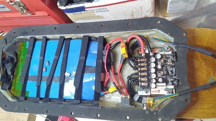

I’ve made a new loopkey Harness, with 10 awg. Gonna mount the panel mount xt90 on inside of enclosure this time, to recess the loopkey itself more, and be able to completely remove it from enclosure, without desoldering, or cutting it.
I intend to use the ‘350’ watt 83mm hub motors at first, as we need to roll again, soon.
I feel I have been breaking my promise to Fiona,. She’s got lumps and bumps everywhere, and ould be riddled with Cancer, …who knows how long she’s got. The cyst on her mammary is growing again, but thankfully does not seem to bother her.
The sleeves on these hub motors are down to 81.5mm and not too chunked, yet. Gotta mr60 them and swap to 6 pin JST housings.
I have the ‘375’ watt 80mm M1 inboard hub motors, and replacement sleeves, and mating 9pin connector pigtails which need MR60’s and 6pin JSTs added. But am unsure how long I want them to be, yet, and the othdr hubs will get us rolling with less effort.
Have two other holes in enclosure, one for 5.5x2.5 charge port, one for power switch, So 2 5.5x2.5’s going in, although one might just be a dummy, though it could be in parallel My 10s2p baTtery has xt90, Anderson Powerpole, and xt 30.
Last June when I tried to get the FS6.6mini going and failed, I had soldered the VX-1 receiver to the ESC. I now intend to remote mount the receiver well away from ESC, and use only PPM wires, and no MT60 to mr30 adapters this time.
Some Vesc anxiety kicking back in. I hope can make the FSESC6.6 work this time.

Ran 10awg at 90 degrees from loopkey to run along bottom of enclosure.
Junky 83mm hub motor’s combo phase and sensor wire got heatshrunk to extend insulation, and mr60’d. One of the JST sensor wire crimps, lost its locking tab.
Made a 90 degree 5.5 x 2.5 charge port with 16 awg. Could add a second port to enclosure, where power switch used to live, but my charger maxes out at about 6 anyway, so just need to seal that hole with something, for now.
2C charge rate would be 10.4 amps on 10s2p Dmegc battery, dumb Daly BMS good for 10.

If fsesc6.6 mini refuses to cooperate, i have OG focboxes, but securing them to my heatsink could be a major curse fest.
Need to sort vx1 receiver wiring, and then should be able to run detection.
Hopefully this time, it reads resistance and inductance consistently and the motors don’t sound like they are filled with rocks above half throttle.
TS 101 smart soldering iron impressed me today, with a fully charged drill battery.
Back to dreaming of smashing the FSesc6.6 mini with a sledgehammer, but it would likely hurt my shoulder to do so, so I am dreaming of other ways to make it so I never try it again.
Largely the same results as before, except this time there is no contact between the sides of the vesc via canbus. This one has a CAN key on off slider switch, which does nothing.
Tried many manual detections with wildly different L and R back to back. Played with different values, same behavior
Motor sounds amazingly horrible when it does spin up.
In the remote wizard the vx1 signal seems to bounce 0.3 + and - with no input, and any pressure on the remotely located receiver circuit board has this jump to 1.5 +/-.
Fark, I just wanna roll, am sick of wasting time and effort and sanity.
Fitting the OG focboxes in this enclosure would be hours of labor, and the damn vx1 receiver could be faulty anyway.
Kind of ready to just get another Lingyi and Eff this Vesc thing.

Tried a new short USB micro data cable.
Still wont recognize other side of vesc via canbus
Same issues detecting…
Duty cycle jumps around wildly.
Current jumps from positive to negative at stready throttle
Gonna mr60 the Puaida ESC, and go back to 5 plug jsts.
Maybe not. That damn thing once lost connection at full throttle.

This enclosure’s heatsink is just not gonna accept two OG focboxes without a lot of labor, and serious compromise.
wasted too much time already, on a maybe.
Now it looks like the VX-1 receiver is fucked too.

Bench test wise, split PPM the receiver, add 14 awg and mr60’s to FB’s, attach to desktop and vesc tool. What do I do regarding vesc4 vs vesc 6?
Seems like I could find myself right back in frustrated sledgehammer mode, and wishing I had just bought another damn Lingyi.
And say I bench test the focboxes, and all goes well.
In order to mount these onto older enclosure’s heatsink, I have to cut up and drill some aluminum flat plate, drill and tap it, to secure focboxes to it, then attach this plate to existing heatsinks studs, and then maybe have to relocate loopkey harness, and add another gasket for clearance, height wise, most likely.
A 100$ lingyi/puaida esc woukd need to be xt90’d, MR60’d, then easily slide.over heatsink studs, plug and play and have telemetry on remote.
My older lingyi puaida esc, which suffered disconnects, just needs MR60s and swap back 5 pin JSTs for plug and play rolling.
The ebay lingi cockroach esc suffered disconnects too, but only after a big bump had one motor shut down. If i kept going on one motor it would disconnect. If I braked to a stop, then both motors would fire back up, and it never would disconnect.
Perhaps the Puaida esc disconnects are related somehow. Iffy sensor connector?

I MR60’d the very short phase wires on Puaida /Lingyi ESC, and returned it to heatsink. Changed JST -ph housings back to 5 from 6.
Tested it, the motors fired up nice and quiet.
Ziptied all the wires to the mini roving bridges, so nothing can chafe or rattle.
The power switch I have for this ESC, which came with it, had its 4 frayed, broken stranding leads removed, shortened and resoldered, and then individually heatshrunk, then Gorilla clear grip’d as additional strain relief.
With Push to start, and Auto off, and the Loopkey, I found I dont even need the power switch, and covered the hole with blue masking tape while the GG cures.
Charged to 41v.
Once buttoned up,
it started raining.
I got a short very timid roll in just before dark on damp roads
Freeroll is not nearly as good as the larger Puaida Hub motors, and there is some bearing noise. I replaced one outer bearing last year, but should do the other 3.
Anyway
, Tomorrow we roll!
