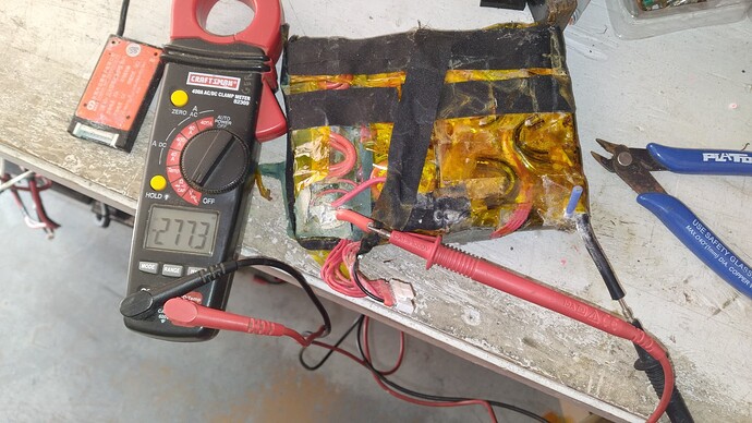

The retrieved 10S submerged battery pack was down at 6.37v, 10 days ago when I put it on bricks, in back yard, under a metal bucket, and walked away.

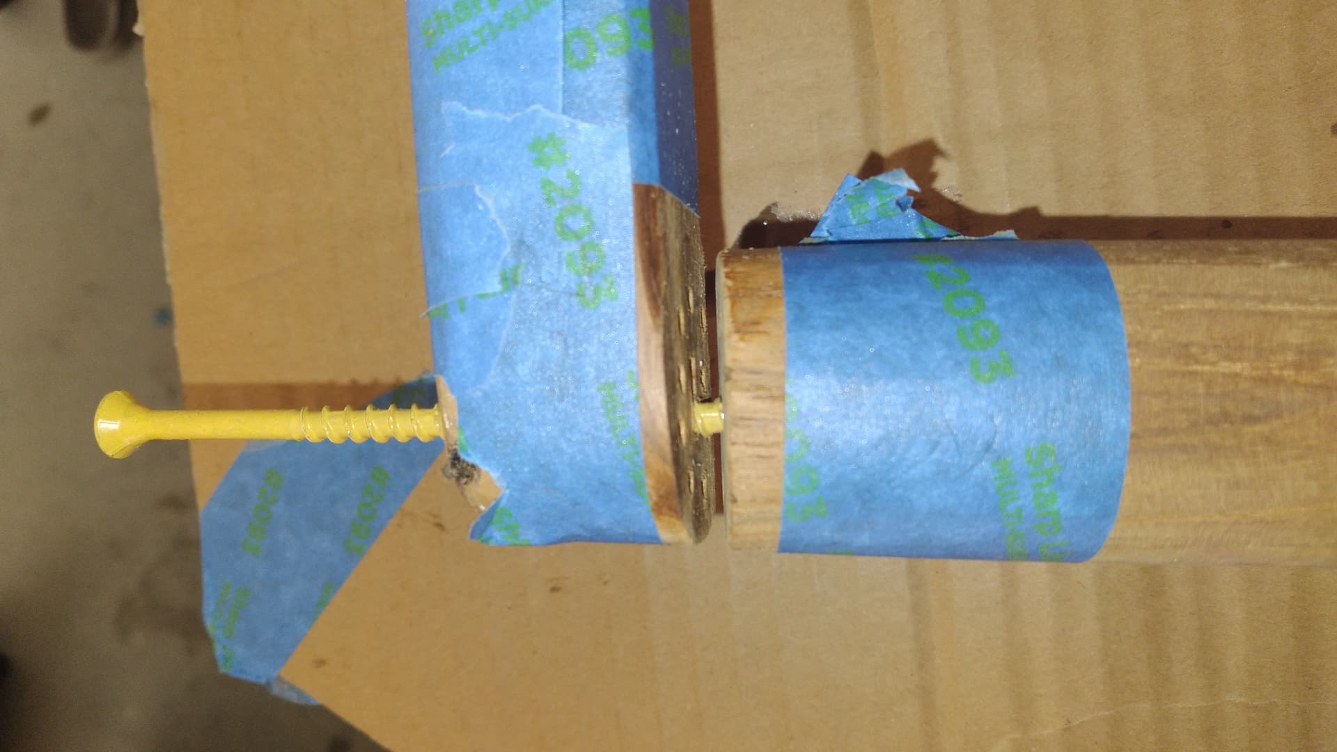

Before ruining my shoulder, I had sanded the chariot’s basket and epoxied and screwed it back together. The basket platform and fork and handle were refined, but not yet epoxied together. So I need to finish that, then paint everything with epoxy to make it purdy strong and weatherproof.

I have glued Fiona’s Chariot base together in several stages. Previously, it was just screwed together with 3.5" deck screws. Quite sturdy but they neexed a retorquing every few dozen miles.
I had planned on using laminating and thickened epoxy for this stage, but the lower portion, I got.lazy, and just used Titebond 2 wood glue, letting the cedar and plywood drink all it could before driving the screws. I tried to not let the glue inside predrilled and prethreaded recesses, as I want to back out these screws, then inject epoxy, then return screws, hydraulically forcing it into the cedar, for the overkill factor.
The Teak handle was adhered today, using epoxy. Since it will be subject to rotational forces, and I only used one screw, I added lots of mechanical tooth, to allow deeper penetration of epoxy into wood grain. Epoxy was applied and allowed to soak deep into screw holes teak endgrain and cedar, several times, then thickened with milled fiberglass powder, and time, then applied to mating surfaces, and screw threads, then screws driven home. The drilled holes should act as locking fingers to prevent rotation.
After this cures, I will further sand and shape and deweight the chariot some more.
I intend to add epoxy saturated unidirctional fiberglass tow/roving, as lashing, to further strengthen the joints.

I partially disassembled my salt water submerged 10s1p P42a today.
I mostly wanted to see how the copper nickel sandwich welds held up, and remove and later reuse the plastic Anderson powerpole housing.
I’d left it outside on bricks, under a metal bucket, bms still connected.
It read -277.3 mV.
Lots of white powder near all solder joints.
The fishpaper is still damp.
The Tesa tape looked perfect.
The copper & nickel strips looked corrosion free, to my surprise but i didnt tear everything apart. expected to see brocolli growing
