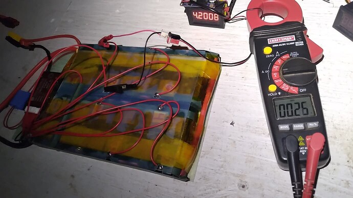

I am not sure if my BMS is actually capable.of balancing. I can’t measure currents as low as 30mA with my clampmeter and A DMM inline would likely induce as much resistance as the BMS is supposed to use to bleed off the higher cells, and confuse me even more.
This AM my 10 P groups were reading 4.19v, with 2 groups toggling to 4.18v briefly, then back to 4.19. My DMM only reads two deckmals above 4v, and I crave 3.

Planning on cleaning up/rerouting balance wires? Having crossed balance wires without insulation is a bozo no-no.
Yes, definitely.
I left the leads loose enough to get my my clampmeter around them. Hoping to be able to read balance current, even though I knew better.
I might still add JST connectors for checking Pgroup voltages, and manual balancing, as I am OCD like that

Sparkey trick: If you can put multiple wraps around your amp clamp it will amplify the signal, probably good to test but not to leave too much extra length installed. Just divide the reading by the number of “turns” through the clamp.
Also, you could make a jst jumper with lots of extra length to extend the balance leads long enough to do your testing while also finishing off/cleaning up the packs permanent wiring.

I can wrap the leads, as they are now, all loose, twice, through the Amp clamp, but I previously established it is blind to current below 60mA, and needs constant unclamping, rezeroing, and returning, just to read that much, briefly, so two wraps might or might not briefly show up at the 30mA the DaLy is supposedly capable of bleeding off.
No way three wraps work unless I desolder and extend the balance wires just for the testing.
I’ve again been shopping for an ampclamp which can read lower current, but my finances are struggling, and the more affordable ones are of questionable quality.
I discharged my 10s battery through the Daly BMS today. I was using a buck converter to charge my 7S batteries to 29.39v at upto 3.5 amps into the 7s2p battery.
Granted the amps were pretty low, but each time I checked all 10 P group voltages under load, the biggest voltage Delta was 4mv, and usually it was only 1 or 2mV.
I stopped discharging it at 35.79v and voltage Delta is 2mv, with 8 reading exactly the same, the two lower groups are only 1 and 2 mV off, and those lower cells were not the ones which were lagging by 30mV on initial charge before I manually top balanced them with a 4.2v source.

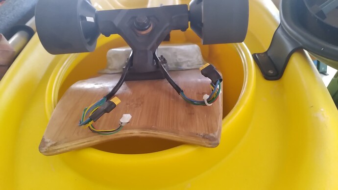

Last time I was stuffing my front hanger freed board into the Kayak hatch, I realized my new maximum sized enclosure might prevent such stuffing.
Unfortunately, this is indeed occuring, but better to realize that now, and not at the kayak launch. Fiona would be so pissed off, as the sky turned black from vile curses.
Looks like I have a good excuse to modify the shape of the deck and make it look less recognizable as a premade that anyone with 280$ can purchase, even though i don’t find its shape displeasing as is.
I don’t need So much kicktail anyway, and a just tapering the nose a bit might be enough as well. The enclosure is getting a 3/16" gasket too.
It is hitting the front of the enclosure by the kayaks footwells, and i dont really want to modify enclosure, and lose interior volume if other options exist.
I was not too thrilled to have to cut off the swallowtail tips, but am not displeased with how it looks with the minimum amount cut off to allow it to fit i to the Fionayak
As a bonus, I can more easily 2 finger carry it by the front truck hardware and it barely scrapes the ground. I figure once I own a pair of shoes again, the added height will prevent scraping at all.

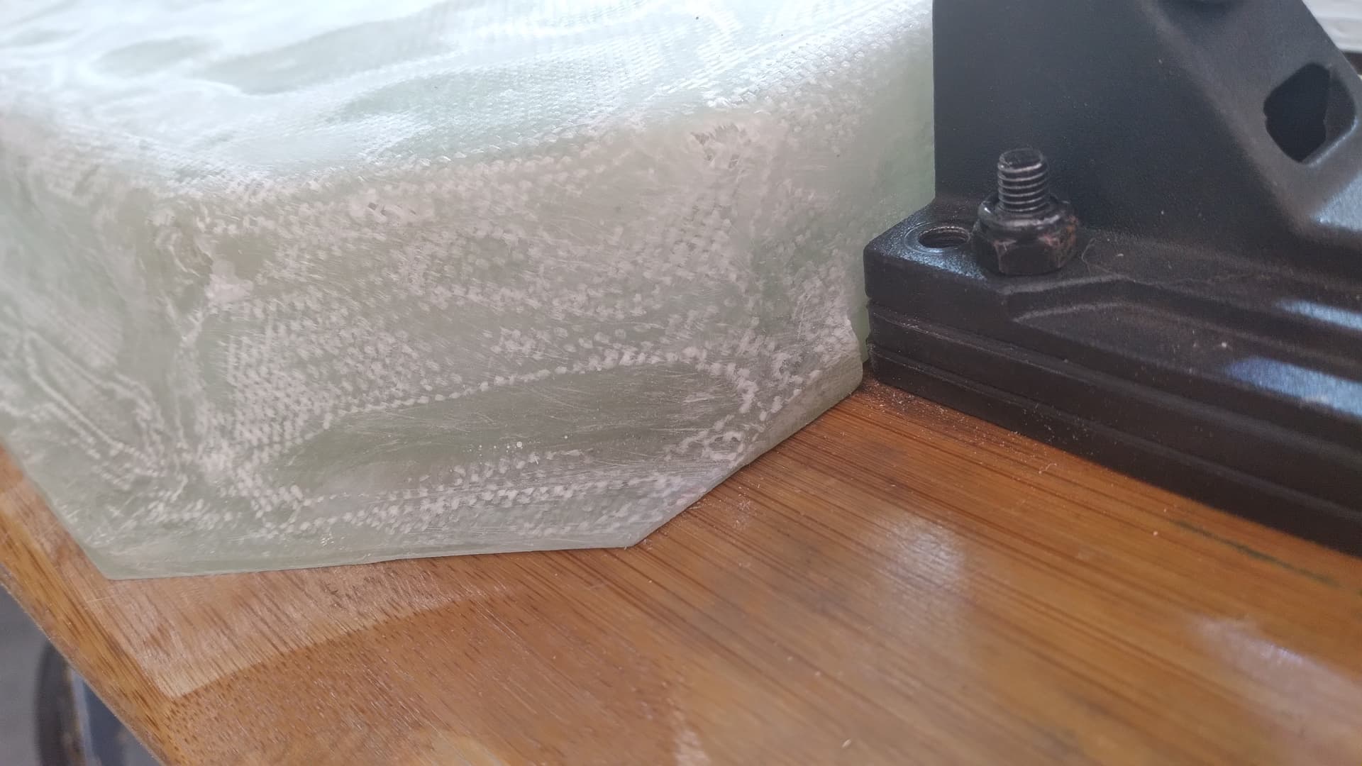

I am not happy with the thickness, or width of the flanges on my enclosure, so will be adding more unidirectional tow/roving/fin rope to the areas lacking girth.
I could do it when not using the board as a mold, but temps are warm and i should be able to reassemble it tomorrow in order to be able to ride it, and it should equate to a better result and less dust/sanding.

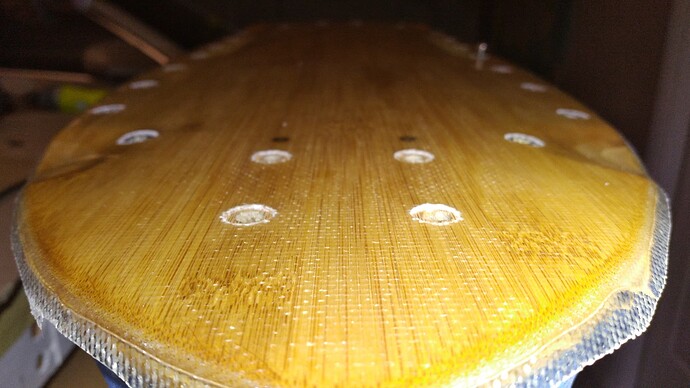

Drilled some pilot holes through enclosure into deck, and then drilled deck for some threaded inserts, but have not yet epoxied them in place.
The cast inserts are disappointing. Blunt threads and the two halves of mold not well aligned, so the seam would gouge the hole wider than necessary, and lumpy dull threads cut more wood away than needed.
I’d not trust them to hold well if not epoxied in place.
I have 3/16" gasket material, but can still shorten 3/4" SS truss head screws, or thicken flange, if needed.
You don’t want to use philips heads here. Try to source some hex bolts. I use socket head for extra depth since I’ve had regular hex strip on me.
10-32 threads, and Phillips head are nostalgic for me, and were a conscious decision.
Standard single fins box hardware on surfboards use 10-32 threads, but slotted/flathead usually.
I went Phillips head on them 35 years ago.
Epoxied inserts in place.
Thirsty endgrain sucked up a lot of thin epoxy.
No issues with epoxy obstructing interior threads, but had to hover, and when epoxy was rubbery, ensure that no epoxy could.
Sanded flat, remove all original finish on hull.
Laminated one layer cheap folded bondo brand fiberglass onto hull.
I’ll estimate it is 7.5 oz per square yard weight. An hour later brushed on a thick weave filling topcoat, and hour later, another.
