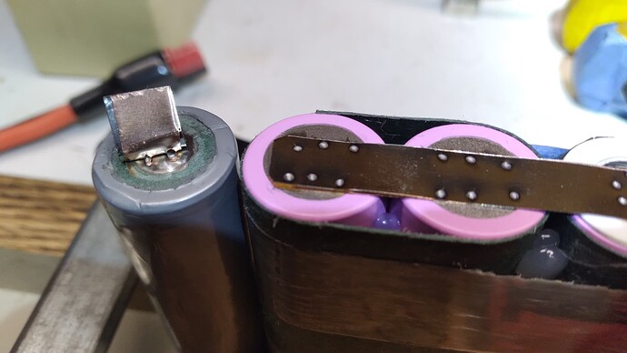

I spent some time today preparing more 0.10 nickel plated and 0.15 copper using infinite slot method, then welding them with my ‘purple’ inexpensive spot welder. Things seemed pretty solid, and i laid the packs.in my enclosure and started laying things out in order to visualize future steps.
Got a little annoyed at cleanly routing of balance wires, and bms location, and had to walk away.
Saw some critiques here, of another battery, one being that the sharp square corners of nickel plated steel strip overhung the positive terminals. I had rounded mine, but they overhung the + terminal over the fishpaper rings by a good amount.
So I took my precision side cuts and went to remove the excess, and in the process, heard and felt a weld break.
Shitballs.
Cursing, and angry, I ripped off all the sandwiched strips, some held very well, a real bitch to remove, and some others did not, and popped off without nearly enough effort.
The whole infinite slot method was very time consuming and difficult with 4 layers to position across 4 cells.
I was using low ms pulses just to first adhere nickel to copper off the baTteries, then positioning two sandwiched strips, with an even gap across batteries held by magnets, and this was still annoyingly time consuming and error prone.
So, I went back to my test cell, and practiced some more with different pressure, tip shapes, width, MS pulse duration, thinner copper, 0.15 pure nickel, slot vs No slot all sorts of comboes.
I had not considered that my test cell’s ends, were basically no longer nickel plated steel, just steel, and the Settings i had figured out previously on it, were underpowered for new and different cells with the nickel plating still on.
I should have known, by sight and by feel that many of the welds on the new cells were not adequate, but…
I had been using the infinite slot method to keep the pulse duration down, but said F it, and found 0.1 copper under 0.1 nickel plated steel, no slot, with a 70ms pulse, and think it might be a bit excessive. Solid welds, but the wiring and Lipo battery Certainty heat noticeably faster the longer the duration.
I walked away again, for now.
I wish i could just convince myself that 0.15 pure nickel is good enough.
But am glad I did not find out the hard way what was mostly ‘complete’, was far from passing muster.

My practice cell, I’ve been rolling off the test sandwiches, and then side cutting remnants as flush as possible, then doubled (for stiffness) worn 220 grit sanding disks on dremel to make flat and clean for next practice test welds.
I fear this has made it far easier to achieve a good weld, with no nickel plating remaining, and micro scratches on steel increasing resistance.
I saw one YT guy test welding strips to side of a dewrapped can on a test cell. I wonder how representative that is of the end of the can, for testing purposes.
I dont have enough test cells to experiment on. The one i am using is a ‘roofer’ 2200 mah cell I had soldered into a cheap headlamp. It was still performing well, but because i soldered it i decided that was the cell to sacrifice, and found It had apparently gotten wet at some.point.
The cell can was rusting under shrink wrap. I put new fishpaper ring on it and rewrapped it and drained it below 2.5v before testing on it.
I had a failed BFN cell from the 7s ‘parts only’ skate, but when the ‘black’ spot welder proved underpowered, and I tried powering it from a pair of 190AH Deka AGM golf cart batteries, it shorted the Mosfets and tried to drill a hole through the can. ratatatata machine gun style.
The 6 other BFN and 3 other LG cells are now tecbnicaLly my first spot multicell batteries, though the LG cells are in a leaf spring holder. the BFNs spot welded.

I peeled off all former spot welds.
Then decided I had to check last nights seemingly solid 70 ms pulse welds, and what a huge pain to remove, screwed up my precision flush cuts trying to roll off the sandwich, and had to retune them.
Those white ring insulators I got from liion wholesale are complete junk. They are like thick paper with a plasticy layer on top. suoer hard to get off backing paper to apply.
Half of the thickness of paper peels off with the blue masking tape, which was only lightly placed across them. A little rubbing alcohol and the rest came off the cell tops easily and cleanly.

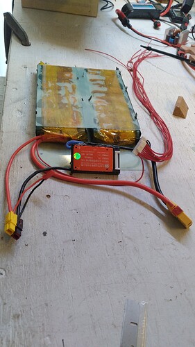

Here’s my first esk8 battery, nearing completion.
10s2p of Dmegc 2600mah 15amp cdr cells, which while tiny, represents 50% more watt hours than my board came with.
0.1mm copper 0.1mm nickel plated steel sandwich.
10awg series connection between P group 5 and to XT90s, as Voltage drop irritates me.
Daly 20 amp dumb Bms with 14awg anderson powerpole pigtail.
I sandwiched the 10s2p flatpack with 0.5mm G10, using Karfuter K705, a moisture cure relectronics Rtv sealant/adhesive that has no smell, and dries super clear.
Extra layers of fishtape near shoulders and balance tabs.
Yep, Id move balance tabs apart in center further, if doing it again.
Will be runnng balance leads outside of G10., and BMS will be attached to Bottom G10 plate.
This small battery will be able to swim laps in the fiberglass enclosure i am making, which is still far from ready to accept it.
I reluctantly decided against additional JST plugs for easier P group monitoring and manual cell top balancing.

Played with the 9 unrouted Balance leads for far too long, then said F it, no matter how route them it, I’ll later wish I routed them differently.
I left some slack, soldered them to the tabs, and all a bit loose for now, as I want to get a clampmeter over them to see how the Daly BMS balances.
I am charging it from my 12vdc Deka AGMs via a 400 watt Voltage booster/step up converter.
The dekas are being floated at 13.6v with a hundred amp PFC adjustable voltage power supply, and the booster is seeing 13.32v under a 6.05 amp load, outputting 2.01 amps on its way upto 41.99v, which I dialed in unloaded.
The booster is turning nearly 6 watts into waste heat.
The Daly BMS says it starts balancing at 4.18v with 30mA max current.
Edit, somehow, with my dunce cap on, I expected 30ma would start flowing through balance leads into the lower P group(s) once 4.18 was reached on most groups
My expectations were not realized, of course, and I could not measure anything, with 8 groups at 4.20, and 2 @ 4.17, and after an hour, nothing changed, and i could detect no current with my clampmeter, nor detect any temperature change on the surface of the BMS, and those 4.17 groups stayed there.
I suppose the 30ma balancing current would only happen with a huge VDelta. and 30mv is not huge.
I am not going to leave it at 42v overnight unattended. Screw that.
I rigged up a 4.200v supply with insulated alligator clamps, hooked it to cell group 8 which reads 4.17v , and saw 200mA flow and start tapering.
My clampmeter can read down to about 40mA, it that i trust it, but its better than nothing.
I want to get all P groups within 10mV or less, then goto bed, see rested voltage in the morning. Then ill discharge the pack down to 36 or 37 volts, and work on the enclosure.
Kind of thinking more about dual 6 wire JST plugs for the occasional manual balance.
I intend to be charge mostly to 4.1v per cell, and if the Daly BMS will only passively balance with sub 30mA and only at 4.18vpc or above, I think it might be next to worthless keeping the pack balanced.
Here an LM2596 bucker is feeding Pgroup9 250mA. P group 8 and 9 were ~30mv lower. Now 8 is equal with the others and 9 is being fed.
