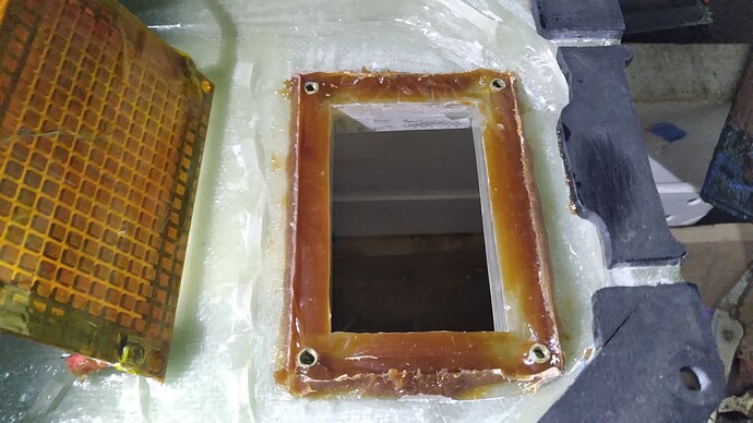

Modifying prebuilt junk, in stages, to be less junk like.

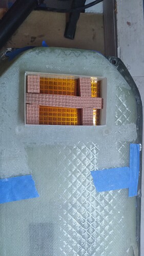

Cut these little pieces of foam to push vertical walls against enclosure.
Tacked in place with superglue, saturating one half strand of woven roving
Trick is to use the thin CY glue, not the gel, and saturate from middle towards edge. If one goes too fast, and comes back to saturate dry areas more, it will likely not turn mostly clear, and might not be as solid as otherwise. It’s pretty thirsty stuff.
But since it eventually gets paint and will be overbuilt, imperfect results can be more easily tolerated.
Glass schedule will be 5 strands of epoxy saturated roving along each edge on exterior, not worrying about bending them over the edge, just splaying their edges, and will sand off once cured.
Edit.
7 strands would have made me happier, for a wider fillet.
The Interior will likely need far more strands for a wide fat mating surface, but could also just be thickened epoxy rather than woven roving strands, which would be far easier.
Keeping epoxy out of the brass post’s interior threads mandatory.
They are cleaned and waxed already
Laid more roving fillets on interior, then added milled fiberglass and woodflour thickened epoxy atop that, seated the kapton taped heatsink, and forced what spooged out the sides, back under.
I just pulled the tape while still a bit soft, and the heatsink and the screw studs came off cleanly, and easily.
But the mold of heatsink underside, is imperfect.
Nothing RTV can’t seal, but I might have to try again.
The kapton tape wrinkled and those wrinkles transferred to the thickened epoxy.
I also dislike adding brown wood flour, to the Volan greenish color, but it will eventually get painted flat black and be inconsequential.
I thought i had some non pigmented Cab o Sil/fumed silica, but if I did, I apparently found the world’s least logical hiding spot for it.
I want to do more tonight, but at 9:42pm, it is 87f/30.5C in the garage, with high humidity, and I’ve already sweated enough today.
What I should have done instead of Kapton tape, was buff, polish and kultiple times, wax the heatsink so that epoxy could not stick. But there is always the fear that it will bond anyway
Clamped belt sander and vaccuum hose to table then flattened lip on the exterior, and xacto knifed the interior a bit cleaner.
Decided to try molding again, without Kapton or plastic separating heatsink from enclosure.
I polished the F out of the heatsink and waxed it numerous times, filled the low spots with unthickened laminating epoxy, placed heatsink atop, and weighted it.
If this is my last post ever, I am crying in a corner somewhere, as it bonded the heatsink anyway.
Actually, Id just leave it and squirt rtv along inside corner, if heatsink bonded to enclosure, but I reserve the right to cry in a corner anyway.
I can still attach FSesc6.6 mini, or hobbywing/Puaida esc to it.
It’s pretty well recessed, and the area is mega strong with so much roving inside and out.
Hopefully the passing airflow gets inside recess rather than skipping over.
I really went to extremes trying to avoid external fasteners.
Probably foolishly so, but oh well.
I razor knifed the edges, and pressed with thumbs, no go.
I tried twisty flexing the very rigid enclosure, and pressed, no go.
I placed Ice cube onto grid, and the cube acted like it was being sucked into a vacuum cleaner, melting and sticking. No water dripped to inside. Could have just left it.
Dried it and hit interior copper with a torch briefly, and twisto flexed it and pressed, nothing, solid as a rock.
Found some adequate load spreading wood blocks and a hammer. Tippy tippy tap tap tap and buhahawhahaaaaaa, out she comes.
It is almost perfect as is.
Brass post threads free of epoxy.
A thin smear of rtv and it should seal perfectly.
Only took me three days.
Cleaned up the new epoxy edges, and interior threads of brass posts to remove any polishing compound and car wax which transferred to enclosure from heatsink and the taped dummy threaded aligning posts.
The sink just drops into perfectly into place, and screws oerfectly aligned, and threy threaded in easier than ever.
Instead of a hard stop at the end, I could feel them slightly compress the new epoxy.
I flipped it over, filled the 10mm cavity with water, and placed it on a paper towel and left it alone for 15 minutes and could detect no visual drop of water level.
One drop did get in on the paper towel though, but considering I used no rtv or sealant, I am satisfied.
One issue is the copper plate is flexible.
When the hobbywing esc was screwed to its edges, the center of the heatsink was basicaLly bowing away.
It was filled with thermal grease of course, but the gap might have been as much as .25mm, which is no good for thermal transfer.
Now the posts are fully surrounded by fiberglass, and the entire 10mm perimeter of heatsink is too, inside and out.
So the bowing outward of heatsink when is ESC is attached is basically eliminated.
Pre final molding, I made sure it was bowed upward very slightly in the middle.
