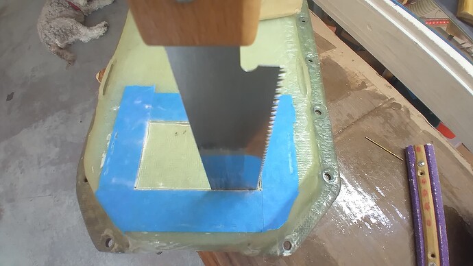

Bought a cheap wood burner tool today
I covered previous enclosure, and truck hardware holes with blue tape before filling them and laminating other side.
In used back of fingernail on top of tape, lots.of pressure toninsure excellent adhesion.
Look how far the thin laminating epoxy wlcked up and down the plywood adjacent to the truck hardware holes, compared to the enclosure’s holes.
Makes me cringe, imagining the deck splitting there on a hard toe, or heel side turn.

On Friday, I laid a pretty thick presaturated unidirectional fiberglass rope around the perimeter atop the woven roving overhang, then laid 1 layer of Bondo brand FG cloth on whole deck over the rope, and when that tacked up a bit, filled the weave with more epoxy, then sprinkled the Turbinado coarse sugar all over, spreading it evenly, pushing the crystals into the epoxy.

Today, the turbinado sugar dissolved off quickly under the hose, and left a really nice grippy surface.
I had to fine tune the vaccuum attachment on belt sander, and ground down the excess fiberglass, leaving about 6 to 8mm additional width around the perimeter.
It’s Imperfect, and not yet finished.
If I had to do it over Id glass the deck first, then flip, lay the rope and woven roving , and cloth the bottom, so then it would carry the deck concave up the edges, and allow more leverage. I could still accomplish this, but likely won’t bother.
I drilled out the truck hardware holes, and returned the trucks, and stood on the deck, giving it a little twist. It still twists, but seems far far stiffer than before.
I did strap the 7s2p enclosure to it, and could have ridden it, but I want it to be truly fully cured before adding riding stress to it.
It is still really light weight, even with all the additional epoxy and fiberglass.

The copper heatsink is 70x100mm.
50mm x 80mm of its center will be exposed to airflow.
I was wondering how thick the enclosure was here.
Averages 2.85mm
I could tack these vertical walls in place with superglue, or epoxy and roving, butted up against the kapton taped copper, then lay fin rope up against the walls on the exterior.
Then flip, remove copper, lay more presaturated FG fin ropeated, and returned kaptoned copper sink to mold a 10mm wide interior flange. which should allow a nice even kapton tape thick layer of RTV to seal the gap.
Or cut a gasket of some sort, or both.
Should be super strong ,and be able to form a sold waterproof seal.
When inserted into kayak, there is a potential drip from right above this area, so I gotsta make sure it is as good as i can get it.
Ill leave a little lip on the exterior as well.
