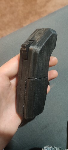

Been using the mini remote for just over a year now, on and off over 2 years. Been loving it. Only ever had disconnects in one spot in downtown.
These days the internals live inside this shittily printed rehousing.
And yeah 2xAA still going strong. Have recharged them maybe 4x in the passed 2 years.
