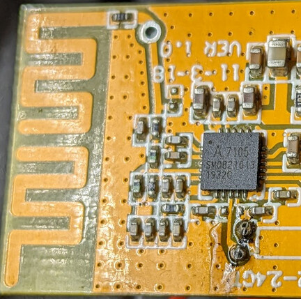

Board department isn’t much better. Main MCU PN has been taken off as expected. I Haven’t bothered reverse engineering what chip it is, however if I have to guess, I would place my bets on some older PIC or attiny series / their china clones. From many remotes this one hasn’t been reverse engineered by many of the open RC protocol projects.
Regarding RF driver chip, it’s A7105 a very archaic chip.
  • RF
    I’m hoping someone can chime in on this. If I have to guess, this remote achieves it’s reliability by ether using high power levels or doing some other illegal RF shenanigans. However I have no equipment to test it.
