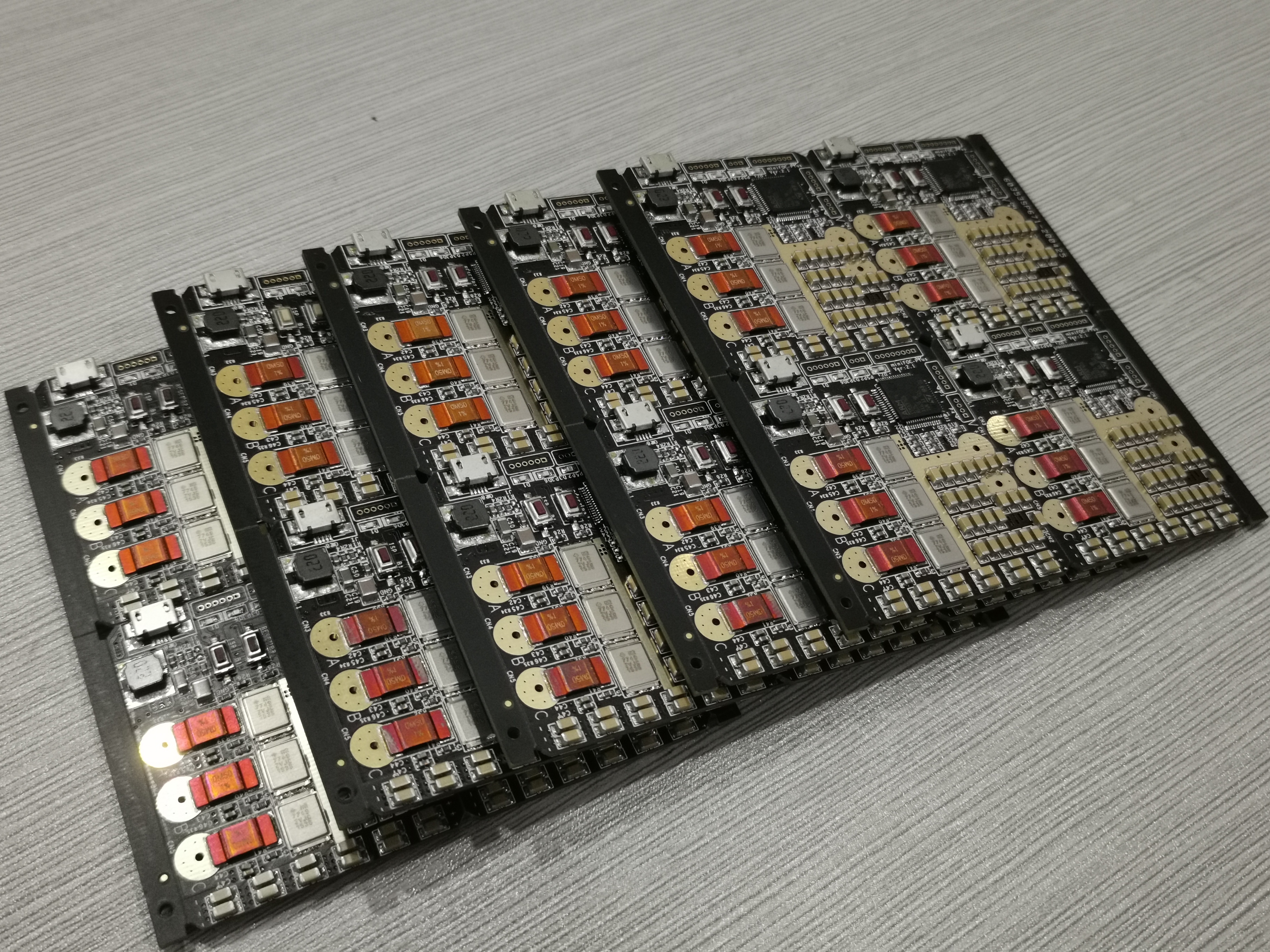

Mini FOC based on VESC6

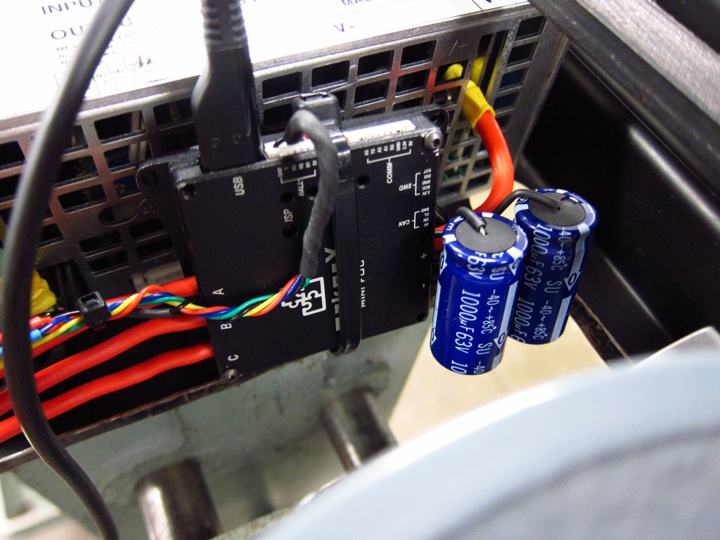

I have added 2 x 1000uF 63V capacitors onto the unit, with the leads soldered directly to the same pads on the board as the power wires. The wires between the Mini FOC and PSU are ~7cm long. From the Mini FOC to the motor, the wires are ~40cm.

The biggest improvement through all of this came from installing the electrolytic caps on the power inputs. Operation became a lot smoother and more consistent with those in place. I just need to tape them up or something so that they don’t fatigue their leads. Anyway, this is why I love forums since other enthusiasts learn and share tips like this.

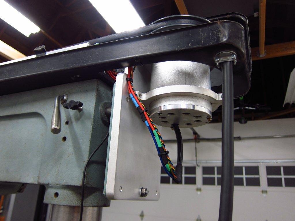

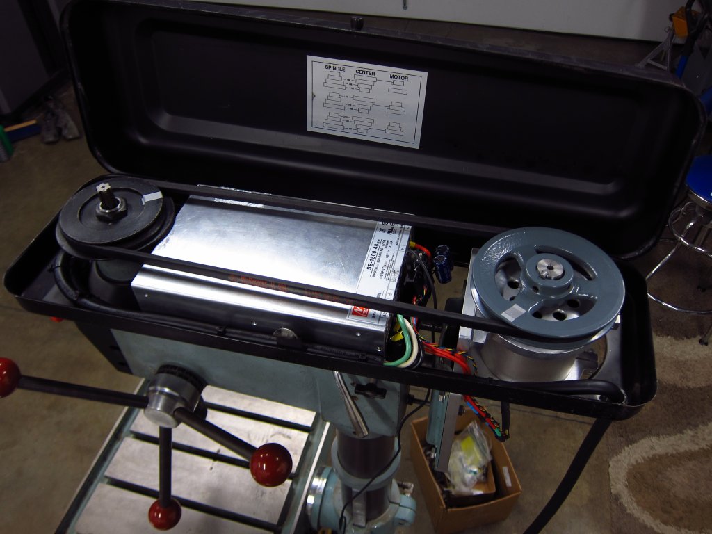

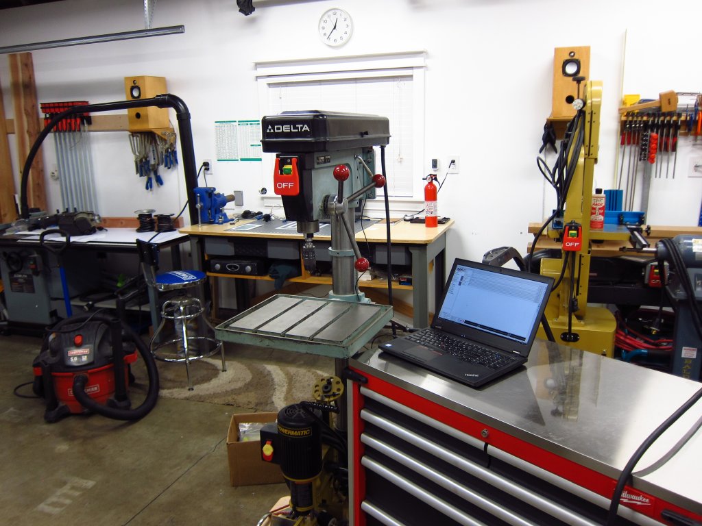

As promised, here are a couple of photos of what I am using the Mini FOC for. This was a craigslist special that was totally rusted over in some guy’s basement up in the mountains. I spent a month totally de-rusting everything, replacing all of the bearings in the quill assembly and machining new handles since it was missing those. While I have access to a full machine shop during normal business hours, it is nice to have the basics in the garage at home! The motor mount plate, motor clamps, shaft-to-pulley adapter and some custom machining of the motor’s rotor were things I had to fab to get this to all fit together well. Now I just need to clean up the wiring a bit more.
