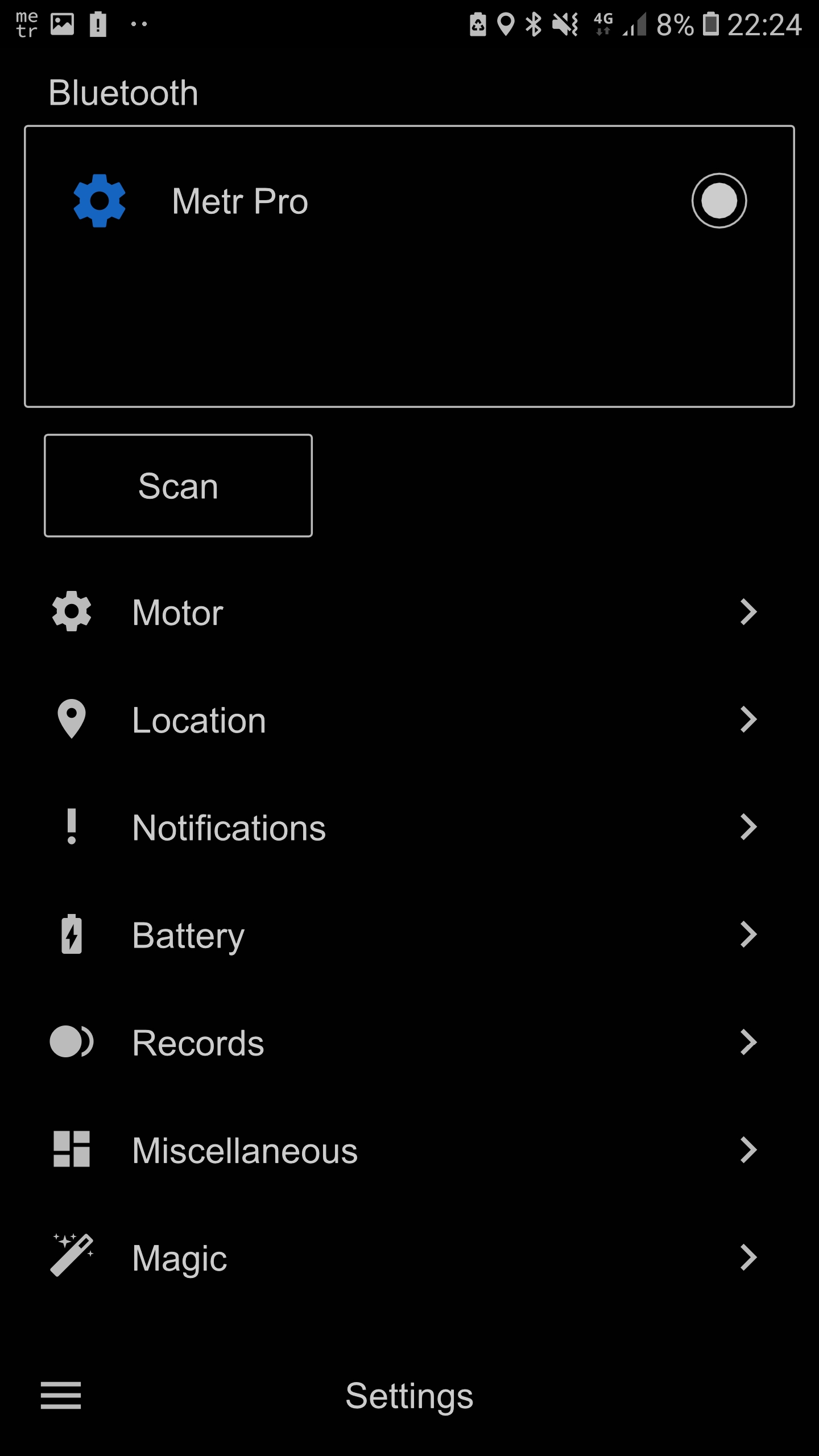

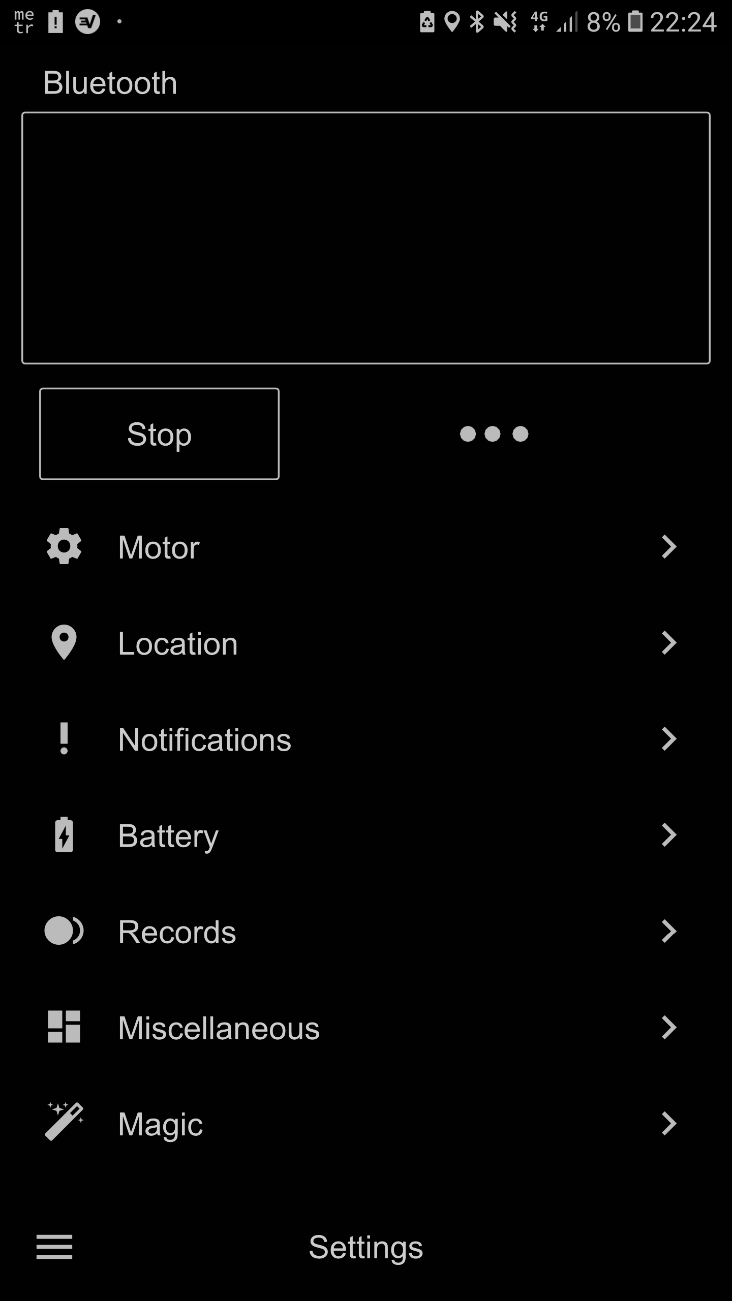

Just reinstalled the latest SW and its not working - just like I said :frowning:
It will only show the metr pro and not the 444 and also I am not able to scan for it
I got both Boards turned on and it will always only find the Metr Pro
PS: Let me know once you saw the Log then I will remove the post to make the thread easier to read… LOL :smiley:
I saved the log for Roman, so you can remove it. :slightly_smiling_face:
On Android it sometimes take some time before the module is discovered on the first scan. Can you send another log with the latest Android app version available (3.8.30), turn of the board that has the Metr Pro inside, so only the one with the old module is on and wait about 1-2 minutes after hit the scan button just to be sure we get the output we are looking for in the log? Please send it to support@metr.at afterwards.

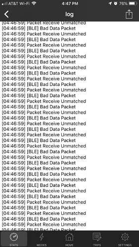

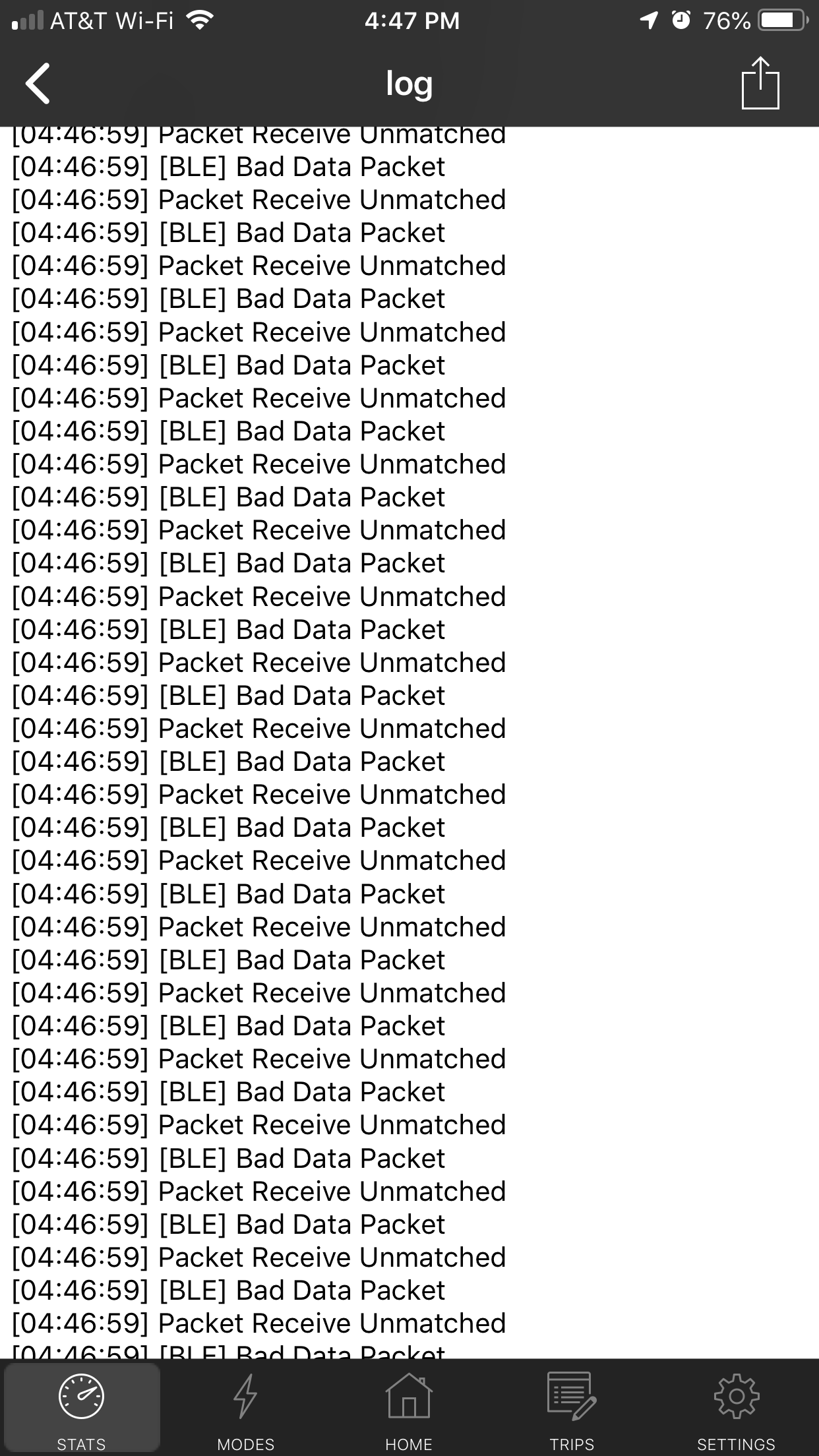

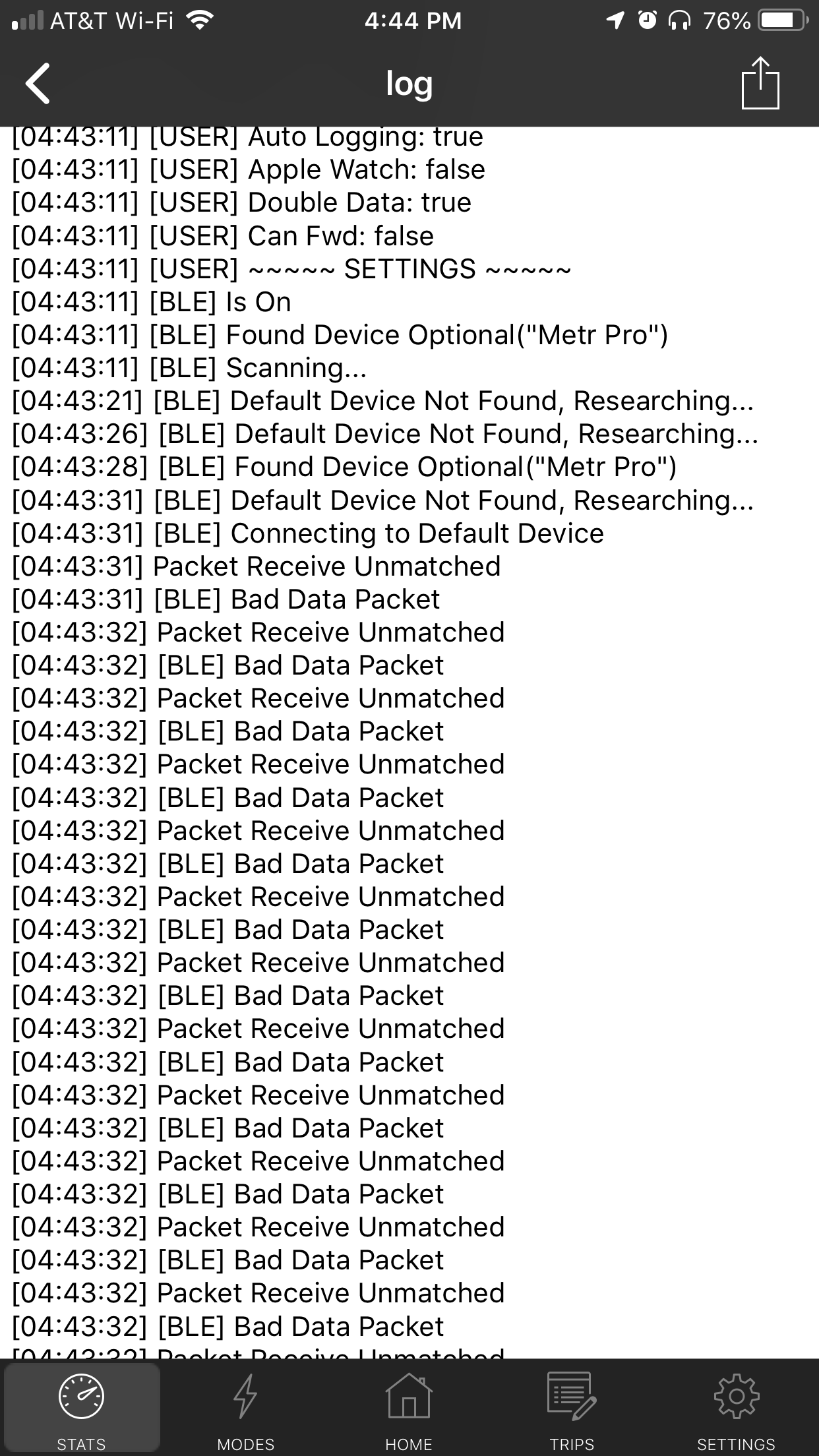

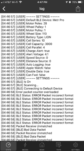

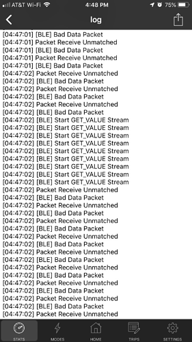

Hey @rpasichnyk think you could help me out when you have a chance real Quick pretty please… got my first metr pro Module from a buddy lent me an extra unit he had so I can familiarize myself with the app and what not while I wait even longer for my unities to arrive and to get a couple of those versions from you guys soon too. Any multi package discounts? Lol. Anyway, I normally always used an HM-10 BT unit for Vesc Info so I’m super excited to get to use yours now,!been having some issues on a motor that I’m hoping metr will help me diagnose. Here are some details…, using a 6 pin JST connector into the uart pin out on my master focbox i running as a dual set up via can bus. I am
Able to connect to the metr both on my iPhone settings and also in the metr and Xmatic apps. But thats where my fun ends… No telemetry / data… can’t figure out why… tried restarting phone and app. Turning b/t on and off. Repairing. Uninstalling and d/l the app again. Nothin. Here’s what xmatic was saying when trying to communicate. See pic. Thanks in advance brotha!

Mail is out - thanks for the recommendation but it did not work. It just will not show up no matter how long or often I hit scan and no matter how often I restart the board.

@Jansen did you do pairing / enter PIN code? Please make sure Metr app works first, go to the https://metr.at and click App Store. When you have it connected and working, we can have a look at xmatic

Got it! Re d/l and restarted everything again and still didn’t work after pairing. Switched to my slave VESC and all is working good and fine now, did a couple runs last night to test it out. 2 quick things…
  1. Does this mean something is wrong with my master VESC? Was set to PPM and UART and slave was set to UART and all other setting seemed fine and I plugged it in the same way as I did on my slave when it started working…?
  2. Is there a way when you upload the data after a ride to look at it that I can have it show with the settings I have in the app? For example since I am in the US I have everything imperial, miles, Fahrenheit, etc. Would just be nice not to have to covert that stuff when analyzing… LMK and great work fellas.
Metr Pro should work with both master and slave. Try again, if it doesn’t work, check that green LED on Metr Pro blinking rapidly or always ON, in metr app go to Settings -> Show Logs -> send to support@metr.at

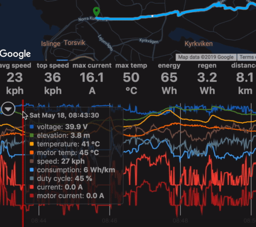

Online uploads do show the ppm values, so does the realtime tab. But looking at records within the app does not show them (no drop downmenu to choose what values are visible).

OK… since I updated my Phone now to Android 9.0 I have no more issues with the new metr.at app and with finding old or new bluetooth modules…
