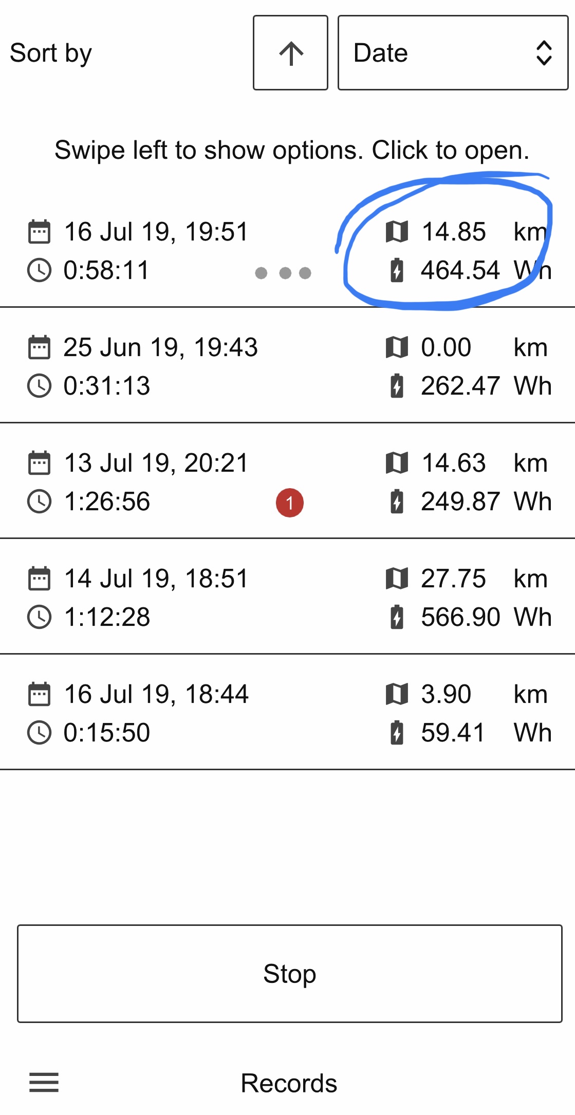

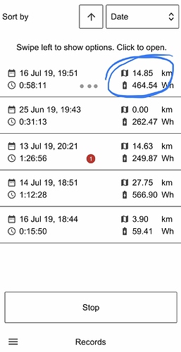

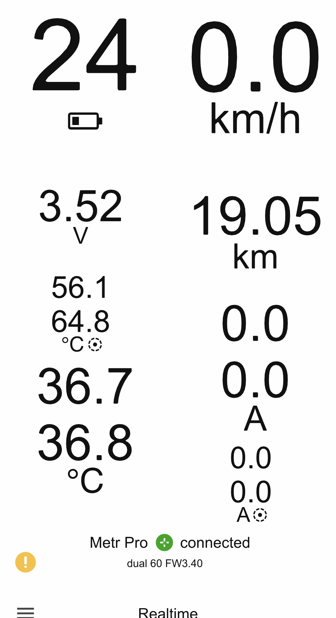

probably there is an easy explanation for it, but I didn’t get how that could happen. I yesterday had different distances in the real time data and the recording
I was driving before that trip with an other board which has a metr modul as well, but even if to add up both distances it does not really fit to total distance displayed in the real time data.
Did you switch modes or settings during rides? If you are in that tab, the realtime data stops. I guess it’s being addressed atm.
I didn´t switch, just switched the boards.
But even if, the real time data than should be lower than the recording. No?
Unsure, only @rpasichnyk will know.
The distance in the record is zero when you start a new one. When you do, the distance should obviously be zero in every record that begins.
On the realtime screen the distance does not reset when you start records. It resets when you close the app. It should also reset when you switch boards, but maybe there is a bug, let me check :nerd_face:
Update: there is a bug with distance not resetting when switching boards, will be fixed soon :+1:
