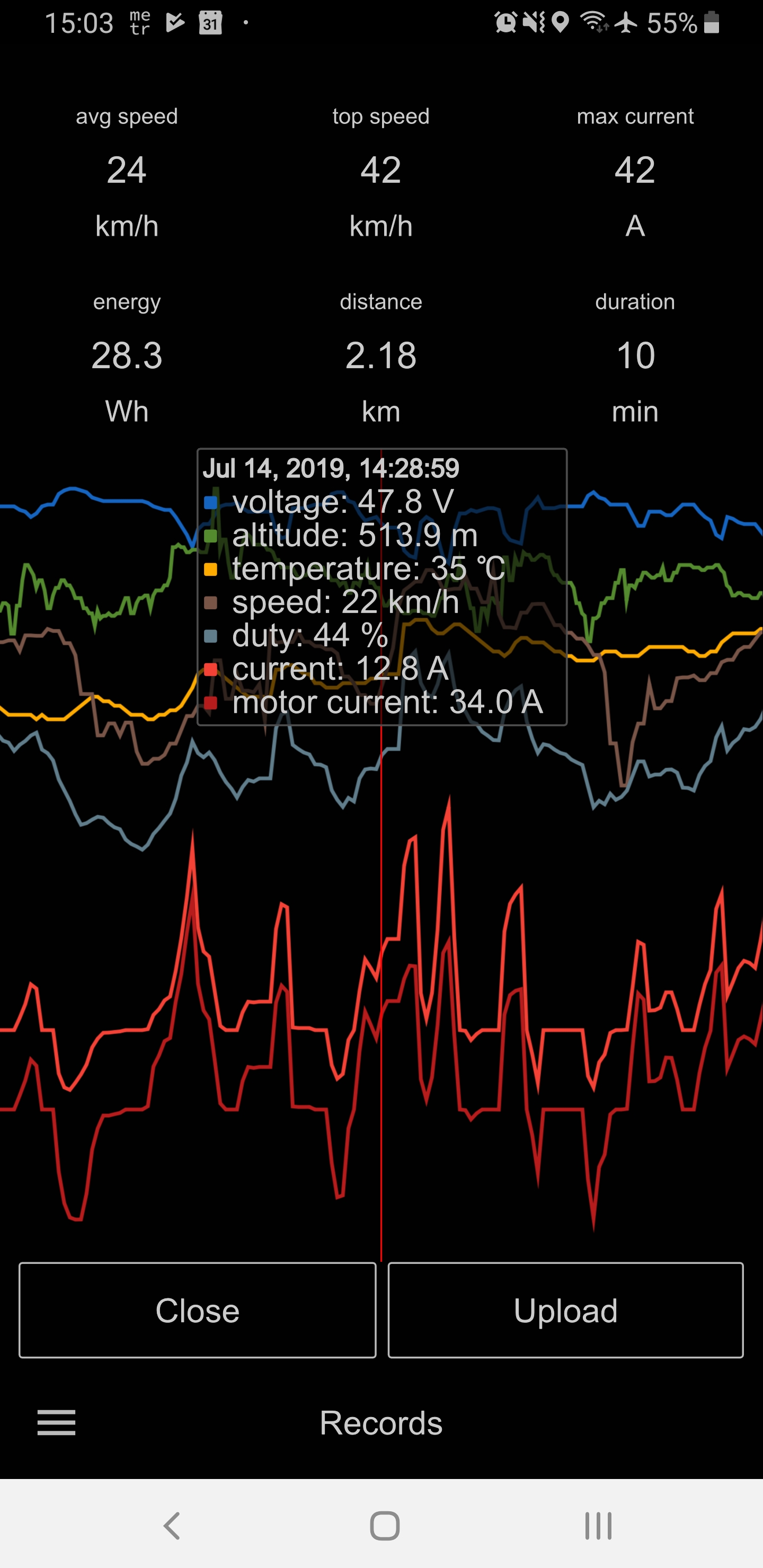

hmm, online my stats dropdown is cut off at the bottom:
in the app itself there is no dropdown menu available (galaxy S9plus).

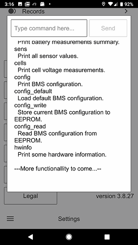

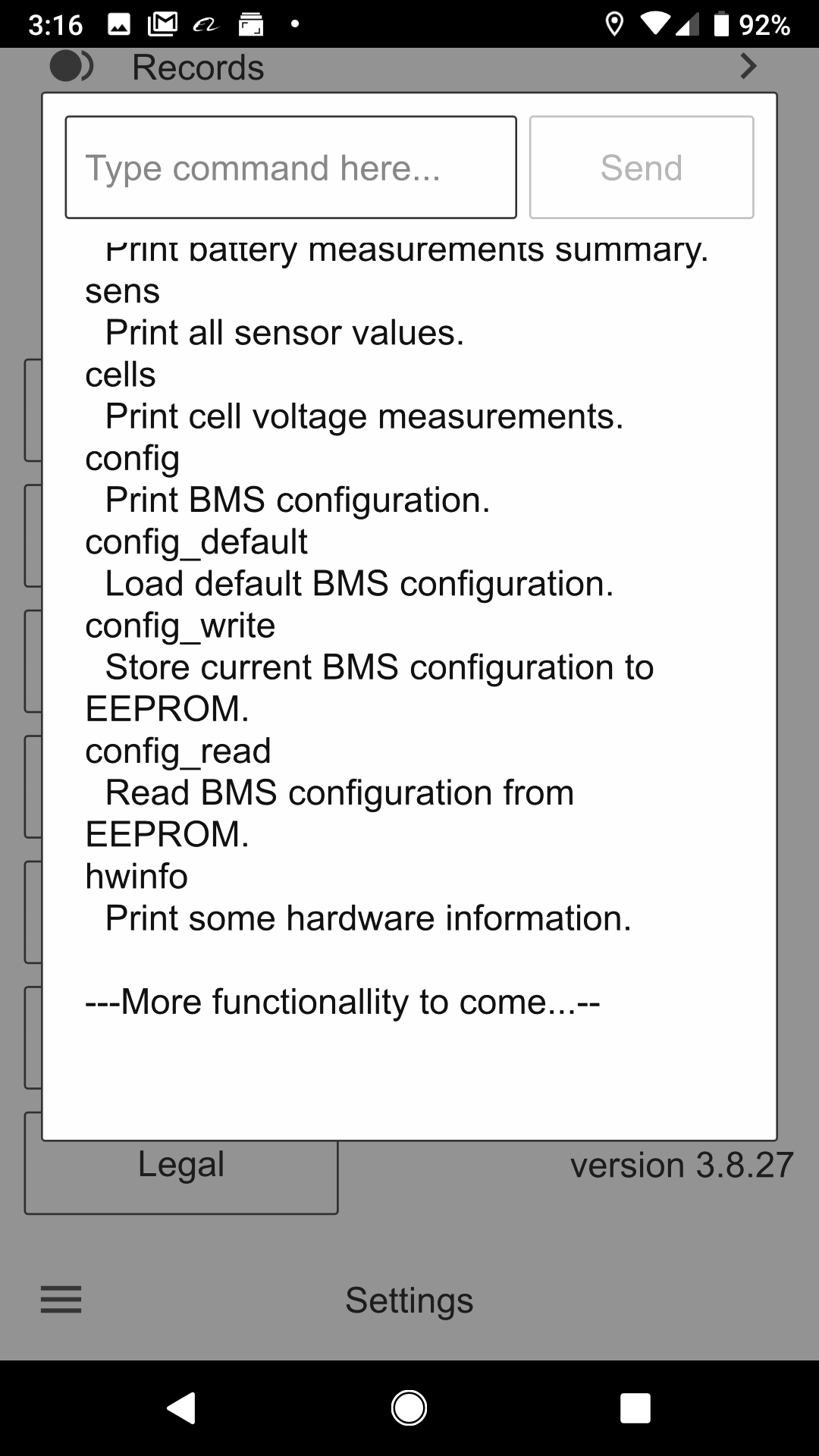

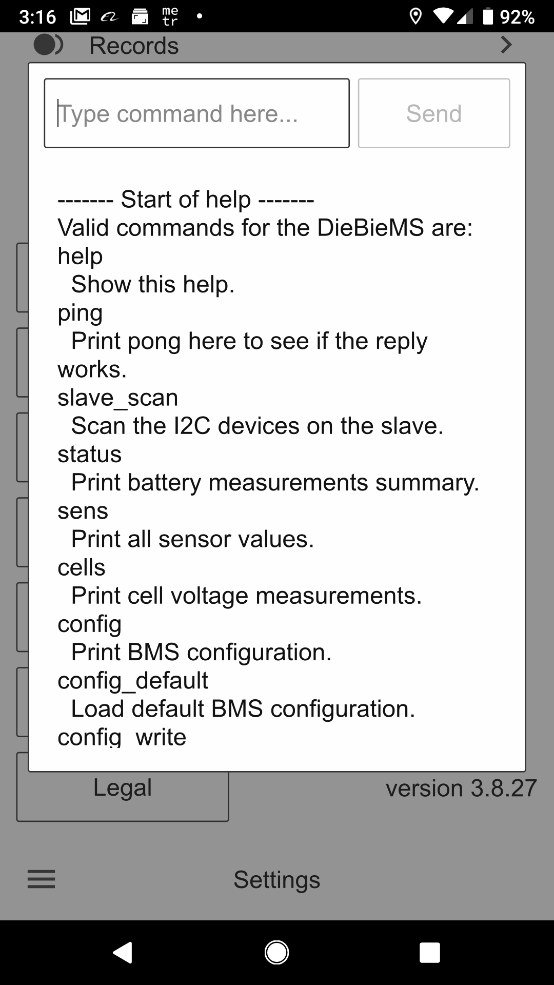

I can use the terminal, with Settings->Magic: CAN forward on + can id:10, to connect to DieBieMS. When I hit help it shows me the options below. However I don’t see a way to set the config. I want to use config_set_HOV(I used to be able to do it previously). Any idea what I can do? I don’t want to open my sealed enclosure. It will be a lot of work.
