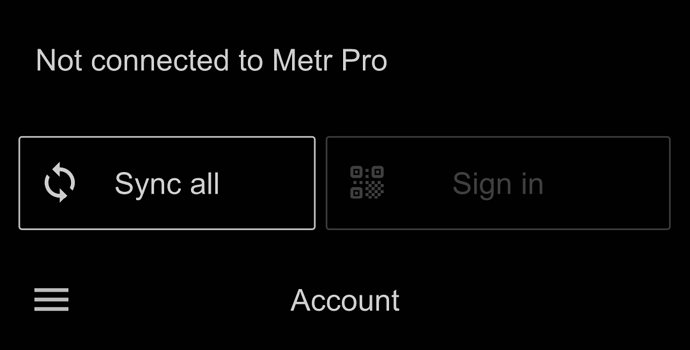

The app update with accounts is landing
any time now :rocket:
You will be able to sign in to your account and view stats and all records for currently selected Metr Pro module. The sign in is done using public key cryptography instead of a password. The cryptographic keys are already installed on your Metr Pro. You will need to have an active connection to BLE module in order to sign in. This is done for several reasons: vendor lock-in, greater ease of use and higher security :lock:
You can sign in with the browser on your phone or
You can open a browser on another computer and scan QR code with your phone to sign in
22
  • Once you sign out in one browser, all browsers are automatically signed out.
  • It is always one account per Metr Pro. For those of you who have more, multiple modules in single account is something that is being worked on and will be enabled in the future.
  • Syncronization is only one way up at the moment. But things will improve there too.
  • You will be able to export / delete all your account data (for example if you want to transfer your Metr Pro). This is being worked on.
  • Automatic records are nice. Now there are Automatic uploads too. Each time the record finishes, it will be uploaded to your account, so you don’t have to manually do this step. If you want it to work, go to Settings -> Records to enable “Automatic uploads”

I could wait and try, but if I understood correctly the records made with a legacy Metr module won’t support this right?
Looks like it’s a no go. Just tried with my old metr modules. Bummer…
Accounts will only work with Metr Pro
