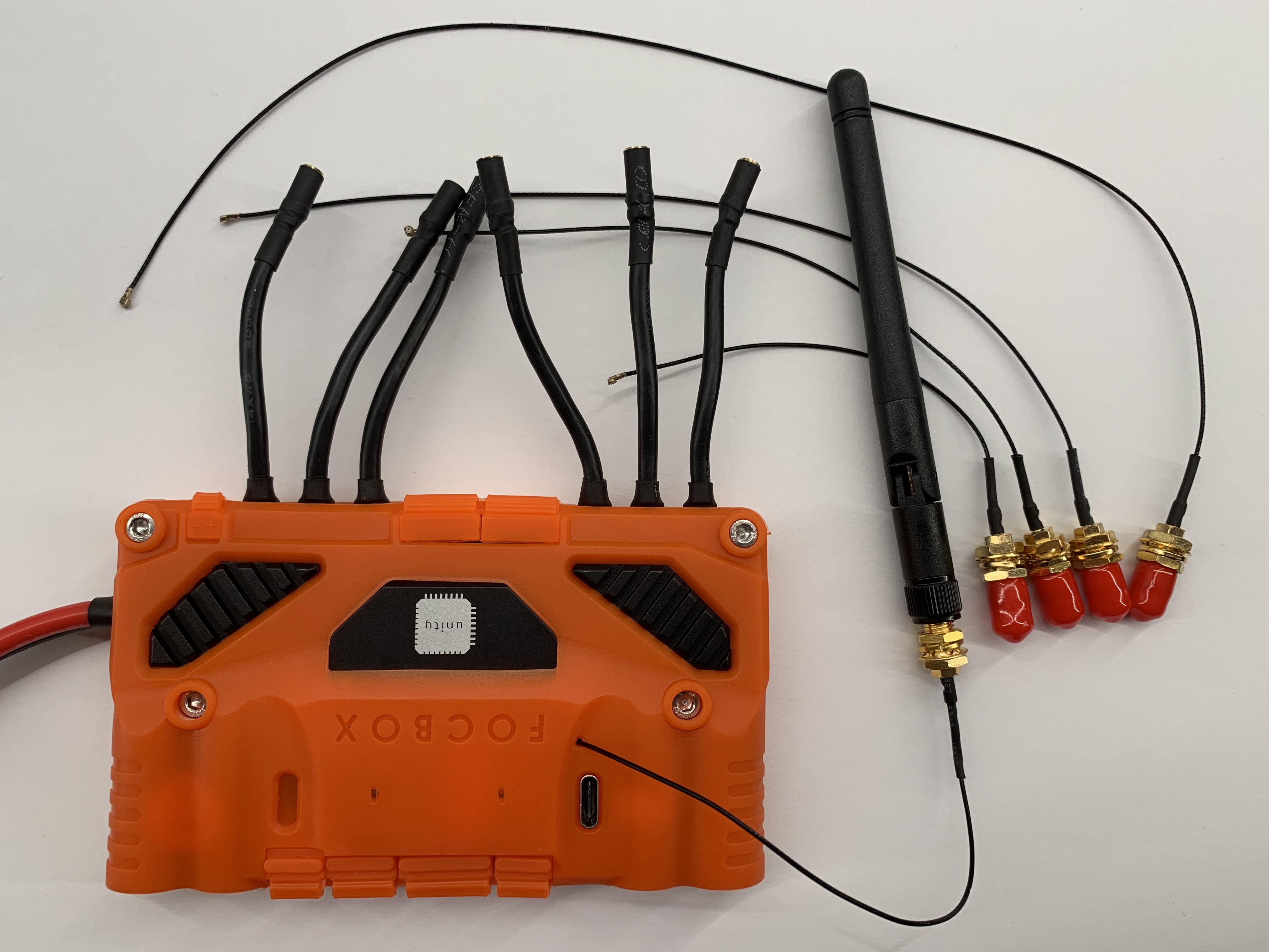

Yes, I have some updates for you. :blush: Sorry that it took longer then expected. Have received the UNITY finally… Right now we sorted out an easy way for installing the external antenna cable with damaging the silicone case as less as possible. For the best and easiest assembly a small tube is necessary that we currently plan to ship with the orders when they are available in the store.
At the moment I can offer you sending a Metr Pro UNITY module with external antenna (small or large), custom made antenna cable (10cm, 15cm, 20cm or 30cm), but without a “helping-tube” so it is a bit more fiddly for you to assemble. PM us for details.
Here a picture what it looks like assembled and the different custom made antenna cable length.

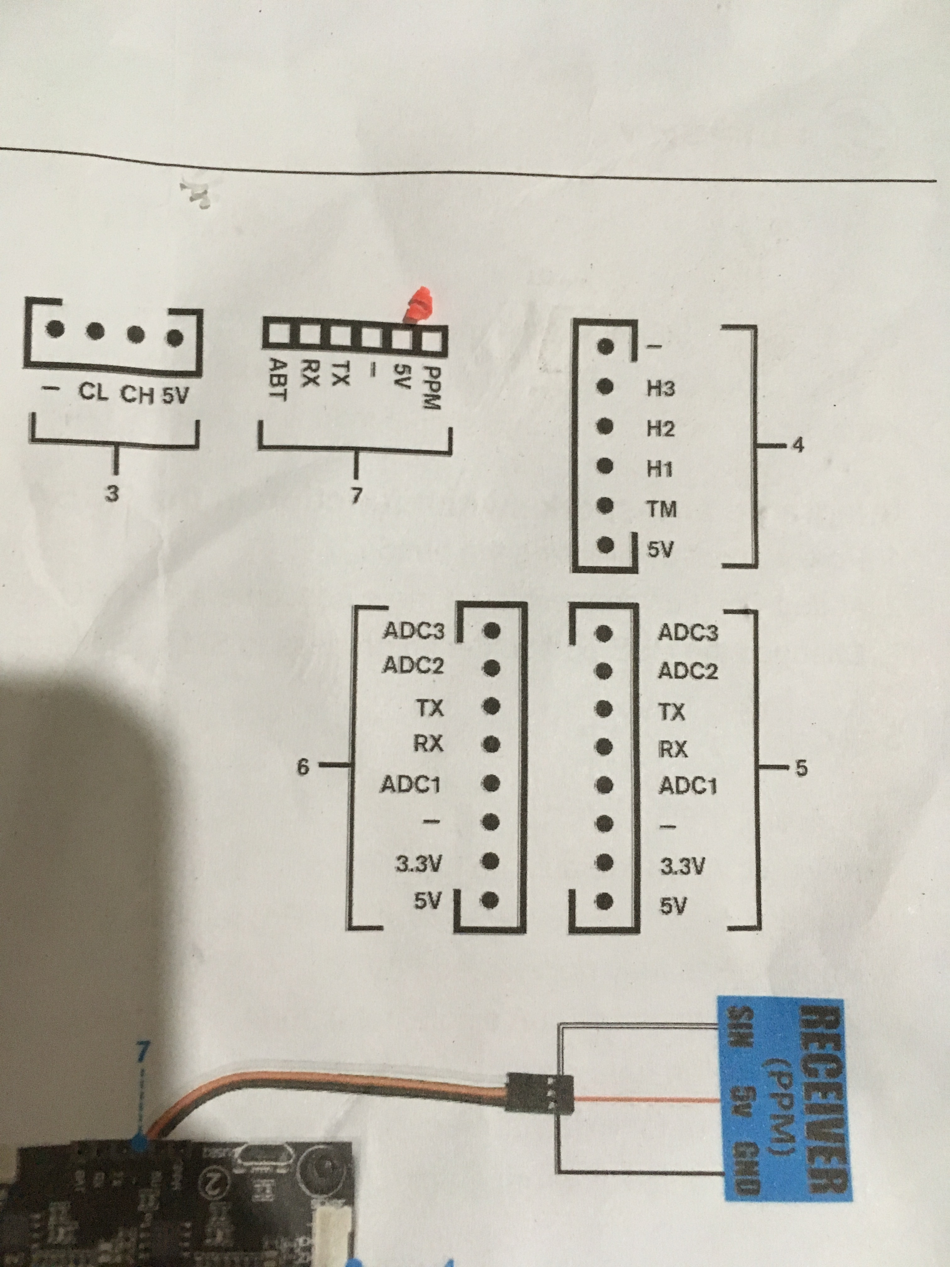

Question. I’m running the metr.pro on the flipsky 6.6+ which has an 8 pin uart port. My metr has only seven pins. Everything functions except for my battery meter, this is in a state of constant fluctuation.
Is there an adapter I’m missing? Currently it’s plugged in to the pins 5v-adc2 should I move it up and run it 3v-adc3?
This is just nature of VESC I figure. Mine is close to “random data” when idle. :slight_smile:
Set smoothing to a value you prefer and forget about the fluctuations.
Your plug-in is all right.
EDIT: is your battery meter a hardware one or are you talking about METR battery meter?

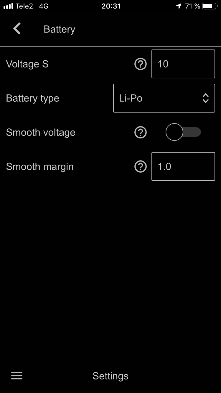

It’s the metr battery meter that fluctuates.
Is there an appropriate smooth margin you recommend setting?
I would love this, as metr logs data much better
If you are talking about the voltage jumping in a range of around 1v it’s because flipsky esc has poor accuracy on voltage. It says on their product page the voltage is in±0.6v. I have flipsky 6.6 plus, tb esc and Vesc 6.6 plus, only fsesc acts like that.
What pins of the JST connector are necessary for Metr Pro to work?
Only four pins: 3.3V, GND, TX and RX need to be connected.
https://metr.at/faq#q32
Jumping voltage workaround - enable Smooth voltage in Settings -> Battery

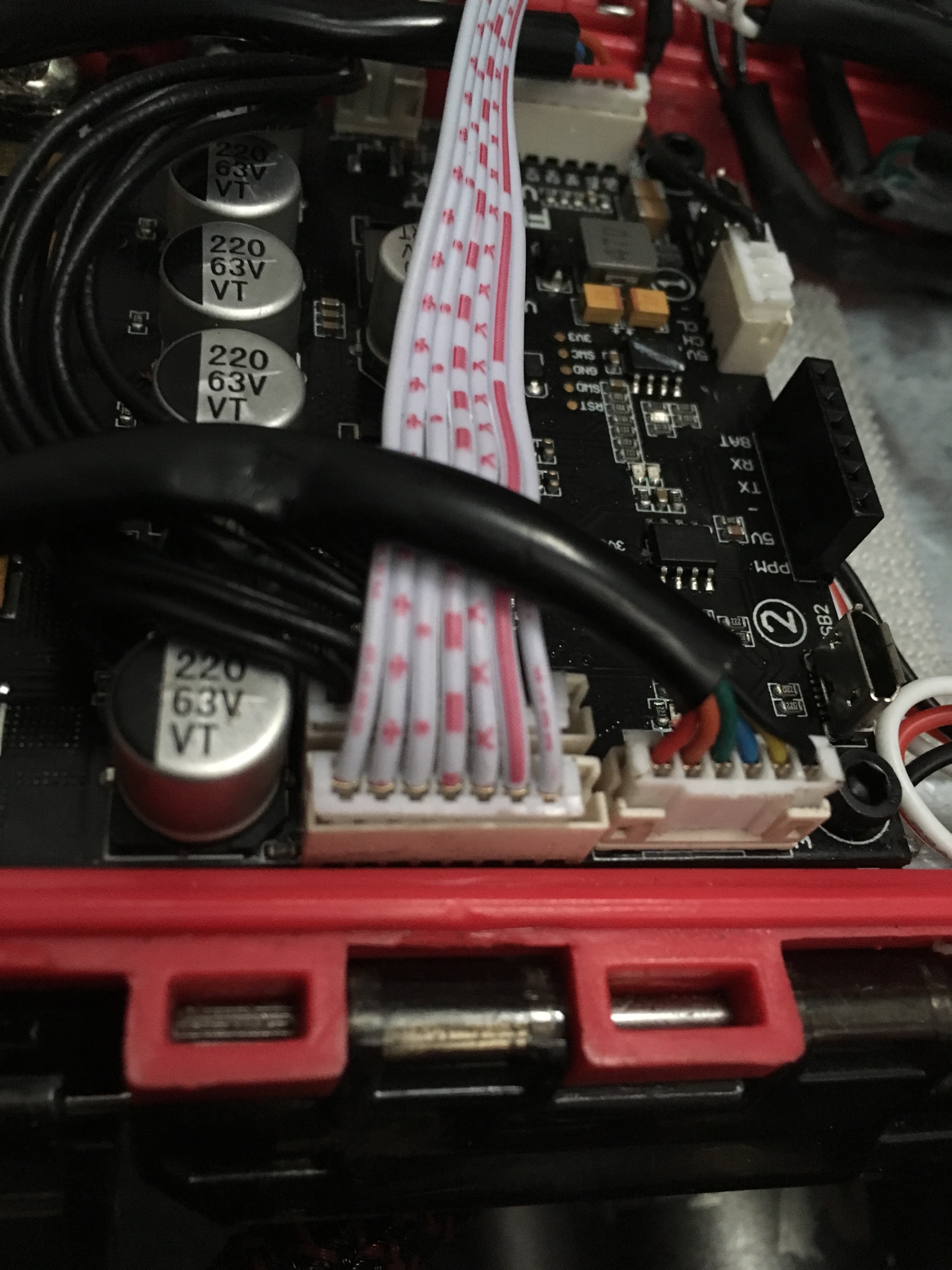

Can anyone help me get ppm logging working please.
I’m on dual flipsky 6.6 with a metr pro.
Running Ackmaniac 3.102.
All other data displays in the app without any issues…
I’m on the latest version of the app and I don’t have the firmware update sign showing.
Thanks.
Metr Pro has to be plugged in master VESC to get PPM. Try to use another UART header?
I have it connected to the master, (same side as the ppm cable from the receiver).
