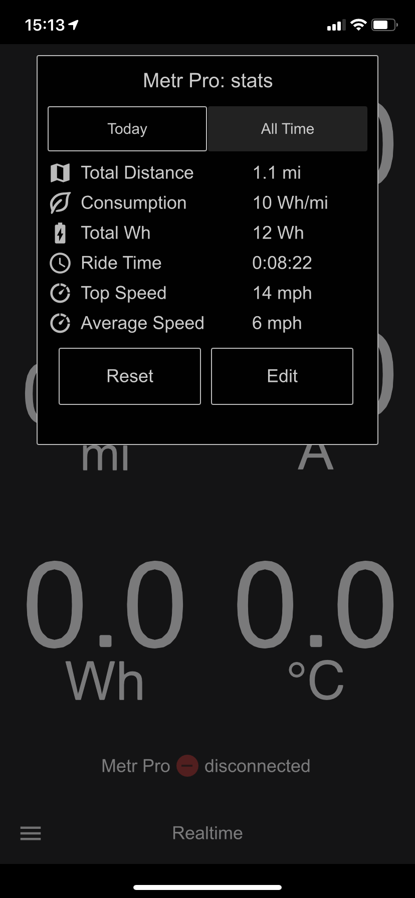

@rpasichnyk I’ve been using my METR on all my longish rides but on short rides I never open the app, is there a way to make the module record even when not paired and then sync when you open the app? Maybe half my miles are unlogged rn
Sounds hard to accomplish considering how the module works. Heck. One could ask for GPS tracking too. :slight_smile: Just need to understand: it’s a module that literally has a limited size of EEPROM memory to save startup mode (not feasible anymore with the latest update) and that’s it. It’s literally a relay of data between VESC and your phone. :slight_smile:
and your phone is what does the GPS logging
The same for me, I’ve said before, but I would love a Metr that has all in it, probably a SD card to store records, GPS and all, the app being only when you want to check
Honestly all I want is the screen that says total miles/consumption/efficiency/time that you get them you click the + on the real time screen…mostly to track total range and energy use. All of that is tracked via the module itself and the hard drive space to record it is trivial (it’s just 4 float values I think, since rates and efficiency are calculated)
