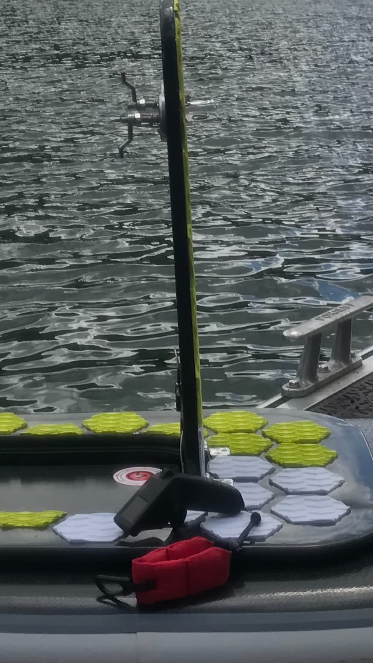

the GPS is located inside the waterproof technical box, more exactly under the access cover to the waterproof compartment. This box is made of AIREX resin exclusively in fiberglass where the GPS module is located. The GPS module is located in exactly the same place as the VX3 remote control receiver, which works flawlessly. when I close the waterproof case I have the satellite connection but as soon as I fall in the water or lie down on the board I lose this connection and metr.pro can no longer acquire the satellites⌠I canât move the GPS module further towards the front of the board: waterproofing requires, the board itself being an inflatable MALA.
Is there a GPS module more sensitive to the reception and acquisition of satellites?
