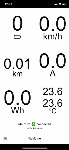

For everyone running latest UNITY firmware 23.45, there is a serious issue.
Please stop using your UNITY until the new firmware version is provided. Or downgrade to older firmware with 115200 workaround iCloud Drive - Apple iCloud
One more option, unplug the metr pro unity module.
NOTE: non-unity metr pro doesn’t trigger the issue
as in the uart metr…but plugged into unity?
or as in any other vesc beside a unity?
So the word is, the metr that replaces the Unity’s built-in bluetooth module can trigger the issue, but not a normal metr (with wire) plugged into the unity’s exposed UART port. The issue is with the Unity at this firmware version, not the metr module. the metr pro unity module happens to tickles the bug.

If this impacts only unity’s with the bt module why is the app disabled for normal metr pro module (On uart) too on the new firmware? Does disabling the app remove the issue for people who have the module? @Deodand are you working on fix for this firmware bug?
Its already released a fix for unity.
23.46
